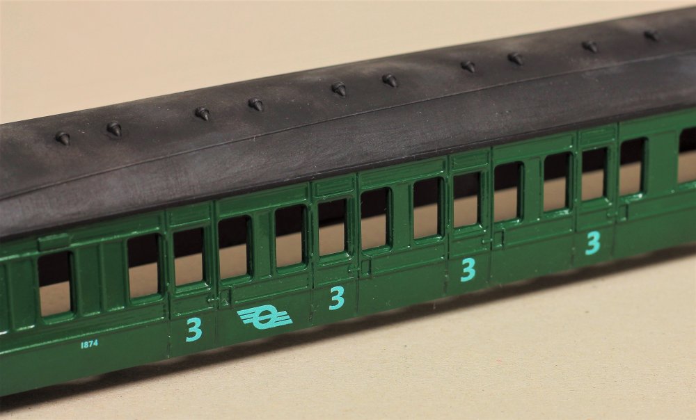

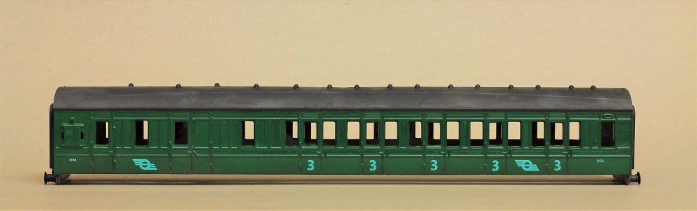

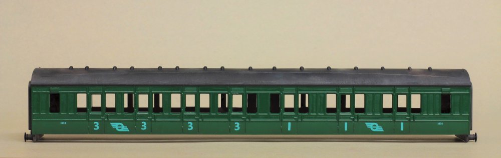

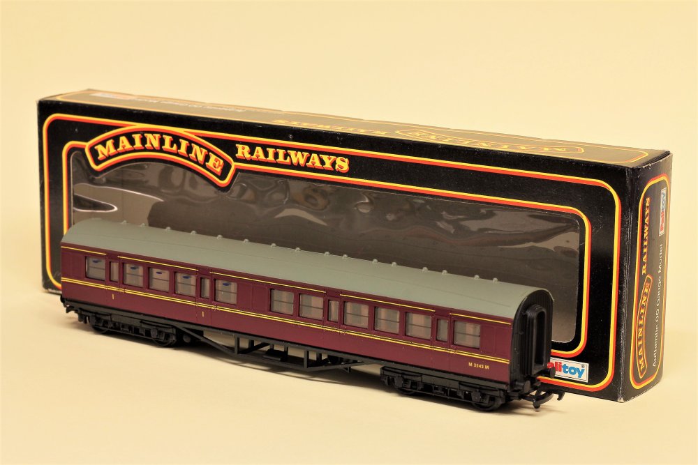

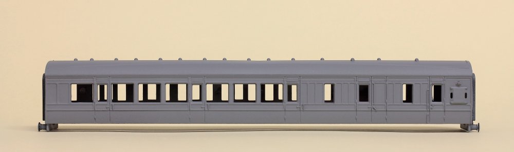

0 popeye Posted February 28, 2018 Author Posted February 28, 2018 So, the story so far, i bought 2 coaches second hand Mainline LMS. I mixed up some green paint. 42 drops of Brunswick green No 3. And 2 drops of yellow. I think it looks close enough. I got some transfers from Railtec. I'm not sure if the colour of the snails & numbers is right. So i would like your opinions please. 2 Quote
0 murrayec Posted February 28, 2018 Posted February 28, 2018 (edited) Hi popeye The Brunswick green mix looks excellent, but I reckon the decals are to green/blue- they should be green/yellow or yellow/green! I think I saw a post some time back here about Railtec's colour choice being a bit off on Irish decals- could be wrong though. jhb should be along soon to take a look- last I heard he was snow modelling a J15 snowman with that 2" of snow that fell on the hills Eoin Edited February 28, 2018 by murrayec Quote
0 jhb171achill Posted February 28, 2018 Posted February 28, 2018 The green is pretty good. Coincidentally, I had an exchange of emails with a gentleman who says he can get me the proper code for it, which I will share once I get it. The "snails" and numerals, if you're asking, are not the right colour - they look quite "blue". The light green can be seen in the photo of John Wayne. However, and there's always a "however", a fair oul dose of weathering will calm it down to a reasonable level. The numbers are also slightly overscale. The Bachmann coach also had slightly overscale markings. Quote
0 jhb171achill Posted February 28, 2018 Posted February 28, 2018 I would add, a lovely paint job nonetheless, and for a coach of this type, you can get away with no lining if it's based around Cork; in late fifties they turned out some old secondary stock in the older green (as above), two snails as in the older green livery - in other words, exactly as your model! Quote
0 popeye Posted February 28, 2018 Author Posted February 28, 2018 Thanks, i thought they were a bit blue. I have to mix paint for the stripes and i will paint over the snails & numbers with the same colour. 1 Quote

0 popeye Posted February 28, 2018 Author Posted February 28, 2018 They are transfers. It is hard to judge the colour on a web page until you see them on the model against the green paint. Quote
0 johnminnitt Posted February 28, 2018 Posted February 28, 2018 For me too the green looks pretty good. Is there any other source of eau de nil snails and class numbers, as those seem not to meet with approval? Quote
0 Noel Posted February 28, 2018 Posted February 28, 2018 Lovely paint job. Your results have inspired me to have a go. I have a few on those maroon LMS coaches and never realised the potential for GS&WR use. Thanks for forging the way! Quote
0 jhb171achill Posted February 28, 2018 Posted February 28, 2018 1 hour ago, popeye said: They are transfers. It is hard to judge the colour on a web page until you see them on the model against the green paint. Yes, it is indeed. I went to great pains some years ago to mix green for a Spanish railcar (G scale outdoor railway). It turned out like CIE green. It should have been way, way, way darker - like in the chassis of an ammonia wagon. The colour wasn't remotely like what it should have been....... Quote

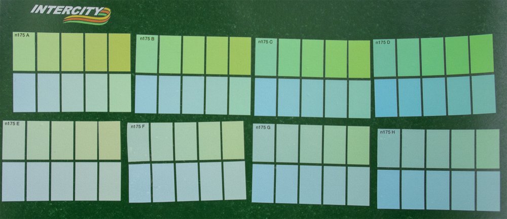

0 railtec-transfers Posted March 1, 2018 Posted March 1, 2018 (edited) I've taken the opportunity to make a series of tests, and if it's ok with the moderator(s) and topic poster, invite feedback to hopefully help steer us all towards a majority verdict on what we think is the most suitable colour match for the transfers to suit this livery. As mentioned, there will be a minor variation in the way your own screens interpret the colours in the image vs the actual physical print I have in front of me, but hopefully this will get us pretty close to where we need to be. I've had to do some playing around with the RAW image to get the screen colours as good a match as I can to the physical print. The blocks of colours have been placed onto card which has been sprayed brunswick green, which should be a good match for the carriage. At least it should be sufficient enough to show the variations in colours for this exercise. Assuming the colour we're trying to match is the very pale green above the gentleman's cap in the Quiet Man film photo, I have a personal choice but am interested to hear others' thoughts...? Edited March 1, 2018 by railtec-transfers Quote

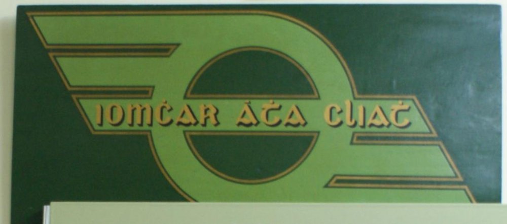

0 popeye Posted March 1, 2018 Author Posted March 1, 2018 Here are 3 pictures of Eau de nil green. This might help you choose the correct colour. Quote
0 railtec-transfers Posted March 1, 2018 Posted March 1, 2018 To my eye, the shade of the snail is quite different to that of the Quiet Man film photo. Which one is it we're trying to match? Quote
0 popeye Posted March 1, 2018 Author Posted March 1, 2018 This is the problem Steve, every picture you look at it's a different shade. I think on the BS chart it's somewhere between 216 & 217. Quote
0 johnminnitt Posted March 1, 2018 Posted March 1, 2018 9 minutes ago, railtec-transfers said: To my eye, the shade of the snail is quite different to that of the Quiet Man film photo. Which one is it we're trying to match? I agree, that snail looks (to my little eye) noticeably darker than the Quiet Man pic, or the snail in Mr Achill's symbol. On your examples I quite like the second from the left, top row, block C. I would suggest that if unsure, as one can hardly help being when the shade seems to vary so much, it's better to go paler than darker - paint would surely not remain the 'paintshop' shade for very long and would be more likely to fade rather than darken? 1 Quote

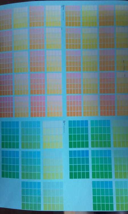

0 murrayec Posted March 1, 2018 Posted March 1, 2018 (edited) Hi Guys Standardisation is the key, the photos are all different depending on the lighting, angle, film or digital! We should stick to the BS 381C Standard, as this paint is ready available and will be the same all the time, I have pasted the 216 into Steve's snail sheet using the same colour pallet in photoshop which gives a comparison to work with;- I would stay with this ref and not alter it, so later when we go back to buy paint it will be the same I would also suggest, If Steve can print white first and then print 216 on top a better colour representation should be achieved, not sure if his printer is able to do this? Edit;- Eau De Nil snails should have a gold line around the edges, this can be achieved with a deep yellow BS 381C 356 and very thin! Eoin Edited March 1, 2018 by murrayec 2 Quote

0 railtec-transfers Posted March 1, 2018 Posted March 1, 2018 Thanks for the posts - this is really useful. So just to back up a sec and make sure I'm understanding this correctly: we're all talking about the colour of the transfers as opposed to the vehicle body? Just the comment re the buying of paint, i.e. obviously we don't want to make the transfers the same colour as the paint. The colour samples I showed above have white beneath. If they didn't those colour boxes would just disappear into the green and you wouldn't be able to see them at all. The printer looks like it came out of NASA and can do various forms of white beneath, with or overlay, but I won't bore anyone with all that! It could print a gold outline although I'd challenge anyone to be able to see it if printed at true scale. For it to perhaps be visible I'd need to thicken the outline which would, strictly speaking, make it incorrect if scaled up, but as is so often the case with this hobby, it's what looks right rather than what may be scale correctness. In the past few posts I'm seeing what I think may be 4 different shades of what I understand would be feasible for the transfers. What concerns me is that if 216 is the "standard", the images of the real-life examples seem to be quite different. 216 seems to be several shades darker. Quote

0 murrayec Posted March 2, 2018 Posted March 2, 2018 (edited) Hi guys Furthering on the EDN colour, I've gone through the standard RAL & BS 4800 colours and come up with this! The EDN colour on the right is from BS 4800 colours- this range is more common and available in all paint stores, one range is 'Dulux Trade' which is called something new now! (it's an old Dulux brochure I have- but the BS reference will not have changed) BS 14 C 35 is called 'Braemar' by Dulux and 'Iceplant Green' by others- in photoshop it's pretty close though?? There is not a green like 226 in the standard BS 4800 colours- the closest is BS 14 C 39 but leans towards the blue side! Eoin Edited March 2, 2018 by murrayec Quote
0 johnminnitt Posted March 2, 2018 Posted March 2, 2018 The colours on the right look pretty close to the film still to me. Quote

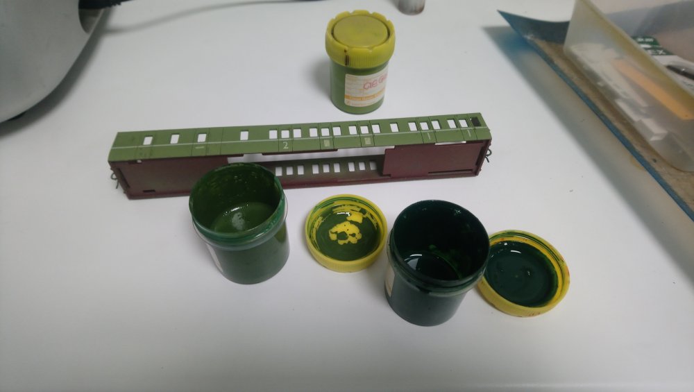

I've updated the test sample photo below to show the Vallejo paint numbers used, apologies without ratios, as I usually mix paint by eye rather than by measure. When I am happy with the shades I will
