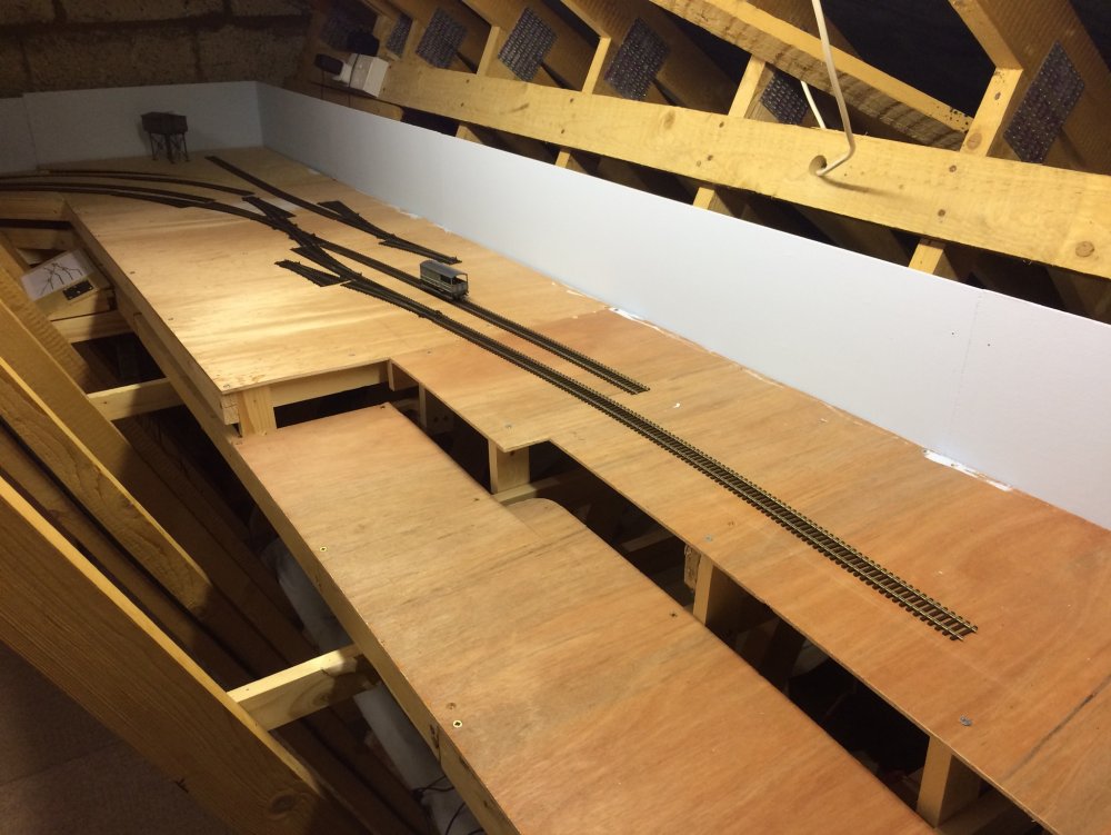

GNRi1959 Posted January 5, 2018 Author Posted January 5, 2018 (edited) Baseboard end fitted today to give possibilities of a running train in a circuit. This last fixture rests on good quality right-angle brackets and will be designed to lift in and out as required though entry is possible by 'ducking under' the baseboard. As you can see there some planning going on with lots to consider. Its quite deceiving in size. I have 2m x 1.6, the left hand side is 2.8m long to allow for a fiddle yard, just out of shot. No hurry on my part, its still not garden shed weather! Edited January 5, 2018 by GNRi1959

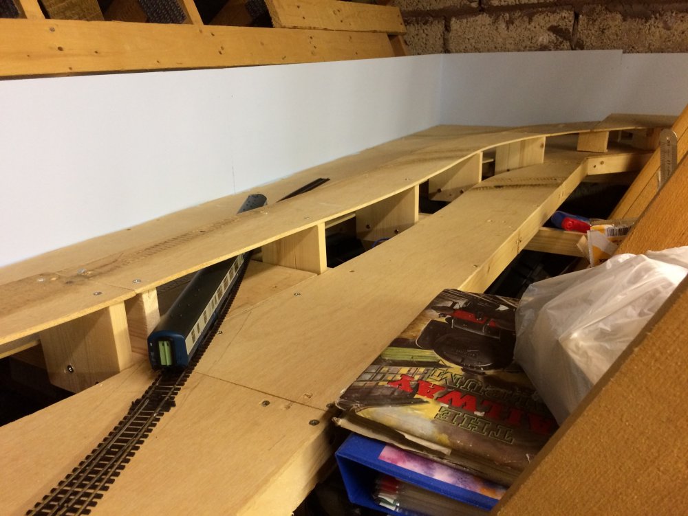

GNRi1959 Posted January 20, 2018 Author Posted January 20, 2018 (edited) The morning sun gave me a burst of energy so I went out to the shed armed with trammel and several large radius curves (1.2m and 1.1m) I cut on the bandsaw in ply and I set out a very pleasing track arrangement with a double track, reduced to single line at one end to give me a complete circuit. I also was able to get turntable, sidings and fiddle yard in place. Very pleased with it, give me an idea on how much track and points I need to buy. Edited January 20, 2018 by GNRi1959 1

GNRi1959 Posted January 21, 2018 Author Posted January 21, 2018 With the narrow baseboard width I have of 350mm I may be pushed to form embankments all round and may have to revert to dropping bridge levels below the baseboard. To form the embankment would mean losing at least 75mm I'd imagine if not more to form reasonable slopes? Any ideas?
PaulC Posted January 21, 2018 Posted January 21, 2018 The usual method for producing varying heights round the trackbed would be to construct an open baseboard. I didn't follow this approach as I already had my baseboards built from the previous layout. Instead, I ascertained what height I needed the track to be at to form the under bridge and raised the trackbed on wood formers to the relevant height. For much of the layout this is just a snaking trackbed above the baseboard with the exception of the station area which has a significant area entirely built up. This method just requires careful planning and knowing what and where you want features to be positioned in order that everything is constructed prior to any track being laid. With your carpentry skills, I have no doubt you could produce a much more professional job than I managed. Paul

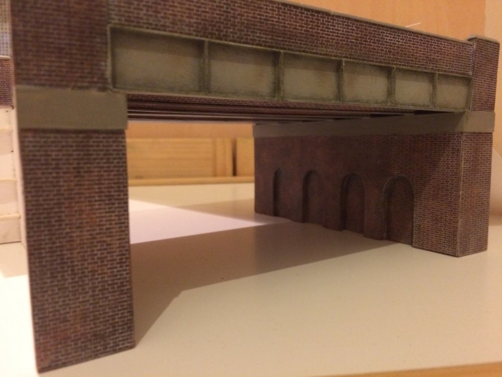

PaulC Posted January 21, 2018 Posted January 21, 2018 I had built the bridge below for my previous layout and wanted to incorporate it in to the new one so the height levels were based on this. I don't recall exactly what that height was but I think it was something in or around 70mm - not far off the measurements you are aiming for. Paul

GNRi1959 Posted January 22, 2018 Author Posted January 22, 2018 More progress tonight. Gradually working my ideas onto baseboards, re-arranging pointwork and curves to maximise space.

GNRi1959 Posted January 29, 2018 Author Posted January 29, 2018 (edited) Some track positioning going on today. Peco points are a nightmare. I wish there was a curved radius point that was a little less of a radius than whats available. Edited January 29, 2018 by GNRi1959

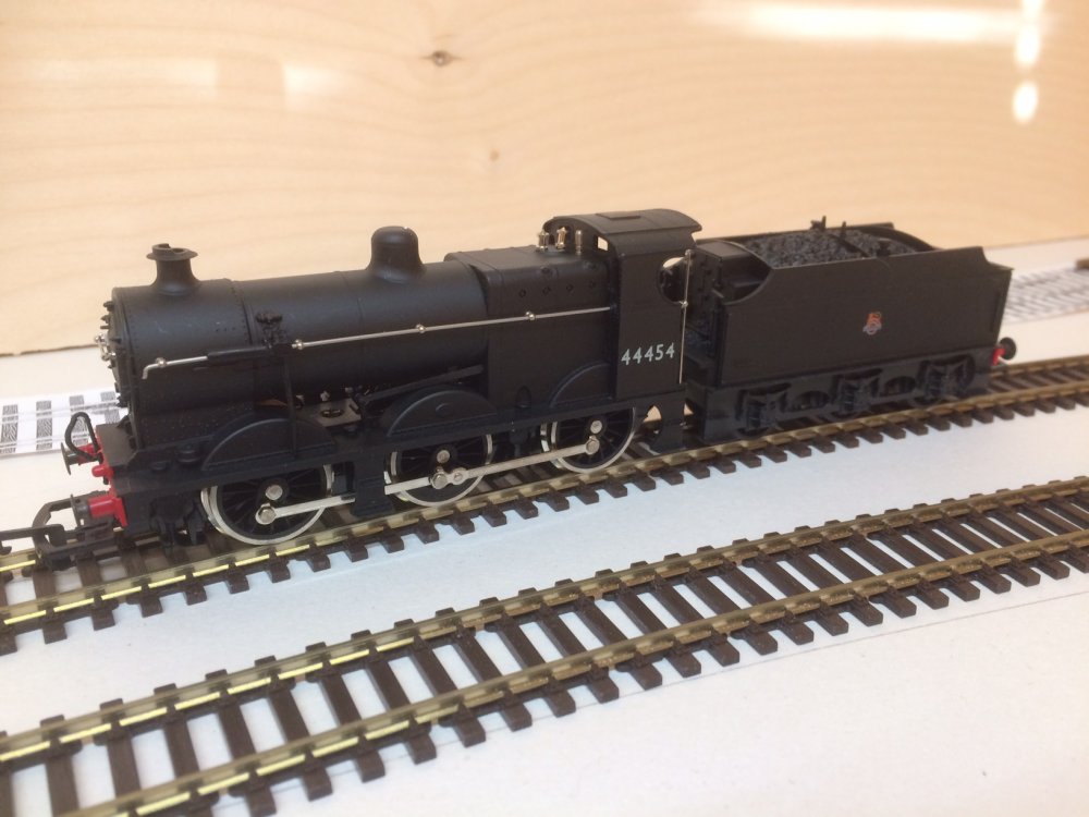

GNRi1959 Posted February 3, 2018 Author Posted February 3, 2018 Ordered 12xlengths of Peco Code 75 streamline flexi this morning to get started again in earnest. Until I find a much desired UG Class 0-6-0 this Un-used and Boxed Airfix 4F 0-6-0 loco will keep me occupied - not bad for £35.
