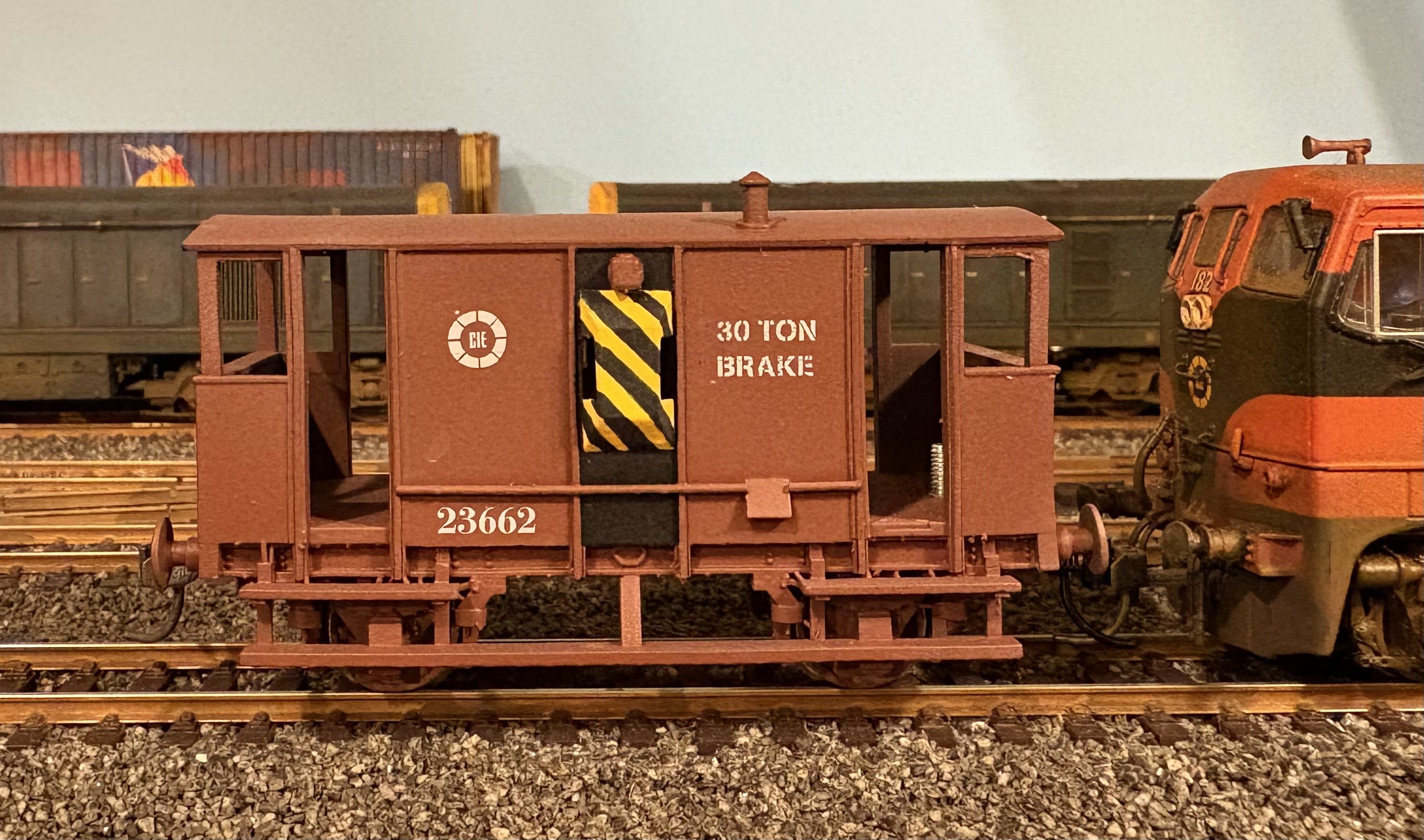

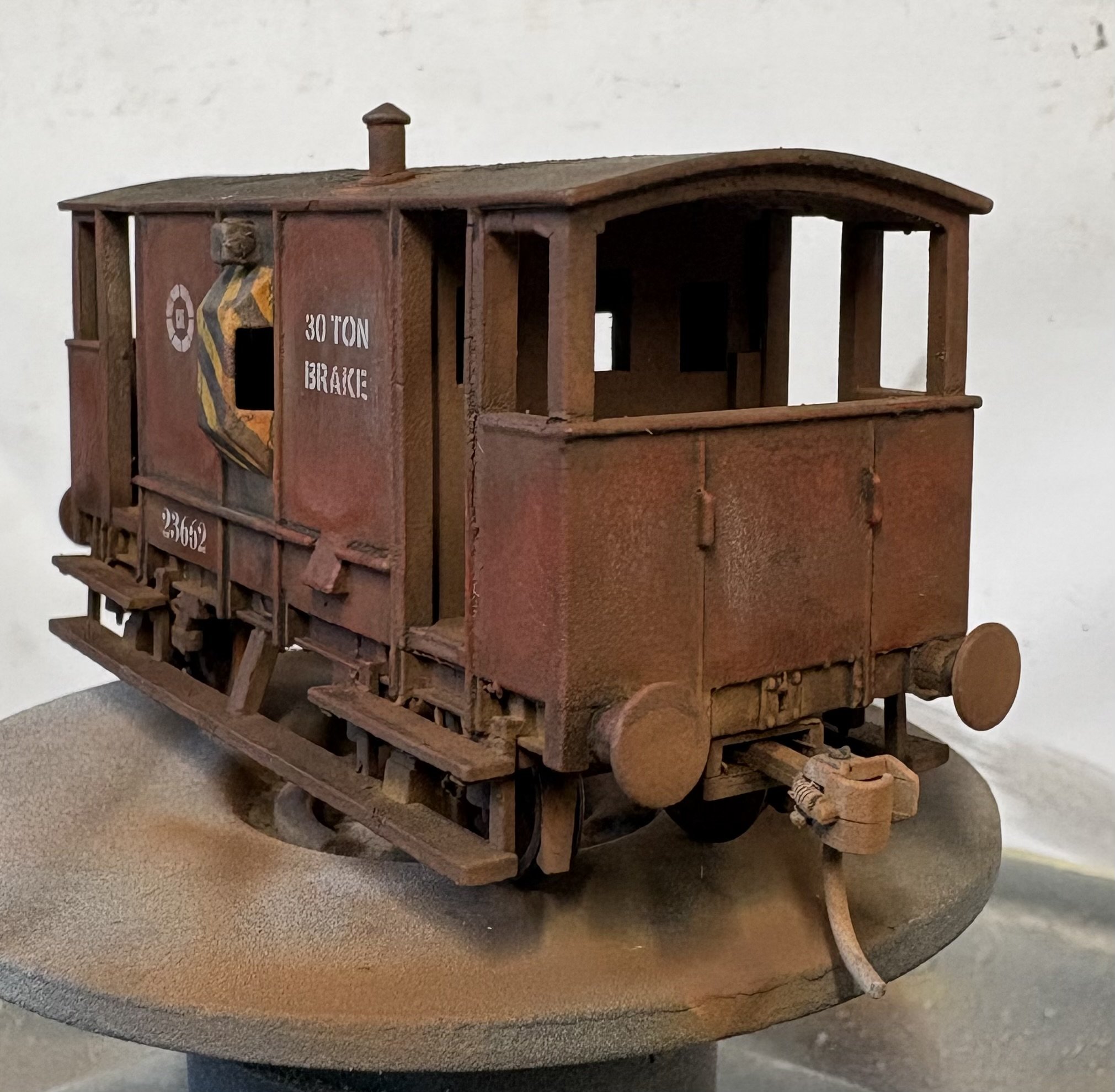

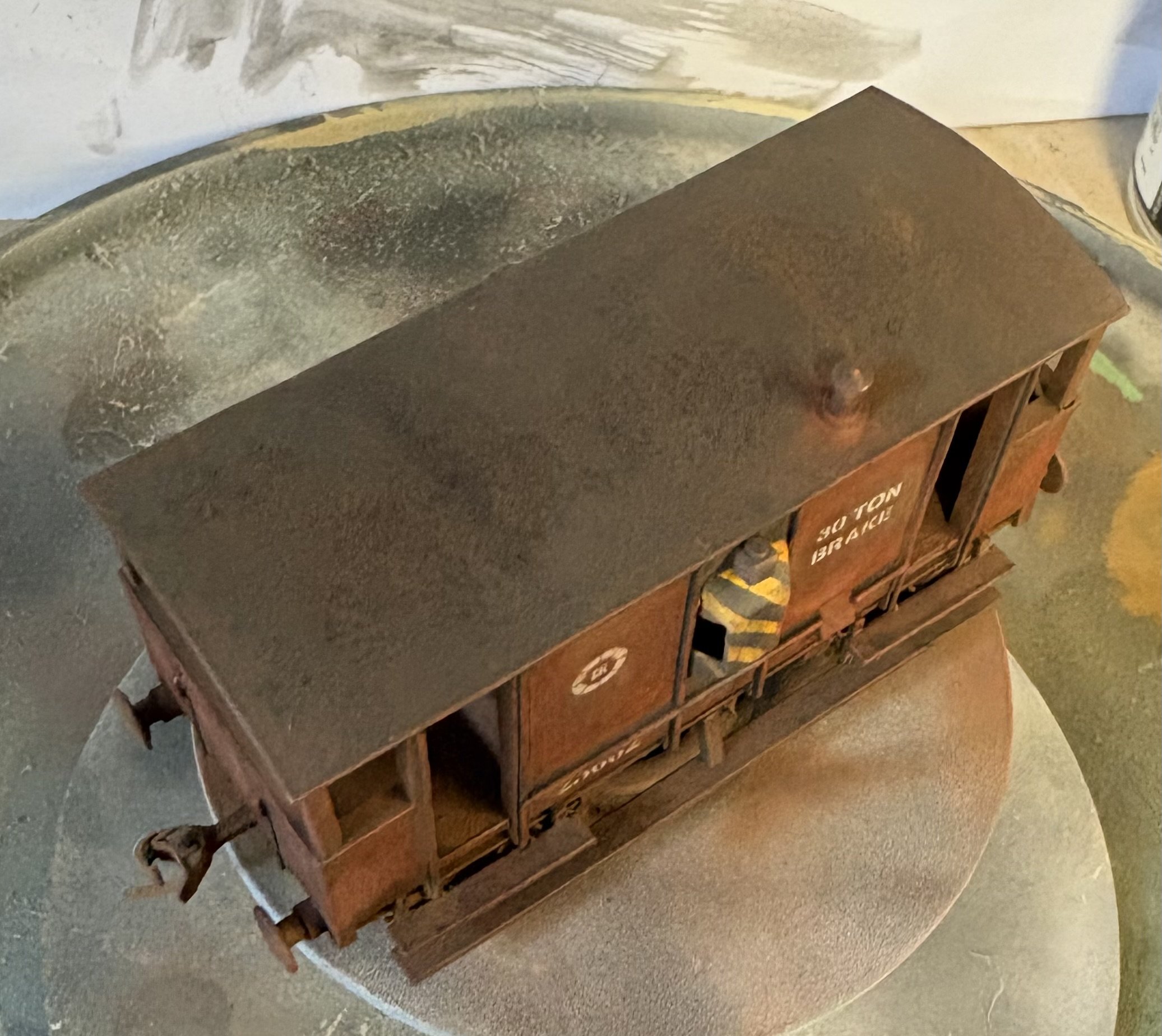

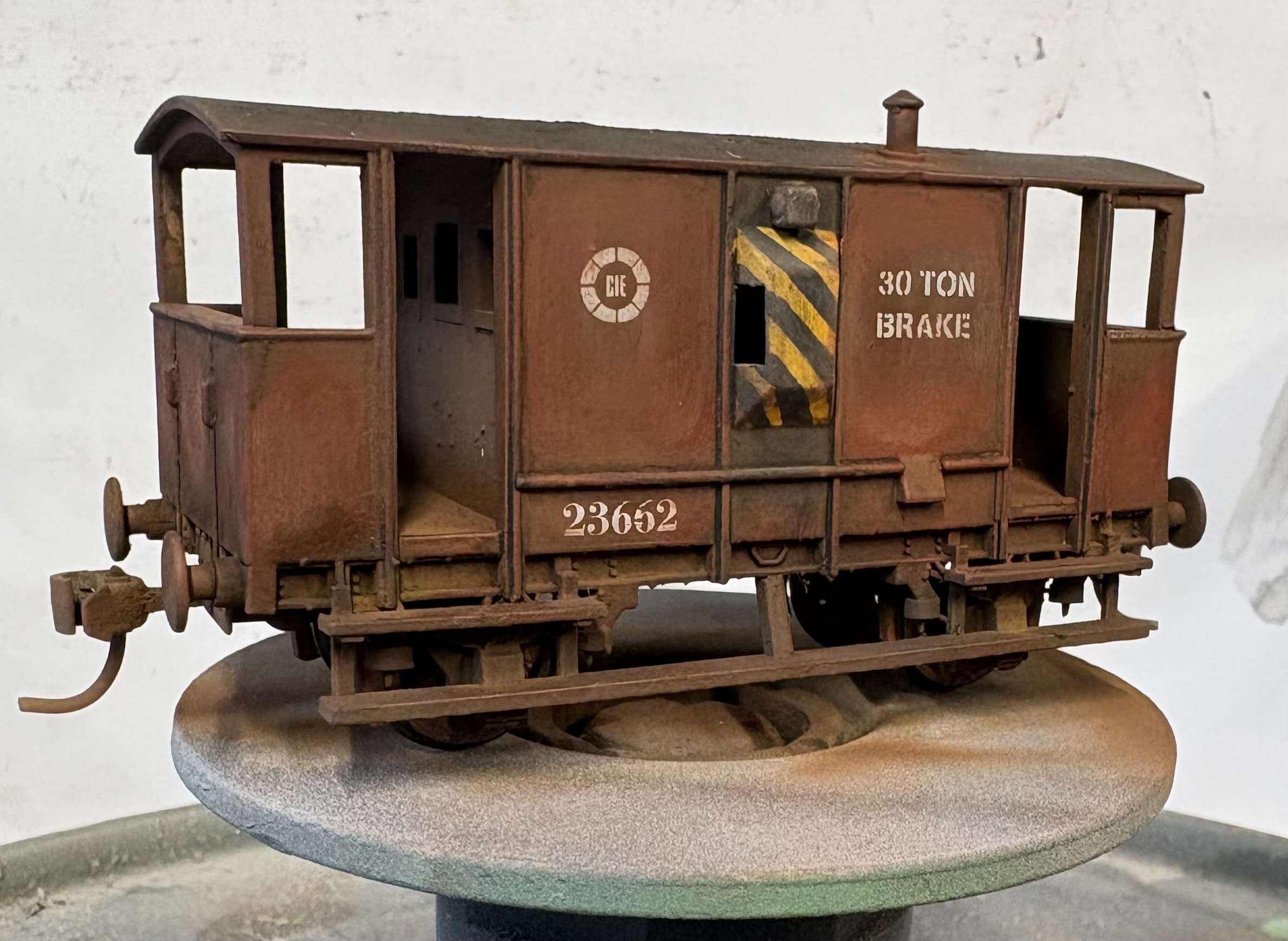

Picked up one of @Past-Avenue’s lovely 3D printed 30 ton brake vans at the last Bray show.
I opted for an unpainted version which came supplied with decals. It really is an excellent print with a very smooth finish that takes paint very well.
I used a more of a brown bauxite colour (Tamiya XF68) which is less red than some models I’ve see but I’m happy enough with it. It will be heavily weathered anyway.
While the decals were fine, I just couldn’t get the wasp stripes to work. Sorry Enda! So I opted for hand painting them, I think it looks ok.
I also removed the NEM coupler pockets. The molded ones are spot on, I just prefer to mount coupler boxes on my stock.
The finished product, sans weathering.

That turned out really well and it will even look better when you weather it.
It's nice to see someone been able to finish a model that you have to look twice at it to see if it's a model or the real thing.
Well done Graham and thanks.
Enda
Enda
Like I said the finish on the model was excellent, it took the paint really well.
I’ll be honest, I was expecting a much rougher finish so I was very impressed.
