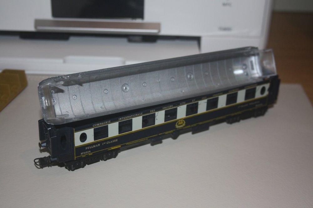

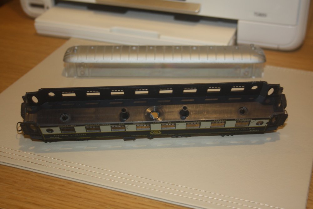

controller Posted November 7, 2018 Posted November 7, 2018 I have three Lima Italy pullman coaches and one parcels van. I bought them for my sons many many years ago. I would like to put lights in to them, but I am having trouble taking them apart. It looks like I will have to take the roof off , but I do not want to force it, in case I cause any damage. There are no screws visible holding the roof on, just three holes in the chassis which don't appear to serve any purpose. Any tips?. Thanks, Controller.
DiveController Posted November 10, 2018 Posted November 10, 2018 Post a pic of the coach in question. Lots of stuff online for different coaches , roof removal etc

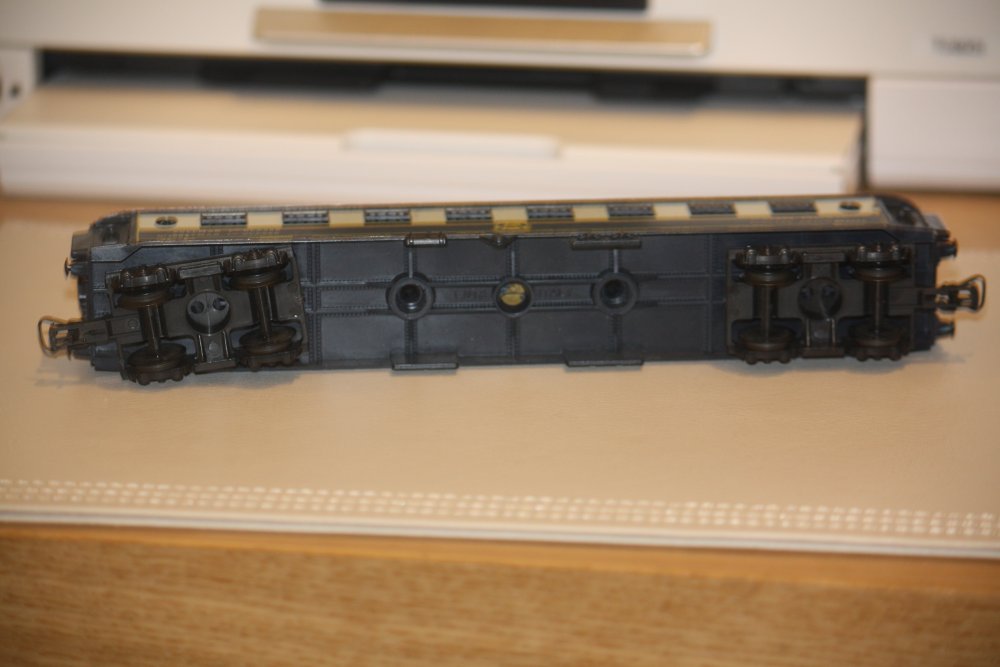

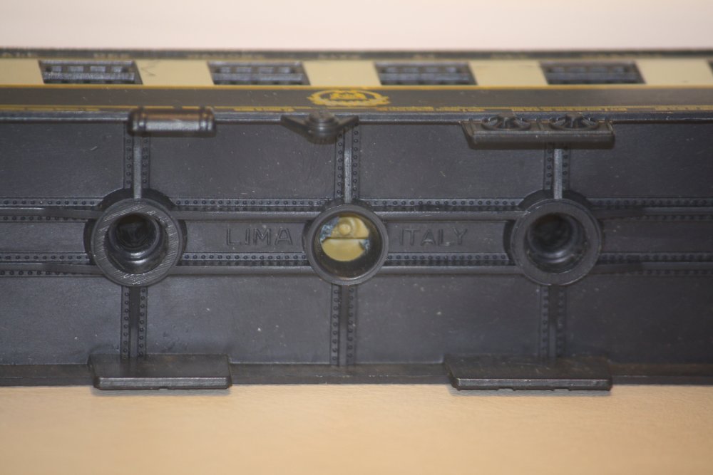

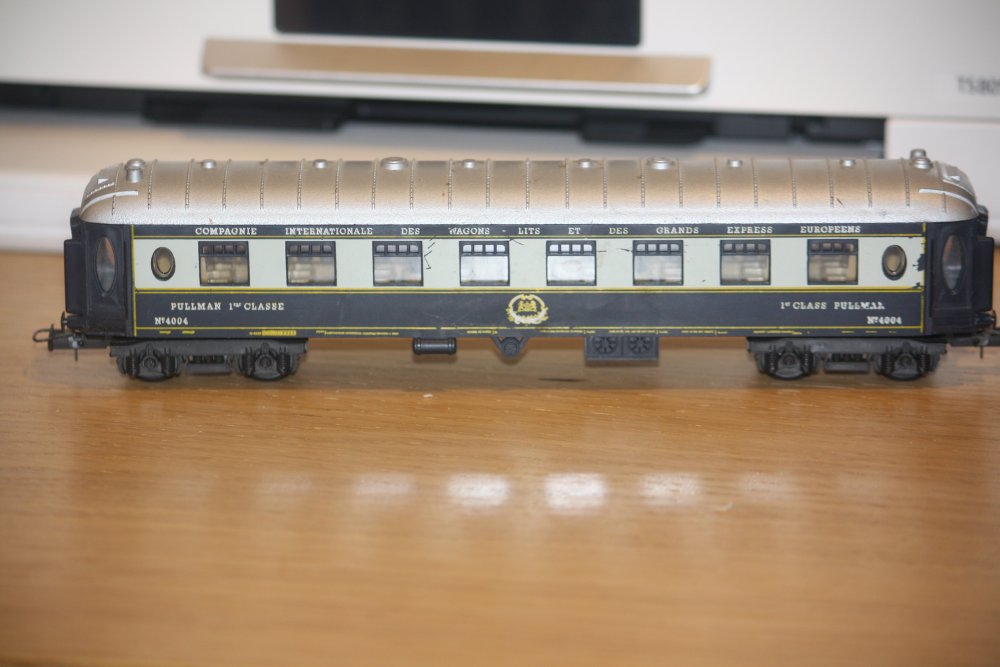

controller Posted November 10, 2018 Author Posted November 10, 2018 Thanks DiveController. These are a couple of photos of one of the coaches. I have pulled on the roof, but I am afraid I will break it. As you can see in the chassis, there are three holes, but I can't figure out what the purpose of these are. Controller.
Broithe Posted November 10, 2018 Posted November 10, 2018 I've never dealt with one of those specifically, but, in that sort of situation, there can often be a couple of screws at the far end of the two "tubes" going up from the floor. Can you see through the windows if they go right up to the roof?
PJR Posted November 10, 2018 Posted November 10, 2018 Looks to me that the bottom and sides and one piece, so think the roof comes off with the glazing attached. So great care need to remove so as not to break, start in the middle and move along using wooden coffee stirrers to hold
murrayec Posted November 10, 2018 Posted November 10, 2018 1 hour ago, Broithe said: ' there can often be a couple of screws at the far end of the two "tubes" going up from the floor. Can you see through the windows if they go right up to the roof?' I reckon Broithe's approach is correct, it looks like yours have the screws removed! are they second hand? as some clever chap may have glued them without the screws. Here is an image I found on e-bay which clearly shows screws;- Eoin 1
Broithe Posted November 10, 2018 Posted November 10, 2018 23 minutes ago, murrayec said: I reckon Broithe's approach is correct, it looks like yours have the screws removed! are they second hand? as some clever chap may have glued them without the screws. Here is an image I found on e-bay which clearly shows screws;- Eoin Ah, right, I was actually wondering if there were screws right up at the top end of the tubes, they're often black and barely visible. It would seem that @murrayec could be right... Another possibility would have been screws hidden by the bogies, but that's excluded by his pictures, too. Sometimes, a bit of gentle pulling about can reveal where the splits are and you may still be able to part them - but there is always an element of risk. Lima did, at times, mould the roof and windows in one clear piece, then painted the roof section.

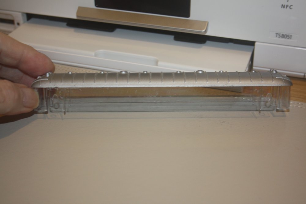

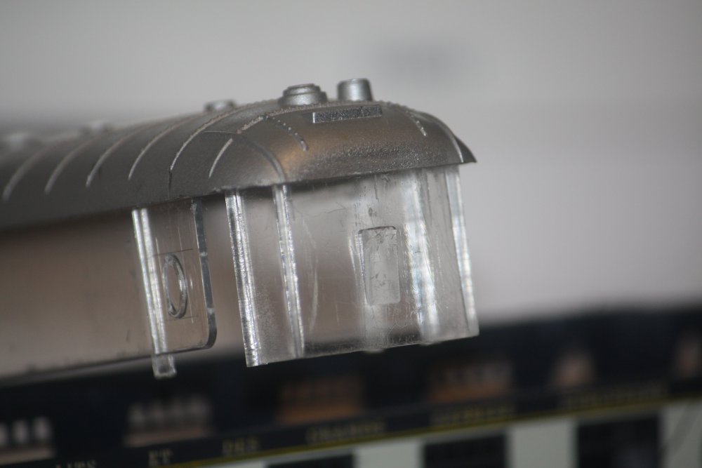

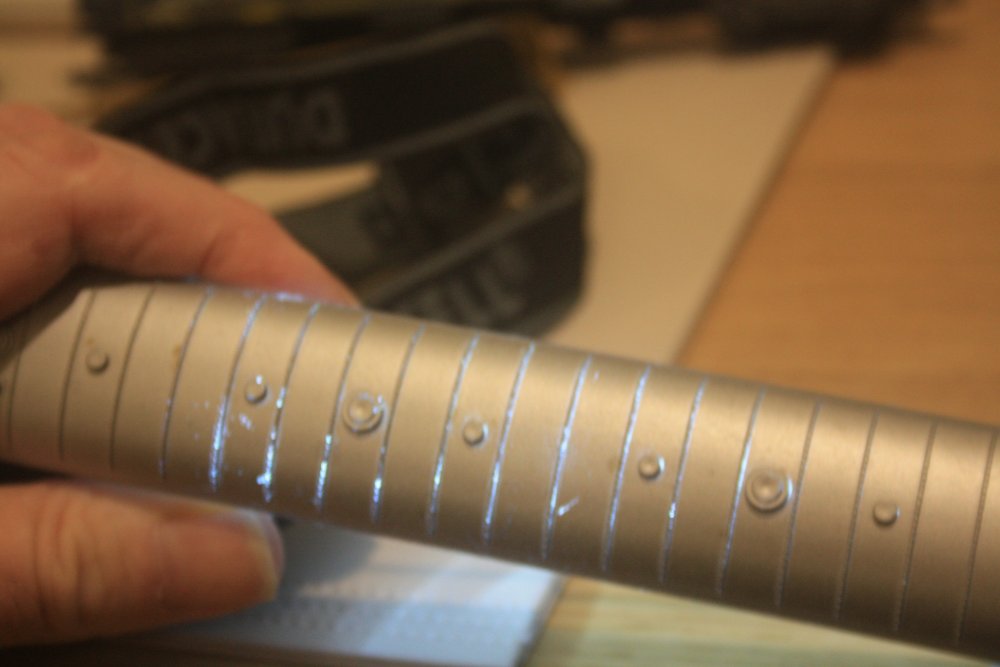

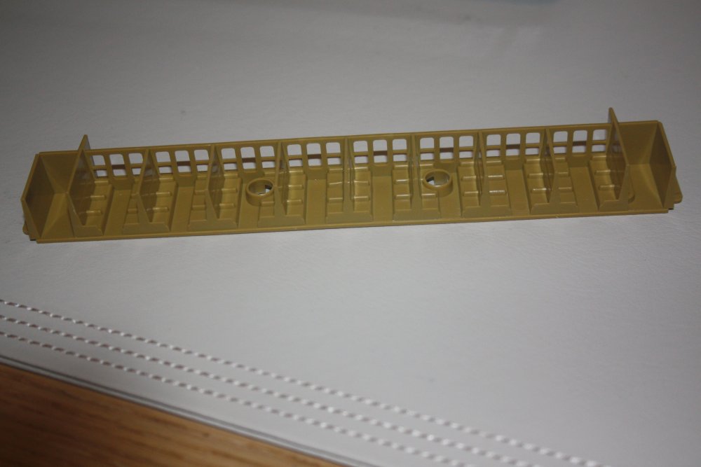

controller Posted November 11, 2018 Author Posted November 11, 2018 Hi Lads, I finally found what was holding the roof on. Not a screw to be found anywhere. As you can see from the photos, the glazing at the end of the coach, at the gangway window has a small lip, which when pushed in, enabled me to pull off the roof and glazing all in one. I can't remember where and when I got the coaches. I got a number of coaches from a work mate, many years ago, so these may be some of them. Now for lighting. Thank you all for all your advice and help. Thanks, Controller. 2 1

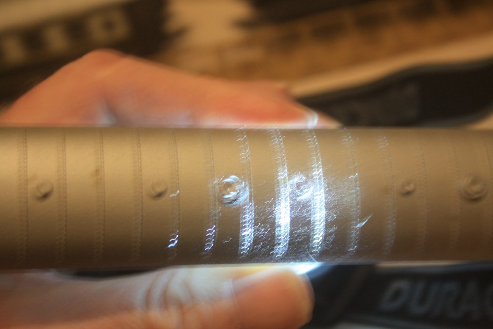

Broithe Posted November 11, 2018 Posted November 11, 2018 Always worth a trial run to see if any light will bleed though the roof or sides. I've found 'silver' paint to be fairly leakproof.
controller Posted November 11, 2018 Author Posted November 11, 2018 Silver paint it is then. Thanks for the tip. Controller.
controller Posted November 11, 2018 Author Posted November 11, 2018 I think I am going to need a lot of paint for these roofs. Controller
murrayec Posted November 11, 2018 Posted November 11, 2018 If you use stick on LED strip lighting you wont have to worry about light coming up through the roof, the LEDs are facing downwards. You could also mount the strips on a wide piece of card and then fix that to the roof?.... Eoin 2
Broithe Posted November 11, 2018 Posted November 11, 2018 You can also have 'edge-lighting' issues around the windows - experimentation is the key to success.
