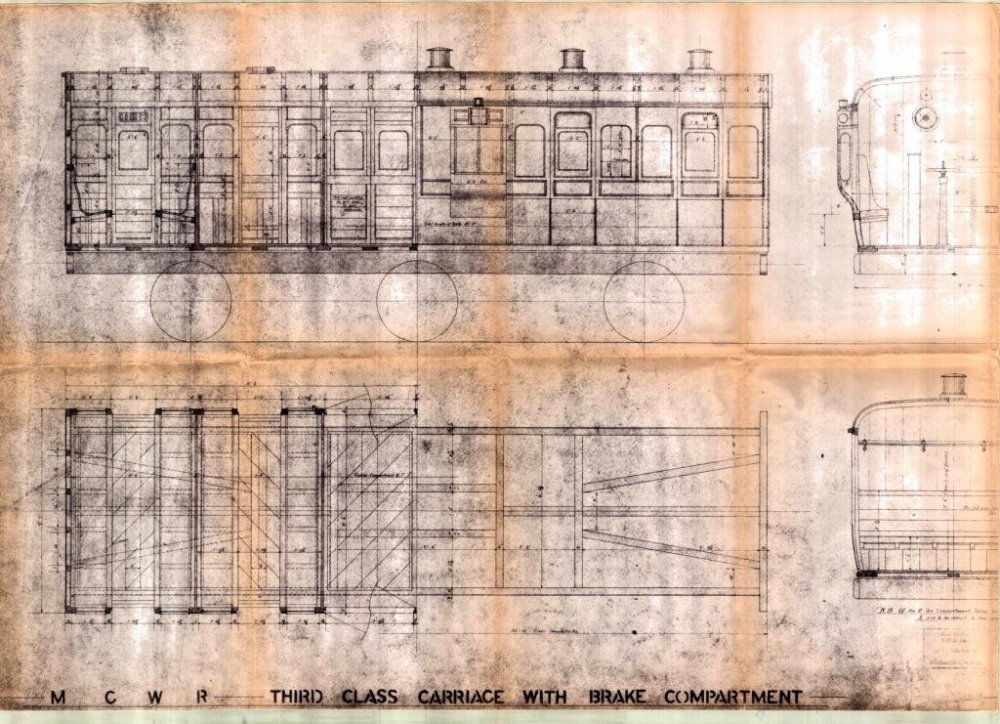

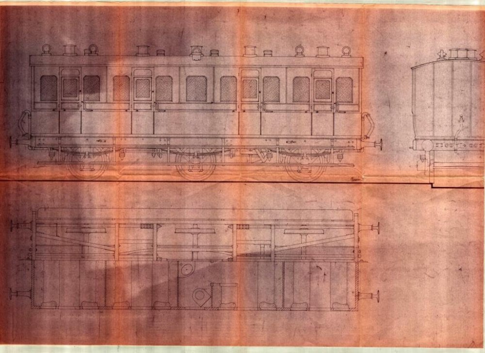

The lighting system depended on the railway.
The MGWR seems to have used oil lighting on 6w stock with top hat lamps, some coaches appear to have had ventilators others not.
Attock 4 compt Lav 2nd
341202275_6WThirdwithBrakeCompartmentCusachRoofProfile.thumb.JPG.cf50a10ce8db153b53e8477957d4c547.JPG
1908 4 Compt 3rd with brake Compt.
WLWR had introduced electric carriage lighting before the GSWR takeover but may have been restricted to new bogie stock.
WLWR 4-4-0 at Junction oil lit stock. Photographer unknown.
GSWR 6 wheelers had gas lighting with large torpedo ventilators and converted WLWR stock to gas lighting following 1900 amalgamation.
