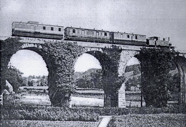

Edo Posted April 24, 2019 Posted April 24, 2019 (edited) http://www.igp-web.com/Carlow/Borris_Railway.htm Hi all Hoping to tap into the hive mind around here to help me out to try and identify the rolling stock in the above photo - While Im not bad at locations and stuff - i have to confess complete ignorance when it comes to naming passenger stock and locomotives from before the 1960s............... this train is on the viaduct in Borris on the Bagnalstown to Palace east GS&WR line - given that passenger services ceased on that line in the early 30's - i think we're probably looking at the 1920s or slightly earlier - Im looking to identify the coaches and loco - not the exact number - but the make and model would be great. thanks all Ed PS - just looked it up - the photo is on a card produced in Dublin and posted in 1908! Edited April 24, 2019 by Edo forgot the effin photo didn't I! 1
jhb171achill Posted April 24, 2019 Posted April 24, 2019 The carriages are GSWR designs of the 1880-95 era, and the loco is a GSWR tank engine, exact type (there were several outwardly similar) uncertain. 1
jhb171achill Posted April 24, 2019 Posted April 24, 2019 Just adding.... the middle one is a 1st class, or possibly 1st / 2nd class coach. The ones either end appear to be brake thirds of two different types. 1
Edo Posted April 24, 2019 Author Posted April 24, 2019 (edited) Thanks JHB. Apart from an IRRS Special which traversed the line just before it shut for good in the early 60's captured by James O'Dea - that is pretty much the only photo or image of a passenger train on that line so has nearly iconic status down South Carlow direction - there is a copy of it in all the pubs!. I'd love to recreate it - I did have a GWR tank with a couple of those little coaches straight off the pages of the Ivor the Engine or out of the Welsh valleys, as a kid, but to put together a prototypical set of some accuracy , as I suspected, will be quite difficult to do..........The GS&WR seems have had an amount of "similar but slightly different"rolling stock.....which makes it a serious challenge to model. thanks again Ed Edited April 24, 2019 by Edo spelling!

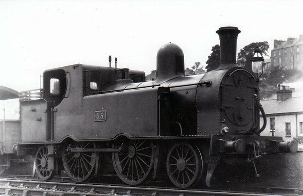

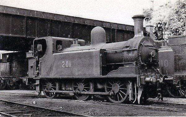

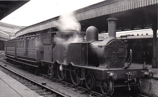

Mayner Posted April 24, 2019 Posted April 24, 2019 Brian McCann built an N Gauge exhibition layout based on Bagnalstown that was featured in the Railway Modeller during the early 1980s, the layout included reasonably accurate models of the station buildings including loco shed and the branch line was incorporated into the main circuit, the layout also included models of the Waterford line Barrow & Nore Viaducts. Building or kit bashing the train would be challenging in OO would be challenging in the absence of a suitable loco kit or ready to run donor locomotive. If you want to build a reasonably accurate model of the train O gauge might be a better option than OO as the 2-4-2T version of the loco is available as a brass kit from Alphagraphix and GSWR 6 wheel coach kits/parts are available from Alphagraphix and Worsley Works. Alternatively it should be possible to re-create a reasonable copy of the train that passes the 2' rule in OO or even N by kit bashing a British RTR loco into the 0-6-0T version of the GSWR loco with modified or re-painted Trtr 4 wheel coaches. A diorama featuring the Borris viaduct and a train in either OO or N gauge would make an impressive model The loco looks like a 37 Class or C7 4-4-2T introduced by the GSWR in the early 1900s. A brass kit of the 33 Class or F6 a 2-4-2T version of the same loco is available from Alphagraphix in O Gauge. Both classes appear to have been introduced a a light tank locomotive for Cork Suburban and branch line passenger and mixed train service and seem to have been reasonably successful. Many years ago someone kitbashed a passable model of a 201 class out of a Triang Jinty. 1 1 1

jhb171achill Posted April 25, 2019 Posted April 25, 2019 The types of GSWR six-wheeled coaches that travelled on that line can be had via Worsley Works “scratch-aid” kits. 1
