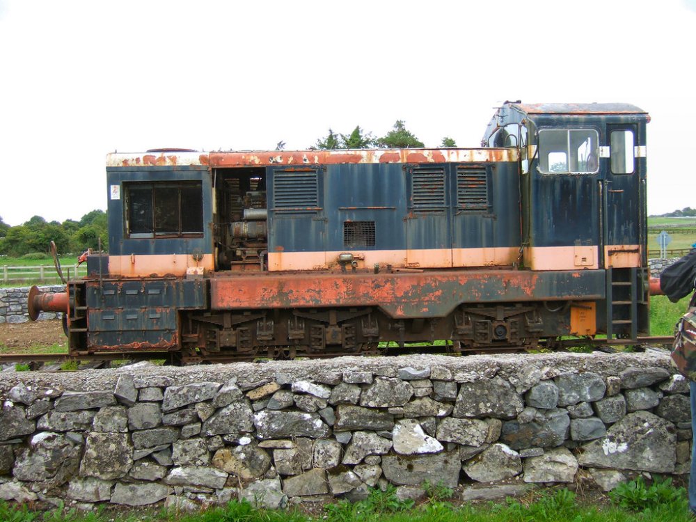

DiveController Posted January 22, 2020 Posted January 22, 2020 (edited) It might be possible to find a donor motor/chassis that you can 'drop' the body onto. The axles are asymmetric on the Es so most likely you won't find an exact match, but it might be possible to move an unpowered middle axle fairly easily. I know this E/421 is in bad shape but the chassis is seen pretty well apart from the bases of the wheels themselves Edited January 24, 2020 by DiveController 2
