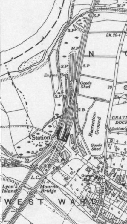

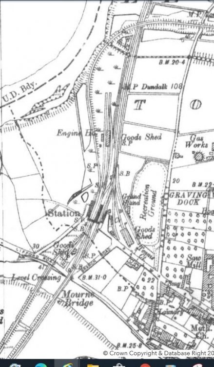

PRONI Maps have OS maps of the period. Below is a couple of screen grabs, one for 1900-1907, the other for later.
Capture5.thumb.JPG.6fa45bb9b20d9caf78c7c57923ad7471.JPG     Capture.thumb.JPG.ea8d699a1475fb6c0aa9d27f0fef398b.JPG
Thanks have access to those but when you try to see any maps pre 1905 you get a blank space on both the NI and ROI maps! Strange

As seen above, with the Strabane & Letterkenny Railway only opening in 1909 (one of the last; only exceeded by the Keady - Castleblaney line in 1913), it does not show on the 1907 map. Thus, prior to 1909, Strabane CDR station had no "back" platform.

OSi have the old 1:2500 (25") accessible online.  As you have noticed, the S&L is later than the plan surveys.  Some coverage exists with the 1:10560 (6") maps, but track layouts are very generalised.
PRONI - for some reason - do not have the 25" series online.
Fortunately, there is a blog that has some coverage:
http://oldstrabane.blogspot.com/2010/09/1905-ordnance-survey.html
It is possible to download the plan shown without the help of Google Earth.
The reason you are seeing blanks is because (I think) of the way PRONI presents the 6" coverage.  In other words, the blanks are because no sheets were available for that series.  You have to switch between the different layers.   By using screenshots, I was able to combine the sheet with the FVR junction and later coverage post conversion to narrow gauge.

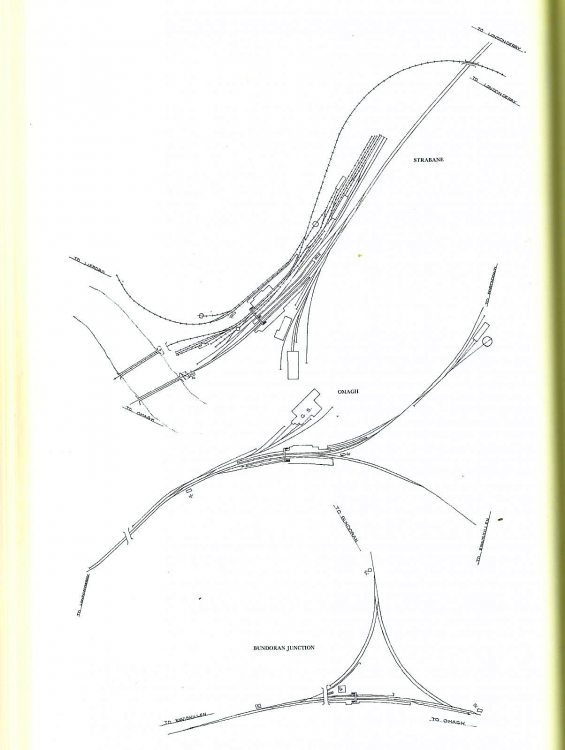

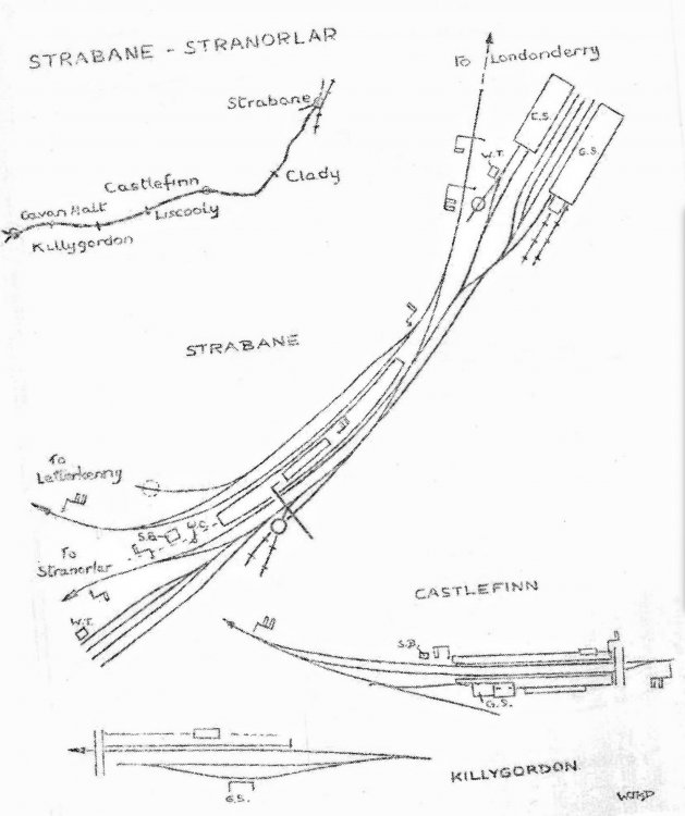

A previous post on this website included some additional information.   Unfortunately, I can’t remember the posting.  I can’t find a way of posting images here....found it.
One of the sketches was done by WJK Davies author of many narrow gauge books.  The sketch looks post-1955, after closure of the line to Londonderry.

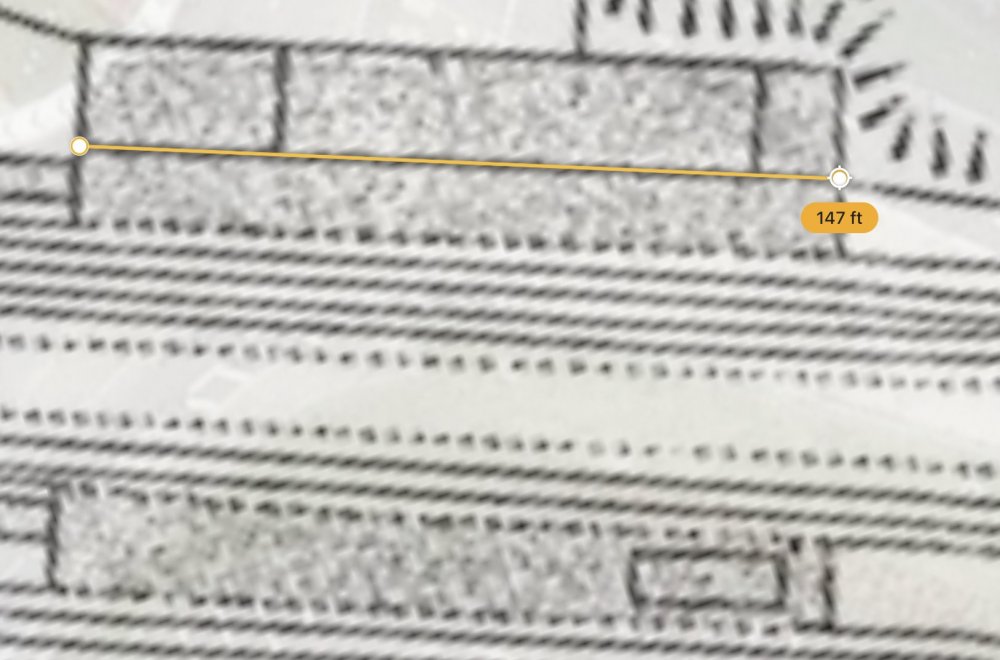

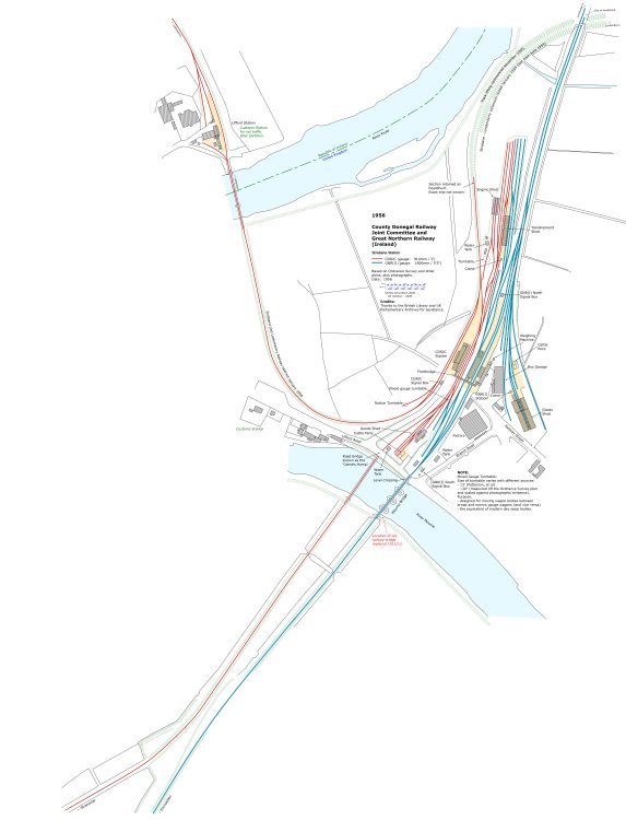

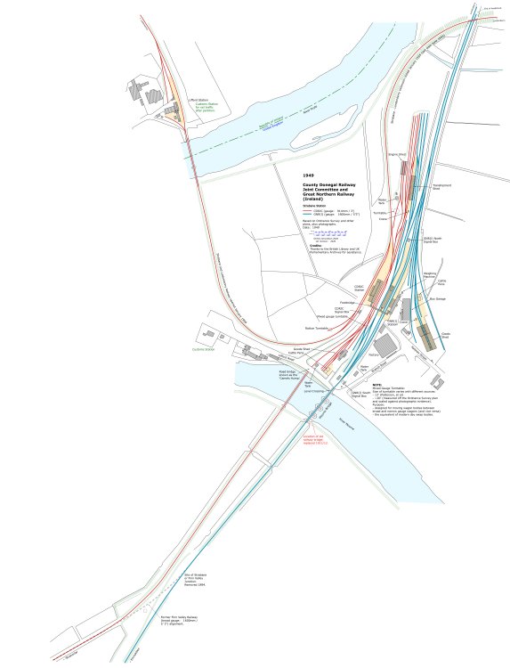

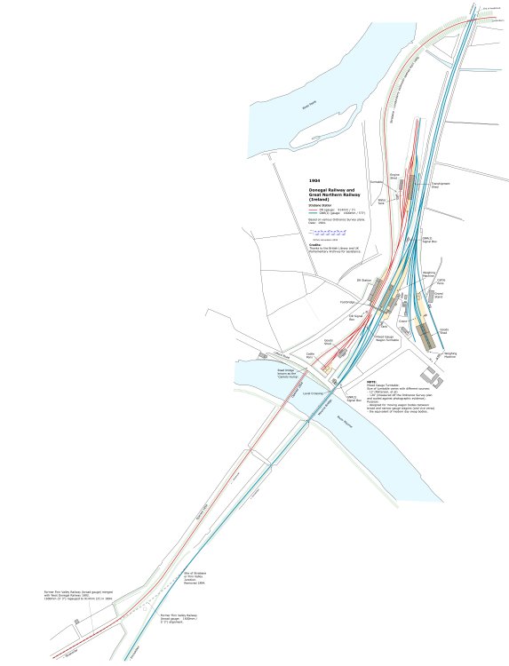

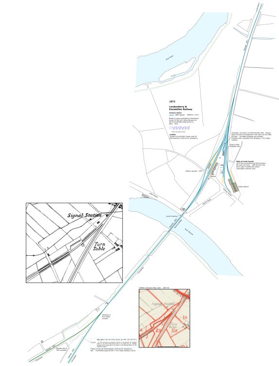

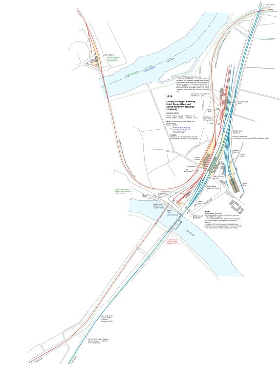

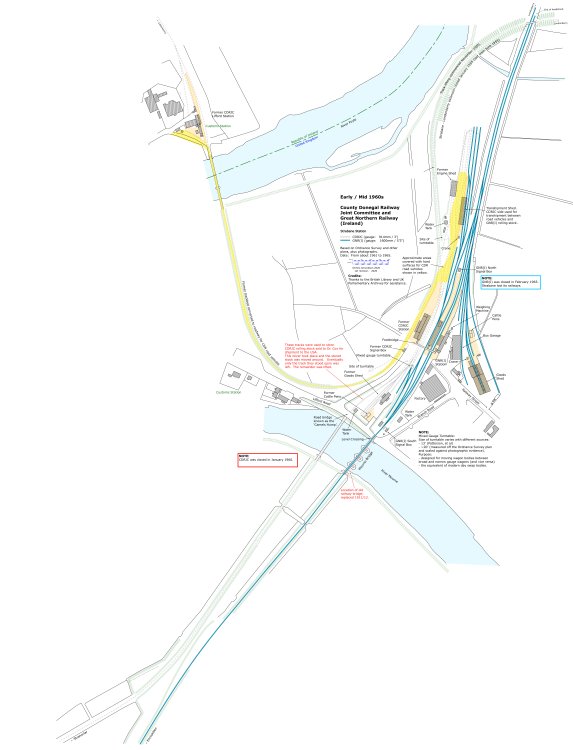

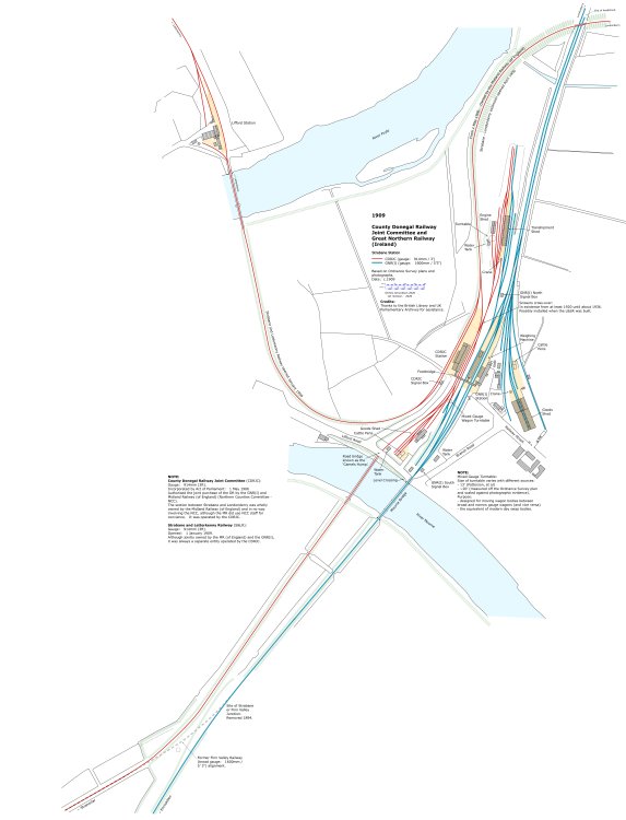

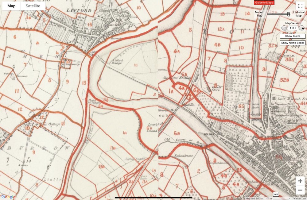

The c.1864 Griffith’s Valuation map shows the L&E and the junction with the FVR.  Detail is limited by the nature of maps, but some larger isolated buildings are good reference points.
Using the 1:2500 on Google Earth it’s possible to obtain general measurements.   See example attached.

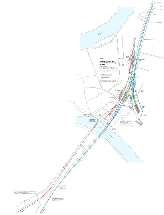

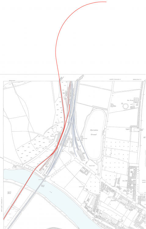

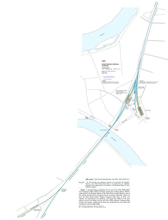

The next image is all I’ve done on Strabane to date.

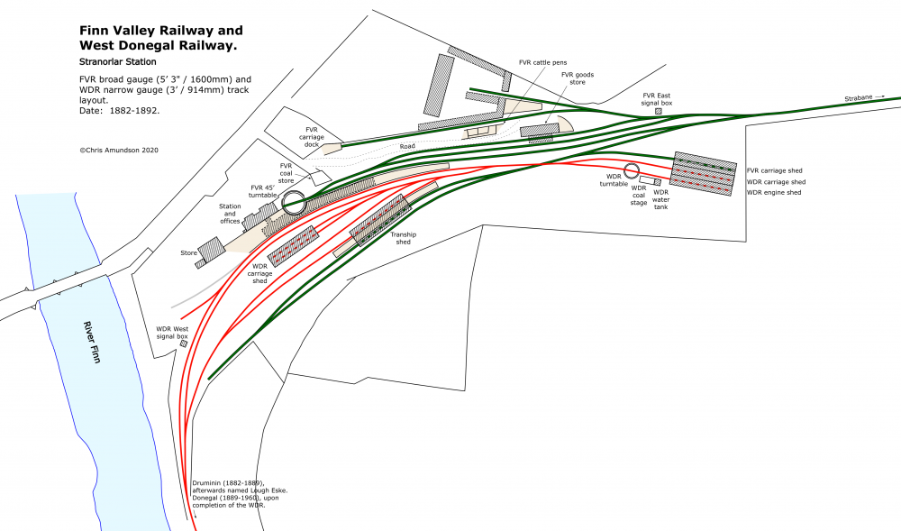

The final image is an example of what one of my finalised drawings - this time Stranorlar.
Any of this any use?
