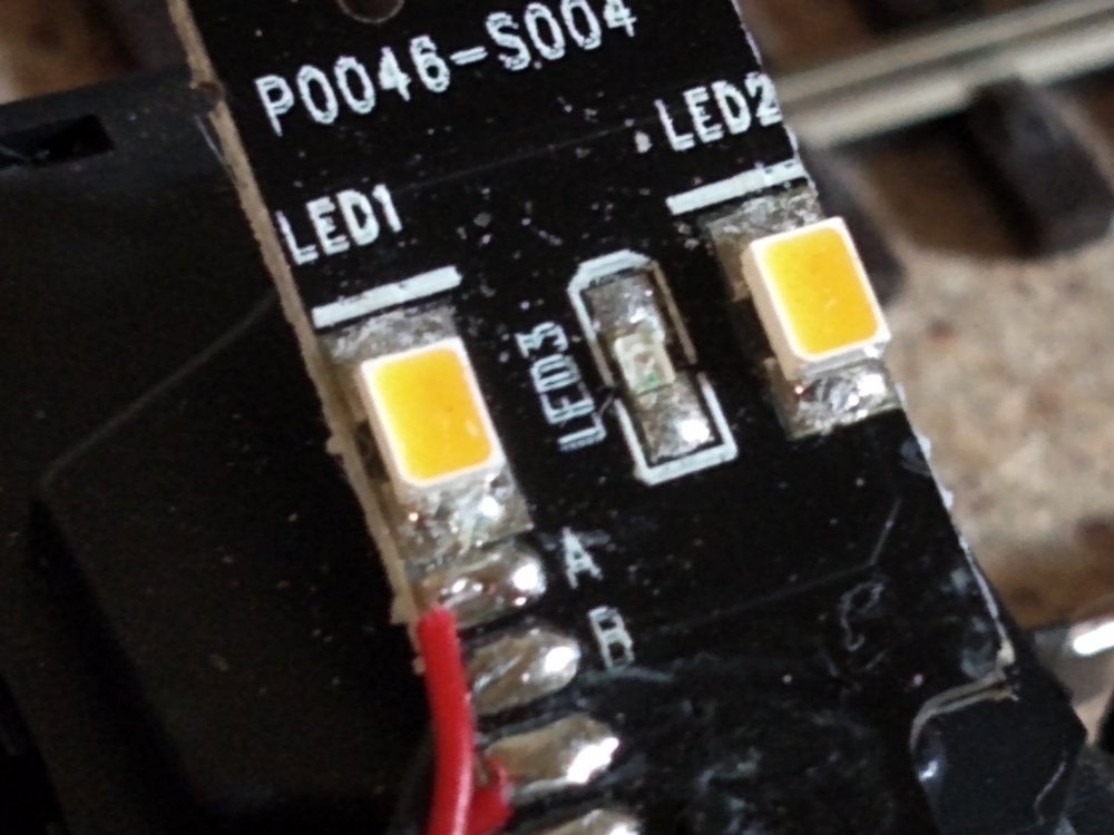

So I took a closer look inside. The LEDs are hardwired together from pins 7 and 8 of the decoder, ie when pin 7 is pulled low, the white marker lights at end A go on while the red marker lights at end B go on.
There is a spdt switch under the loco which allows the path from the red led (led3 according to the silkscreen) to the positive common on the decoder to be interrupted, leaving the red led off.
Helpfully, not, the led silkscreen has the incorrect polarity for those 3 LEDs and it took me a while to figure that out. The cathode chamfer on the larger white LEDs is not visible unless under magnification. I trusted the silkscreen.

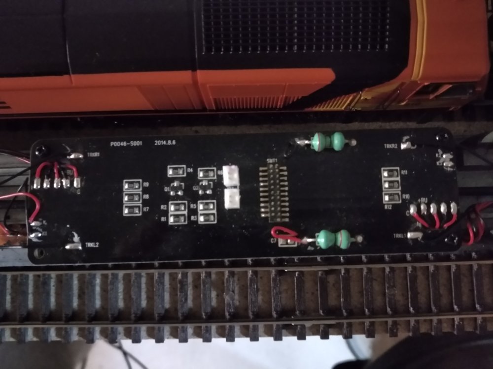

I may as well add some information for anyone interested in the 201 electronics.
The main board accepts a 21 pin MTC decoder.
I suspect the majority of owners will have a Loksound 4 or Lokpilot 4 installed as these are the chips sold by MM. These chips have forward/reverse lights, auxiliary outputs 1 and 2 which are wired to the headlights front and rear on the 201 and auxiliary outputs 3 and 4 which are wired (via a pair of transistors to amplify the output because the decoder output is TTL, very low power. The NEM 660 standard requires this but I suspect it was a fake standard created by the decoder manufacturers to allow them to sell you extra hardware later on to actually use these outputs)
An examination of the main board in conjunction with reading the ESU manual for the v4 revealed:
-all function outputs are open collector type. That means the output is switched to the internal gnd of the chip when active. The "return" path is to a common positive pin (pin 5). This is irrelevant for incandescent bulbs but not so for LEDs for example.
-the outermost groups of 4 wires lead fairly obviously to the 3 LEDs at each end of the loco, red and white marker lights and the headlight.
-the red marker led return path to the common positive of the decoder passes through the aforementioned spdt switch, which simply allows the return path to be interrupted and thus prevent the LEDs from illuminating.
-the two outer pairs of a group of 3 smd resistors on the main board are just the series resistors protecting the aforementioned LEDs from over current.
-the two transistors (marked Q) are used to boost that TTL output from aux 3/4 to a usable level to drive something, in this case they are feeding into the two white headers and in operation on to the cab lights at either end.
This means that all the available aux outputs on a Loksound 4 are exhausted already and without sacrificing one of the existing functions, nothing else can be driven by this decoder.

So I will install a miniature relay and instead of the common return from the red LEDs going through that switch, it will be connected to either side of the n.o. terminals of the relay. The default state for these lights should be off as locos will generally not be running light engine and thus the red marker lights will be off more often than they are on so it's better to have the default state of the relay as not energised.
The relay coil will be driven by aux 5 with return to the common positive of the decoder.  Very simple job but adds a lot IMO. I will do all the soldering on the loco board rather than touch the decoder. The decoder should still be removable.
