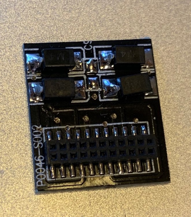

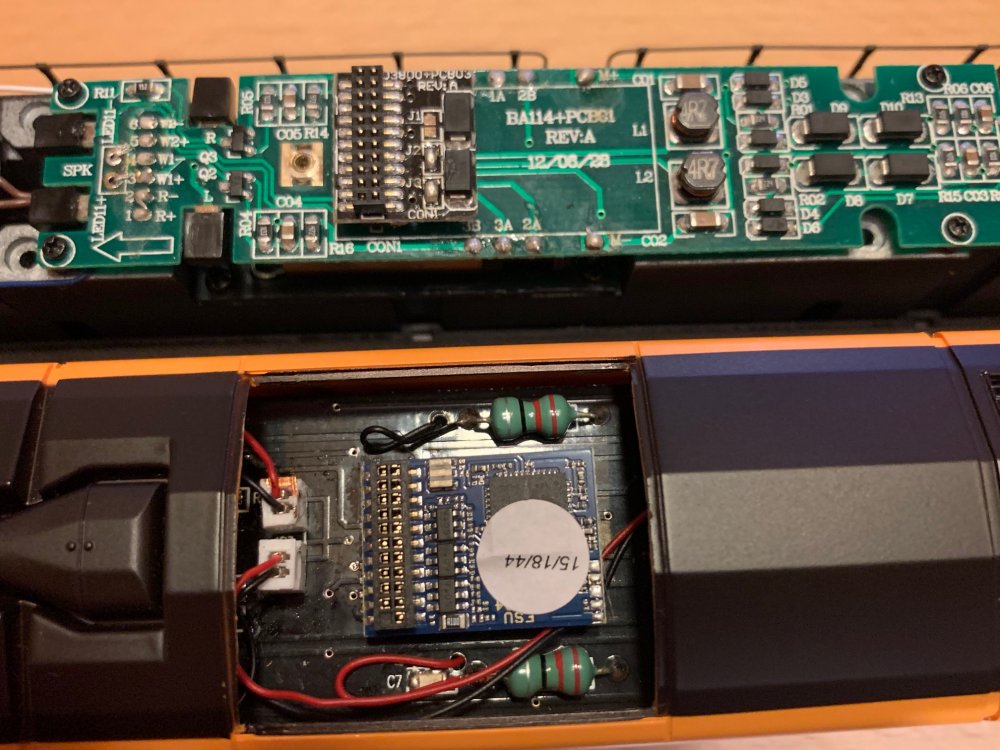

The MM locos are delivered DCC-ready with a blanking unit in to allow running on DC only. Could you have confused this blanking unit for a DCC chip I wonder? Checking each loco's number on the Programming Track in advance of running is good practice - if you can't read the loco number then the DCC system is not happy that all is well and vice versa. If it is not happy on the PT then don't run it on the DCC Main Track until the problem is sorted.
  • 0
58 minutes ago, irishthump said:
Yes that looks like a blanking plate alright.
Was this installed in a loco?
Yup /-)
Apologies to all !
".....Therefore I think one has a LokSound anyway, but they both sound the same. They are both fairly new...."
Duh
The attached picture is  the 071 on the top
and the 201 with the 071 chip in place in the bottom
I guess that the "chip" in the 071 is a Blanking plate again?
  • 0
Yes that's the blanking plate in the 071. At least that's your problem sorted!
