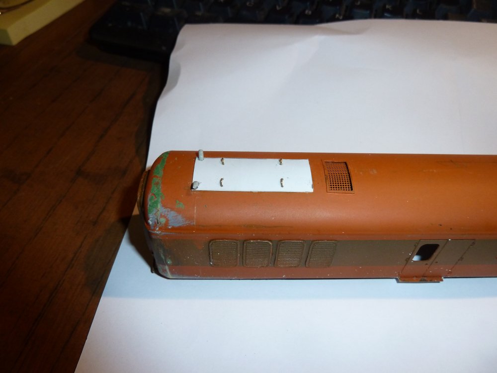

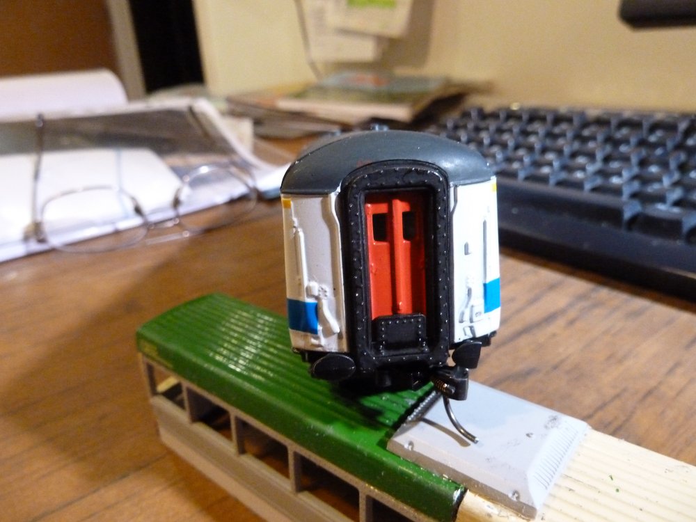

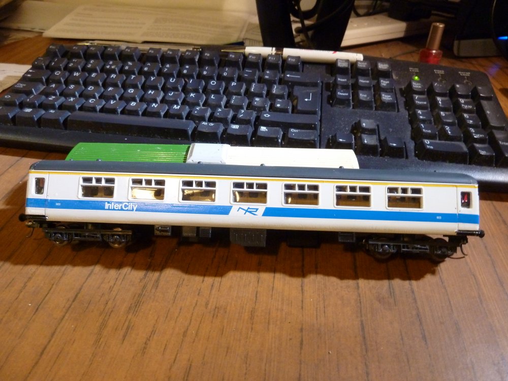

NIR 8911  roof vents, side grills and roof holes  this built up on an older airfix MK 2D  BSO with roof hatch removed, side grills are BR class 37 refurb nose grills chopped about a bit , the round grill is an N gauge class 47 roof etch , long grill has been glued on for a long time and I think was from  A1 models
Model from the ark - yes I have two of them !  MTK brass etch, plasticard roof hatch as etched item was armour plate thick but made a template for roof lift lugs- Mine not totally identical but having seen pic of tortured ones they pass ok. Top air intake had some fine mesh bought a model boat show. The Exhaust elbows exercised the mind and electrons but in end a light bulb moment got me to tomix N gauge sprue  from a lorry. - it had 2.5mm dia sprue with nicely moulded elbows. I also cut and bent out door steps and infilled resulting slots with thinish plasticard from offcuts box - but strong backed with a 30 thou evergreen strip . All that is missing are the roe-vac roof vents - on order from Southern pride models.  Both models to same condition.

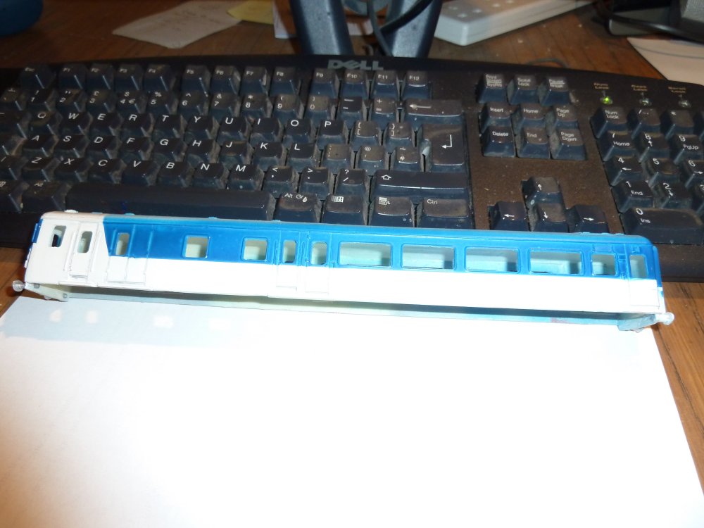

A set of three NIR Mk 2s in various states of experimentation Decals from Darius on the SO - blue no white line on Halfords ford pale grey. The Gen brake is an early model and flawed with a door missing - the haste of youth shell mods over a decade in the making. Painted in precison NIR coach  grey with Railtec Enterprise livery - white edges, available as shown or with coach numbers already added.  The top coach one of the NIR second hand buys ex FK into SO painted in Halford  Audi Ibis white - which is just slightly off white and matches the coaches when photo`ed in bright sun . I think this is easily the best and being an acrylic is easy and safer to apply to the enamels. It might be close enough for bumble bee livery. several rattle cans of blue to try.

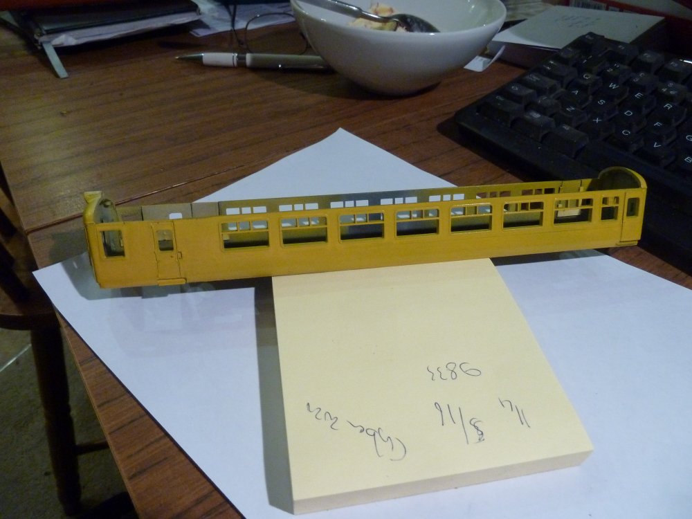

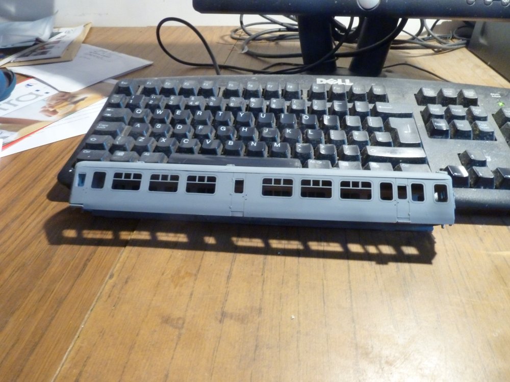

1868875387_Irishcoaches301120023.thumb.jpg.012a22fe42e5d7e79cdcd0131838a41e.jpgAnd finally  a can you guess what it is yet picture - a late yesterday cut and hakcenbash to start of window blanks. The real one is preserved as more than a hint.

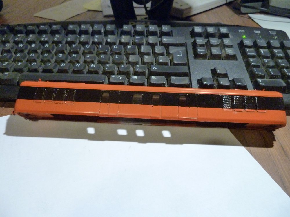

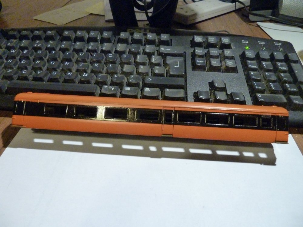

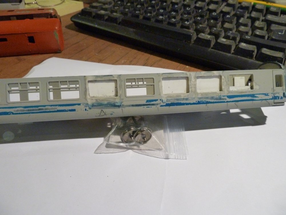

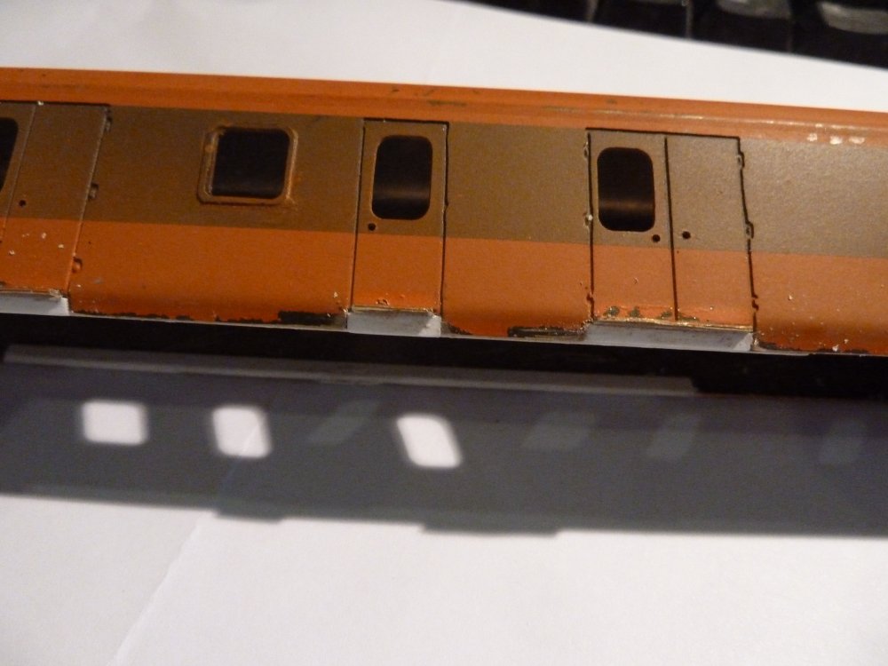

This is 5408 again after makeover no xx! Dealt with etch end gaps - nearly and filled the gutter gap which was very obvious. A primer and orange but on very close inspection the end joins still open up little.
Close up of end of EGV showing tomix exhausts.

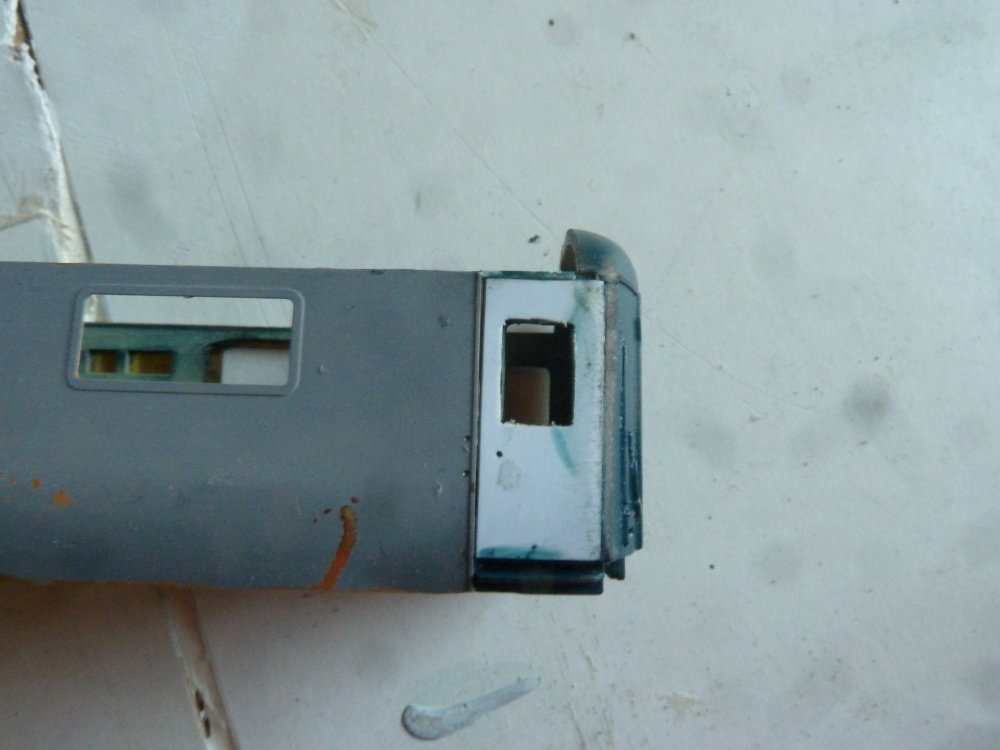

The etch sort of provides for the foot steps - but the end slots only half etched - a few careful dremel cuts and scoring of etch with hook bladed scorer and these folded out, fractionally short but certainly better than nothing. Of course this left a gap in the body shell,  30 thou strong back visible on other side and a bit cut  to fill slot. I was quite pleased with this improvement.  Clearly "kit" had no instructions by this stage - if ever.

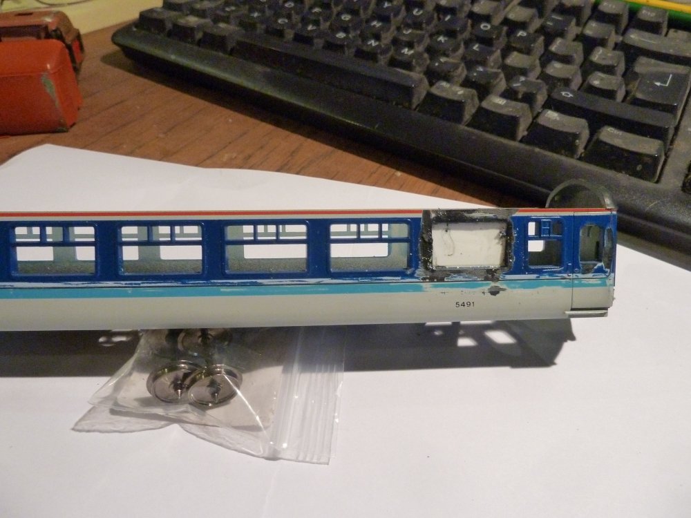

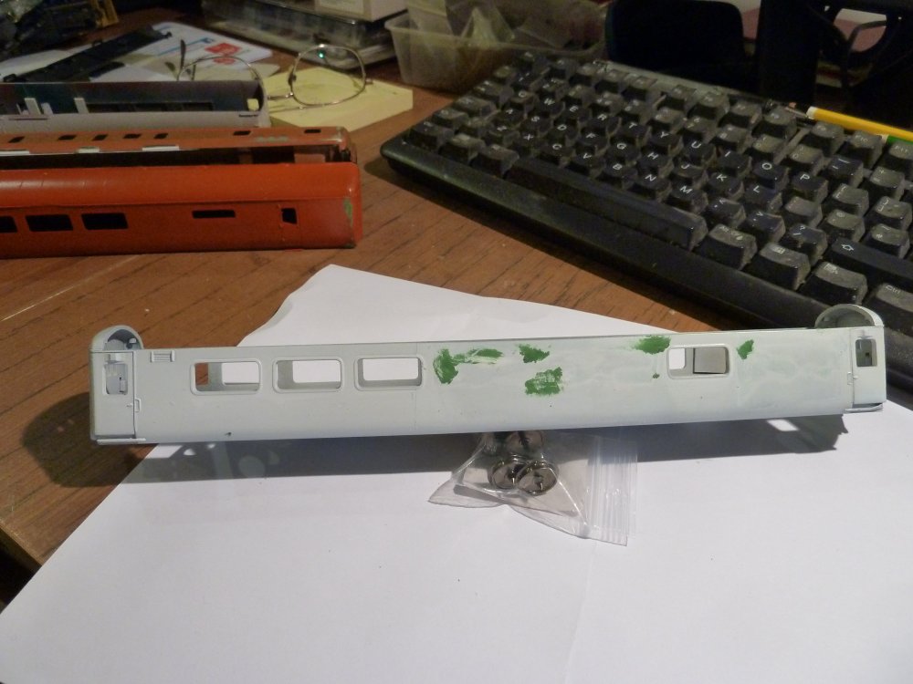

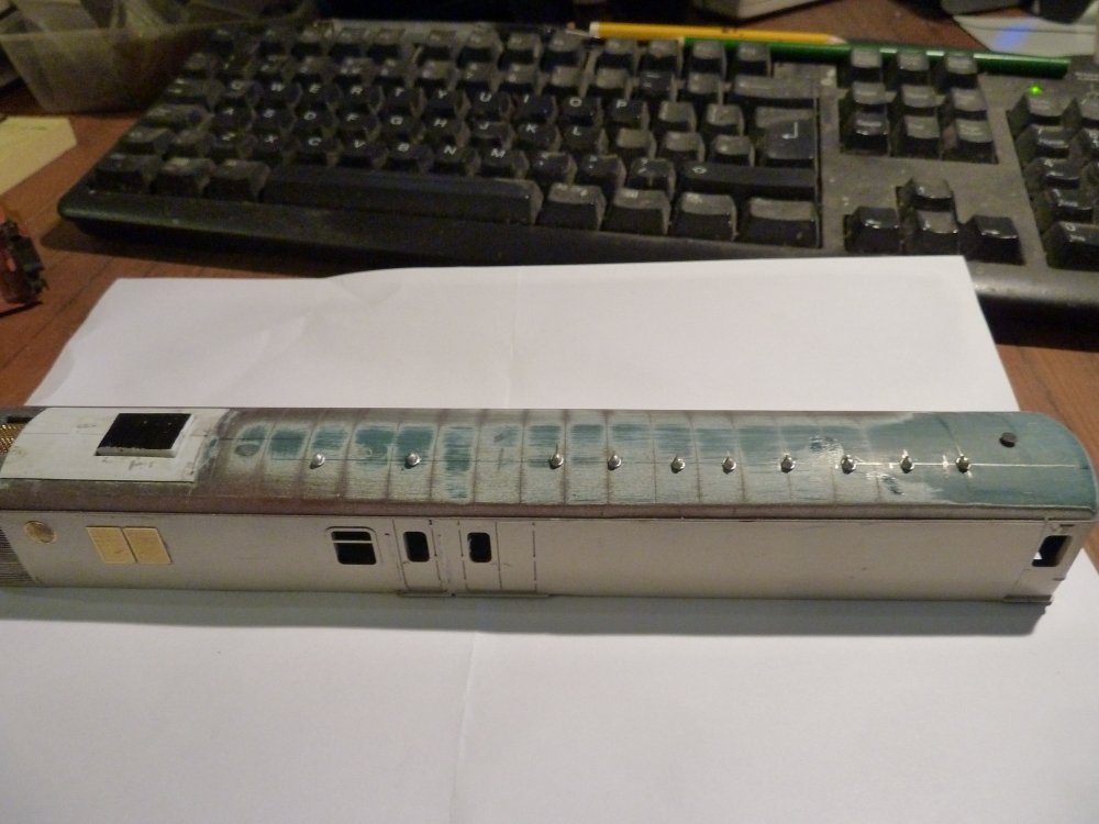

1935534273_Irishcoaches301120021.thumb.jpg.cd524bba70370dcd5fcfed0151331734.jpgRSS1800 in UK money or 546 in the NIR version of the pound!  A Lima Air con MK2D as donor. Windows blanked and filler applied several times hopefully the last as a couple of joins refuse to die! Another old age mod going back three many years! But with annual leave and long weekends of work giving 21 days away from the real one allows quite a bash.

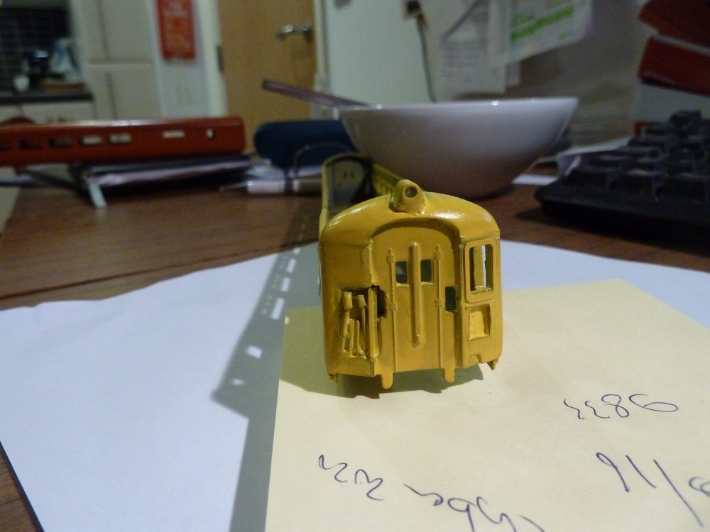

The two steps back one forward this morning, my yellow offering to the 80 gods is the wrong shell it is 752  but this got some differing mods when converted from loco hauled to demu  stock - the passenger door at leading end got BR suburban style small vertical windows - same on BR 310 / 312 stock- which was handy as Southern pride had a end of line brass 310 body set. " Just a case of letting in" a bit of brass into the bodyside !  More later hopefully but morning taken up with more 5408 spraying - happy now and the earlier buffet mods have has primer and second filling sessions.

Airfix, filler and grills, slight touch on left end and ends to sort but much better from 6 years ago.

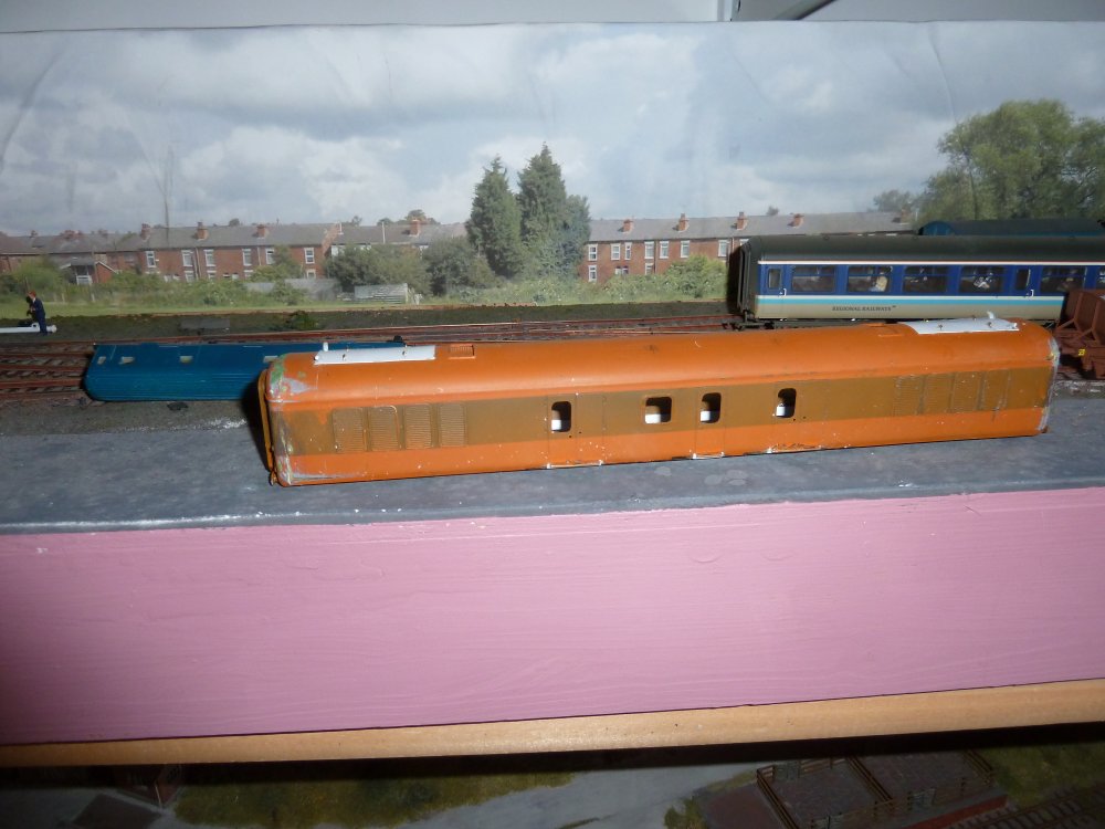

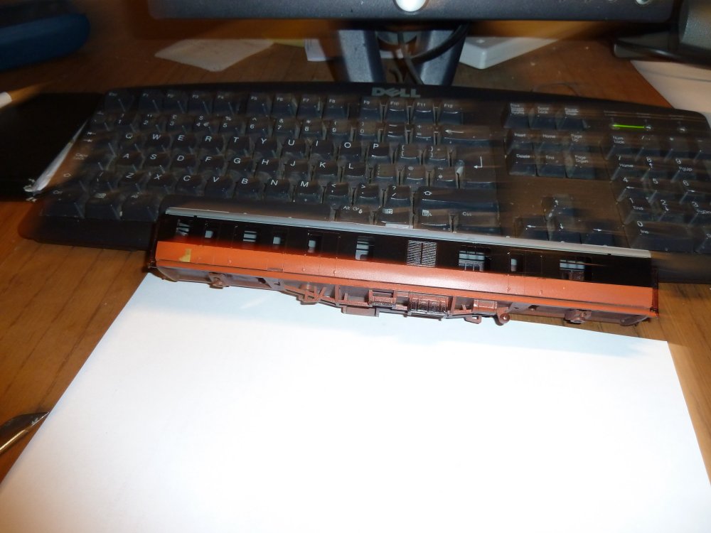

483291810_CIEcoaches081220007.thumb.jpg.4b129d0bfa6467e1c5e52fc375349aba.jpgThis one of the EGV shown earlier The etched grills are over size but now better placed, I will do in the super train livery as it will not emphasise the grills  but black has gone on well. all the bobbly details of hinges and handles to add plus now got some roevac roof vents to glue on - hopefully a bit of exhaust grot will tone down the roof.

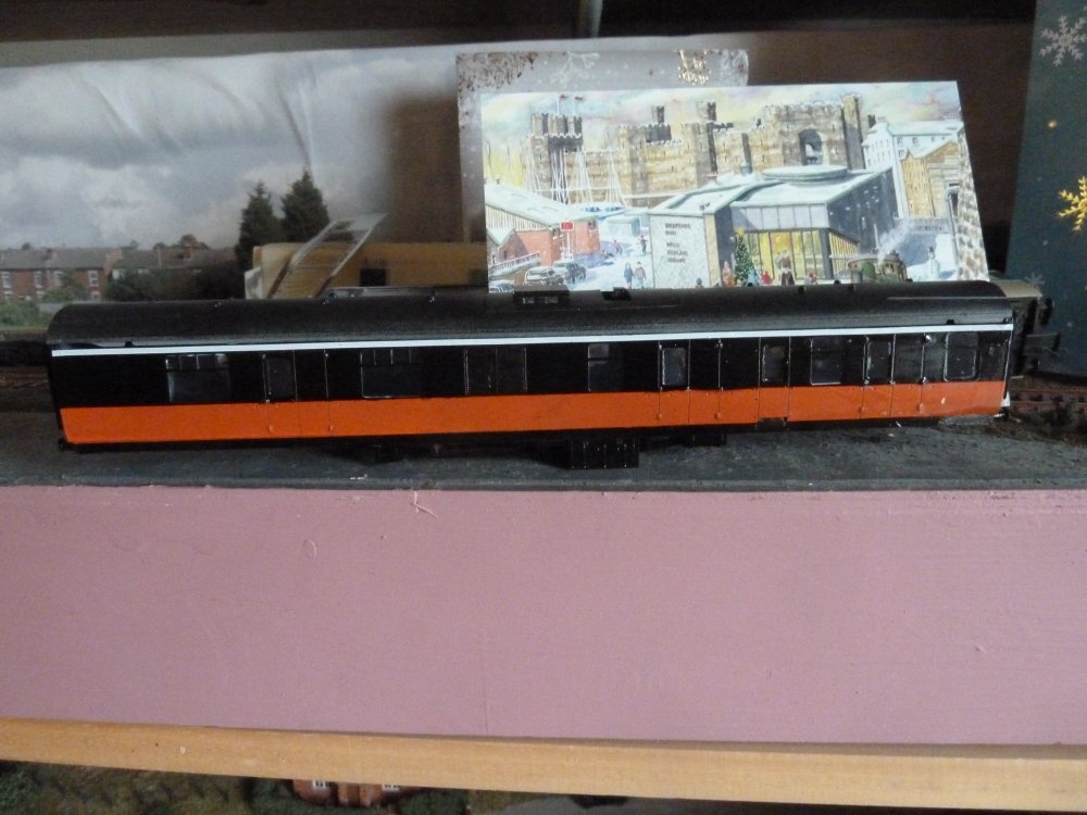

2130741262_CIEcoaches081220012.thumb.jpg.15e42baba8f835fafdeba06c66fb5eb5.jpgA coach that was part done and of course inspired Mr Murphy to bring out rtr version ! This too has sat in a box for donkeys years but got a flashover of orange rattle a few days back and black gloss from airbrush after lunch today.  Based on two airfix coaches and will benefit from correct roof vent positons and wheels ! but no rush is there.

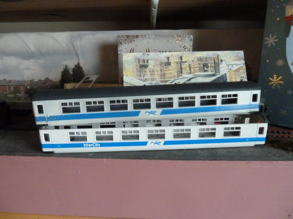

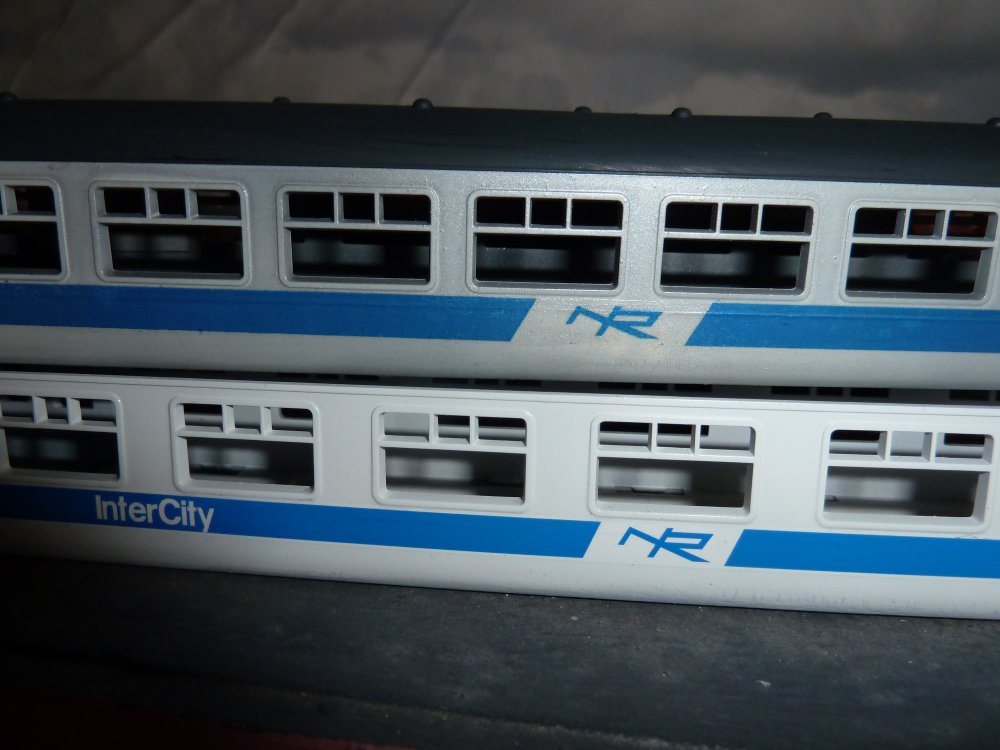

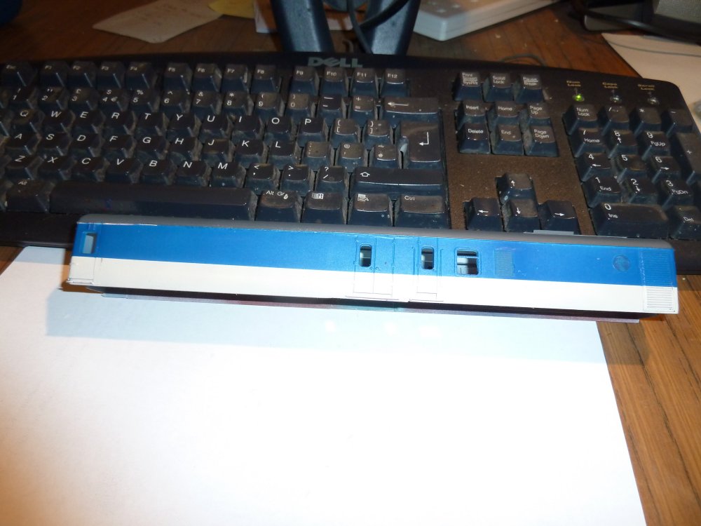

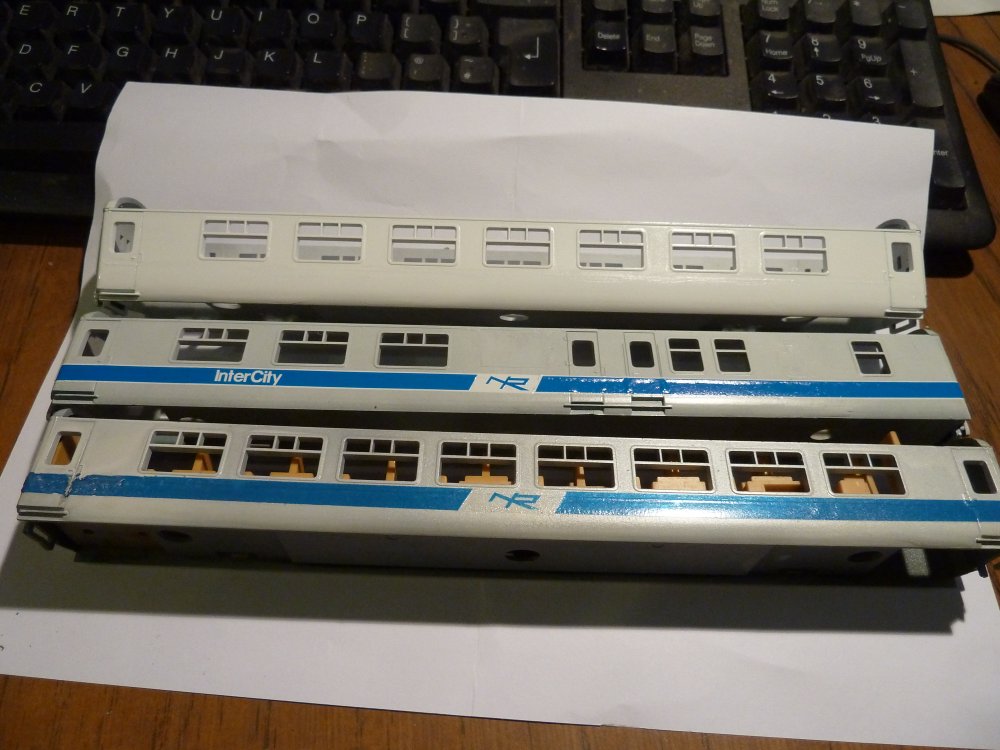

Update 16/12 - got some transfers on .  The Mk 1 got white stripes and glazed oneside. The two NIR coaches are the blue stripe and stripe with white edges - the Blue stripe is on MIR tinlet of NIR grey and the blue/white is on audi Ibis white which reflect images in research in books and web - open to comments.
1657208316_Irishmodels161220014.thumb.jpg.9a060cf46071d3c897da2448d3ed157d.jpg Top blue stripe decals a big thanks to Darius, test application as you can see Lima rib not fully removed and lower from Steve at Railtec.

NIR 903, glazed with the vacc formed Eastern finecast units - not totally convinced so any body got contacts for getting lazer cut ones?
The ends- a small conundrum. I have seen a pic of 547  nee M1800 with black ends in the Intercity stripe livery - I guess a hang over from BR import. Did the other coaches follow suit ?  The Lima detail in ends stops getting a flush fit transfer - loads of microsol and it is only average - I can scrape off end details of course and add hadnrails - you know proper modelling but being the impatient soul I was wondering if the black paint brush would give a work around. Needless to say even searching "Belfast CSD" in flikr has only found later timeframe pics , coach searches show lovely train shots but not enough to say 903 got black ends.

For the end blue stripe I cut the decal off at the door edge/handrail, matched up some blue paint and hand painted the blue. I then applied white edges using white lining of a suitable width, which then covered the edge of the brush painted blue. Much easier to apply narrow white stripes than the full width transfer.
Yes Where I was going  but then spotted 547s black end which seemed  a godsend!

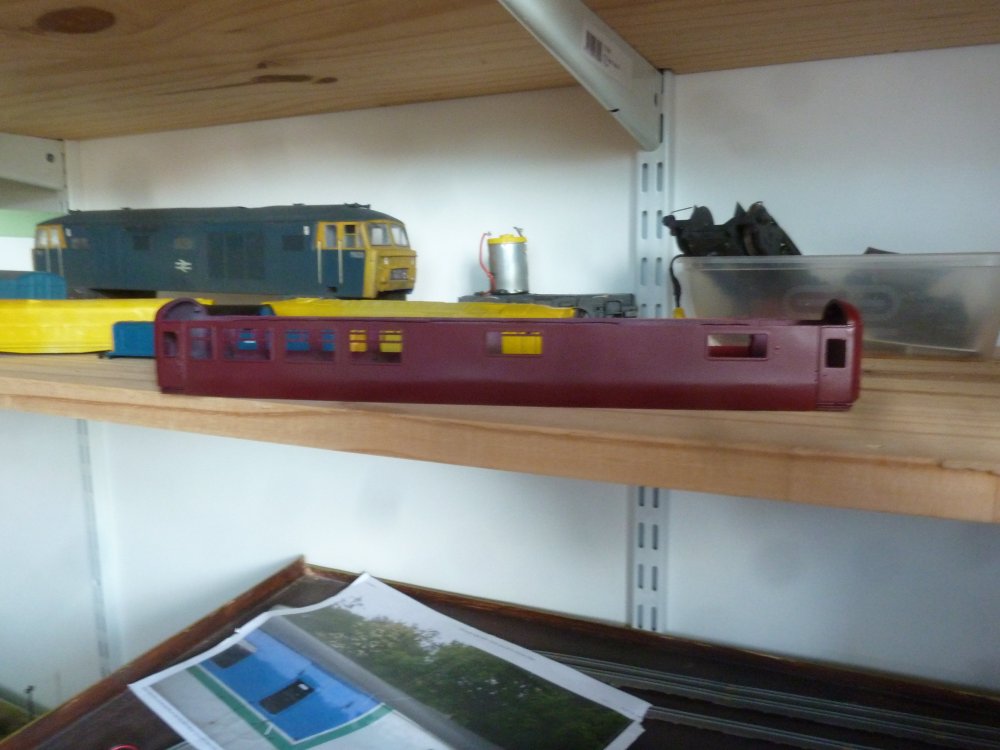

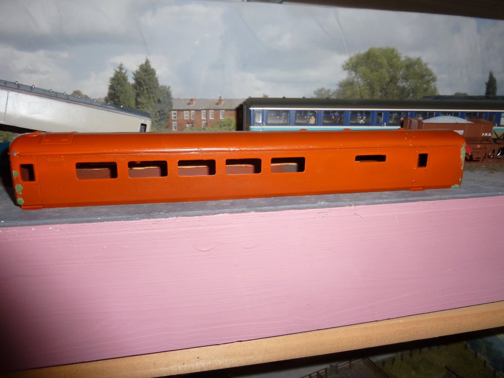

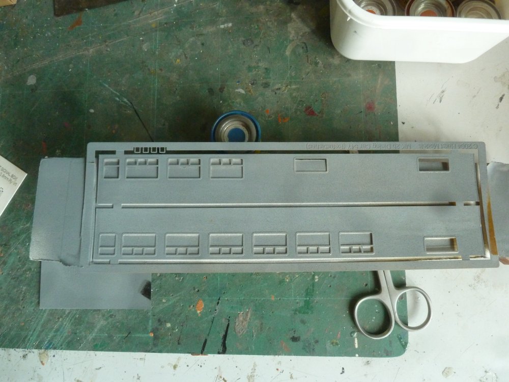

I will have to take some pics tomorrow of progress on the coaches but could not resist starting another - an old MIR etched NIR buffet car 547, I know the good boys in the bunker have one well on its way but to spur on the 101s and the original livery this lima based coach will be in the first enterprise livery and go with 4 others I bought from the web, I also need to do a DBSO  and number all the coaches.  Day off tomorrow so might get a bit more done on 547 to make worth taking a pic.
Robert

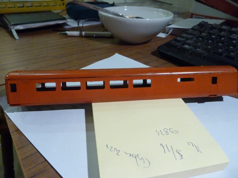

 Hurst etch primed  vehicle 547
10thou overlay on lima door end to match overlay holes drilled for grab and door handle- to be fitted later .
To help the 80 class project first build DTS in primer - been sort of on its way for 2 years just needed some filler sanding back.
547 in NIR maroon , the Hymek not moved for a while.
