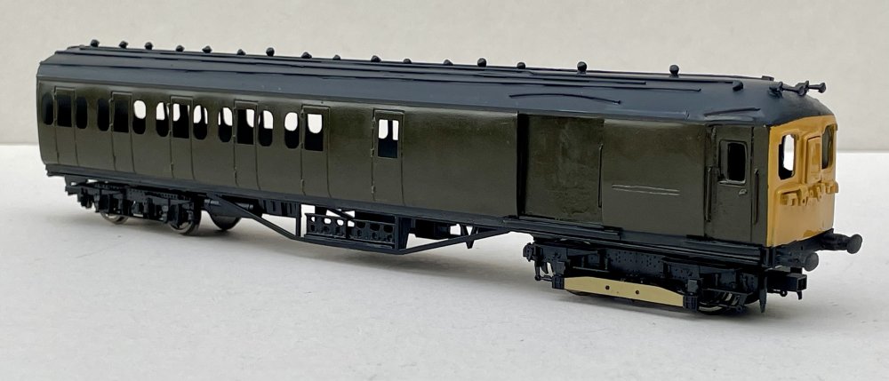

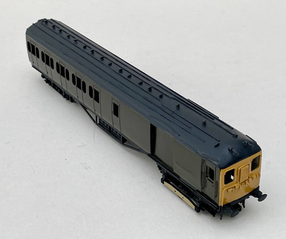

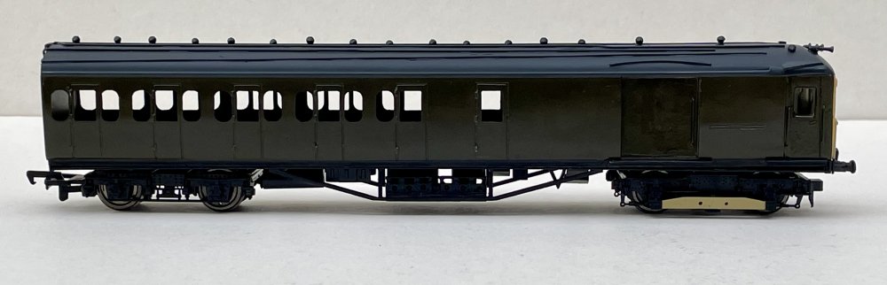

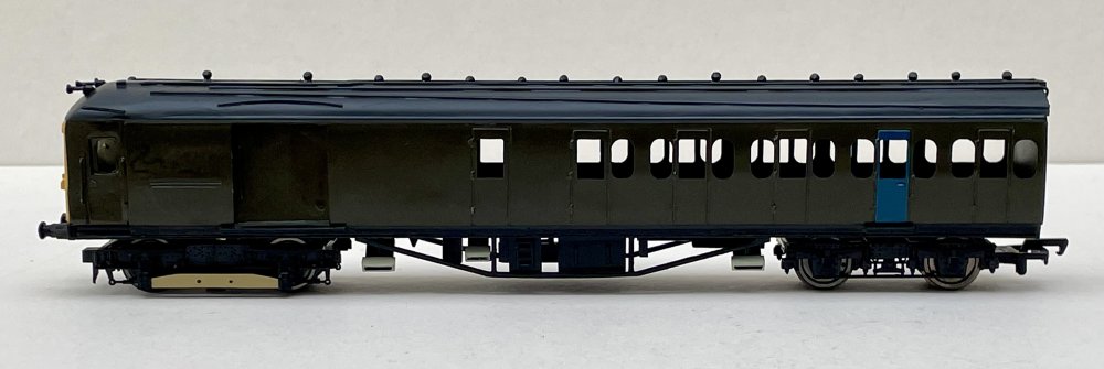

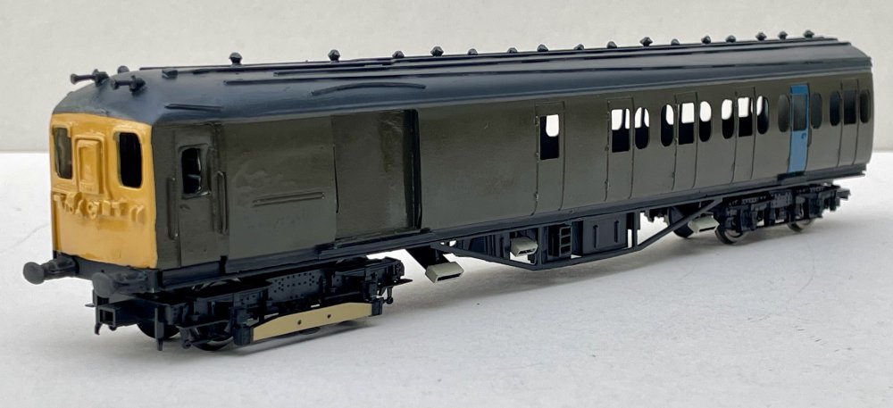

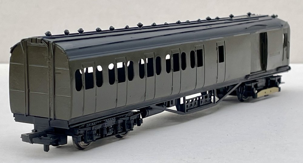

  5. Silver Fox models B Class started. Hornby Railroad Class 55 chassis (as recommended by Silver Fox) modified to fit. I had to thin* the inside faces of the Silver Fix resin body with a Dremel so that the chassis would actually fit. The tablet catcher recesses below the cabside windows were a bit shallow so I drilled out the lower parts and re-made them using plasticard sheet. I cut away the Deltic bogie sides and glued in place the Silver Fox replacements. I sanded* the rear faces of the replacement sides to provide a decent surface for glueing. I glued strips of plasticard to the inside faces of the resin body to act as chassis supports. Body fitted to chassis - it’s an interference fit at the moment. Next tasks are further cleaning of the body and scratch building the tanks that sit between the bogies - the Silver fox ones aren’t that good. Cheers Darius * I always wear a respirator when sanding resin and keep it on until all the resin dust has been cleaned up.

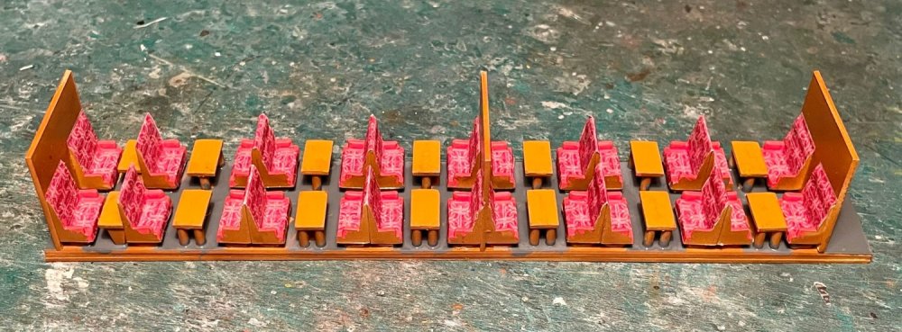

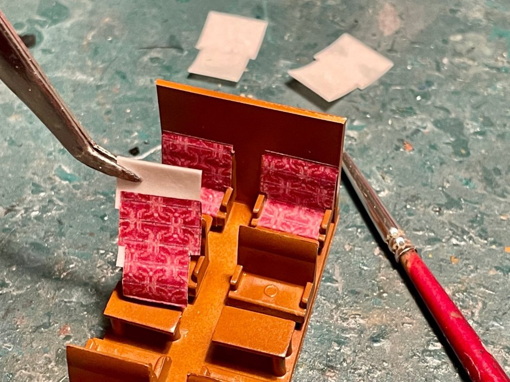

  7. Obtained an unboxed Hornby Class 101 centre coach from eBay in blue/grey livery. I detached the coach body from the chassis and removed the interior. The window glazing was carefully removed and the body masked for painting into Regional Railways livery. The first class logos were removed from the window glazing using the end of a cocktail stick dipped in white spirit. The wooden cocktail stick is abrasive enough to remove the painted on sign but soft enough not to scratch the clear plastic. Fox Transfers lining decals applied and glazing re-fitted. Coach interior upholstered and gangways fitted. Light weathering of chassis to finish. Cheers Darius

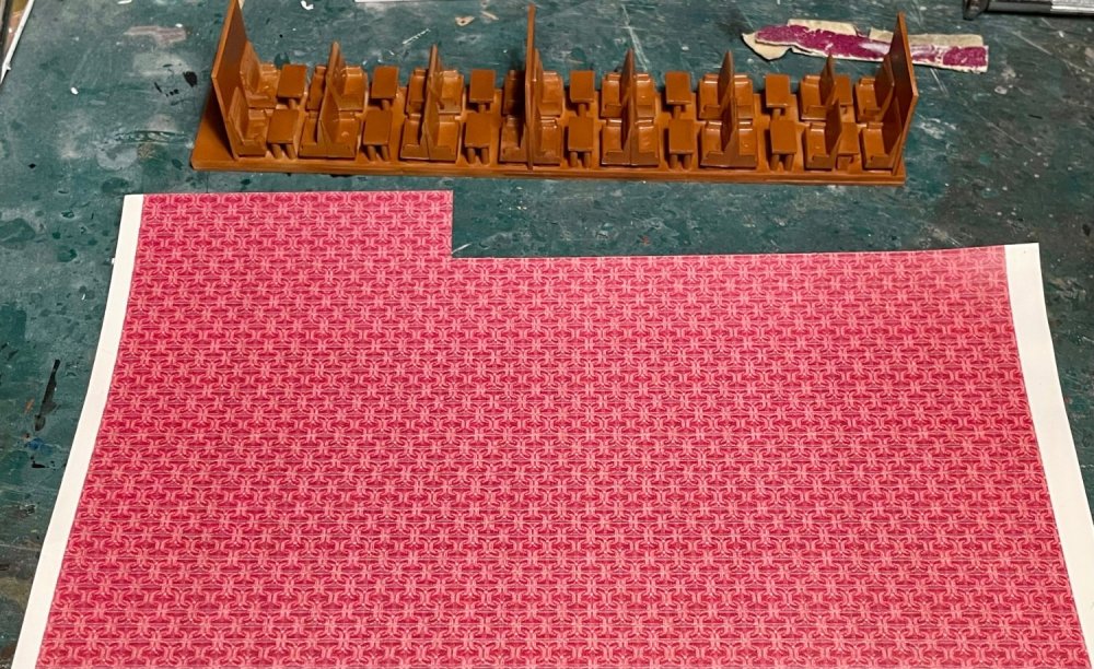

  18. I picked up this second hand Lima Class 101. Someone had done a reasonable job of detailing and weathering the chassis but more can be done. First off the Lima pizza cutter wheels on the trailer coach were replaced with better wheels. The interior had the floor painted grey. I repainted the floor and painted the seats and partitions before applying home made upholstery decals. This was followed by peops and a driver. The body was then given a clean and re-fitted. The plan is to replace the pancake motor bogie and trailing bogie of the with more recent Hornby DMU examples. Cheers Darius
