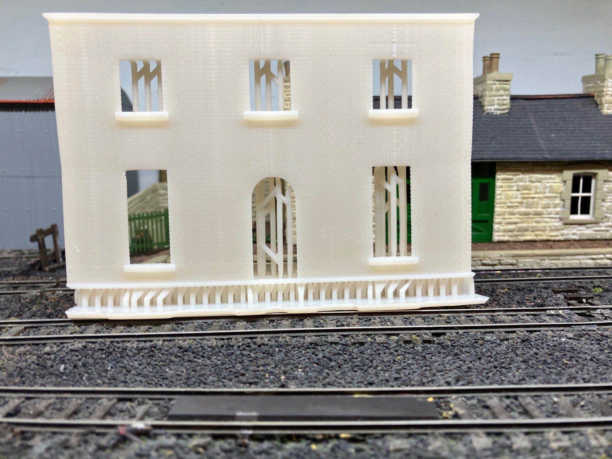

The Dublin Port layout reserrected in a different in OO about 10 years later with some of the buildings in 3D printed form.
Windows/doorway placed temporarily in the openings to check fit before carrying out final (hopefully) adjustments to the 3D model & print set up. While brick coarsing, opening, cill, lintol and parapet lines came out well some 'interesting' distortion along the party wall between adjacent buildings & de-lamination between layers in one corner (joy of resin printing) Some tweaks to the model (digital reinforcing) to reduce distrotion and delamination resulted in some improvement to the building on the right!
The pitched roofs & chimneys on this terrace  are hidden behind a low parapet when viewed from street level!

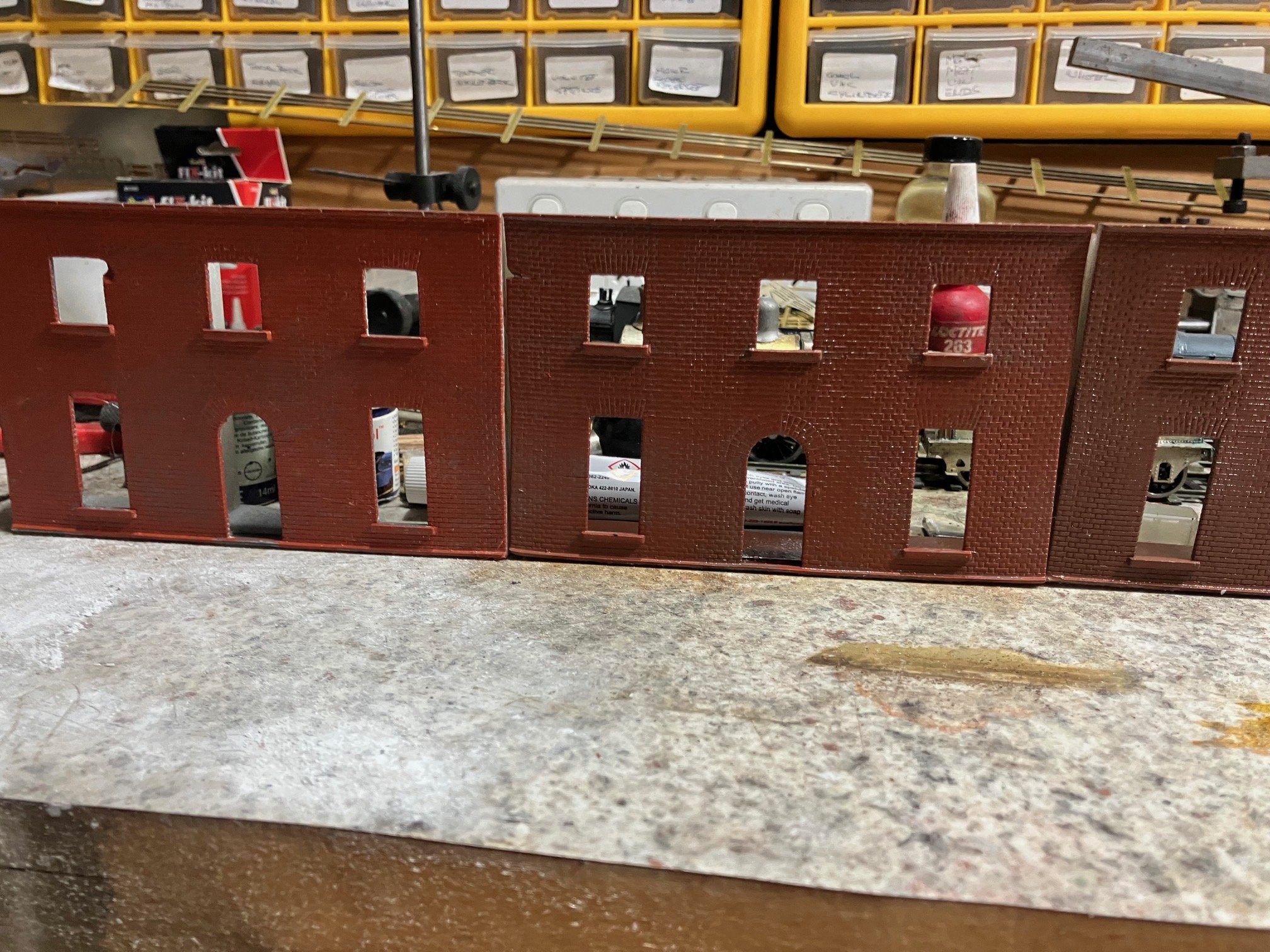

Three usable facades glued together after some fettling to the construction joints with a large mill file! Now ro read up on Iain Rice's advice on painting brick buildings, but may go for more of an overall effect as mortar joints and difference in colour/shade between individual bricks unlikely to be noticeable in background/same for maltings building.

Mixture of physical and digital modelling. Preparing some of the building in the terrace for painting/weathering.
I have glued the three building on the right together primed and sprayed with brown aerosol (my version of CIE brown wagon paint) and filled & touched up unsightly joints in the party walls.
Brickwork joints in the building on the left flooded with a cream paint to represent the mortar joints and brickwork overpainted with a shade selected from a photo of the prototype and a paint colour chart. I used a colour chart and matchpot from Resene a New Zealand owned paint & decor company.
The buildings on the right and left were overpainted with the same colour one on a grey the other on a brown base, I've forgotten which is which and managed to 'disappear" the two test pots I bought yesterday😵‍💫

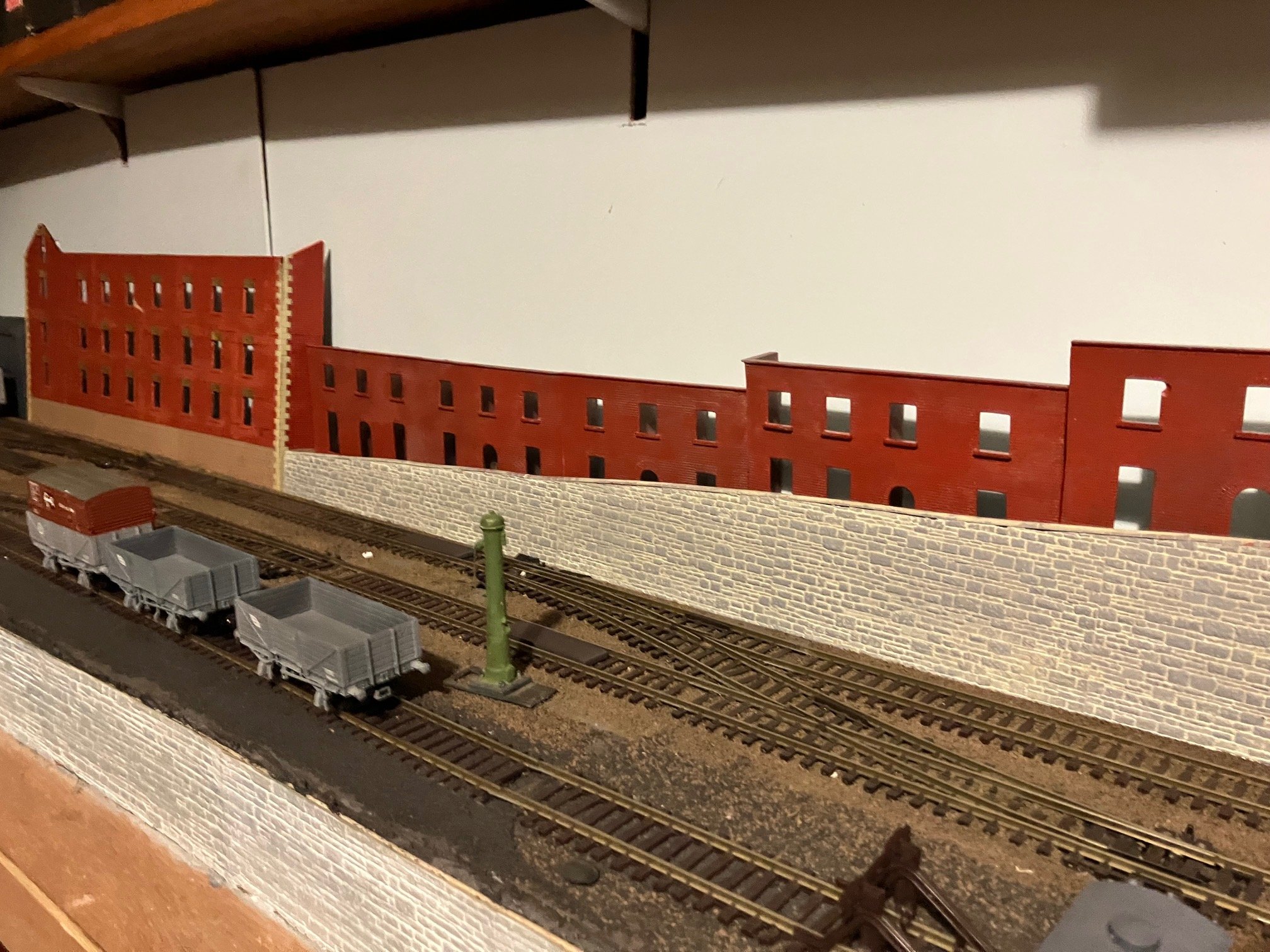

Trial fitting of the terrace after painting the brickwork. Facade was first sprayed with etch primer and brown aerosol I had in stock, brush painted with a Humbrol grey acrylic working paint into mortar joints wiping surplus paint off face of wall with kitchen towels, and stippled/drybrushed face of brickwork with a 'matchpot' acrylic selected from a local 'home improvement' store. I selected a 'near match" between a Google Earth image of the building & paint colour charts.
General view of terrace from railway/dock, buildings from Google Earth views of Sackville Gardens, Ballybough-Drumcondra depending on whether your a buyer/renting ot selling/landlord. Building on right is a temporary while printing the permanent one 🙂.

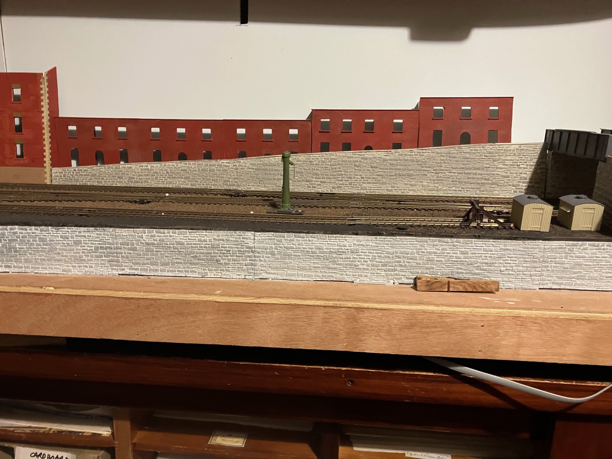

The retaining walls are Wills Coursed Stone, the wall in the background painted/finished more than 10 years ago using similar techniques with the last of my stock of ( American) Floquil modelling paint. Water crane is a fairly ancient (early-mid 80s)n Mikes Models casting fairly close to a MGWR crane, Mike once produced a large range of water cranes and other steam era castings.
 The 'view from the bridge' so to speak looking towards the maltings based on the former distillery at Grand Canal Dock with its distinctive stone and brickwork, the yellowish brickwork of the distillery buildings should make an interesting contrast with the redbrick terrace.
 Looking back towards the road bridge and Tower Building, I am planning to add another low relief house between bridge and backscene and add the water tank/parapet to the tower building. I originally to form the tank sides/parapet in etched brass when I started the building around 2012, but probably simpler to produce a 3D printed model these days.

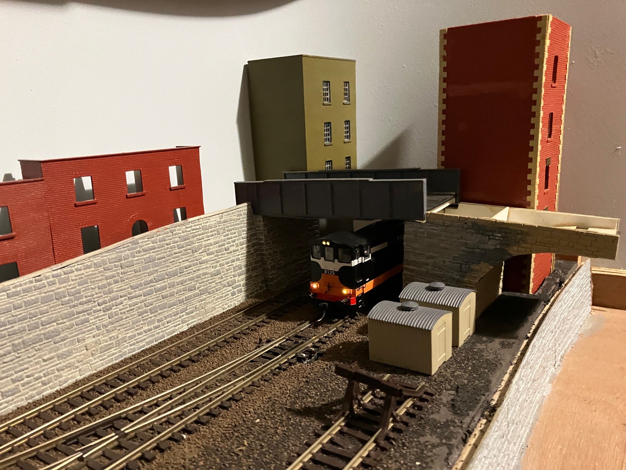

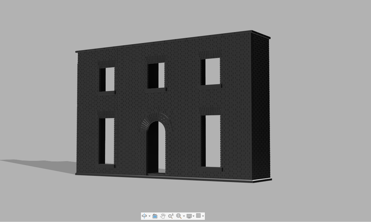

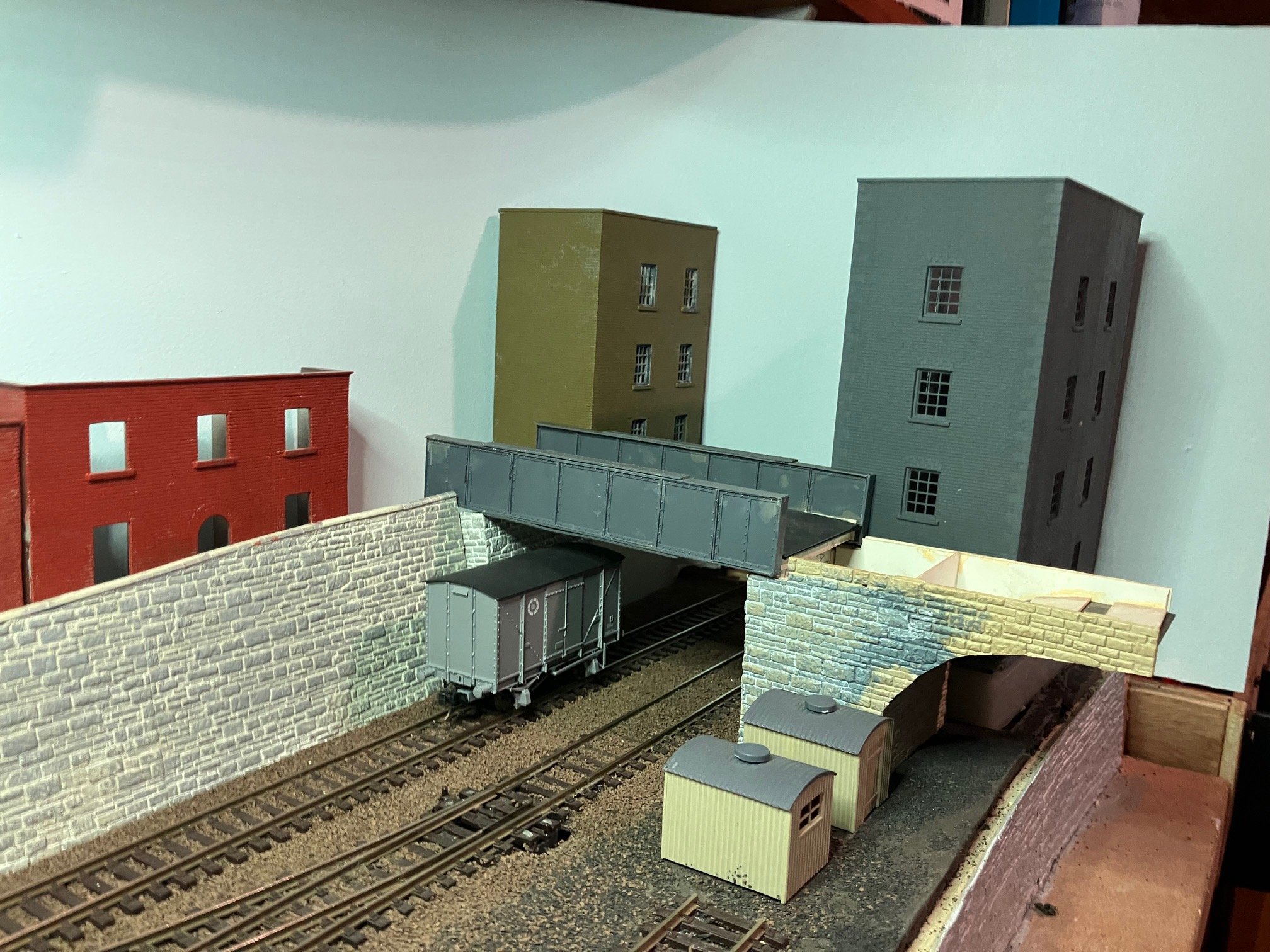

Re-thought the building between the overbridge and backscene on the fiddle yard approach and decided on a semi-low relief malthouse to balance the Tower Building rather than a pub!

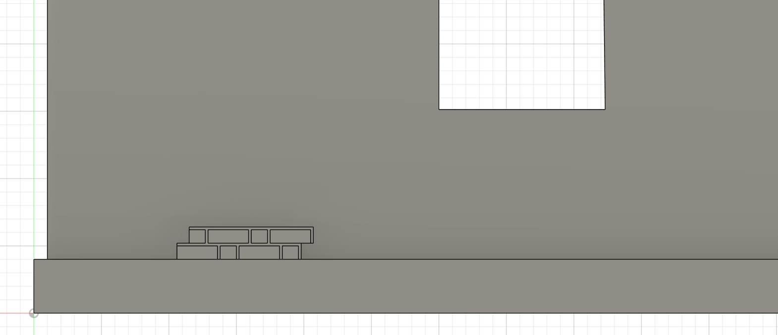

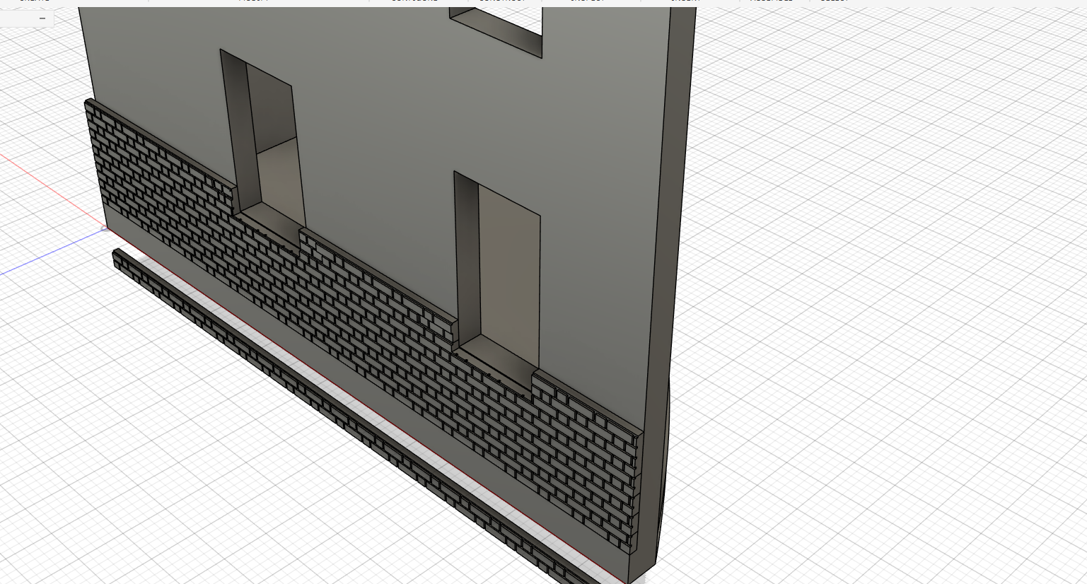

Progress after 2 evening (approx 4hrs total) with Fusion, cills and lintols to be added and decide on how I will form the windows, Wills parts or 3D printed.
Section below street level will be modellerd using Wills Coarsed Stone sheets.

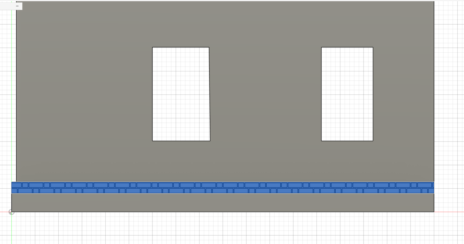

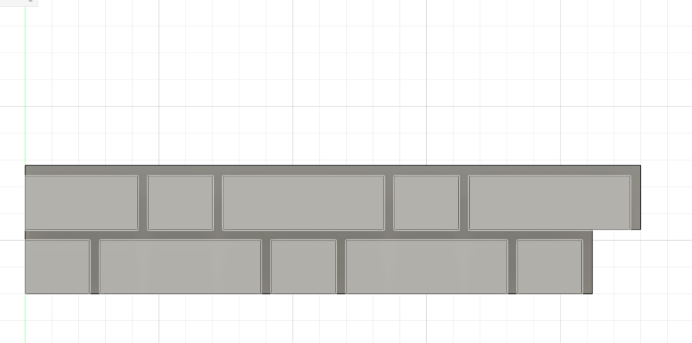

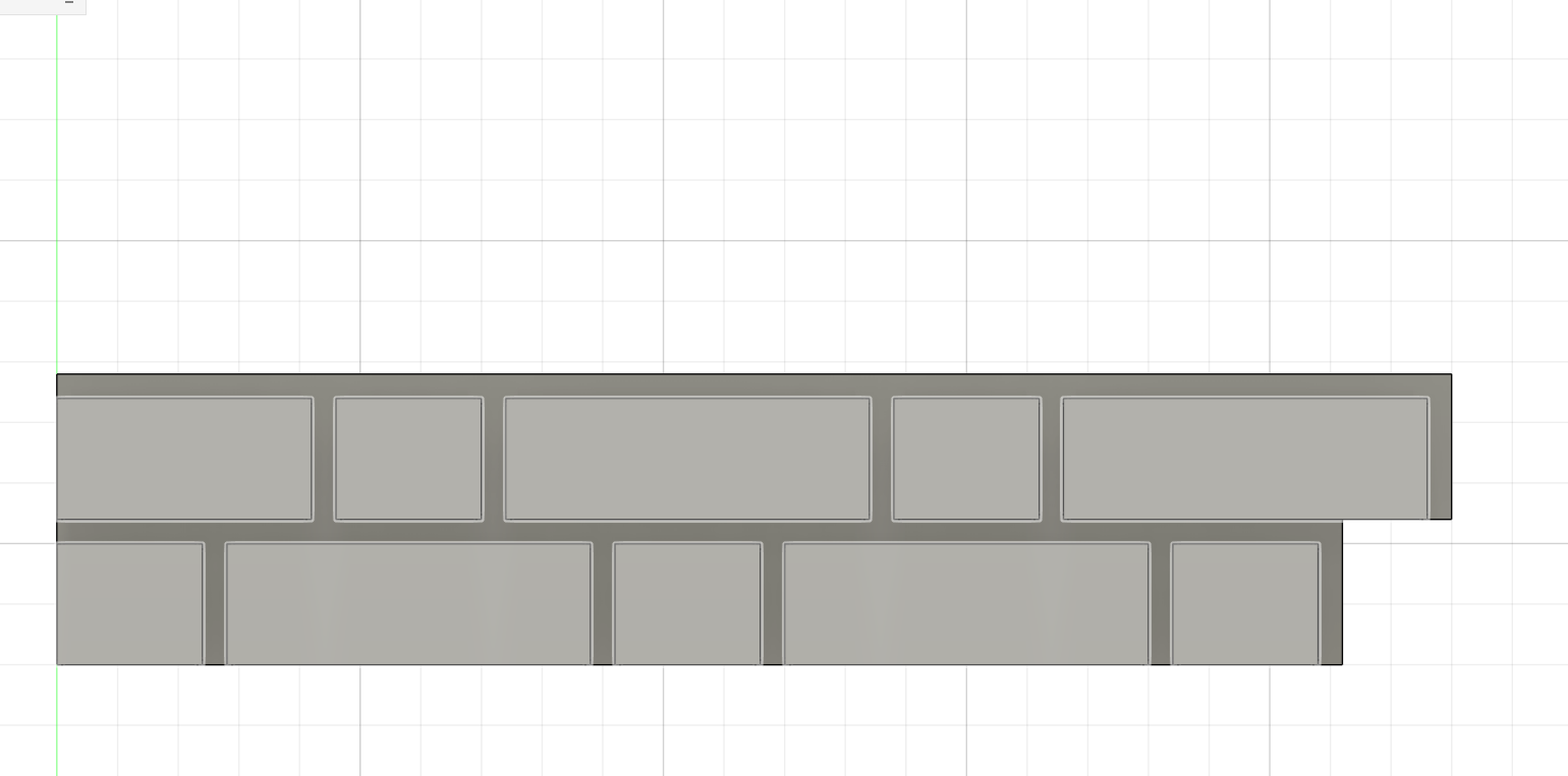

I first produced a 3D model of the basic structure complete with window opes before adding the brickwork not unlike a building with in-situ or pre-cast concrete walls & brick cladding (without the cavity)
Set out from one corner to get the header-stretcher-header pattern on the first course-then 3/4 stretcher (King Closer)-header-stretcher on the second coarse. (wall & base hidden in view
Then added header-stretcher-header-stretcher-header for the second brickwork module then, copu and paste for the rest of the 1st two courses!
Individual modules now combined and selected for copying.
Progress to cill height and window opes set out. Coarse template beneath ready for copying.

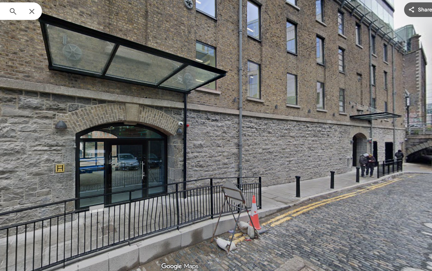

Distillery buildings at Grand Canal Dock the inspiration for the models. In its orignal form the Tower Building in the background was a landmark 'signature structure' in photos of Grand Canal Shed and the approaches to Westland Row, Pearse Station.

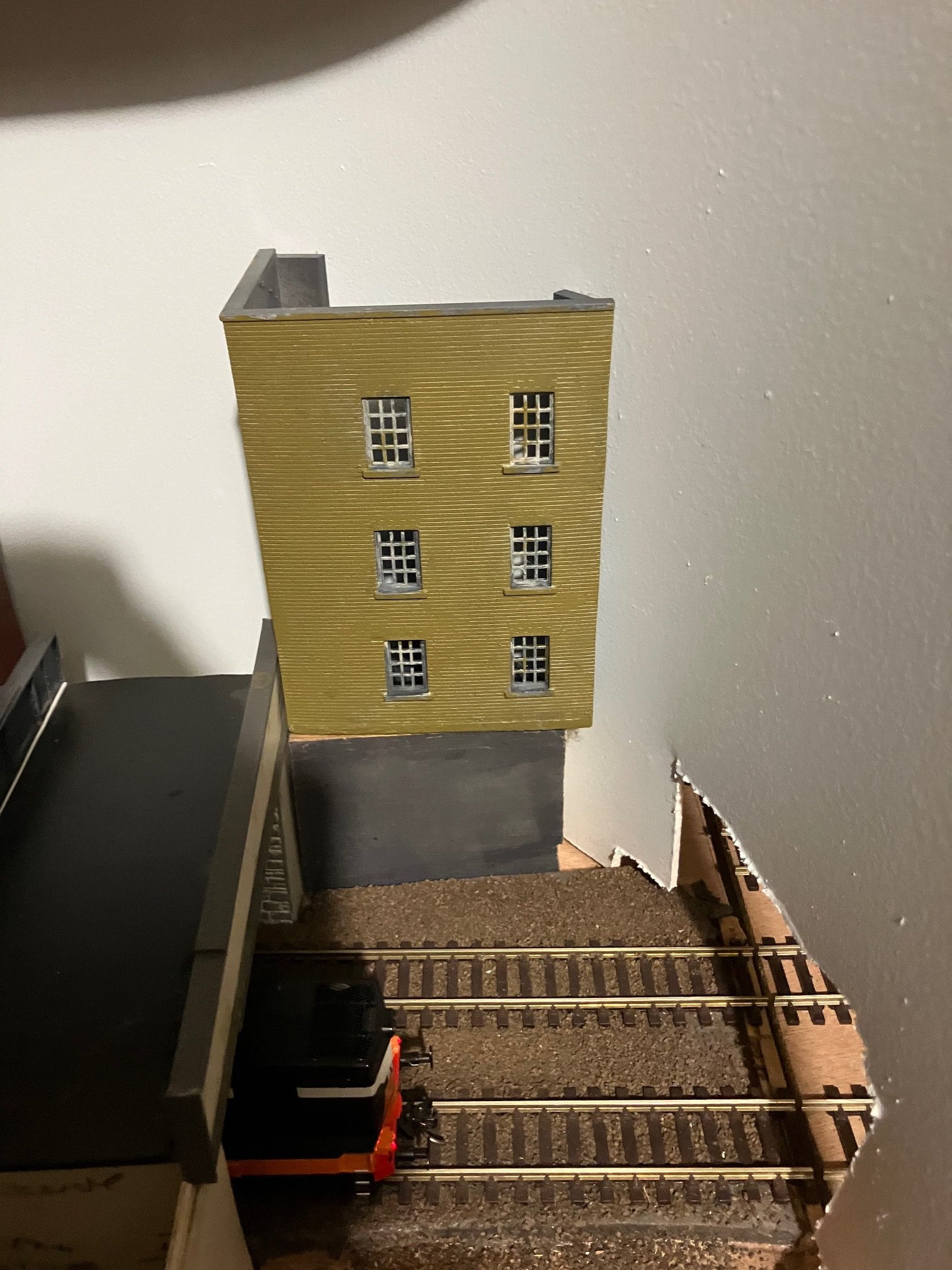

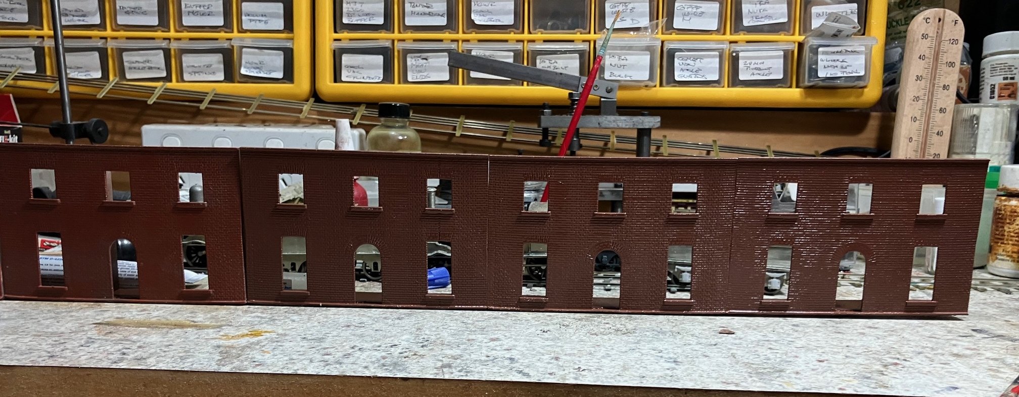

Another evenings work cills, lintols and windows added, some minor adjustments before printing, meanwhile the shell of the large malthouse I started 14 years ago had a coat of spray primer, now to fill and sand the worst of the joints between the Wills brick material sheet panels before painting.
Printed and positioned the Malt House to check how it would work visually.
Again initial coat of paint from a paint/DIY store match pot.  Quite pleased with the print quality & the way the windws worked out.
I'll probably end up replacing the 'Tower Building' with a similar 3D printed building that extends to the backscene to give the impression that the maltings are part of a larger complex.

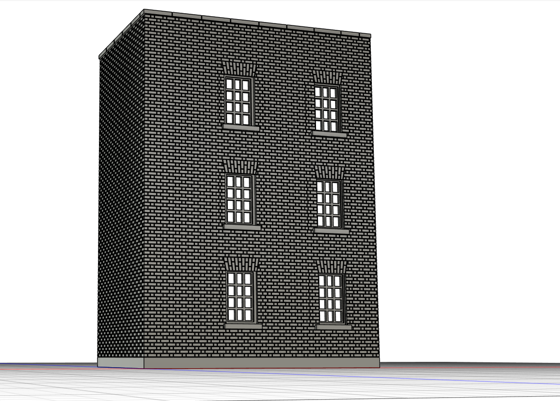

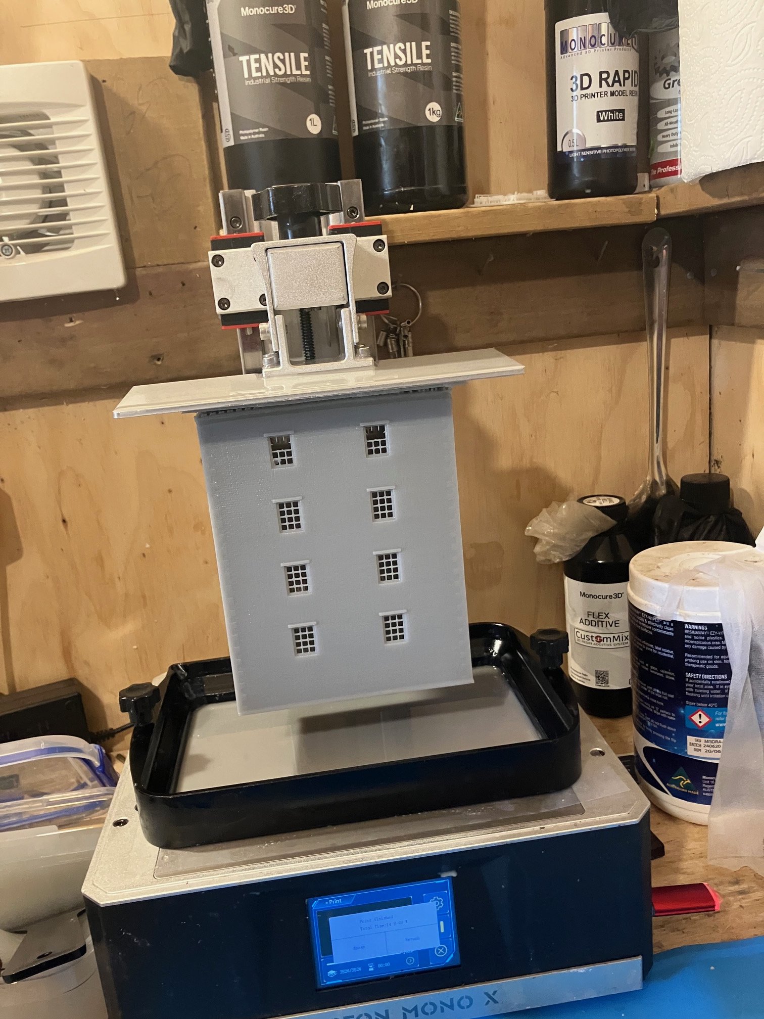

The Tower Building or my interpretation of the building ready for printing after several eveings work. Estimated print time 8hrs on my Photon Mono X!
NZ is going through a cold snap at the moment with -0 night time temperatures, switched on the print room heater this morning to raise temp.  to 24+c for the print job.
Brickwork only modelled on the two elevations visible on the layout, will be using Wills 'Coarsed Stone" to model stonework at groundfloor level mainly to match stonework in quayside and retaining walls, also may computer/internet connection struggling in handling the sheer amount of data!  Computer theoretically upgradable to Windows 10, but would need to upgrade graphics card or buyt a gaming computer! Oh for the days of Superquick and Faller brickpaper and cardboard buildings.
The building was part of a complex built by the Guinness family at Grand Canal Dock in 1859 for storing/malting barley, now incorporated into a prestigious ofice, residential and retail complex.
I got to add a water tank to the roof and a lattice footbridge link to the Malthouse in the background

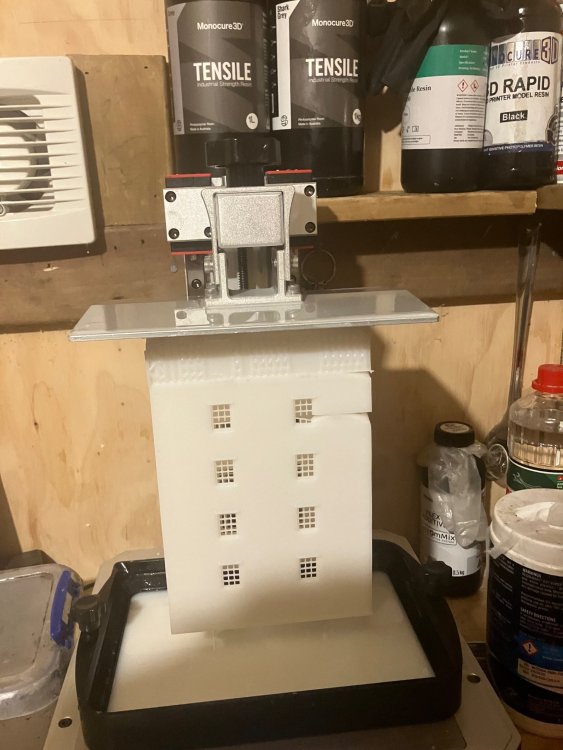

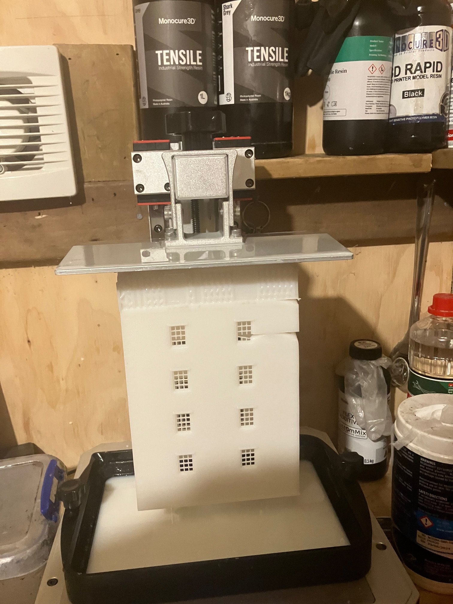

Tower Building print (10hrs!). I had hoped to salvage the print using model filler and scribing as de-lamination had only affected one corner and print quality was otherwise good! Filler has shown up some misalignment in area of de-lamination.
Possibly re-print to 2nd floor level, then re-check alignment, before committing to a total re-print!
  • WOW! 2
  • 3 weeks later...
Not much physical modelling since the last post. I overdid things doing some maintenance work on the house and had to rest up for the last couple of weeks.
I ended up doing a re-print of the upper levels Tower Building with reduced  Lift & Retract speeds, took longer(14½ Hrs) but eliminated the majority of faults with the earlier print. The Tower Building is printed in a Tensile 'engineering resin" having exhausted the local supply of 'eSun' water washable resin I normally use for buildings.  One of the challenges with 3D printing is sourcing relevant printing guidelines as resin manufacturers continually upgrade change their products. Although bought in 2025 the manufacturer since upgraded their Tensile and other resins and technical information on the earlier verisons no longer accessible on manufacturers web site.
Tower Building after 14½ hrs ready for removal from the build plate and start the washing & curing processes. Some distortion on the initial layers and one row of glazing bars did not print but otherwise good.
At this stage I had decided to print the stonework base section as a separate print to the brickwork upper levels
The original idea was to print the stonework integral with the base as no of the available stonework sheets are strictly correct for the 'coarsed random rubble' stonework commonly used in Irish industrial and railway buildings. In the end I decided to use Wills 'Coarsed' or possibly "Dressed' stonework to match the material used on other buildings and structures on the layout.
I am satisfied with the base print, for the print I trialled Lychee slicing software, in the hope of overcoming some of the print quality issues experienced with the slicing software supplied with the printer in 2021. Printer is incompitable with the current version of Anycubic slicing software.
Probabably re-print the base section with the original software using same/similar settings to the upper section of the Tower.

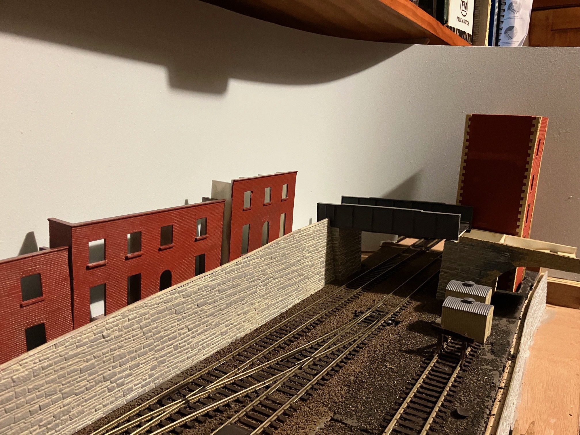

Now getting to the stage of finishing the overbridge modelling the roadway and parapets and figuring out how to support the end of the backscene.
Turned out that I only have enough etched windows and doors for one house in the terrace, so I'll probabably update the drawing/artwork to complete the entire terrace, etched lintols no longer needed following the shift from conventional to 3D modelling.

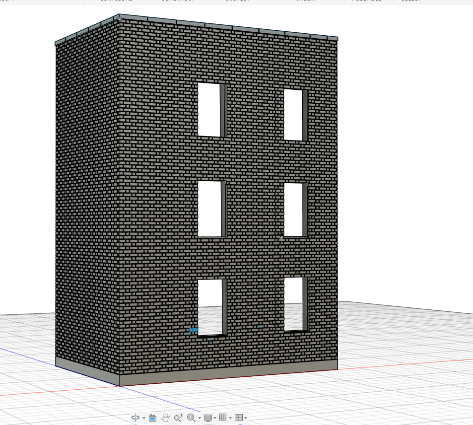

Digitally (3D) modelling brickwork can be very theraputic almost the current day equivalent of the practice of modelling brick work with individual "punched card" bricks or "computer chads" once poplarised for fince scale modelling.

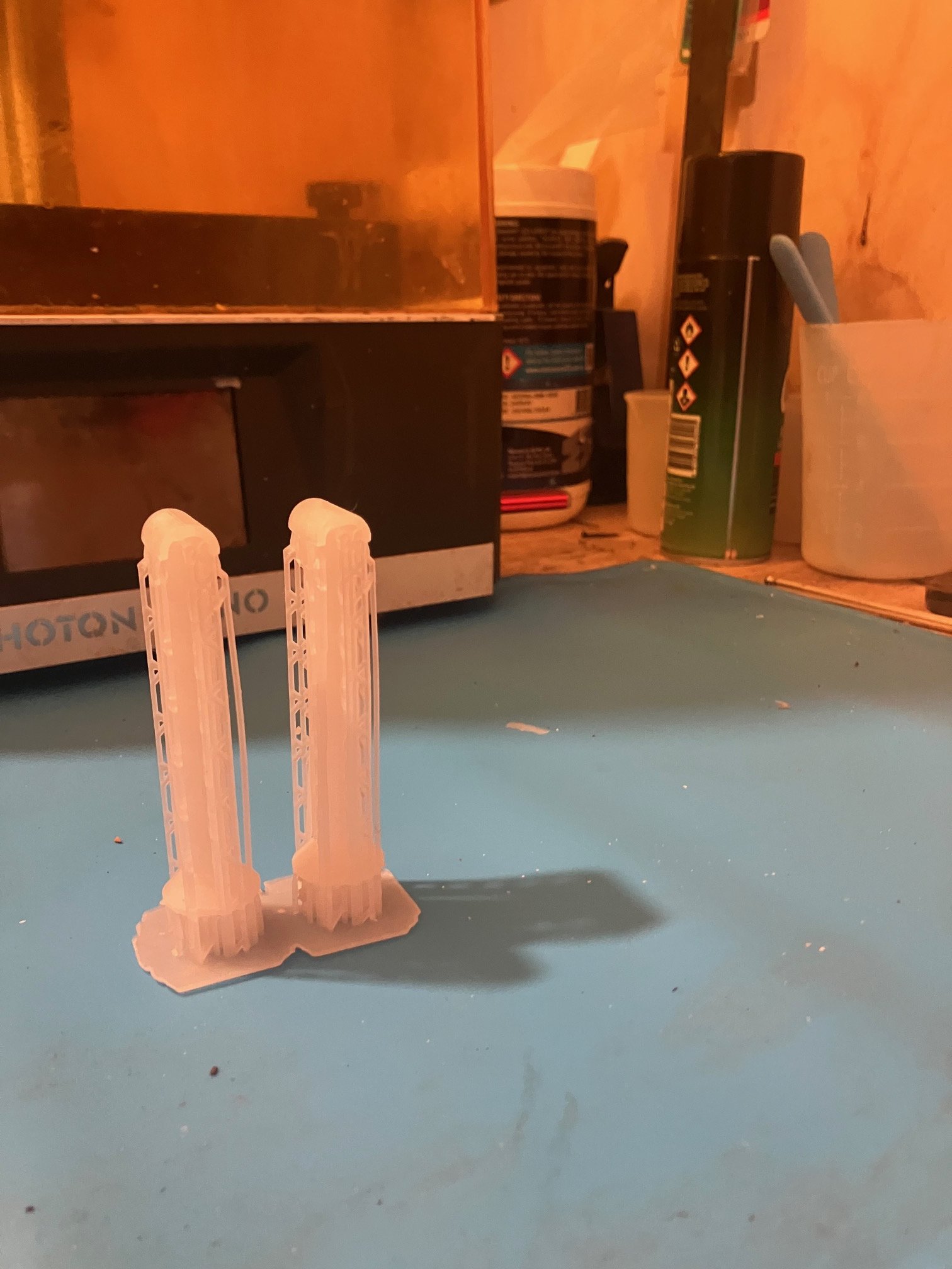

Caboose smoke stacks with supports.

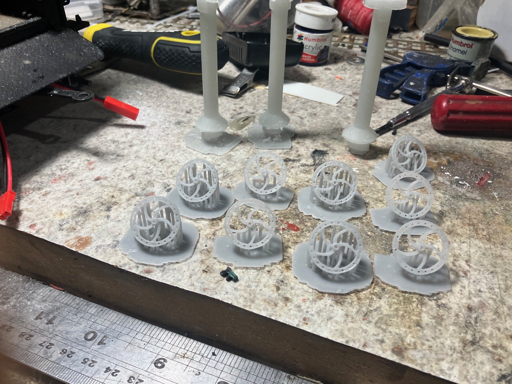

These had been a vunerable item with two 'missing in action" on the Garden Railway during the last couple of years, a vertical print in Tensile resin two as direct replacements with one as a spare.
Selection of smokestacks with supports removed and handbrake wheels printed at 45° which helps minimise print failure/distortion during printing.

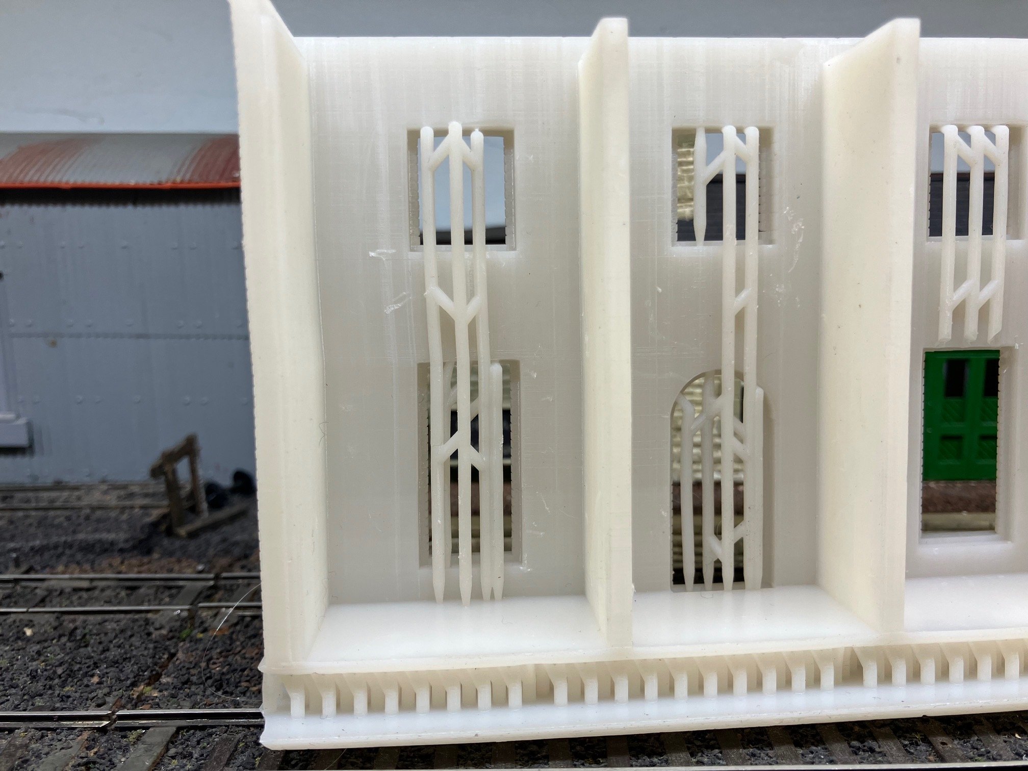

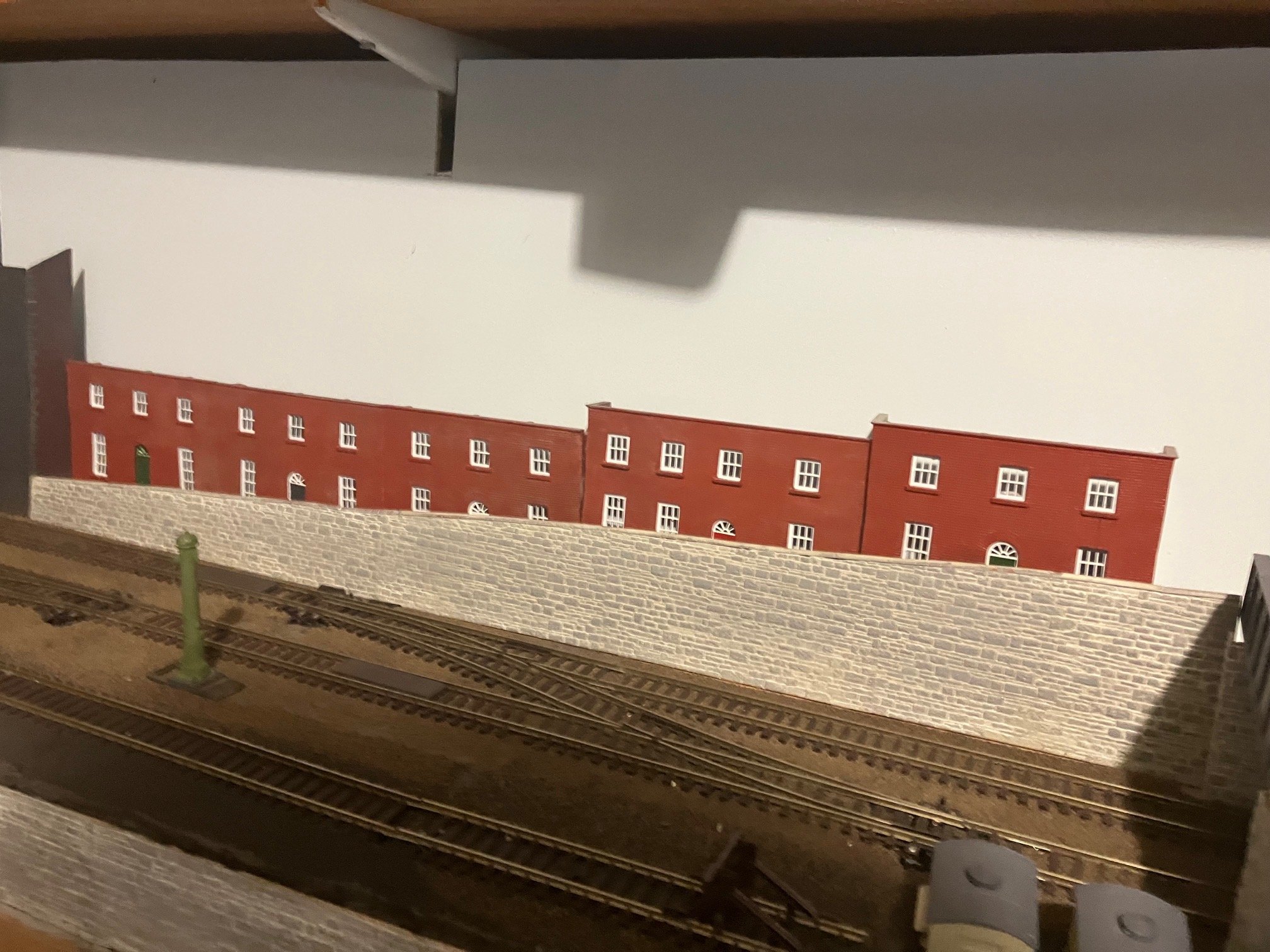

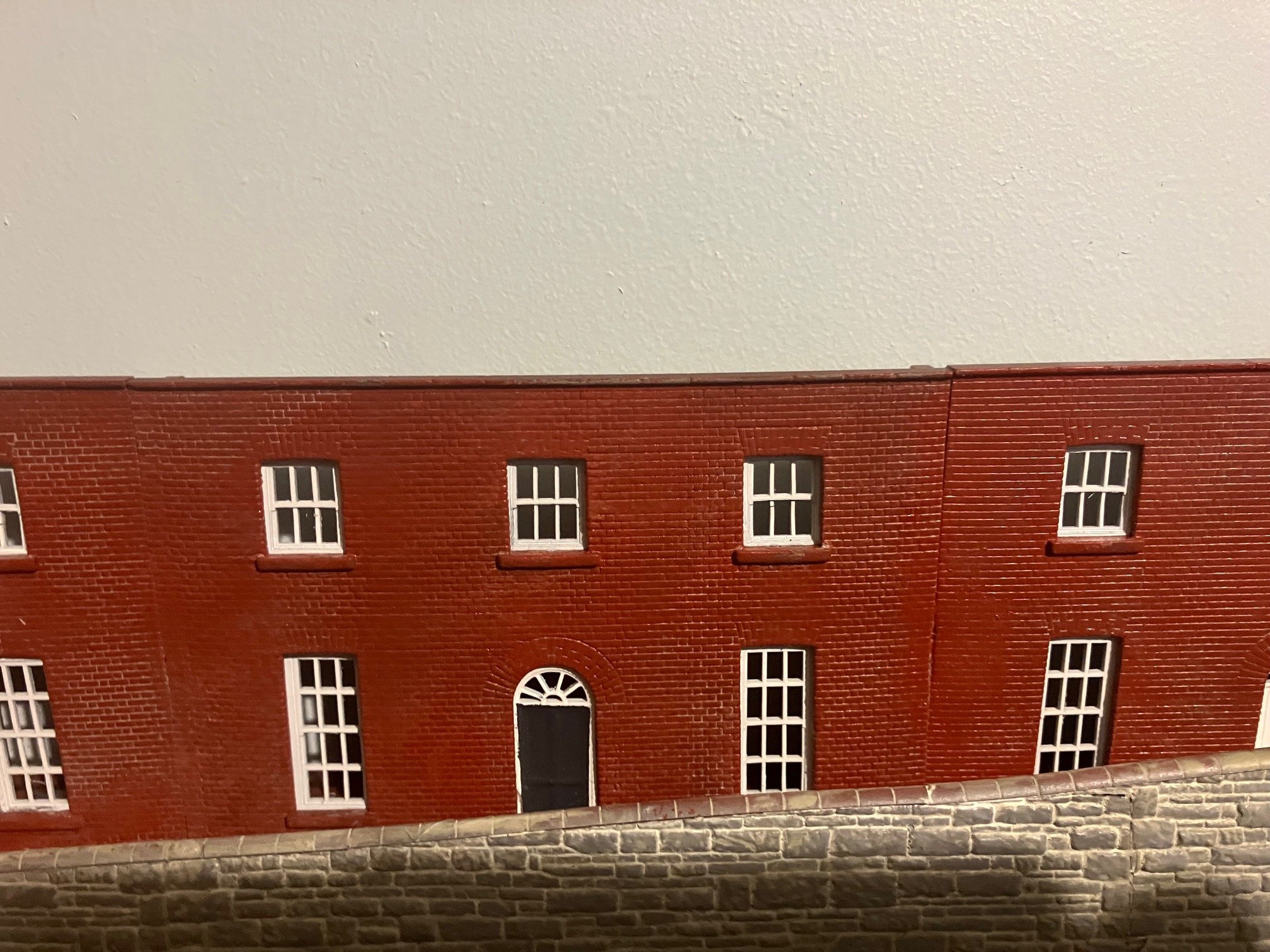

Finally got round to fitting the windows and doors to the terraced houses based on Sackville Gardens.
Had originally planned to use windows/doors I had custom etched several years ago, but only had enough etches for two house fronts so ended up 3D printing windows/doors for the entire block. The most satisfying part was modelling the joinery with vertical sash windows and doorways with fanlights and panelled doors, hardly noticeable on 4mm low relief background buildings, but I know its there🙂
  • Like 7
  • 3 weeks later...
Finally got round to printing and fitting the low relief slated roofs and chimneys to the Victorian terrace.
Both printed in an eSun black water washable resin, the local hobby 3D print/electronic supplier had run out of my usual white resin😉  Roof printed to a triangular profile to add ridgity/resist distortion.
Slate's drawn using similar principals to brickwork but 0.1mm wide/deep gap between individual slates, internal gutter behind parapet, roof fitted against backscene. Slate sized from a Wills Material sheet.
Chimneys sprayed with an etch primer & red primer before finishing with paint matchpots from a decor store. Roof unpainted at this stage possibly overpaint with a matchpot dark/slate grey.
Good fun designing/drawing the stepped chimneys, the stepped houses are on stripwood packers
Need to add rainwater hoppers and downpipes, help disguise joints between individual houses and TV ariels for a 60s-70s Irish layout.

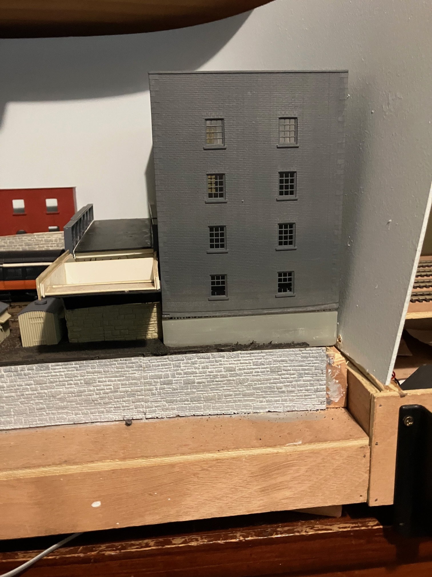

Printed a packing piece (to be overlaid in Wills Coarsed or Dressed stonework) to bring the Tower Building to its intended height. Watertank and chimney to be added!
I have got to fit a metal angle to support the backscene and proscenium arch to separate the scenic section of the layout from the staging.
