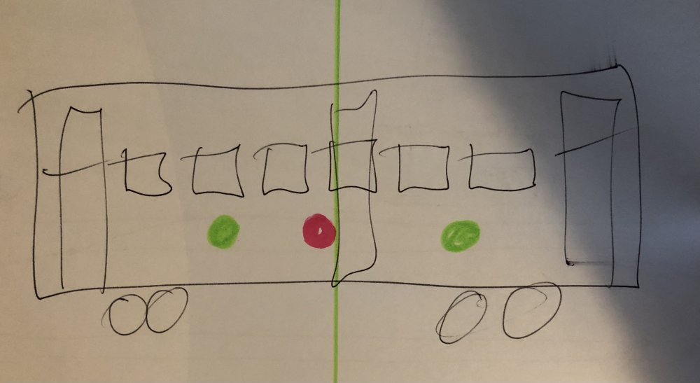

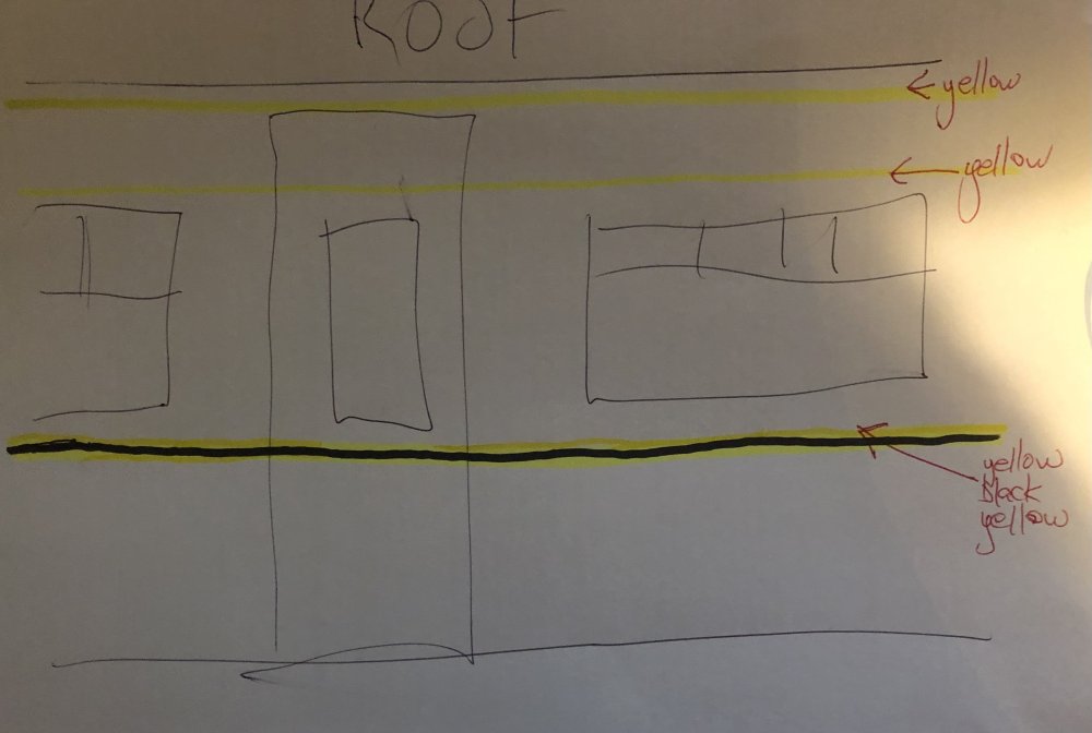

The above highly accurate (!!!) scale drawings show (upper) correct style of GSR coach lining post-1933 or so. Lower shows position of crests.
On a recent thread somewhere, mention was made of British stock RTR which could approximate, given a very long two-foot rule, for Irish, and the subject of Bachmann LMS coaches came up. As bought, these are obviously in LMS livery, with a crest in the middle as shown in pink above. The GSR used TWO crests on bogie stock, as had the GSWR before them, at least till the early 40s.
"Beware of imitators"; some warnings read - some LMS models bought off the shelf have all sorts of livery inaccuracies, usually involving the lining. But the style shown above, which is correct for GSR, is reproduced accurately on some of these models. So, in order to "convert" a LMS Bachmann coach to GSR, remove the (pink) LMS crest and apply two (green) GSR ones, plus of course the "L M S" lettering. With the allowance of a "two foot rule", the class designation numbers on the doors will do, although in accuracy terms the LMS ones are a bit too small.

I might add that in the short-lived GSR chocolate brown & cream "main line" livery, a couple of years either side of 1930, crest info was the same, and while the lining was in the same positions, all three lines were black; one line separating the lower brown from upper cream, and the upper two lines contrasting with the cream background.
ALSO forgot to add - if converting any of those Bachmann or Hornby coaches to look GSR-ish (or, indeed, NCC), get rid of the light grey or shiny silver roofs! They should be a matt dark grey.
