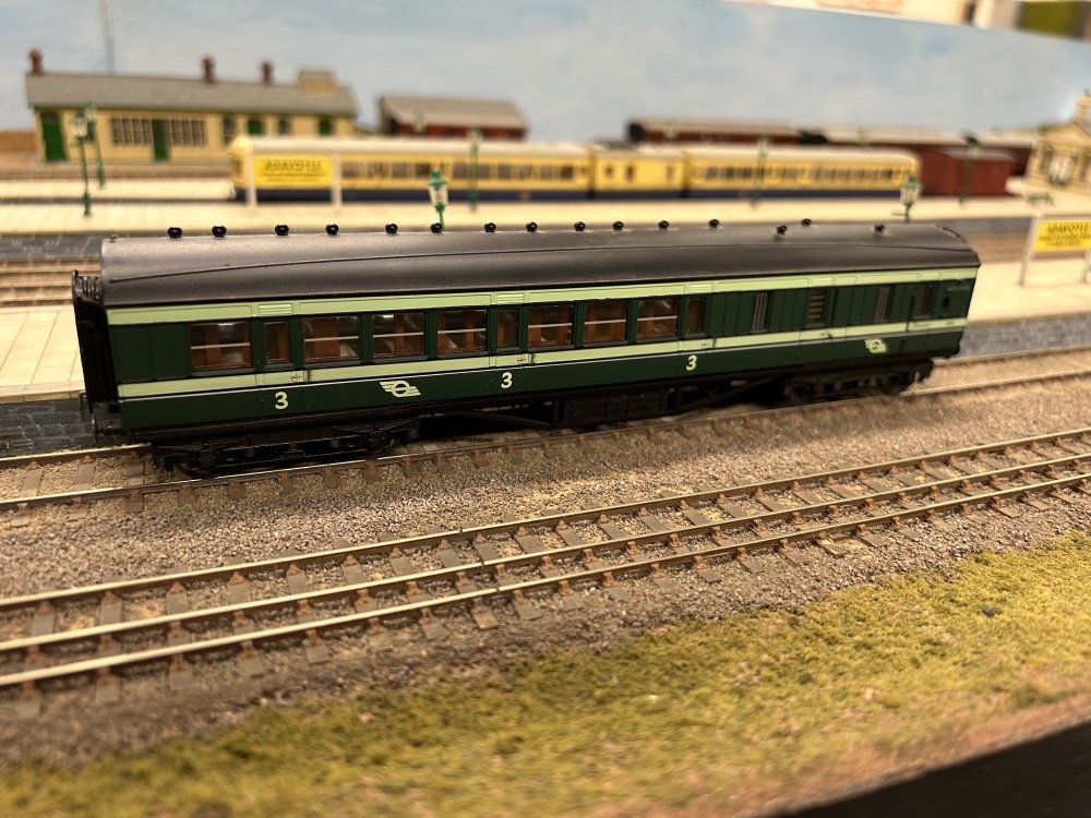

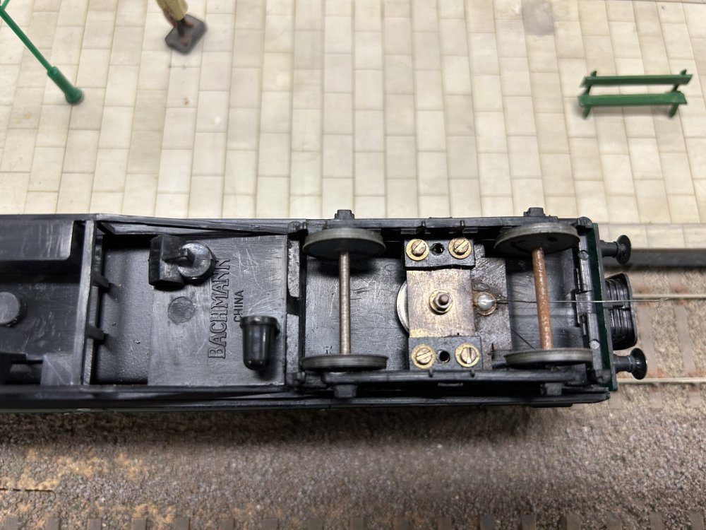

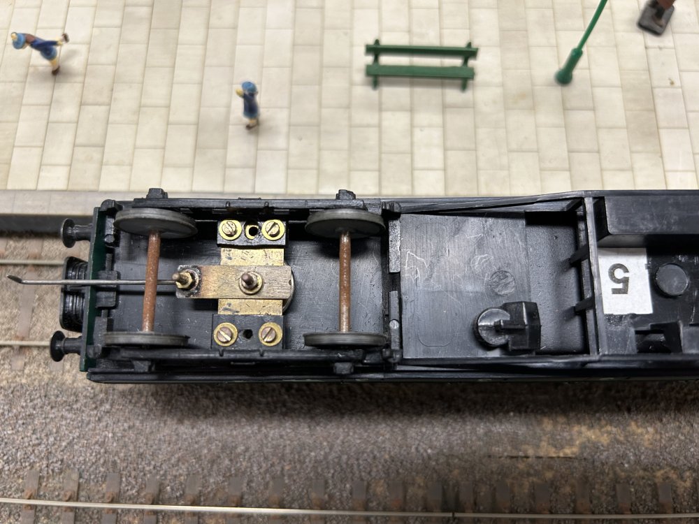

TimO Posted November 23, 2023 Posted November 23, 2023 @Fiacra I took a few photos to show you what’s possible. This is a Murphy / Bachmann CIE coach from way back when, converted many moons ago to 21mm gauge, P4 Profile to run on Adavoyle. I think the wheels are Alan Gibson on 28mm axles and I suspect a jig was used to get everything square. Under the brass bolster plate there is a brass bush but the details are not visible. The screws are likely M2. the original bogie has just been cut down the centre and widened with the plate, nothing fancy. I hope this gives you some ideas. 5

Fiacra Posted November 24, 2023 Author Posted November 24, 2023 10 hours ago, TimO said: @Fiacra I took a few photos to show you what’s possible. This is a Murphy / Bachmann CIE coach from way back when, converted many moons ago to 21mm gauge, P4 Profile to run on Adavoyle. I think the wheels are Alan Gibson on 28mm axles and I suspect a jig was used to get everything square. Under the brass bolster plate there is a brass bush but the details are not visible. The screws are likely M2. the original bogie has just been cut down the centre and widened with the plate, nothing fancy. I hope this gives you some ideas. Lovely work! Very helpful - thanks TimO! 1
