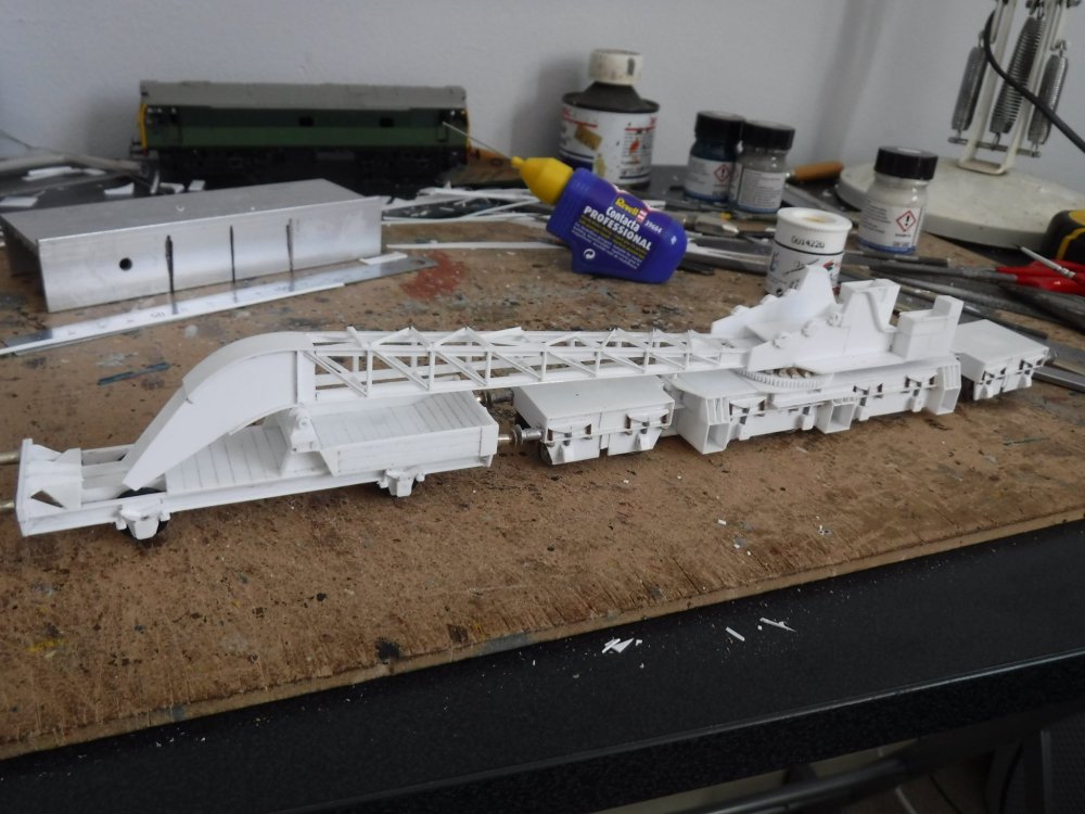

gibbo675 Posted July 9, 2024 Posted July 9, 2024 Hi John, What scale and material are you working with ? I build most of my models from plasticard of and I use various sections of Plastruct or Evergreen sections that come in all sorts of shapes and sizes. As Robert noted above Archers do rivet transfers as does Railtec which I have found to much easier to source direct from Railtec's website. This is a OO gauge crane jib that I have made up from 2mm and 1.6mm angles and various pieces of square section. This is the rest of it although I haven't applied the rivet transfers yet. Gibbo. 4 2 Quote

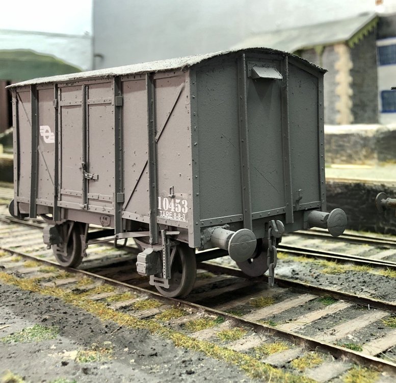

Galteemore Posted July 9, 2024 Posted July 9, 2024 I used plastruct or Evergreen t-section with separately applied rivets …. 8 1 1 Quote
TimO Posted July 9, 2024 Posted July 9, 2024 @Galteemore Brilliant strapping and door detail. 1 1 1 Quote
