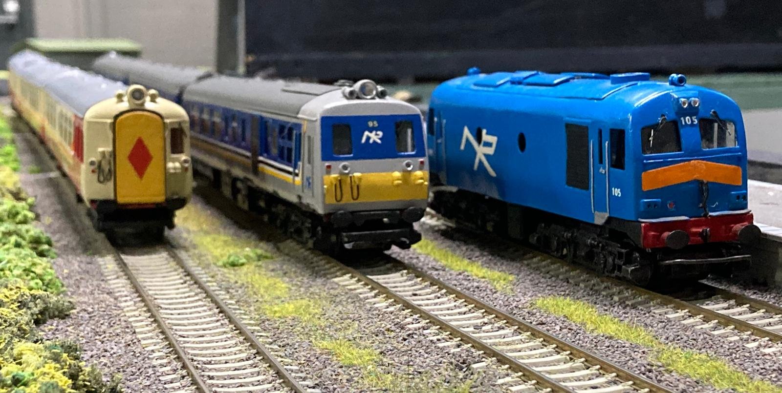

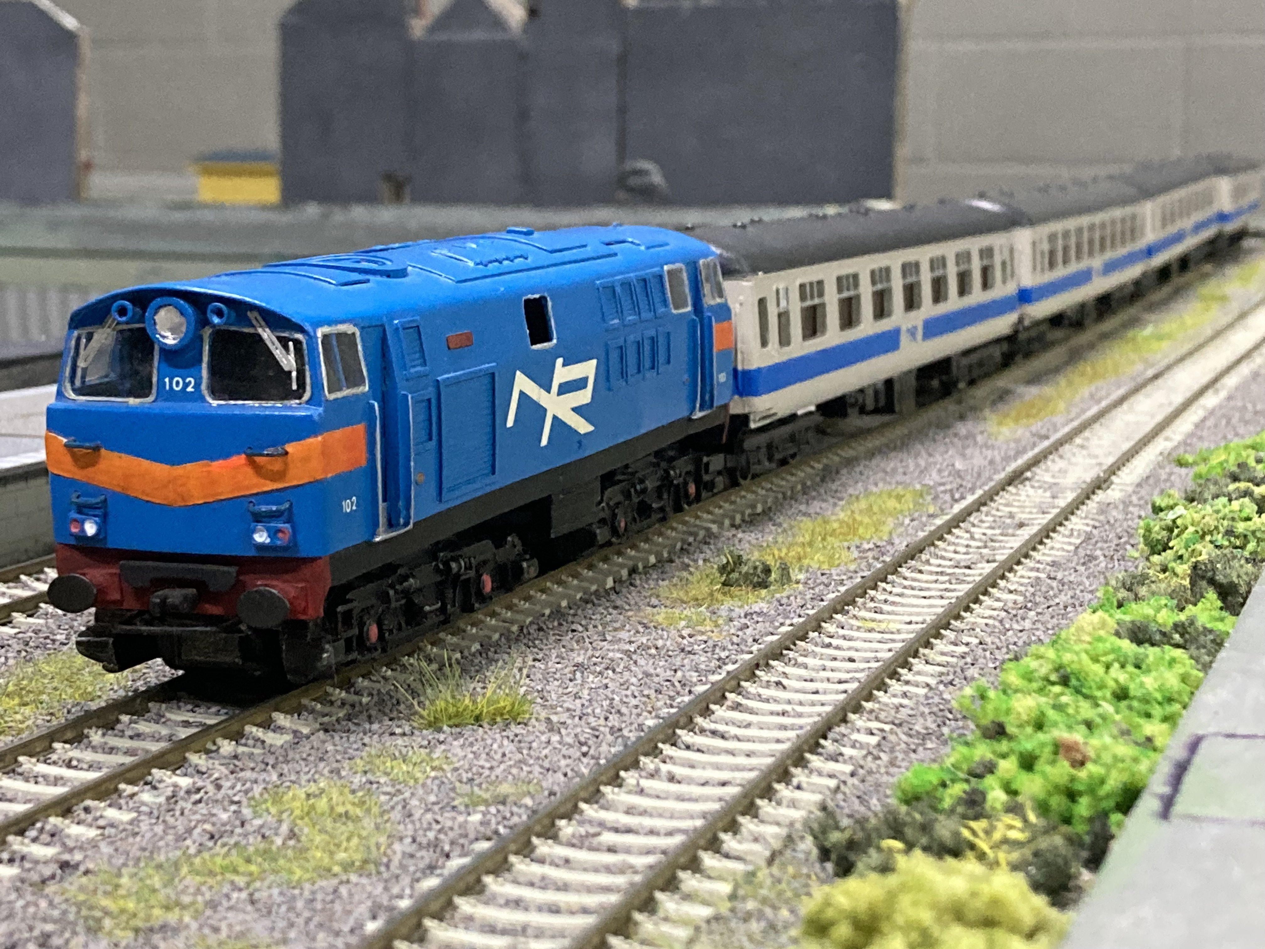

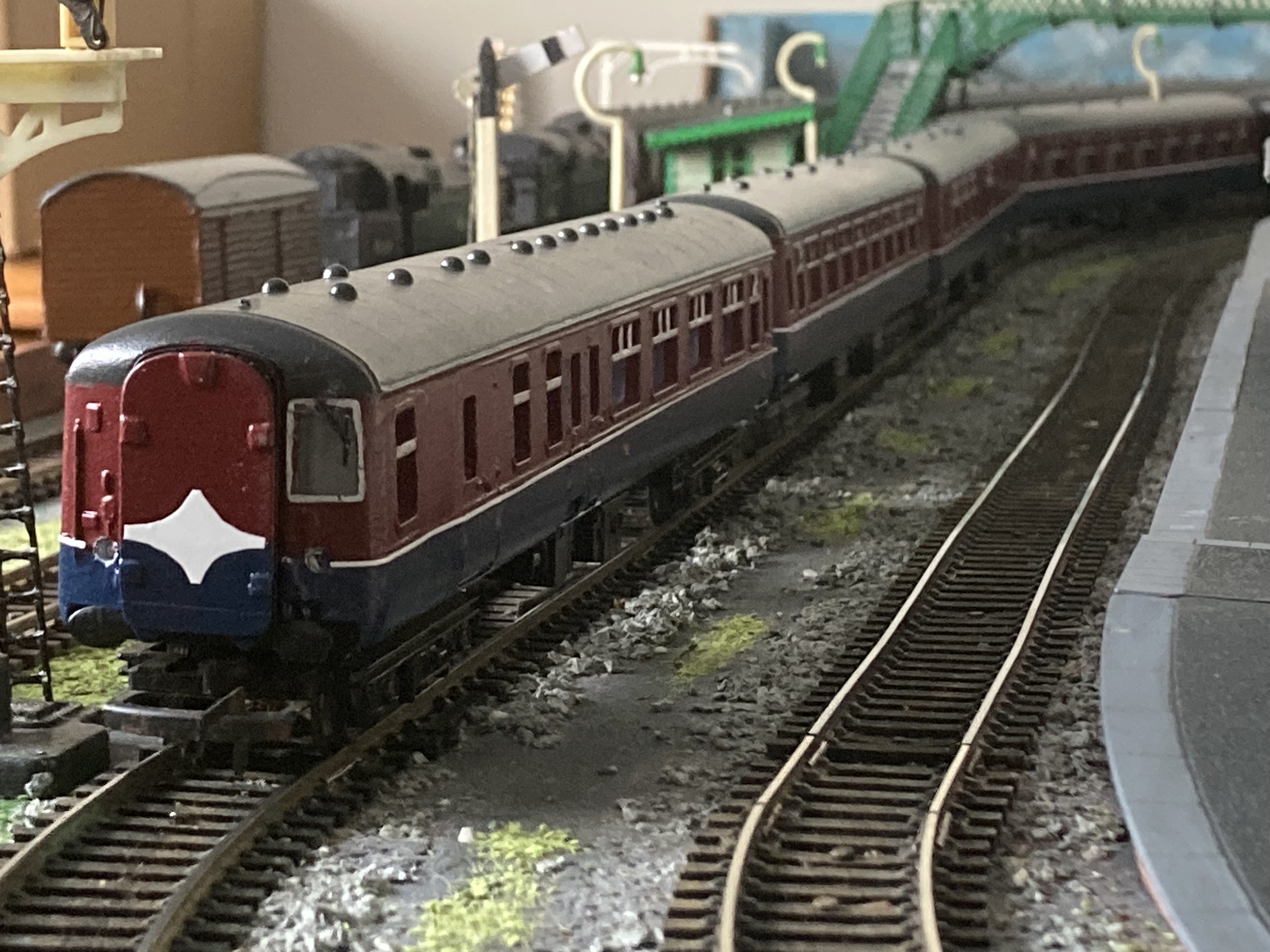

33lima Posted Saturday at 13:41 Posted Saturday at 13:41 (edited) Like the Tri-ang Hornby Mk2s, the Lima Mk2s - with their very thick bodyside moulding and deeply recessed windows - were something of a step back from the near flush-glazed 'scale length' Triang Railways Mk1s introduced in the 1960s. Flush glazing is awkward due to the need to reprofile the window edges and fit the three ventilator pieces individually. They are also awkward to dis-assemble for rebuilding due to the somewhat fragile but tightly-fitted roof/glazing piece. But they are cheap as chips, ones with the metal wheels run very freely, and they provide a good basis for comparatively inexpensive rakes of NIR coaches - I have five NIR 'bumblebees' (plus two of the three-packs Lima released in that livery), another five in original NIR Enterprise, and another four in NIR 'blue band', including some adapted as driving trailers, diners and a genny. I also used Lima Mk2s for my 1990s NIR 80 Class sets, as other have done. Edited Saturday at 13:42 by 33lima 9

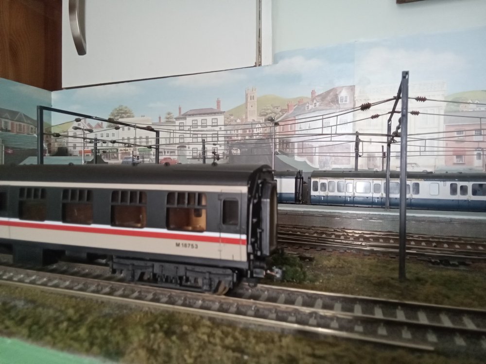

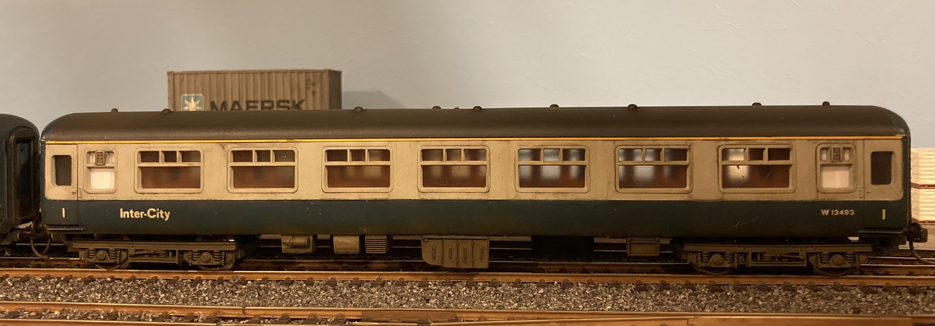

irishthump Posted Tuesday at 11:58 Posted Tuesday at 11:58 (edited) For when they were made the Lima coaches are fine. They have better details than they’re given credit for and can be made to look even better with detail parts. I have quite a few in British liveries and they happily run behind my modern locos. My layout is all code 100 so the wheels give me no problems and I have switched all the couplers for Kadees or magnetic ones. Although they're obviously not the most detailed models they can be made to look pretty presentable and they run very well. Edited yesterday at 11:13 by irishthump 4

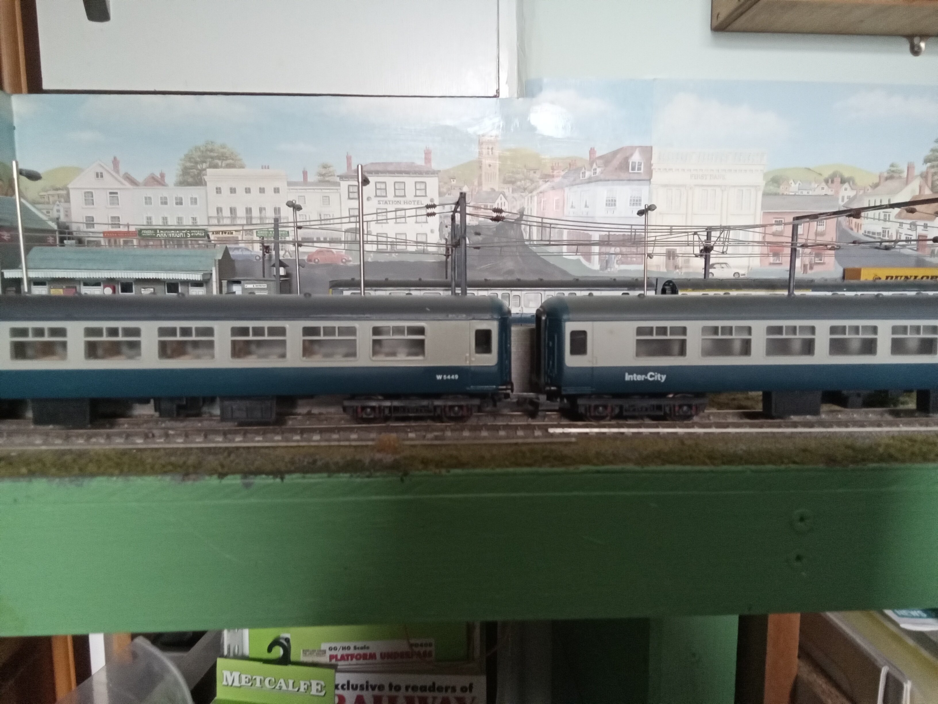

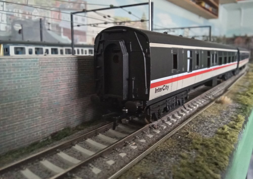

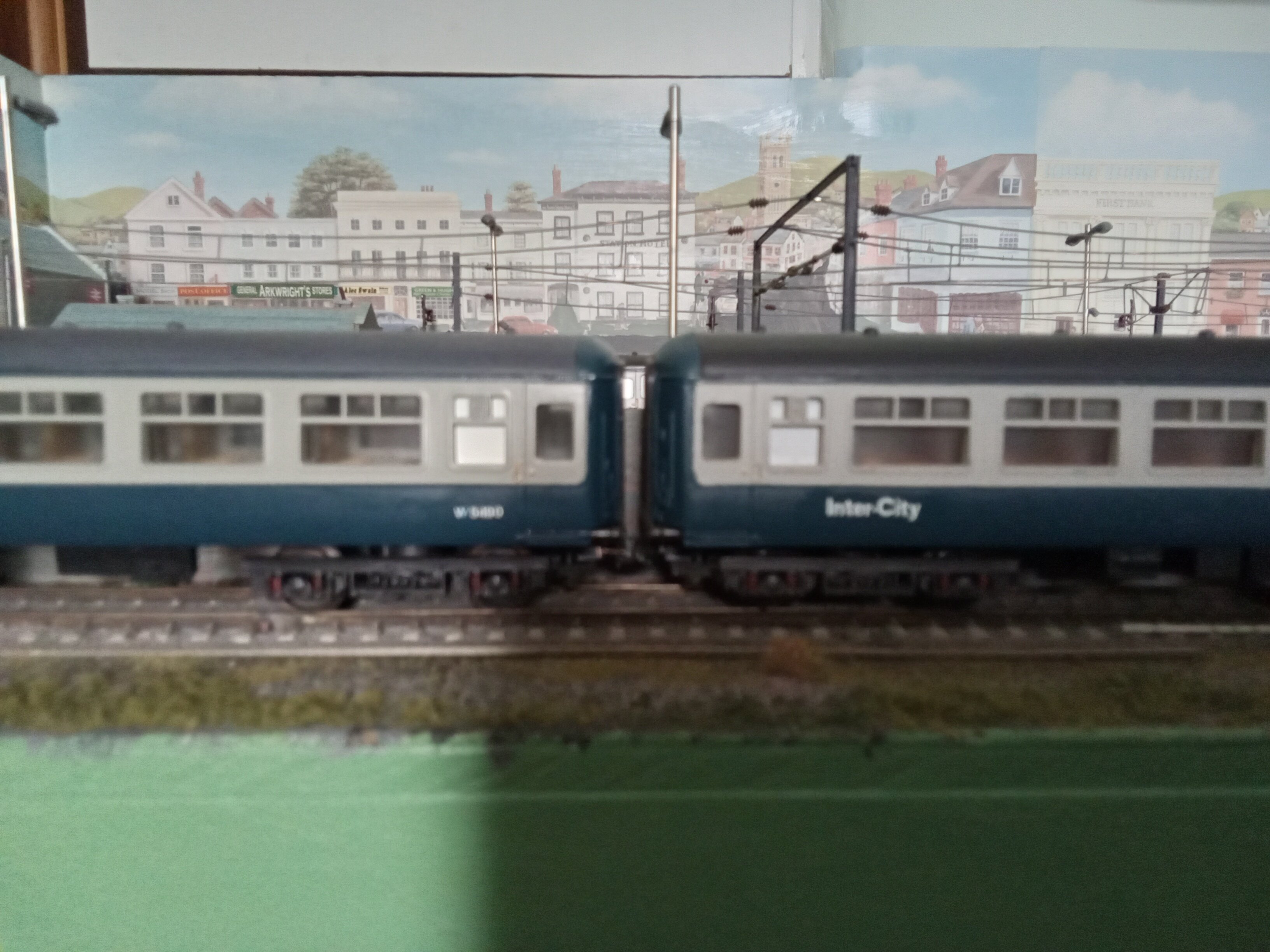

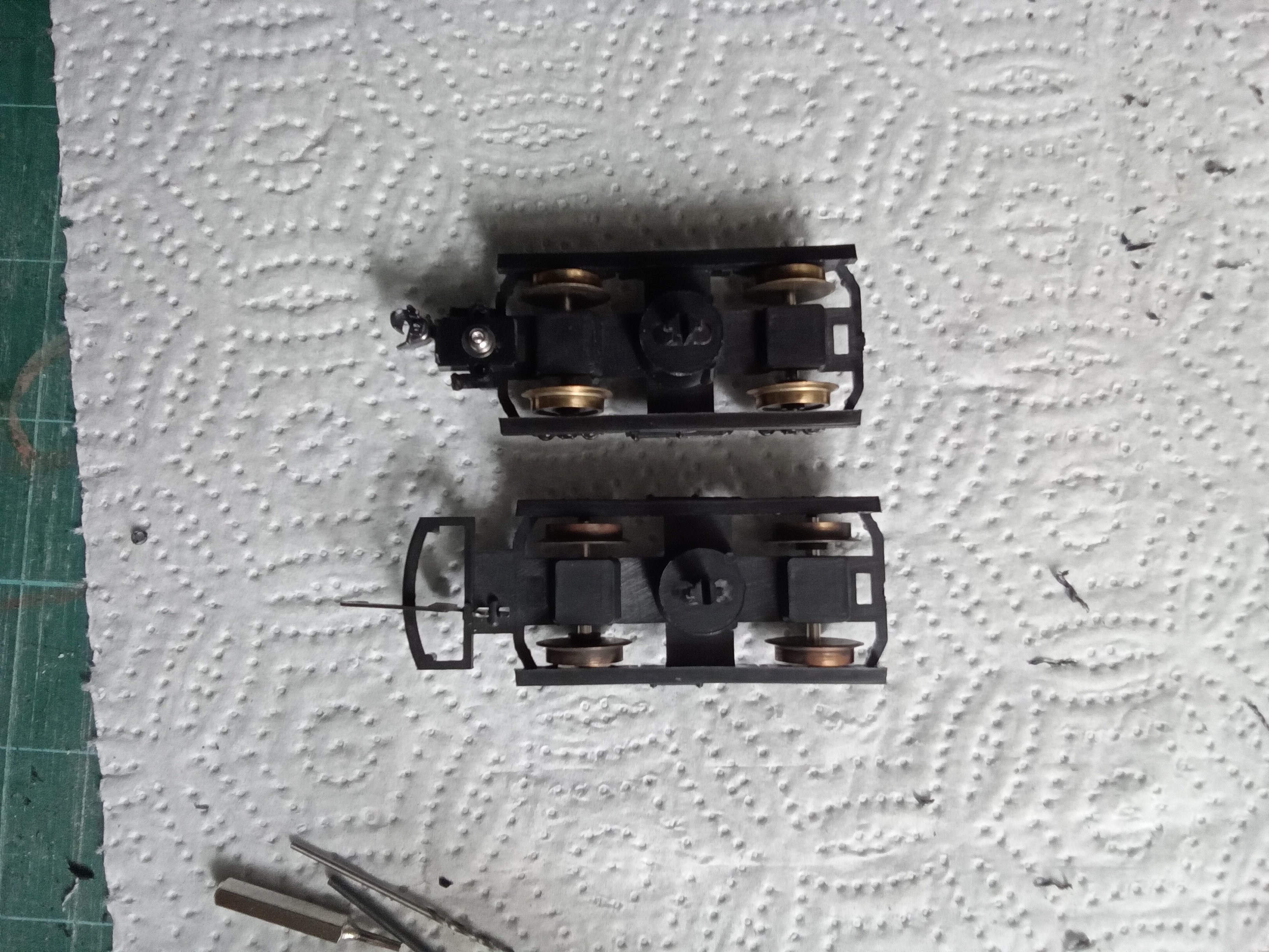

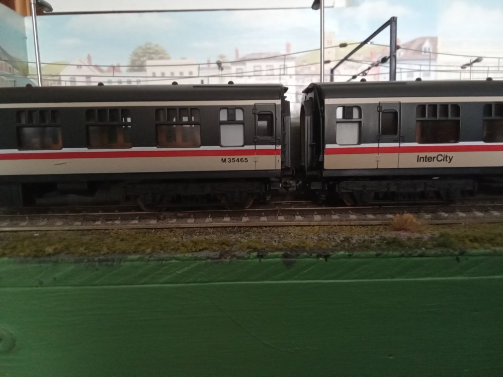

irishmail Posted Tuesday at 12:22 Posted Tuesday at 12:22 20 minutes ago, irishthump said: For when they were made the Lima coaches are fine. They have better details than they’re given credit for and can be made to look even better with detail parts. I have quite a few in British liveries and they happily run behind my modern locos. My layout is all code 100 so the wheels give me know problems and I have switched all the couplers for Kadees or magnetic ones. Although their obviously not the most detailed models they can be made to look pretty presentable and they run very well. I am currently working through my rake of Lima MK'2s , I have removed the hideous tension lock couplings and replaced them with Kadee's, this helps reduce the gap between the coaches. In fact I tend to run my lima coaches more than the Bachmann ones! Will try and post some before and after pics later. 2

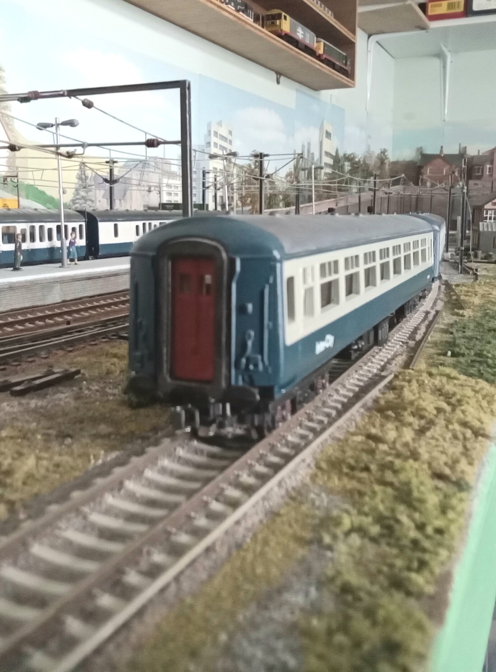

irishmail Posted Tuesday at 15:23 Posted Tuesday at 15:23 (edited) Here are the pics of some of my Lima MK2 modifications. There is a before and after image. I have also modified the end corridor and painted the end doors red. I have a rake of 5 SO's and have renumbered them, also have an FO and BFK to do. Edited Tuesday at 15:24 by irishmail 5
Horsetan Posted Tuesday at 16:16 Posted Tuesday at 16:16 Lima were quite fond of that weird grade of bendy plastic that they used in their bogies and associated parts. It was virtually impossible to glue anything to it.
irishthump Posted yesterday at 11:10 Posted yesterday at 11:10 18 hours ago, Horsetan said: Lima were quite fond of that weird grade of bendy plastic that they used in their bogies and associated parts. It was virtually impossible to glue anything to it. Newer adhesives like Plastic Magic from Deluxe will work. Also, if you roughen the surface with fine sandpaper or a file superglue works very well. 19 hours ago, irishmail said: Here are the pics of some of my Lima MK2 modifications. There is a before and after image. I have also modified the end corridor and painted the end doors red. I have a rake of 5 SO's and have renumbered them, also have an FO and BFK to do. They look very good! I don't think I could be that brave with the close coupling space on my layout!
Horsetan Posted yesterday at 12:38 Posted yesterday at 12:38 1 hour ago, irishthump said: Newer adhesives like Plastic Magic from Deluxe will work. Also, if you roughen the surface with fine sandpaper or a file superglue works very well. Plastic Magic didn't exist when I had Lima items in the 1990s. Roughening the surface didn't work for regular superglues, and the plastic was also resistant to solvents like Mek-Pak and Daywat butanone. Araldite would hold for a while but the bond was quite weak.
irishthump Posted yesterday at 12:49 Posted yesterday at 12:49 9 minutes ago, Horsetan said: Plastic Magic didn't exist when I had Lima items in the 1990s. Roughening the surface didn't work for regular superglues, and the plastic was also resistant to solvents like Mek-Pak and Daywat butanone. Araldite would hold for a while but the bond was quite weak. I attached all my Kadees and NEM pockets to the bogies with Superglue (cheap stuff) after abrading with sandpaper. That was about 10 years ago and they're still attached!
Horsetan Posted yesterday at 14:32 Posted yesterday at 14:32 1 hour ago, irishthump said: I attached all my Kadees and NEM pockets to the bogies with Superglue (cheap stuff) after abrading with sandpaper. That was about 10 years ago and they're still attached! Interesting. I remember using Loctite, which proved unable to hold on.
irishthump Posted 6 hours ago Posted 6 hours ago 20 hours ago, Horsetan said: Interesting. I remember using Loctite, which proved unable to hold on. Sanding the plastic really is the trick to it. Sanding both the spot on the bogie and the Kadee coupler box gives a really good bond. 2 1 1
