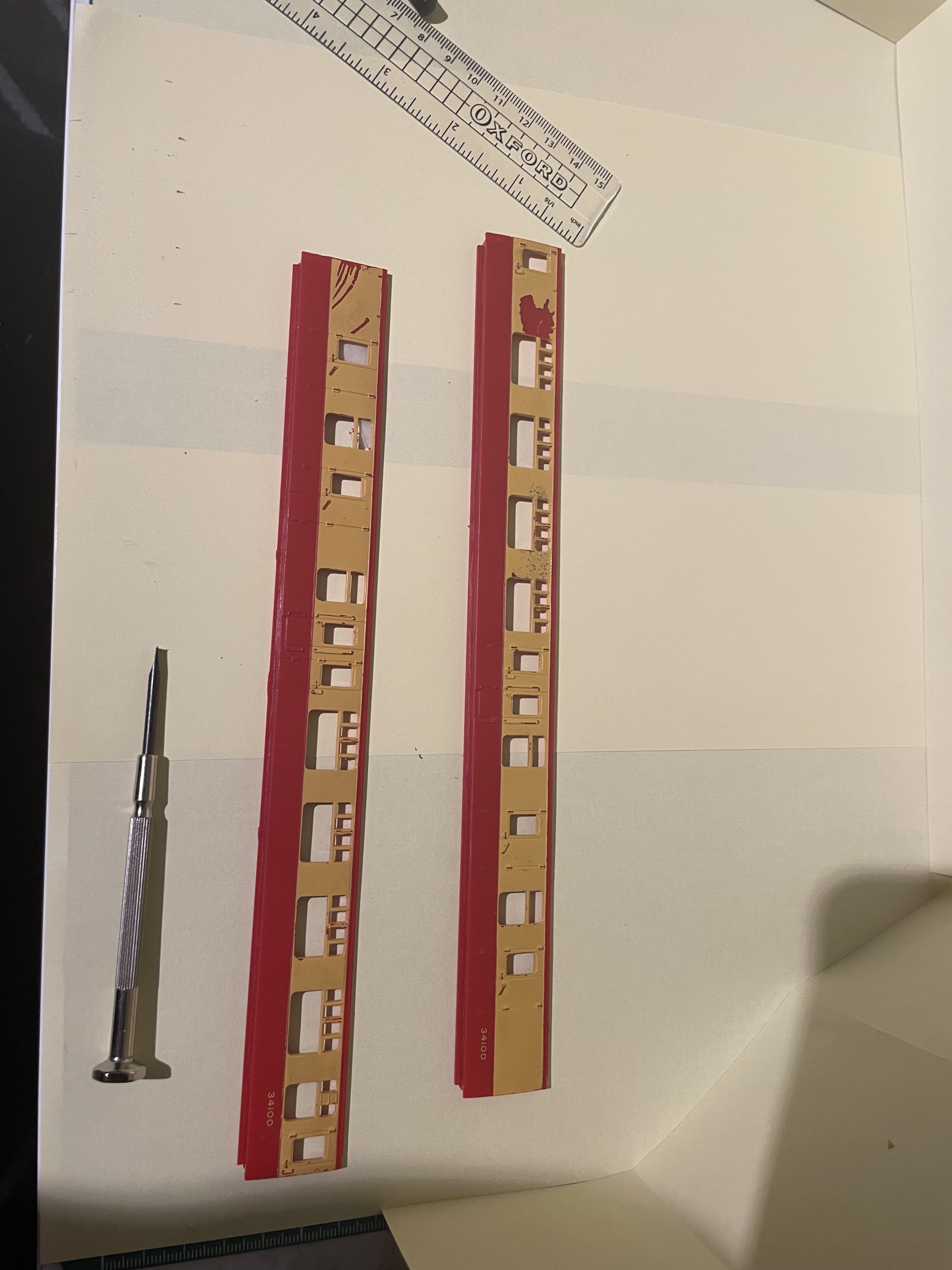

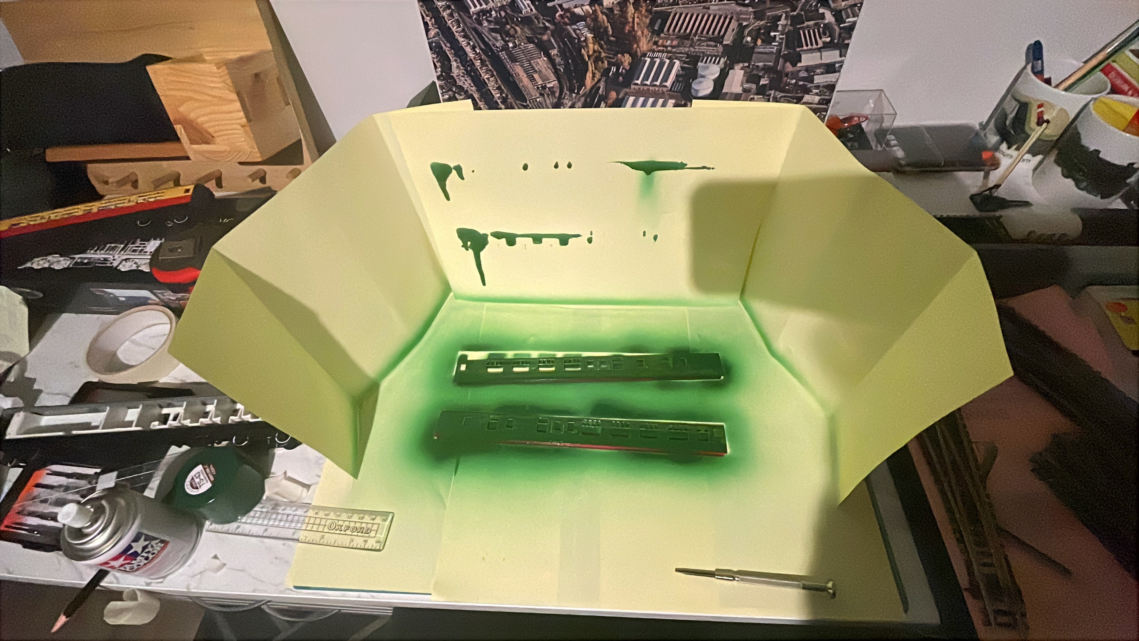

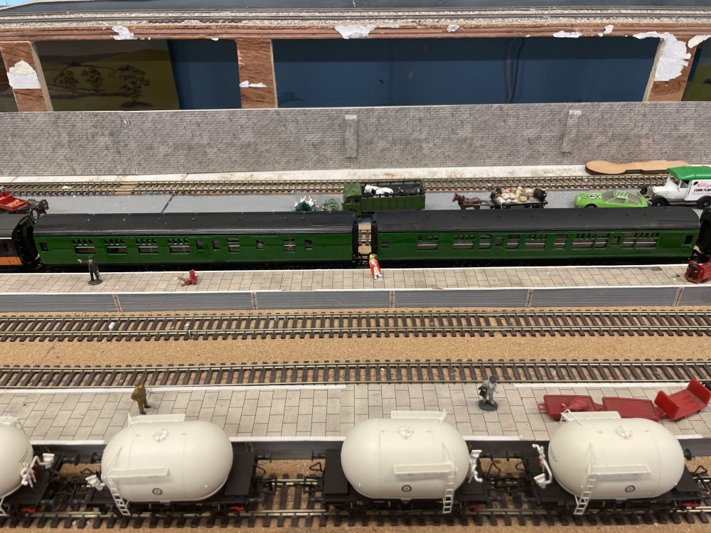

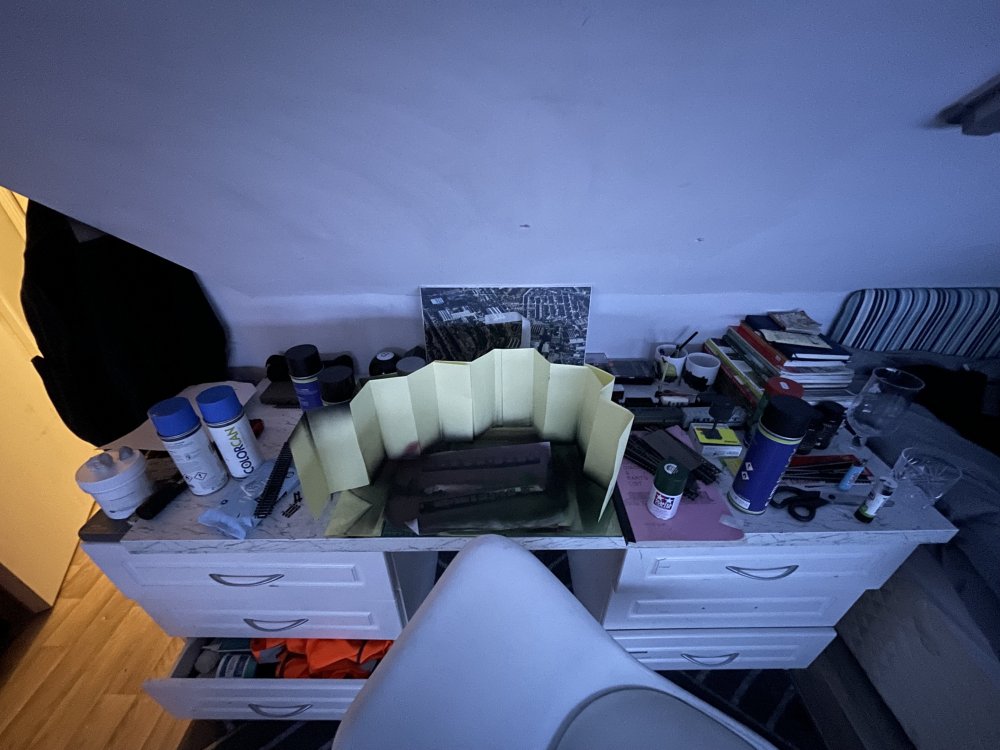

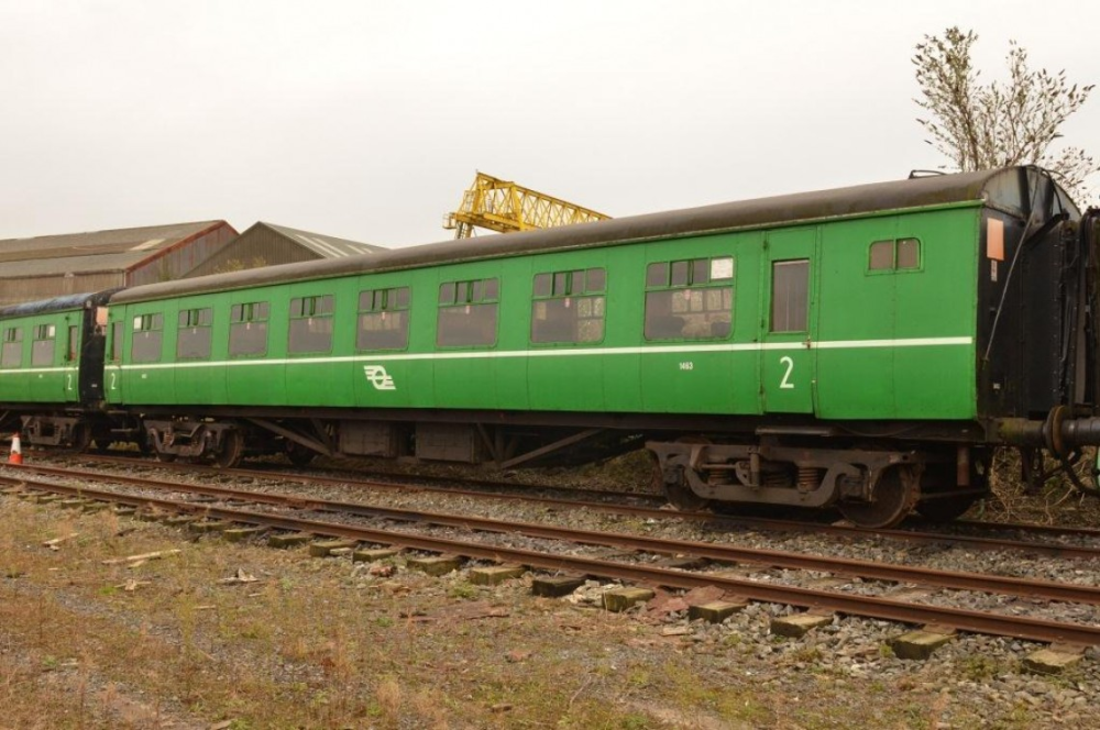

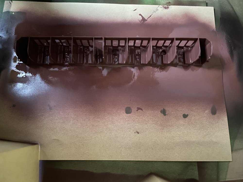

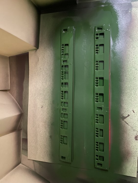

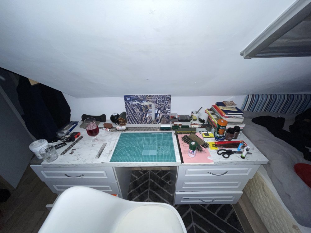

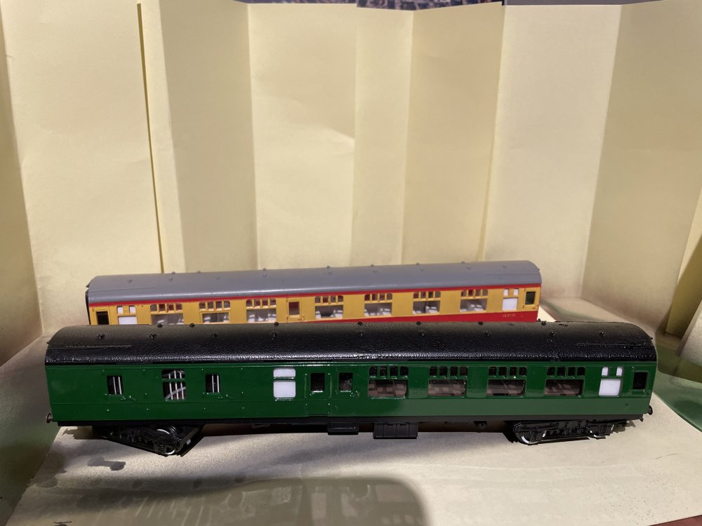

josh_ Posted May 28 Posted May 28 So I decided to make this as a side thing from Connolly shed I currently got home and turned my desk into a paint shop And this was to pimp out these 2 tri ang coaches I had lying around that my mam got me years ago I picked up a racing green spray from marks and gave it a good smooth coat as Simon told me it was the closest I could get to a CIE green Surprisingly turned out great as it was first time ever spray painting/detaining a model before Came well prepped with the paper stand, goggles and 2 old face masks from Covid but cracked a bit of the plastic which looked bad but worked around it just fine as you see below with the little strips of masking tape Currently, the paint is drying and will be fitted and then eventually decaled after I spray the roof black and the inside brown as I’m replacing a laminate(well badly attempting) Hope and love to post all my shenanigans of modelling up here in the future 2

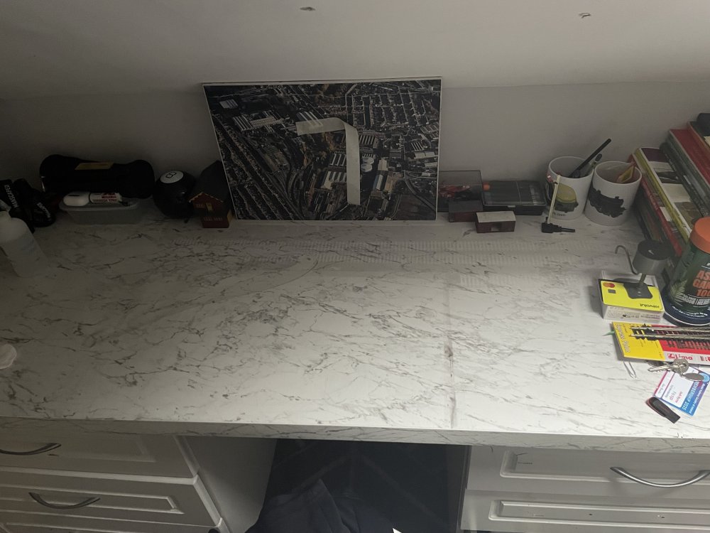

josh_ Posted May 28 Author Posted May 28 I do need to work on my lifting as where my desk is it’s quite a dark spot I’m sketching out an idea of how to tackle this problem as it’s annoying especially dealing like today I plan to have LEDs on the board of the bedroom circuit above the desk to give me lighting in a better angle to work on as the lil colourful ones are “aesthetic” but downright as they can’t last half an hour before they start to die even with fresh batteries and aren’t bright enough
David Holman Posted May 29 Posted May 29 Lighting is indeed important. Aim to have the same on your workbench as you will have on the layout. For LEDs, have found that "cool white" works well. See that the spellchecker goblin is at work on your thread too (lifting for lighting) - sometimes I wonder what language I'm typing in! 1

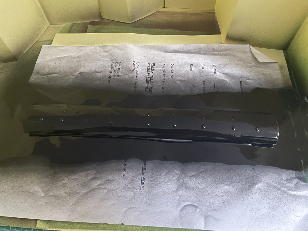

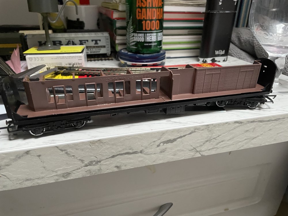

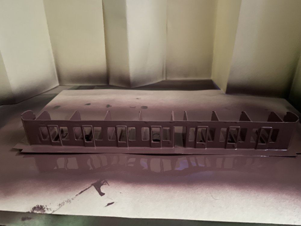

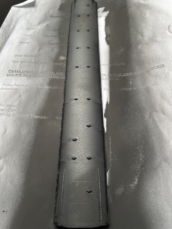

josh_ Posted June 4 Author Posted June 4 Apologies for the wait Finally got a load of my dads spray cans Im gonna go with satin black for the roof but do also have Matt and gloss black using the reference from the RPSIs website seen below

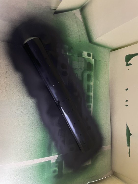

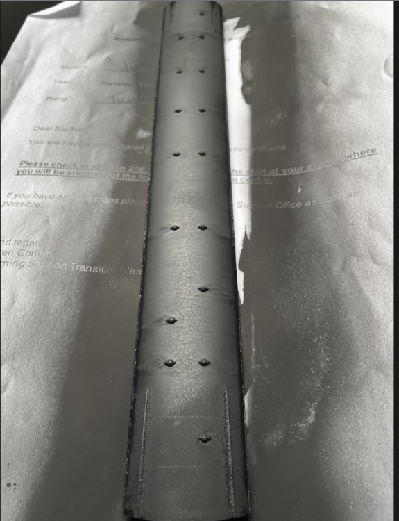

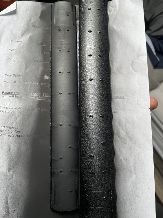

josh_ Posted June 4 Author Posted June 4 Some pics during the process I like the rough look it comes some realism personally but it does look like rhino skin IMG_6896.mov 2

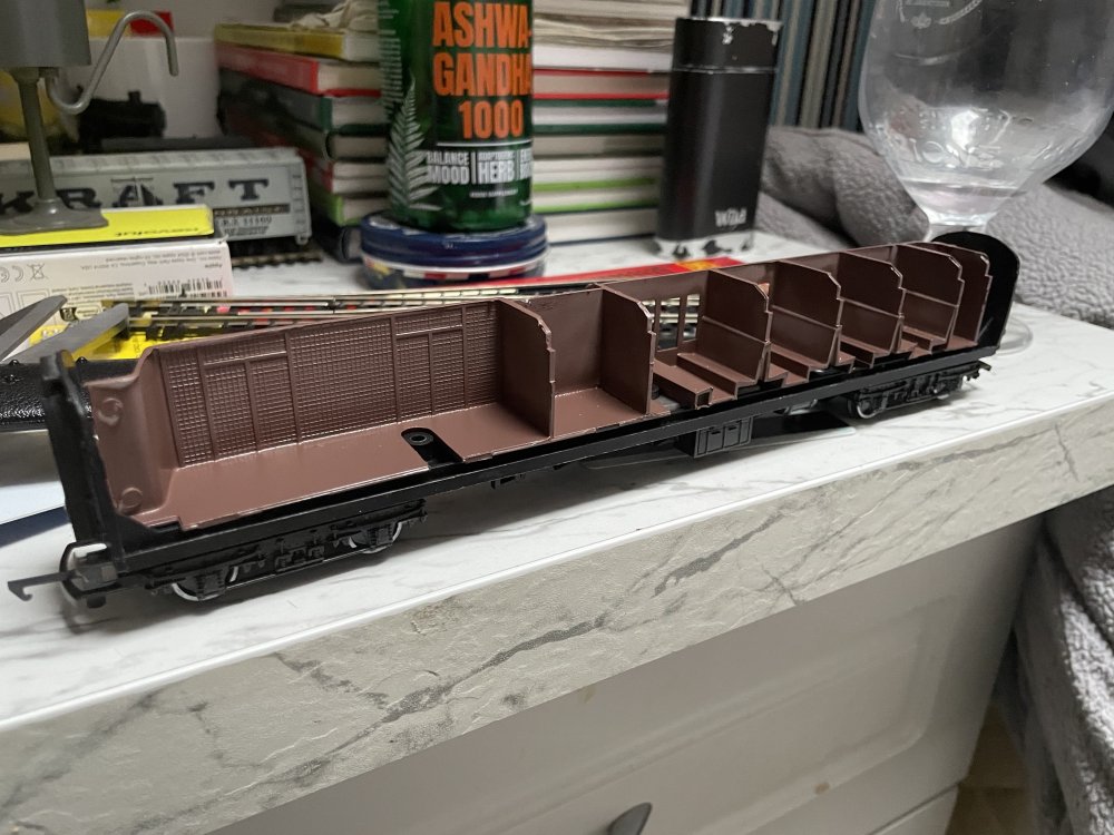

josh_ Posted June 4 Author Posted June 4 Now I’m gonna wait and put on the sides and then find hopefully if I have one a light green marker to do the livery but will print or buy decals Mainly I’m saving my money for Dundalk and express points

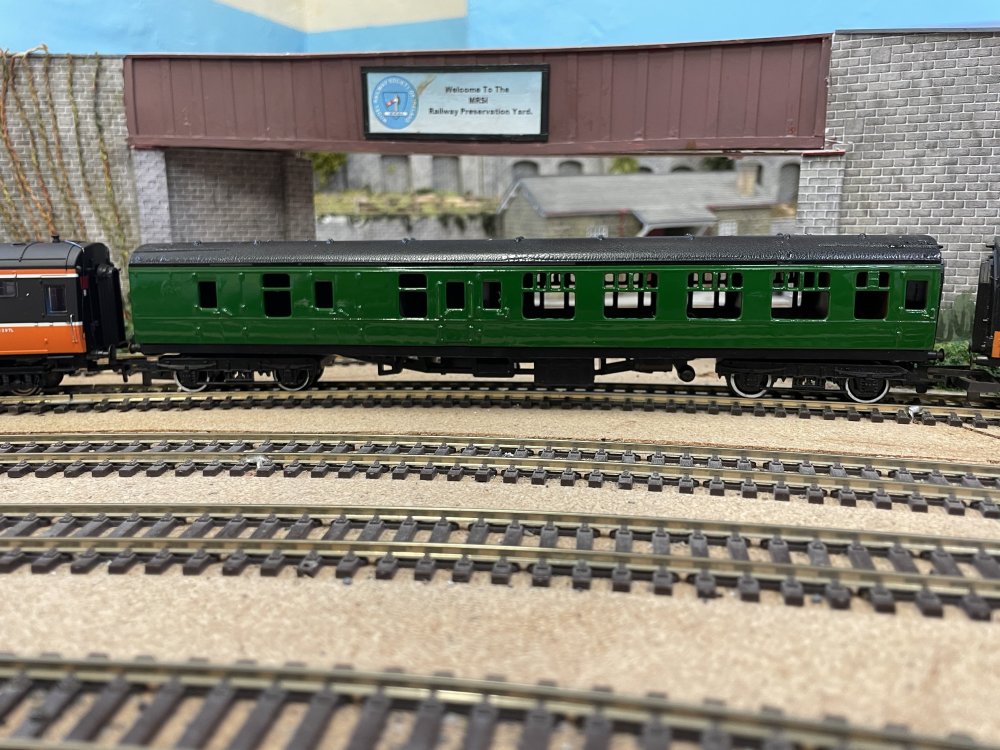

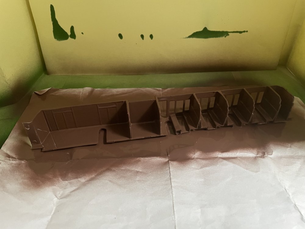

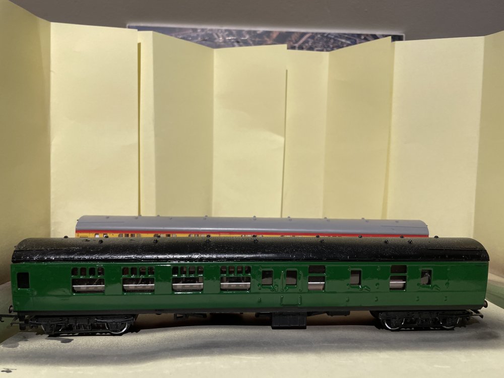

josh_ Posted June 4 Author Posted June 4 IMG_6905.mov IMG_6906.mov Yes it had no windows in it and paintwork scuffed a lil due to the bubble wrap Coach 2 now 2

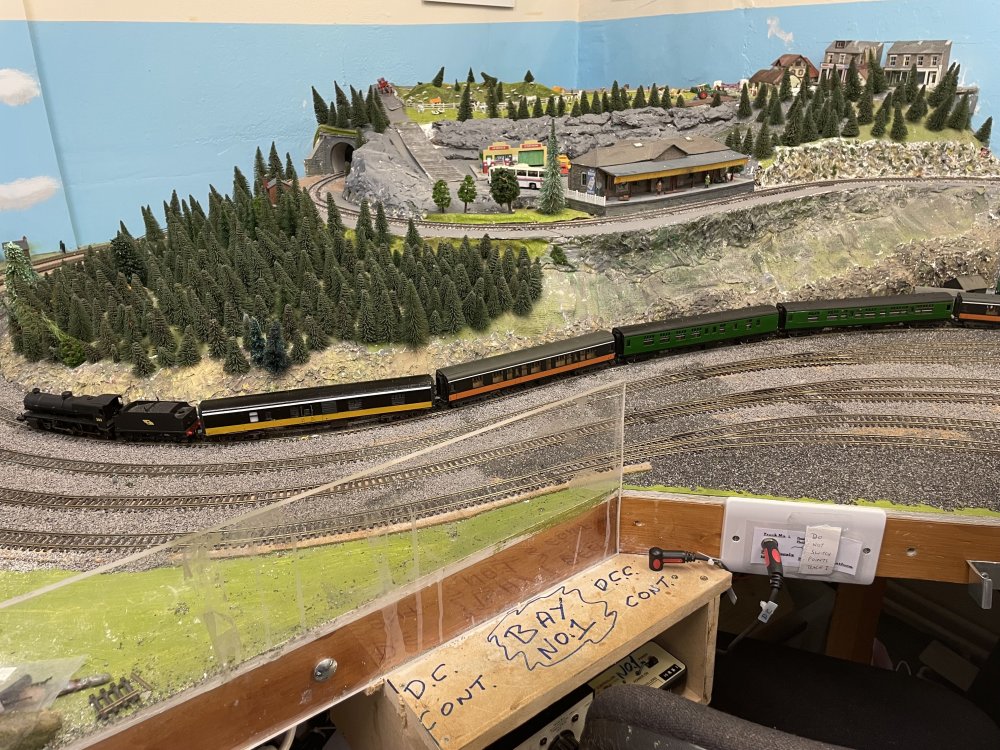

Flying Snail Posted June 4 Posted June 4 It definitely looks at home in that rake. The colours seem a good match. Well done! 1
josh_ Posted June 4 Author Posted June 4 Thanks so much all that’s left is the other coach and decals

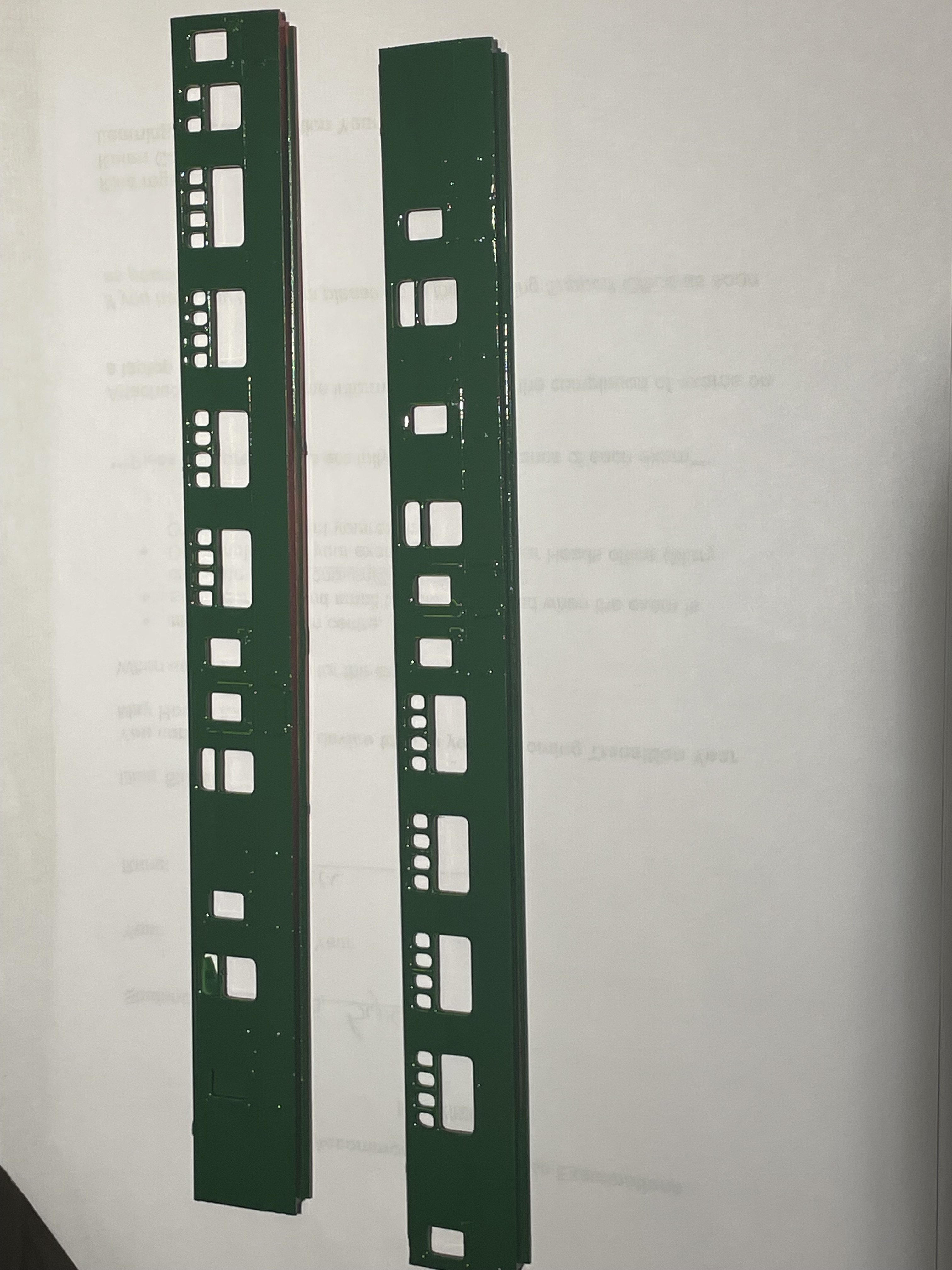

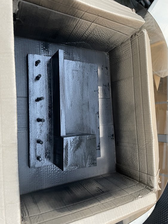

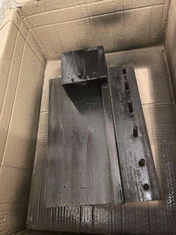

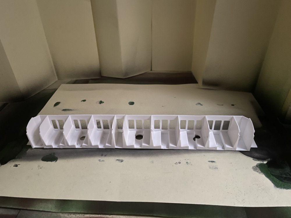

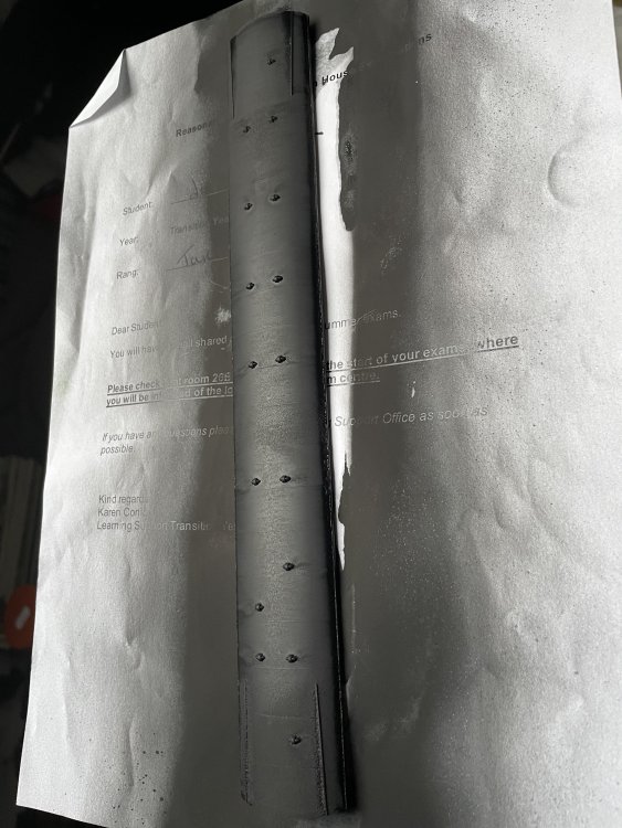

josh_ Posted June 5 Author Posted June 5 Did the roof and what I did instead was layer of satin black layer of Matt black 2 layers of satin whcih turned out better then the first time I did it I’m gonna get some strong sand paper to get that rhino skin off and hopefully it does the job IMG_6928.mov Did the sides and interior too Saw the opportunity and decided why not paint my junior cert woodwork piece Its drying out rn done in a Matt black I will paint on some logos and maybe signage onto it for that appeal Woodwork piece was actually a last min thing I did which didn’t turn out too bad and from what I remember got a good grade Worth rooting at the scrap box
josh_ Posted June 5 Author Posted June 5 Will show the dried out results tomorrow But I will sand the rhino skin roof tomorrow

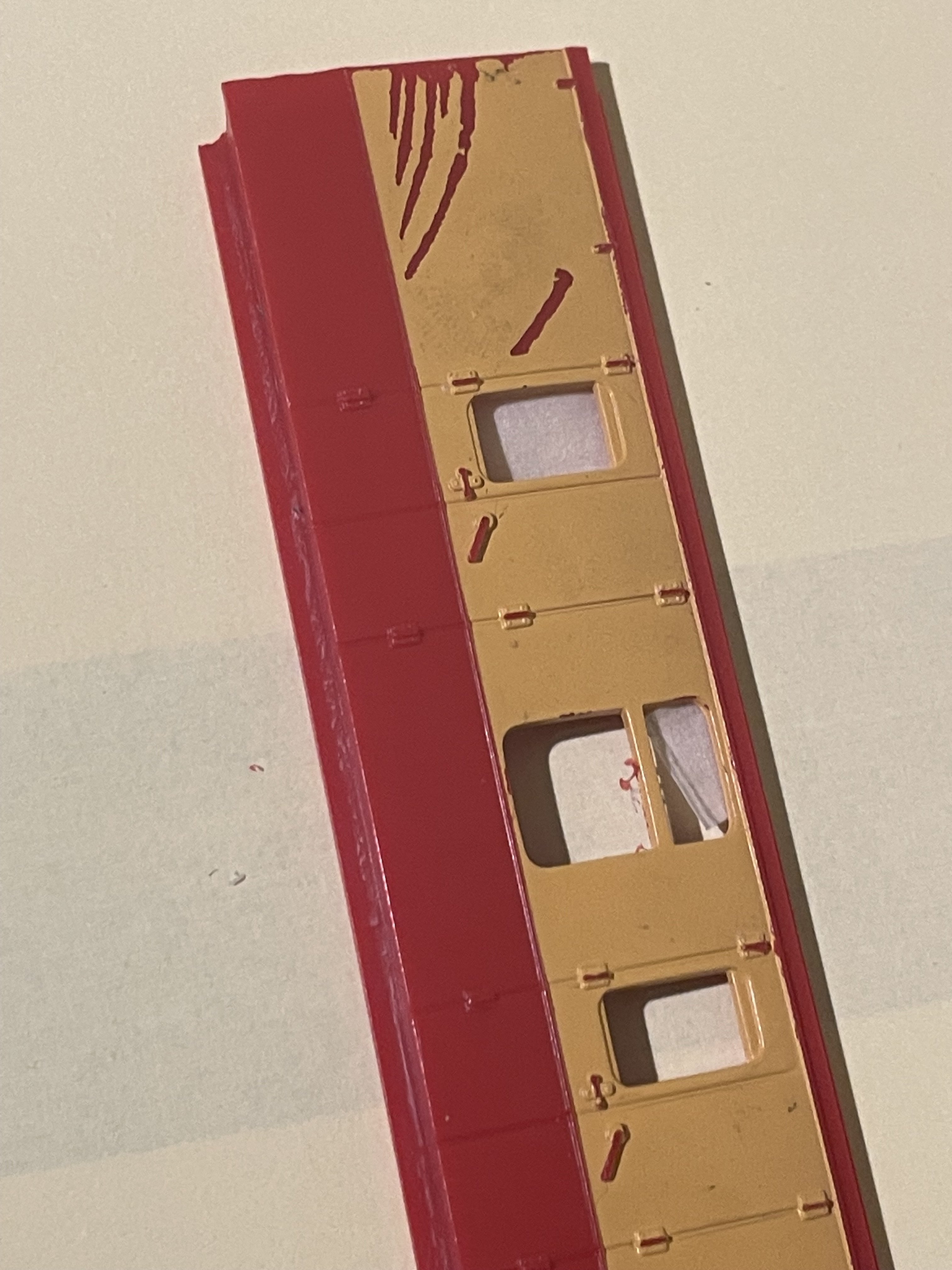

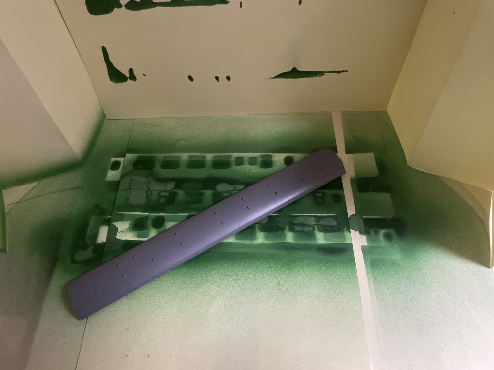

Georgeconna Posted June 6 Posted June 6 Good effort but you seem to be layering on the paint way too heavy,. A few light coats each time to build it up is the way to go. Are you using different types of paint as the cracking tends to be caused by acrylics and enamels on top of each other? This affect looks good. 1

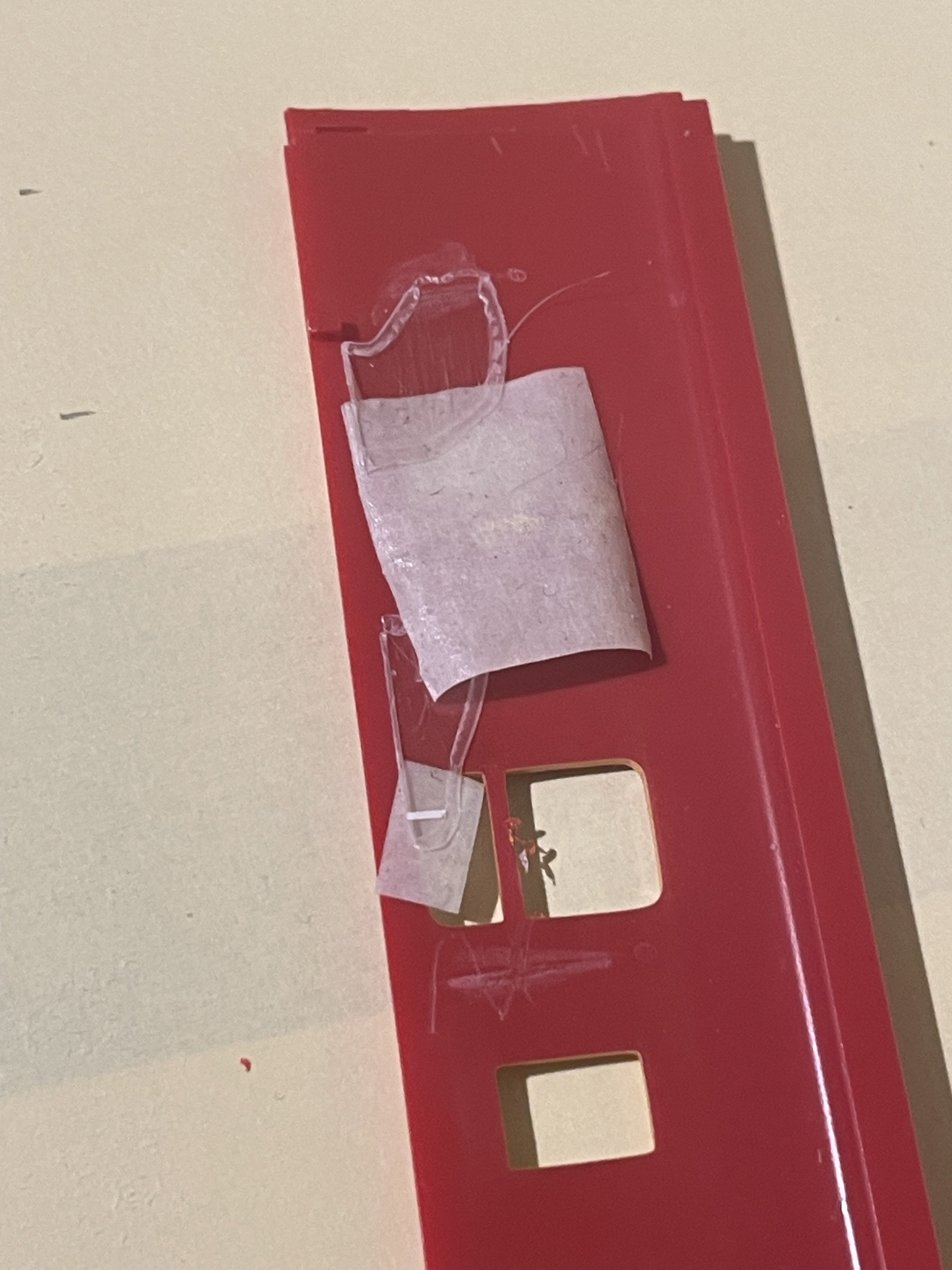

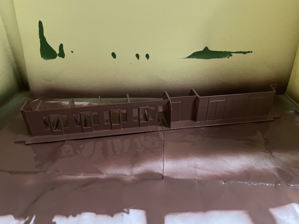

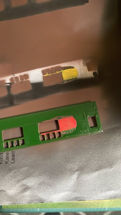

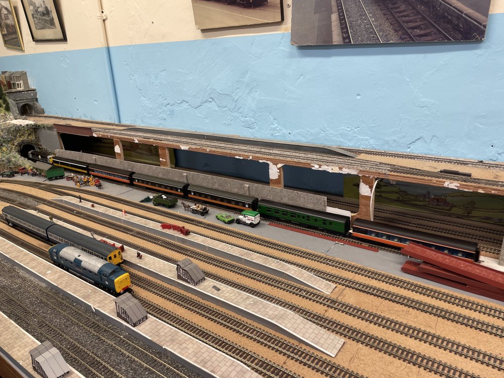

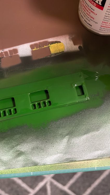

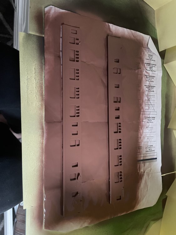

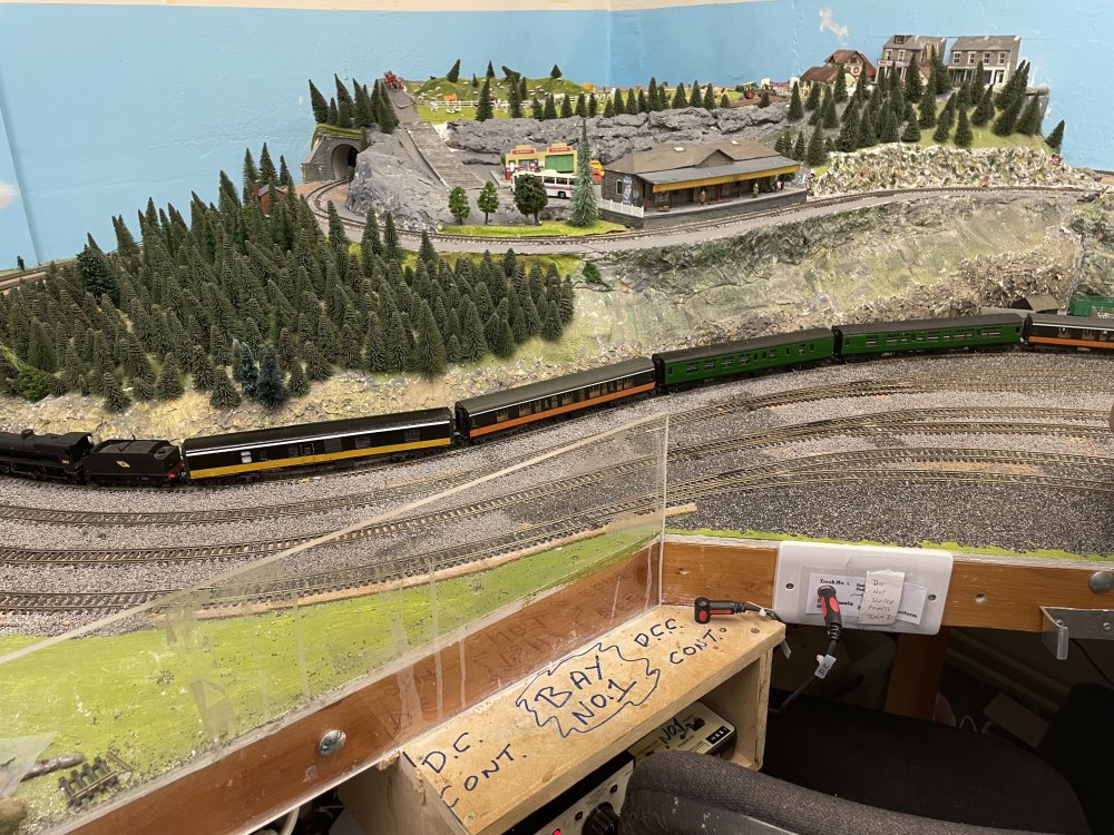

josh_ Posted June 6 Author Posted June 6 From earlier today Had a lil problem but fixed easily Paint stuck to the paper causing both layers to rip off Earlier this evening Both running in my clubs layout (MRSI) Now gotta do the decals soon when I swing by marks to pick up one or 2 hornby express points IMG_6962.mov IMG_6963.mov Before and after of clearing the paper fort for painting

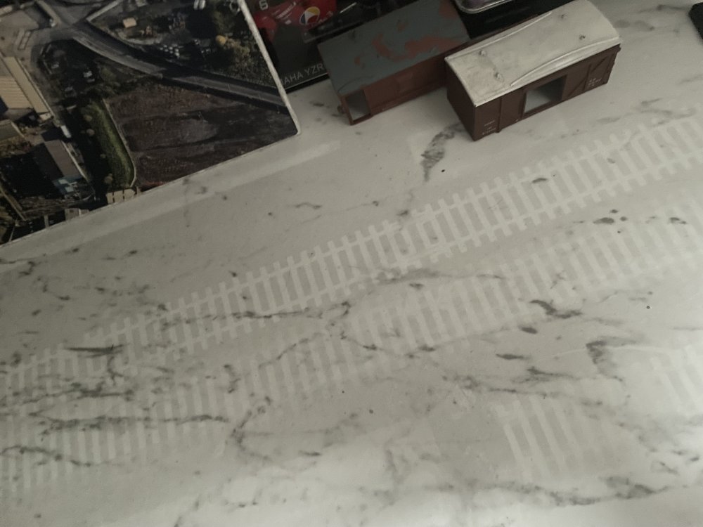

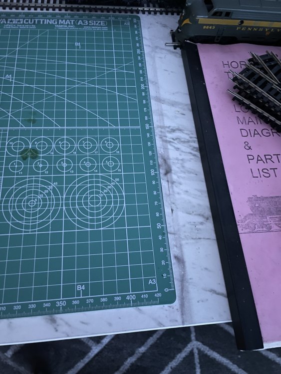

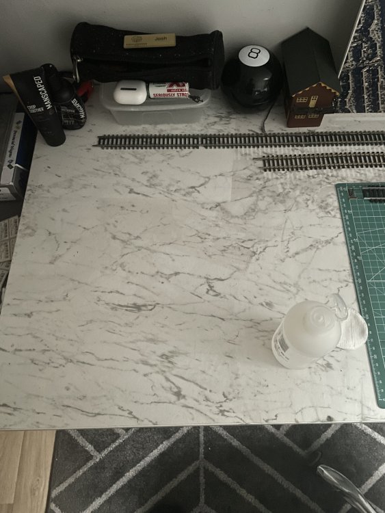

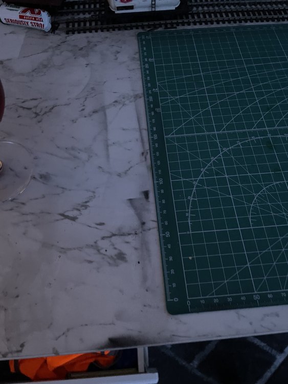

josh_ Posted June 6 Author Posted June 6 Uh oh Any tips gents? The tables mdf and spray paint stained on it was those big Pringle tin size industrial spray cans for your info
Mol_PMB Posted June 7 Posted June 7 9 hours ago, josh_ said: Paint stuck to the paper causing both layers to rip off I'm delighted to see that you're learning about repainting models, and improving your skills as you go. Starting with a couple of cheap coaches is a great idea as a learning exercise, and they're looking good. In this case think you're trying to work too fast. The green hasn't properly dried before you have turned the coach side over to do the brown. Another thing to think about is the preparation of the parts before painting. If you want the paint to stick well, they need to be clean, dry and free of grease, so it's a good idea to clean them first and then let them dry properly. 20 hours ago, Georgeconna said: Good effort but you seem to be layering on the paint way too heavy,. A few light coats each time to build it up is the way to go. I agree with this. You'll get a better finish, and it will dry more quickly, with a series of thin coats. Where you're using green to cover red, it would be better to start with a light grey primer, which will neutralise the red colour and help you achieve a good even green colour without the paint having to be very thick. I suspect there's little you can do to remove the paint from the worktop. If the surface is MDF then trying to remove it either by chemicals (e.g. thinners) or mechanically (scraping/sanding) is likely to make things worse. A couple more thoughts. Think about the order you do the painting. On the coach sides it might have been better to do the brown interior first, then finish with the green exterior which is the most visible. And you might consider something to hold the parts while painting, even if it's just a couple of matchsticks to keep them clear of the newspaper. Finally, make sure you're working in a well-ventilated area with those spray paints. Keep up the good work! 2 1 1
Georgeconna Posted June 8 Posted June 8 On 6/6/2025 at 11:23 PM, josh_ said: Uh oh Any tips gents? The tables mdf and spray paint stained on it was those big Pringle tin size industrial spray cans for your info Cellulose thinners will move that but not on your cutting mat. On 7/6/2025 at 8:52 AM, Mol_PMB said: I'm delighted to see that you're learning about repainting models, and improving your skills as you go. Starting with a couple of cheap coaches is a great idea as a learning exercise, and they're looking good. In this case think you're trying to work too fast. The green hasn't properly dried before you have turned the coach side over to do the brown. Another thing to think about is the preparation of the parts before painting. If you want the paint to stick well, they need to be clean, dry and free of grease, so it's a good idea to clean them first and then let them dry properly. I agree with this. You'll get a better finish, and it will dry more quickly, with a series of thin coats. Where you're using green to cover red, it would be better to start with a light grey primer, which will neutralise the red colour and help you achieve a good even green colour without the paint having to be very thick. I suspect there's little you can do to remove the paint from the worktop. If the surface is MDF then trying to remove it either by chemicals (e.g. thinners) or mechanically (scraping/sanding) is likely to make things worse. A couple more thoughts. Think about the order you do the painting. On the coach sides it might have been better to do the brown interior first, then finish with the green exterior which is the most visible. And you might consider something to hold the parts while painting, even if it's just a couple of matchsticks to keep them clear of the newspaper. Finally, make sure you're working in a well-ventilated area with those spray paints. Keep up the good work! Good words from the Maestro 1
josh_ Posted June 8 Author Posted June 8 On 7/6/2025 at 8:52 AM, Mol_PMB said: I'm delighted to see that you're learning about repainting models, and improving your skills as you go. Starting with a couple of cheap coaches is a great idea as a learning exercise, and they're looking good. In this case think you're trying to work too fast. The green hasn't properly dried before you have turned the coach side over to do the brown. Another thing to think about is the preparation of the parts before painting. If you want the paint to stick well, they need to be clean, dry and free of grease, so it's a good idea to clean them first and then let them dry properly. I agree with this. You'll get a better finish, and it will dry more quickly, with a series of thin coats. Where you're using green to cover red, it would be better to start with a light grey primer, which will neutralise the red colour and help you achieve a good even green colour without the paint having to be very thick. I suspect there's little you can do to remove the paint from the worktop. If the surface is MDF then trying to remove it either by chemicals (e.g. thinners) or mechanically (scraping/sanding) is likely to make things worse. A couple more thoughts. Think about the order you do the painting. On the coach sides it might have been better to do the brown interior first, then finish with the green exterior which is the most visible. And you might consider something to hold the parts while painting, even if it's just a couple of matchsticks to keep them clear of the newspaper. Finally, make sure you're working in a well-ventilated area with those spray paints. Keep up the good work! Thanks so much for that reply that made my day The coaches i initially wanted to sell but had no luck and picked them up one day and thought "they could pull off laminates if i did them up" and then it all started from there Only problems i faced were getting the plastic off and matching the roof as one looked like rhino skin and the other was perfectly smooth I did have them clean and dust free, there was scuffs on the original factory paintwork but a thin layer or 2 of paint covered it perfectly but id definally go use a primer next time Ill try nail polish remover to try it ill post the results I think i did it from roof, inteiror and them the sides and for the matchsticks, could sthin strips of cardboard or even custom small wood stand work? My rooms small but always got my window and door open day and night and thanks so much for the advice 4 hours ago, Georgeconna said: Cellulose thinners will move that but not on your cutting mat. Good words from the Maestro Never thought of cellulose, ill see if i have some lying around Right gents, Just swiped my mams acetone(nail polish remover) Got cotten pads too ill post before and afters 1

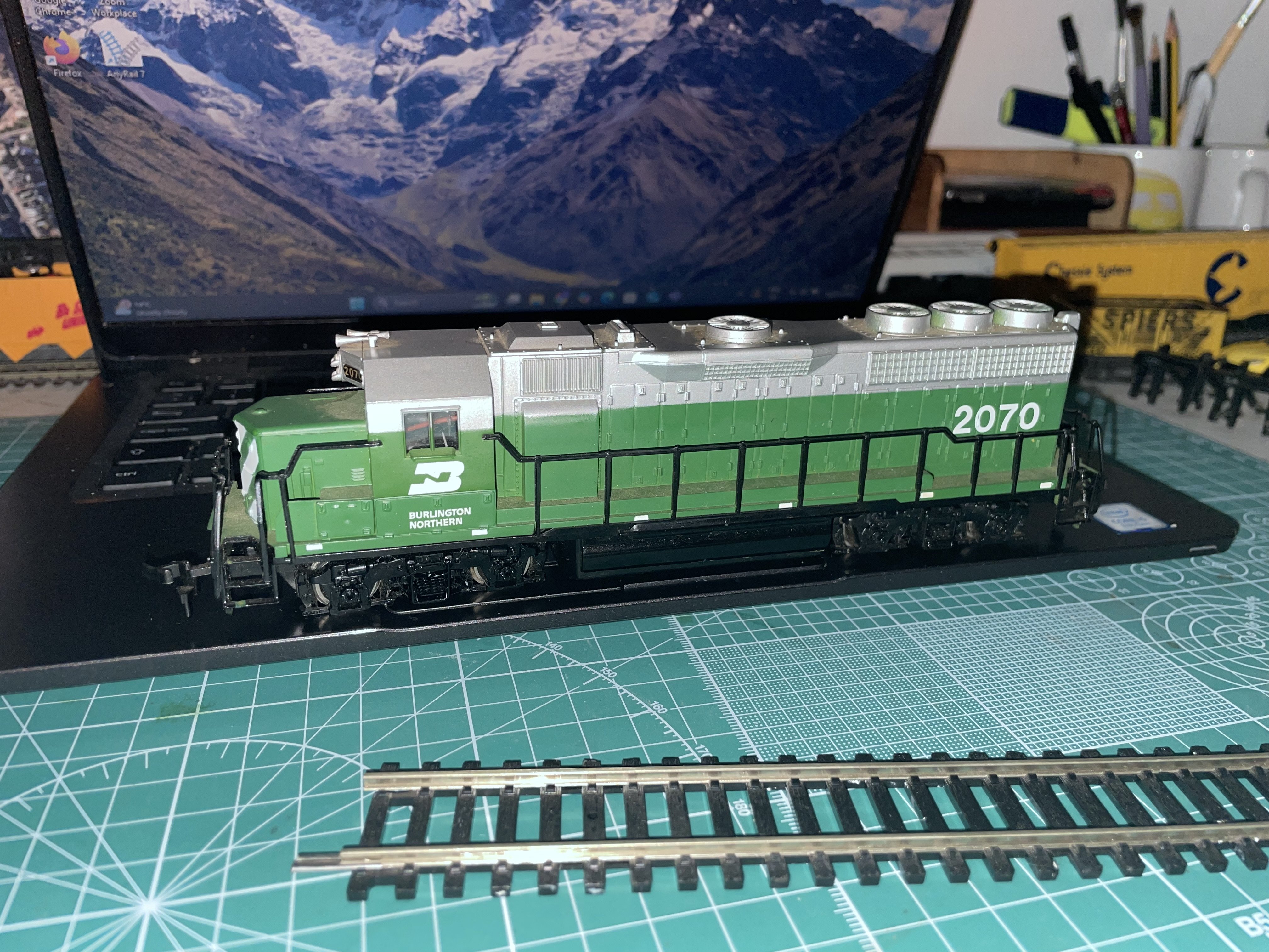

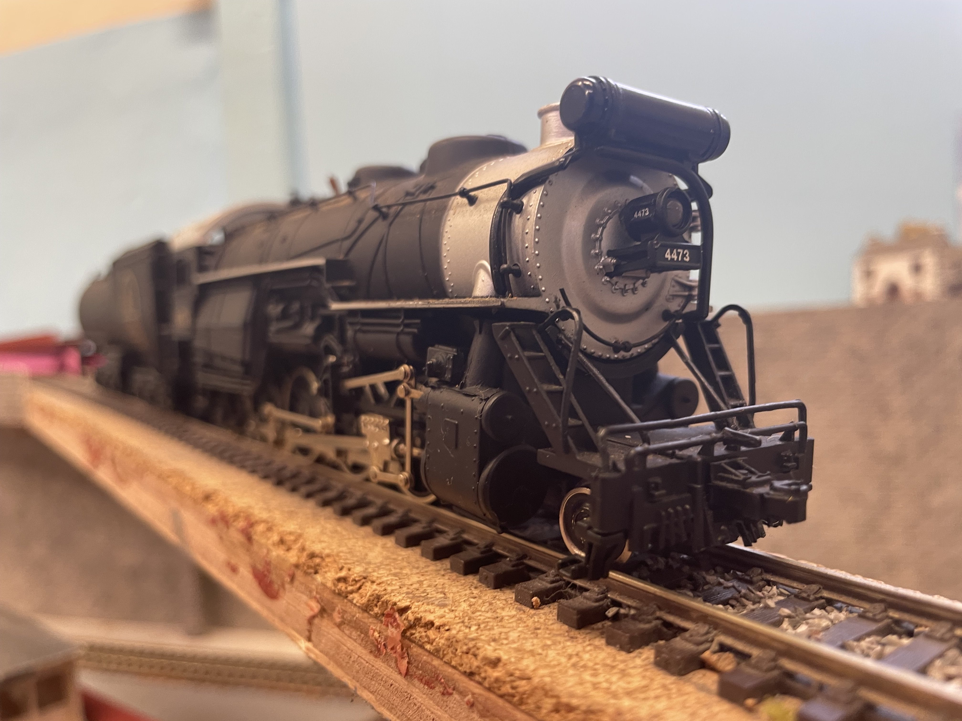

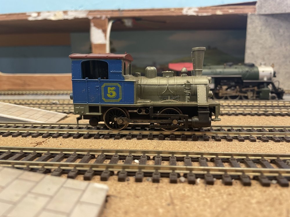

josh_ Posted July 28 Author Posted July 28 Apologies it’s been a while been up to mostly railway shenanigans and waiting around on a carpenter for my other topic Connolly Shed Now I started work on these projects yesterday Its an old Bachman. 2-8-0 consolidation So far stripped it, put some the plastic gears in distilled malt vinegar to clean it but I first thought of nicking the last drop of my dads grey goose which could of worked as good I also got another 2-8-0 and a diesel (I forget the class of loco) there all American as maintaining my grandads old athearn 4f’s and making a complete freight set I grew a connection with collecting the older Bachman and athearn stuff
josh_ Posted July 28 Author Posted July 28 Here’s some pics and videos I got of them IMG_8703.mov IMG_8704.mov Some clips showing how aged they are 3
josh_ Posted July 28 Author Posted July 28 Some more that took ages to send IMG_8707.mov IMG_8712.mov IMG_8709.mov IMG_8747.mov IMG_8750.mov IMG_8751.mov IMG_8753.mov IMG_8754.mov

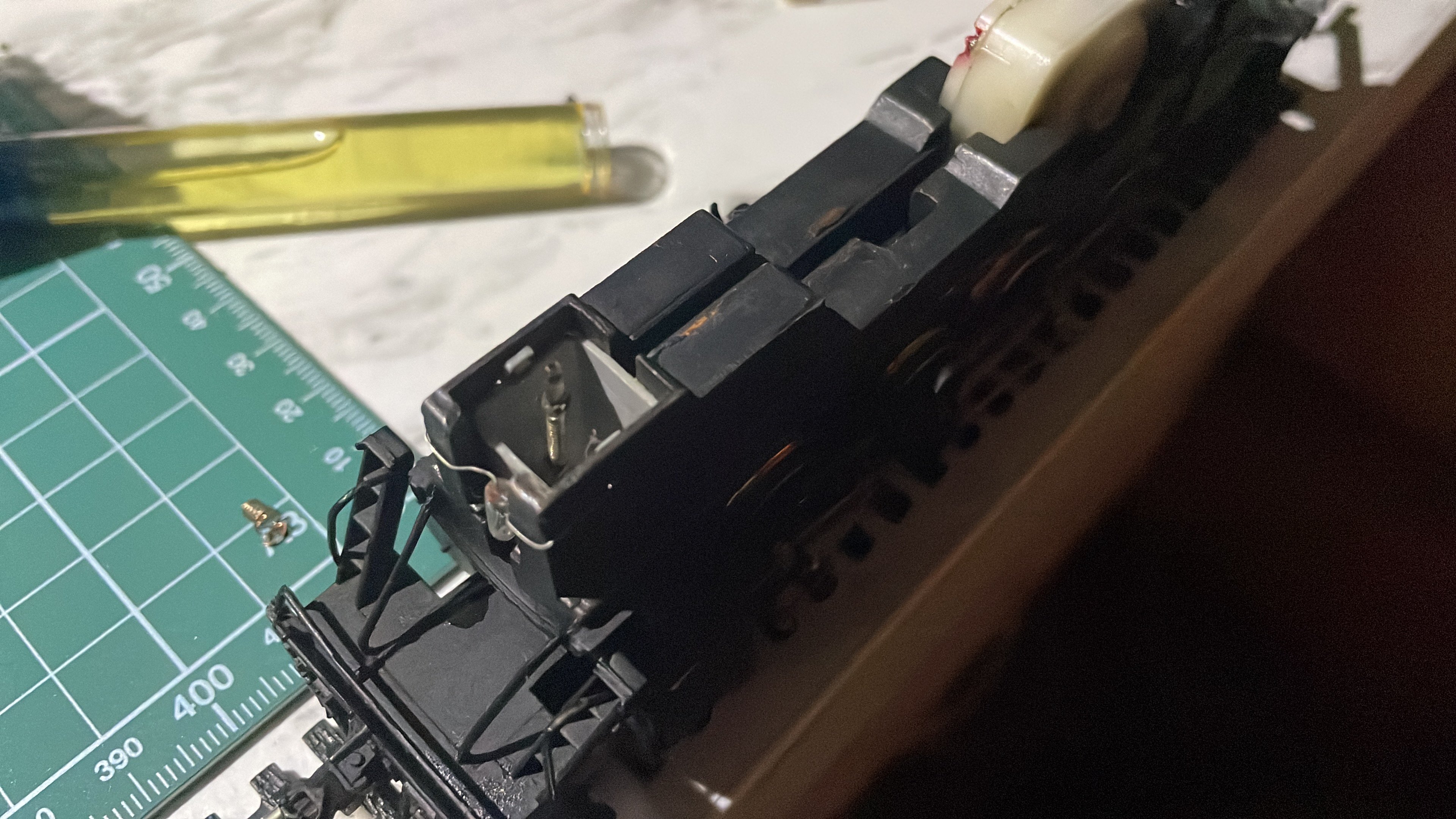

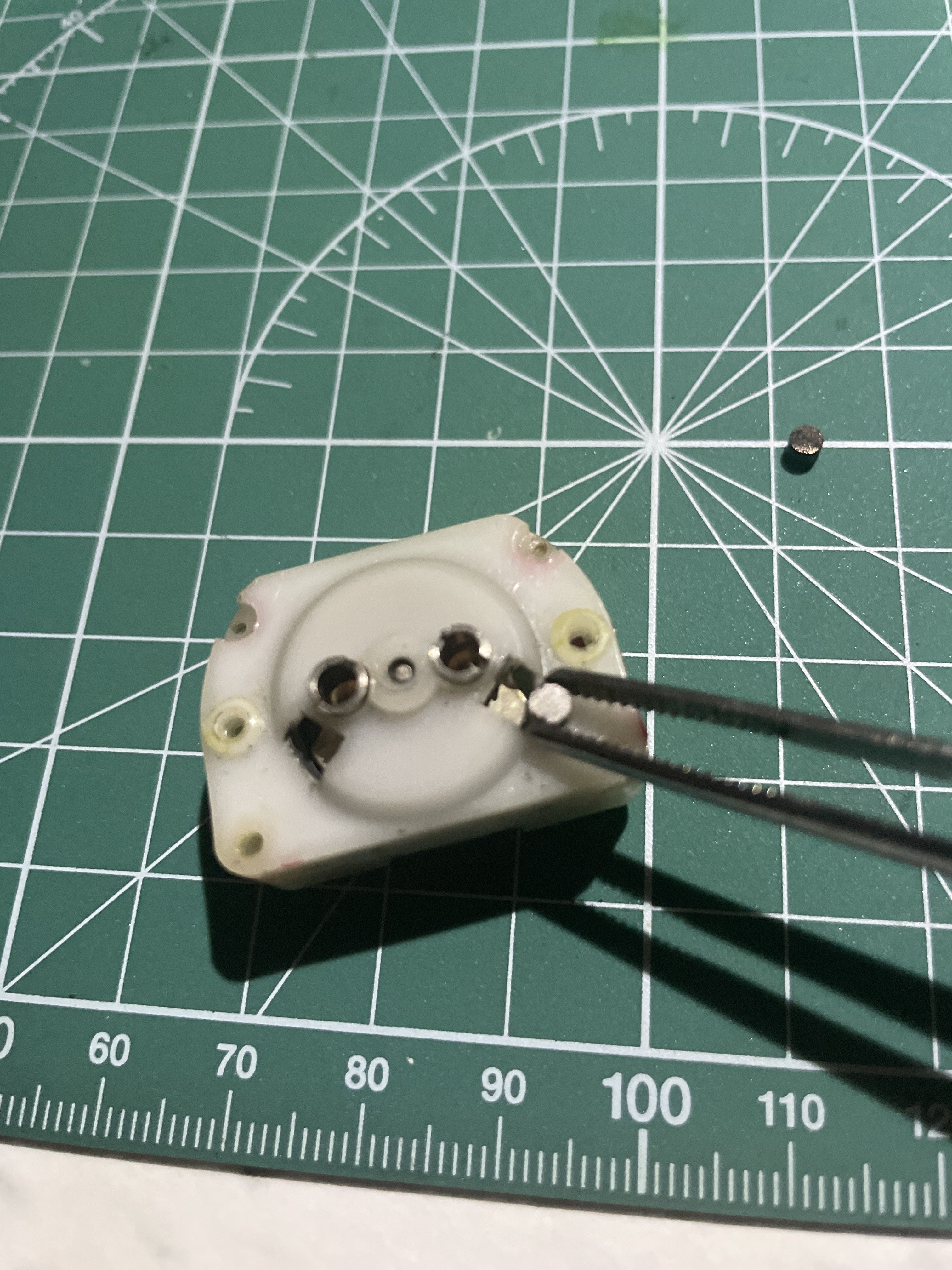

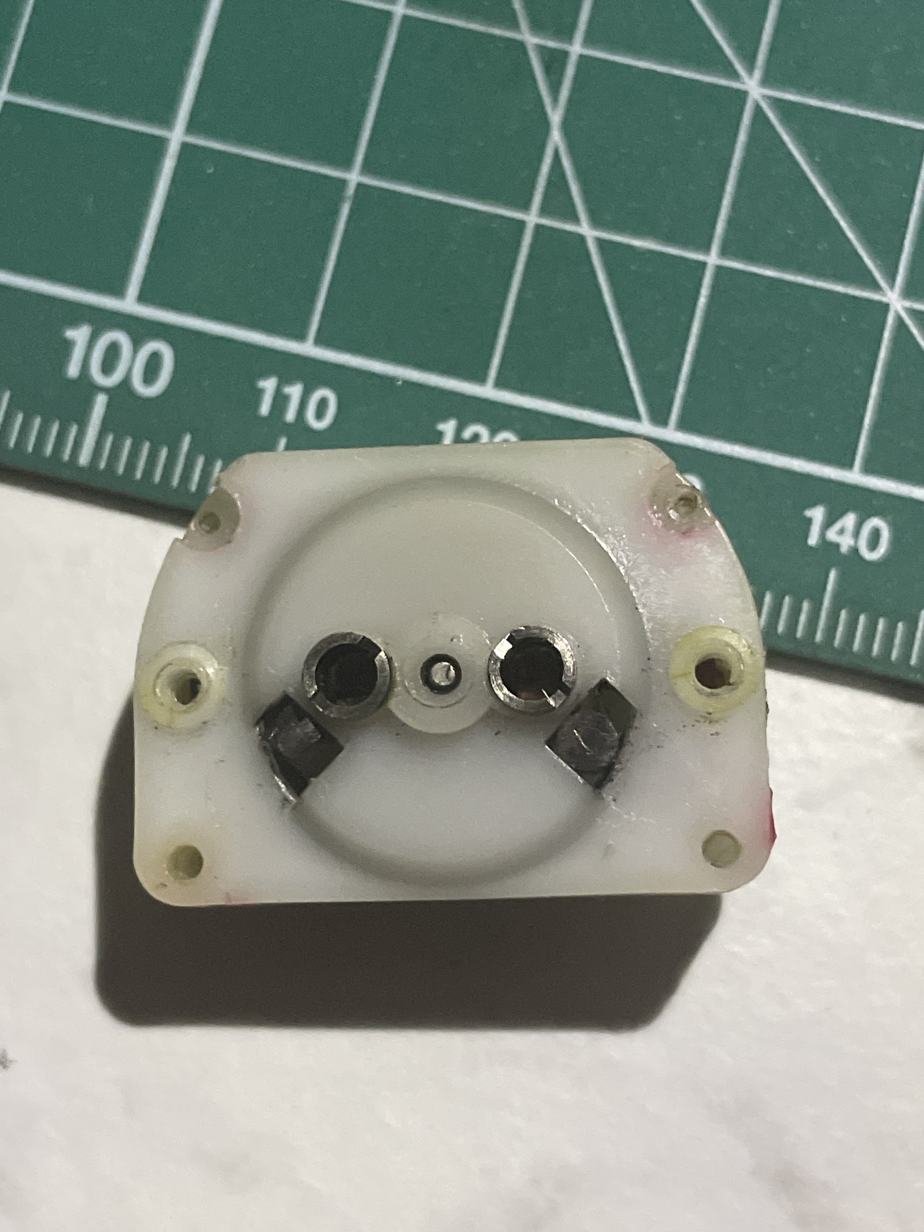

josh_ Posted July 28 Author Posted July 28 I have a problem I had 2 very small steel circles pop out when I opened up the motor I’m unsure where they go Any ideas from those who are more experienced and knowledgeable on model motors IMG_8984.mov
GSR 800 Posted July 28 Posted July 28 (edited) 25 minutes ago, josh_ said: I have a problem I had 2 very small steel circles pop out when I opened up the motor I’m unsure where they go Any ideas from those who are more experienced and knowledgeable on model motors IMG_8984.mov They're the motor's brushes. They should be sprung, though idk if pancake motors achieved it via regular springs or a type of plate? Edited July 28 by GSR 800
josh_ Posted July 28 Author Posted July 28 I wanna leave them out at the same time I sense that they could be a key component Ill open it up and show inside the motor IMG_8985.mov
GSR 800 Posted July 28 Posted July 28 5 minutes ago, josh_ said: I wanna leave them out at the same time I sense that they could be a key component Ill open it up and show inside the motor IMG_8985.mov motor wont work without them, they carry current through 1
GSR 800 Posted July 28 Posted July 28 14 minutes ago, josh_ said: Should they be placed in the holes here? almost certainly in the two inner holes yes, though they should be sprung. 1
josh_ Posted July 28 Author Posted July 28 There solid I put them in but which way is better left or right? I’m personally feeling the right but unsure
josh_ Posted July 28 Author Posted July 28 I managed to get them through the holes at the front shown in the video is that right place to put them? 77543933710__2776ECDE-A24D-4B45-9266-39C7FA994936.MOV
josh_ Posted July 29 Author Posted July 29 3 hrs later there done after a lot of repeated stripping and fidgeting with the underside and finding other problems the 2 are now resting funny built back now the ill work on Connolly tmr and show the progress and more info on that topic as well as post the diesel tmr 2
josh_ Posted August 2 Author Posted August 2 Attempted at running it Didnt budge an inch But produced steam as i got baby oil I didnt know u had to put abt 2-3 drops of the oil in the funnel, i put abt half a cap full in it and it was fogging up the layout, and had this damp smell off it, like stale hot candle wax(didnt stop a crowd from forming) Now gotta strip it again and test it on some track at my bench and see hopefully i can get it moving perfectly As it was my first time stripping a loco and reassembling it, im not surprised thinking back Was also pretty stupid to work on 2 identical models as parts likely got mixed but u learn

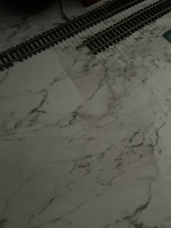

josh_ Posted 2 hours ago Author Posted 2 hours ago After a lot of grunts, moans and a lot of sweeping dog hairs The tracks connected gonna click it to the controller and then try think of ways to prevent dust and dog hair getting at it tomorrow 1
