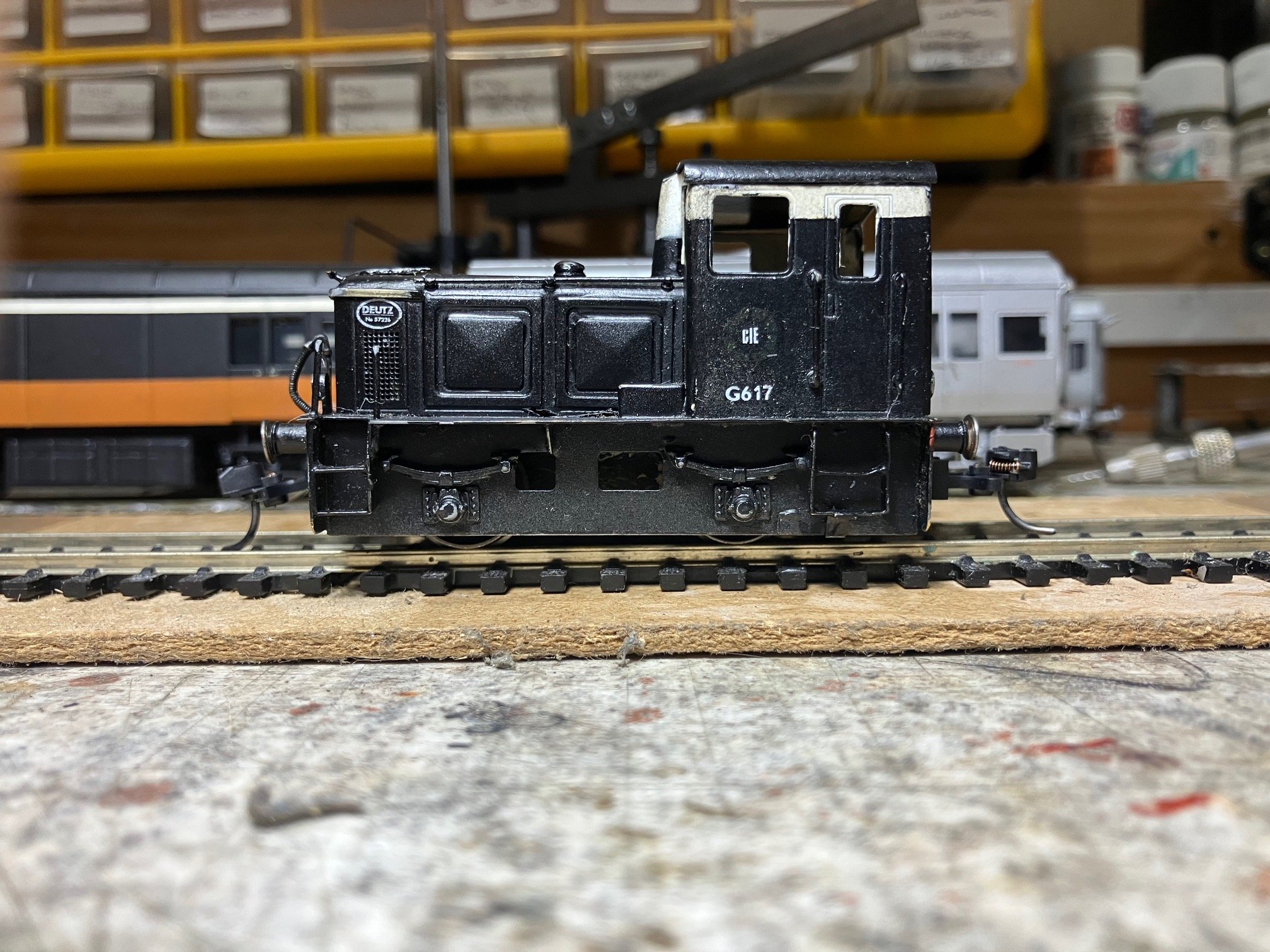

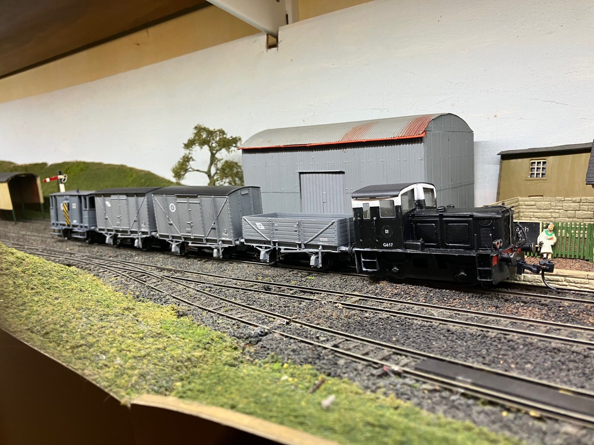

Managed to find the remains of the decal set I used when I originally "completed" G617 (goodknows when) complete with replacements for the obliterated/damaged numbers and CIE, I also found a 'stash' of 6pin 1-2amp decoders I bought from the States several years ago but never used, when I had a problem with 0.7 amp decoders blowing on kit built locos.
I am using "Gun Blue" as a blackening agent in areas where paint damaged/chipped exposing brass before touching up paintwork
So at this stage a case of paint touch-ups and clear varnish to seal the decals and protect the paintwork.

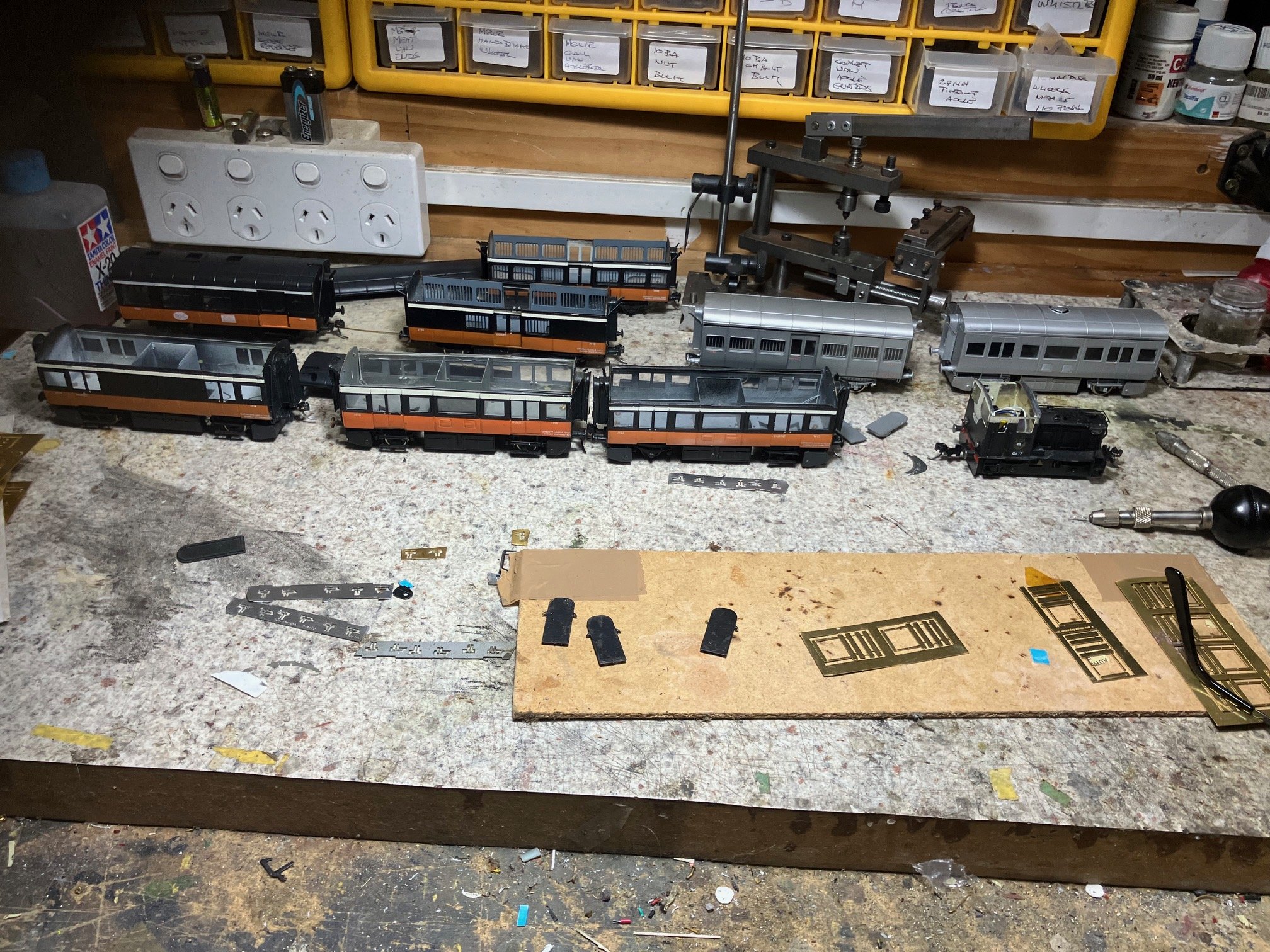

Big break through this week cleared tools and accumulated junk from the workbench to complete a flotilla of Tin Vans I started between 5-years ago.
The Vans were substantially complete, mainly door handles, gangway ends to add, replace some damaged/missing steps and complete paint touch ups to G617.

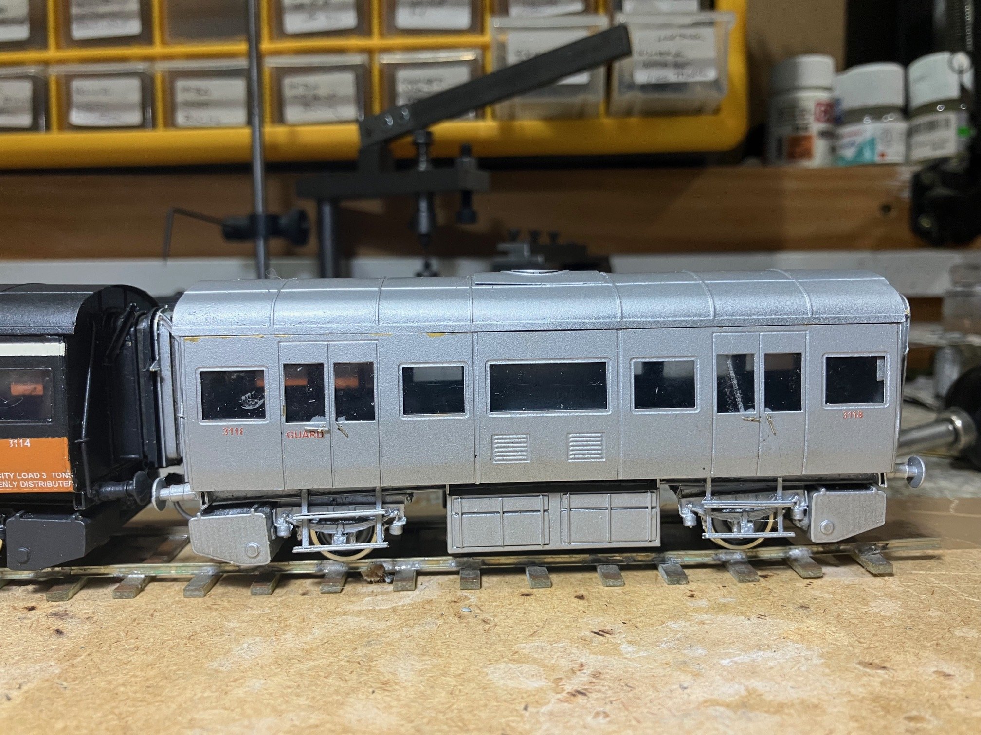

3111 Tin Van 1955 as introduced condition, unmodified doors. Although I fitted door handles on previous builds, I found it challenging this time around over 10 years after I initially produced the kit.
I need to adjust the axleguard assembly on the righthand side!

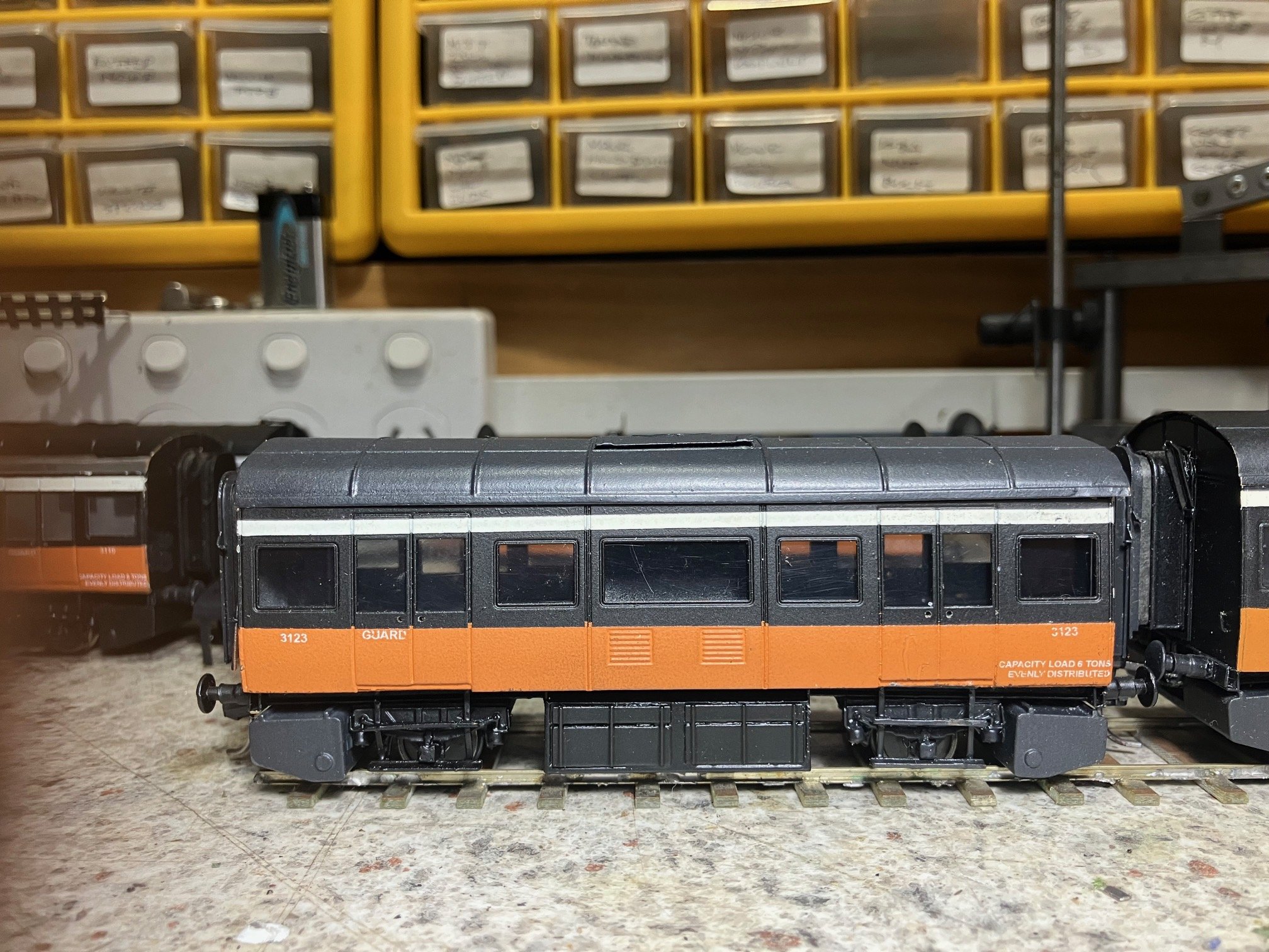

3123 with modified doors an early modification to these vans.
3114 a van with the majority of windows replaced with plain panels & 3111 a van in original as introduced condition. 3114 is based on a late 60s David Malone photo of the van at Sligo.

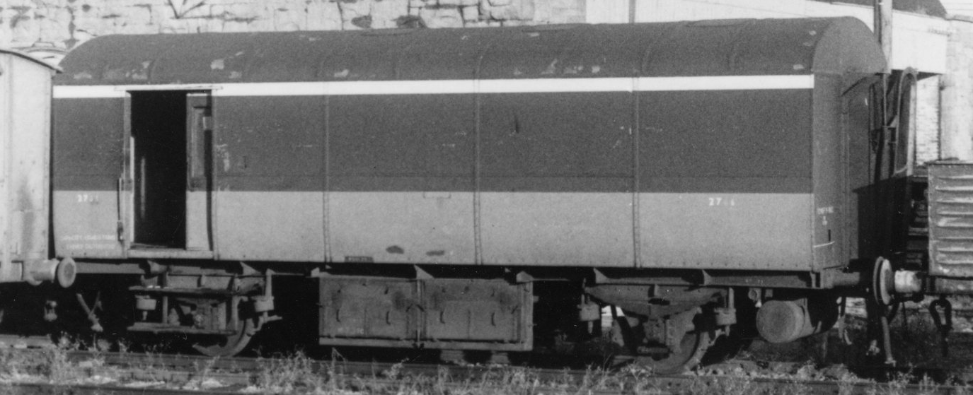

Loosely on this topic, here's one of the TPOs as later converted into a luggage/parcels van. Letterboxes sealed, and renumbered in the 27xx series - possibly 2766. I'm not sure if there were any other changes - possibly the rooflights plated over.
29 minutes ago, Mol_PMB said:
Looking good, John!
I think the roof lights were inded covered over. But there were only a small number of these four-wheeled TPOs. Two, as you know, ended up in PW use, with gangways removed too. One, the last survivor of any type of tin van at all, is now at Downpatrick undergoing restoration. It will be used there as a genny / luggage / brake van.

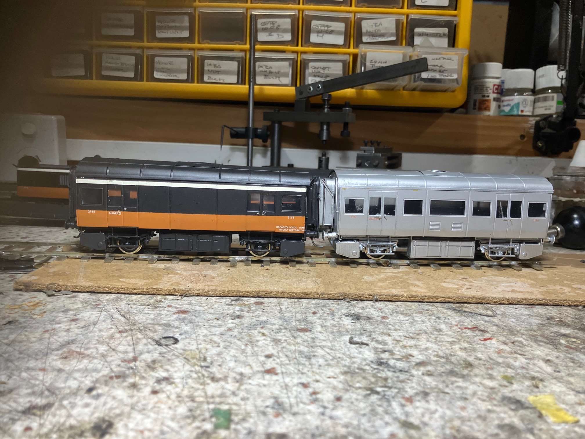

Finally managed to find some time this week to almost finish the Tin Vans one or more of which started over 10 years ago, though still have to replace the glazing on one van and fit door handles to several!
Silver Vans finished in Tamiya "Bare Metal Silver" aerosol, the Heating Van was assembled fro the 1st batch of kits released 10 or so years ago, the Luggage Van from the 2021 batch. Both vans are 21mm gauge, I haven't gotten round to fitting couplers to the Heating Van, I am thinking of replacing the Kadees on my 21mm stock with B&B couplers reliable delayed uncoupling and less obtrusive than Kadee.
I was inspited to finish these two vans in silver by a series of FW Shuttleworth photo of the Night Mail being made up at Sligo in 57 the consist included a pair of almost brand new Bulleid Vans, a an ex-MGW Meat Van and a ex-MGW 6w TPO dating from the 1880s, a an ex-MGW 2-4-0 shunted the train but likely to have been worked to Mullingar by an A Class.
IMG_7280.jpg.17b7df23909d0d1aef91f770232ff878.jpg d
Consist of the Sligo Night Mail about 15 years later based on photos of Bulleid Vans supplied by David Malone, a UK based modeller who did some pioneering work to promote Irish Broad Gauge modelling in P4 during the 80s & 90s. David assembled a couple of my Vans with fully detailed interiors including a boiler in the heating van and parcels/luggage in the luggage sections.
Luggage Van finished from the original test build of around 10 years ago decals supplied by Des or SSM
Luggage Van in original condition.
Luggage Van with 4 window panels on both side replaced by solid panels.
Heating & Luggage Van with a 3 window panels replaced with solid panels.
G617 had a spruce up after replacing worn decals before return to service. I masked the black paintwork and re-coated the white areas with a Tamiya "Pearl White" (gloss) aerosol, before finishing the loco body with a satin aerosol clear coat, unfortunately the orange on the SSM broken wheel logo does not show up too well aganst a black background!
Having almost cleared my workbench I thought this was a good time to do some urgent repair work on a Large Scale loco before, resuming work on the next unfinished 4mm loco/s project.

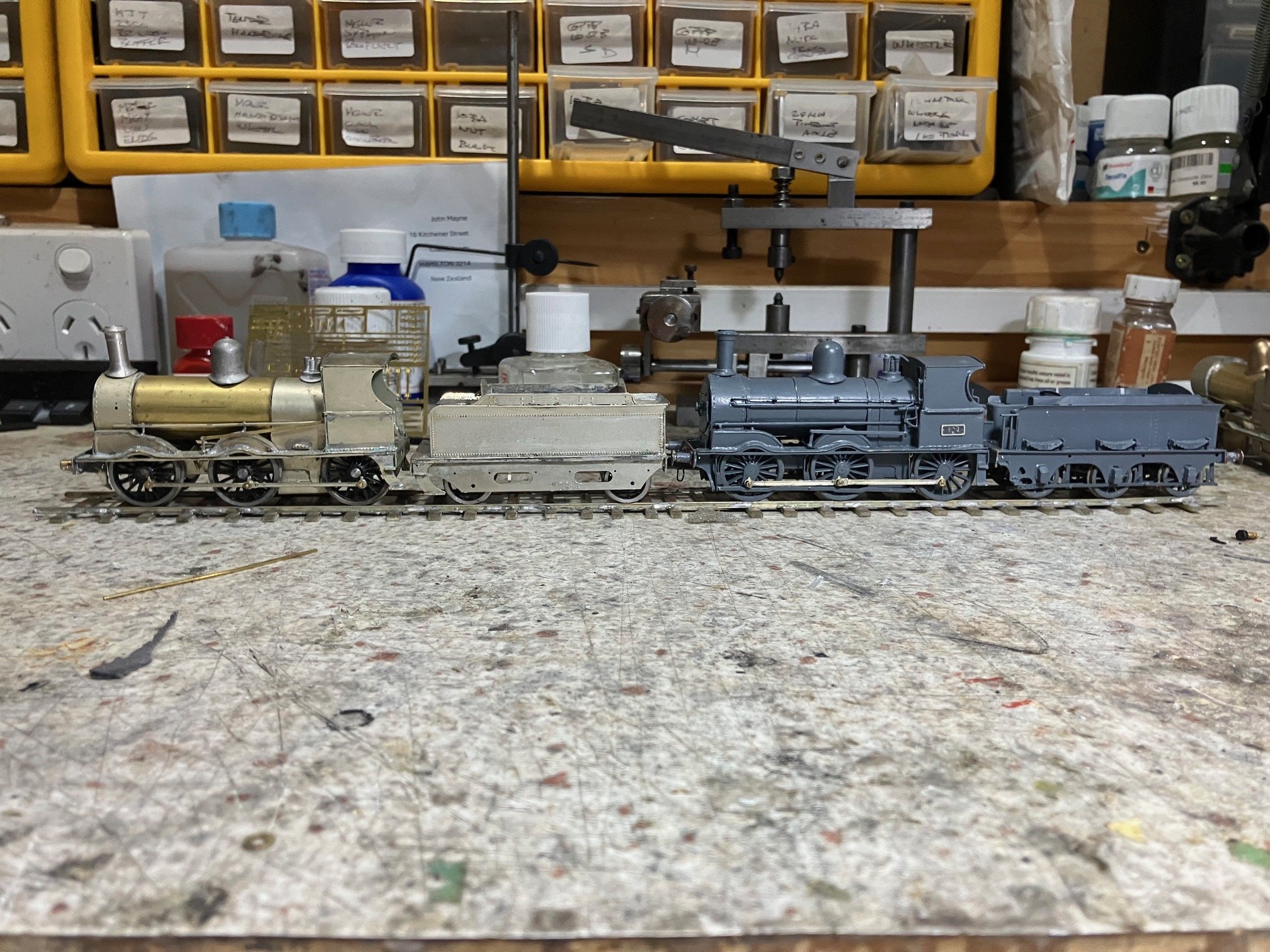

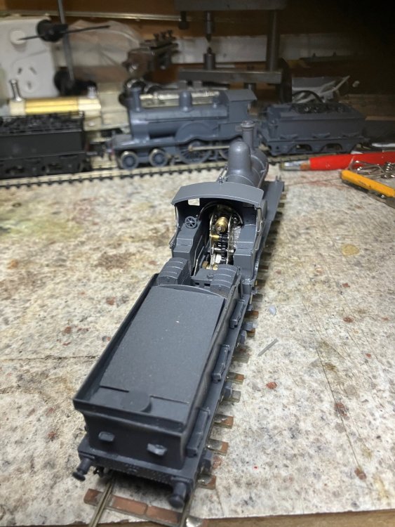

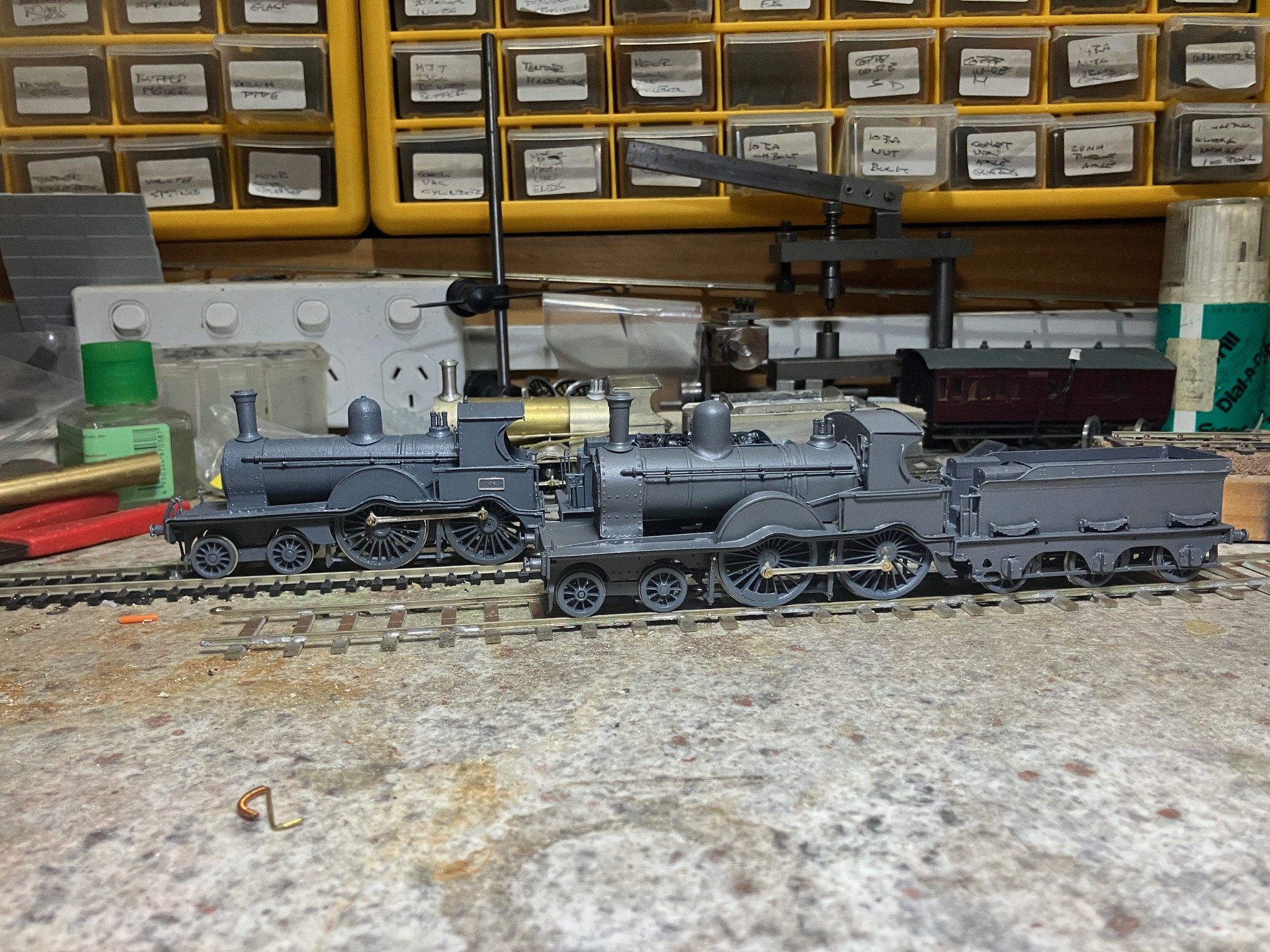

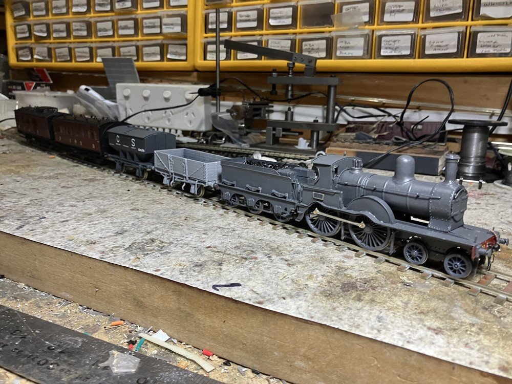

The main upside of (nearly) finishing the Tin Vans is that there is now space in the Shops to complete 229 a Coey J15 one of a pair of SSM kits I bought about 15-16 years ago and started to assemble about 7-8 years ago, but often sidelined by other more urgent, profitable or interesting projects.
The main 'spotting' differences between the "Coey" J15 built in the early 1900s and earlier members of the class were (a) raised sandboxes on the leading splasher, (b) direct reversing lever (at an angle) rather than the "linkage" reverser, curving cab footsteps and slight difference in cab on some locos.
No229 is based on a photo of the loco on a Limerick bound 'overload' goods at Ballycar on the Sligo-Limerick line, a saturated loco running with a larger GSWR Type B tender which indicates that the loco may have been regularly rostered to long distance  goods work.
No229s companion No124 is based on older the (much) more common version of the Class with distinctive lever reverser and more common smaller Type A Tender.
Hopefully I will complete No229 within a shorter time frame than No124 picked up as a part built kit at Expo EM in 2001 and finally completed in 2022, though most of the work carried out since 2018 when I basically dismantked and re-built the chassis.!
