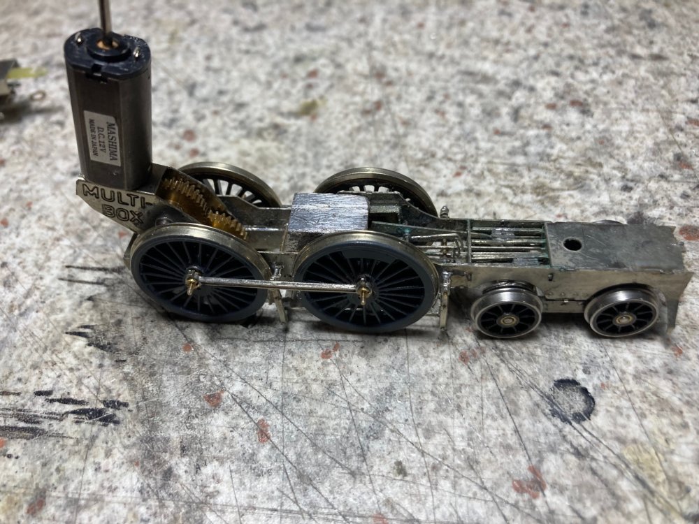

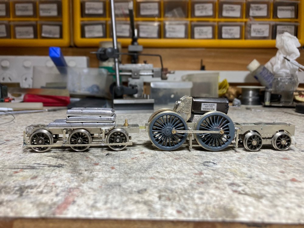

Back to loco building this time a GSWR 52 Class.
I used a Mashima 10X24 motor and 53:1 Branchlines Multibox rather than the High Level 35:1 gearbox and coreless motor I used in earlier builds of this class.
High Level were furloughed (unable to obtain components from suppliers covid supply chain problems) when I ordered the parts in 2021, but fortunately Branchlines had a stock of gearboxes and motors.
I selected the 53:1 box to achieve improved slow speed running and a more realistic top speed, the builds with 35:1 gearboxes turned out to be racers!
I build/assemble 2-4-0s and 4-4-0s with weighted tenders and rigid drawbars to improve traction. The leading and center tender wheelsets are floating free to move up and down in slots lightly sprung to maintain contact with the railhead/power pick up.

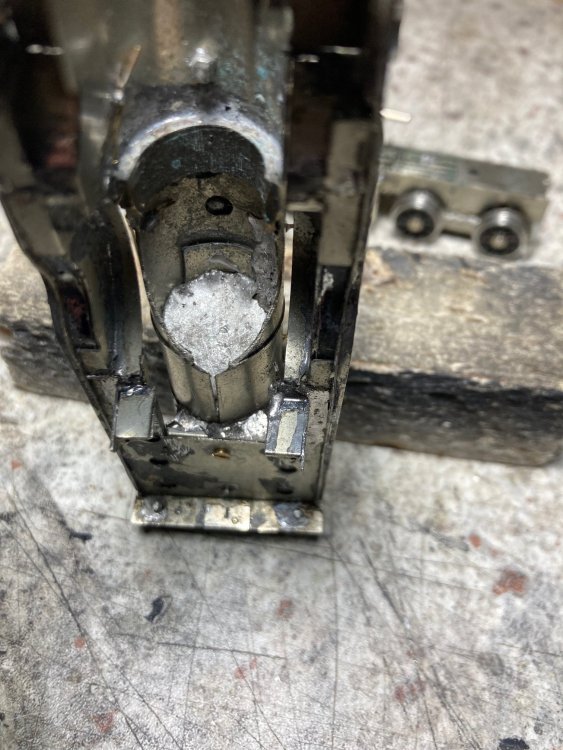

I used self adhesive tyre weights for the tender and cast woods metal weights in the loco chassis and boiler.
Loco and tender wheels are Markits with 'live axle" pick up, the loco is DC the only wiring are leads from the loco and tender chassis to the motor brush terminals, a lot less hassle than wiring a kit or scratchbuilt loco for DCC.
The chassis weight was cast in a rubber mould, the loco literally poured into the boiler.

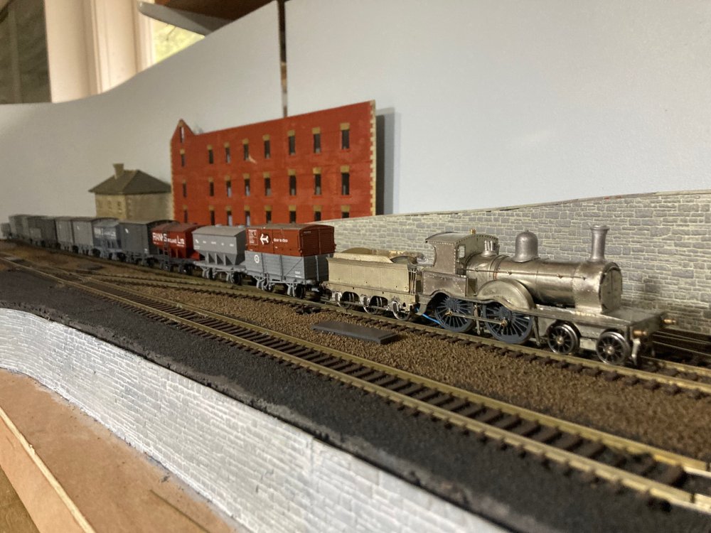

First load test 14 wagons no hint of slipping.
Even with the 53:1 box and motor of similar rated speed to the earlier builds this loco also turned out to be a fast runner.

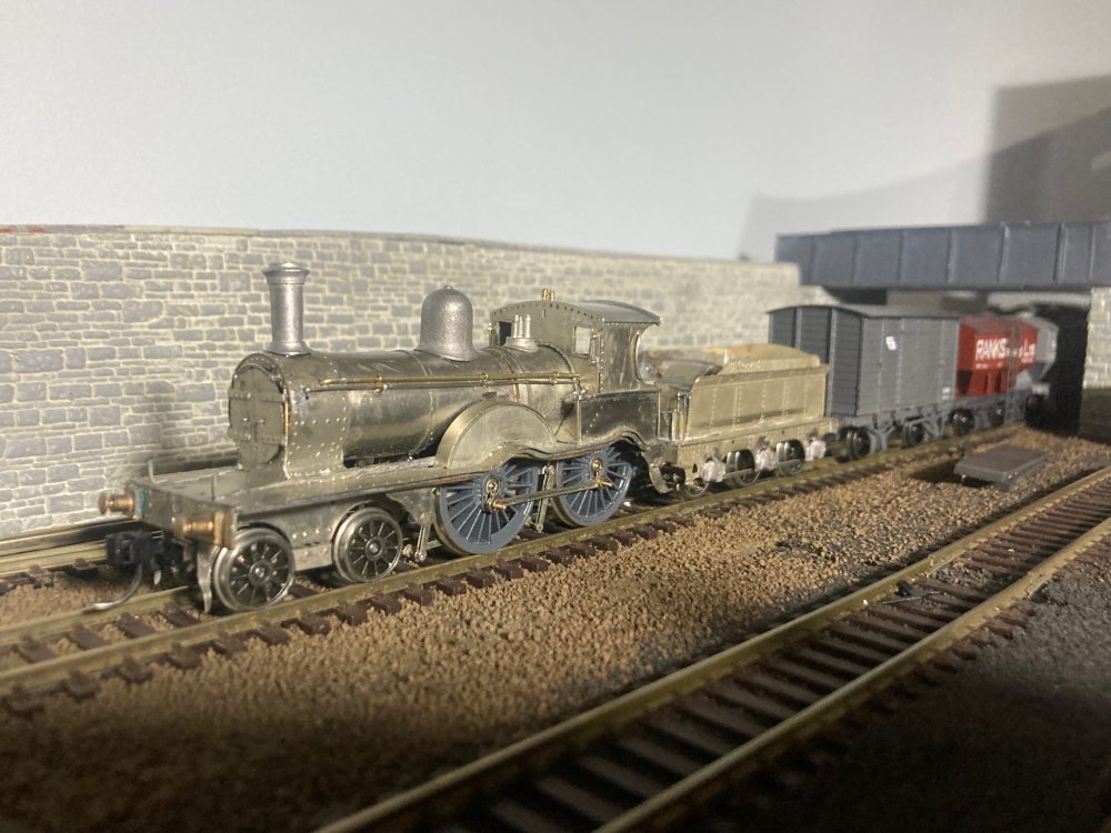

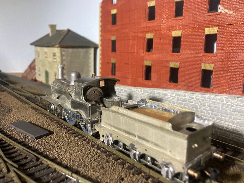

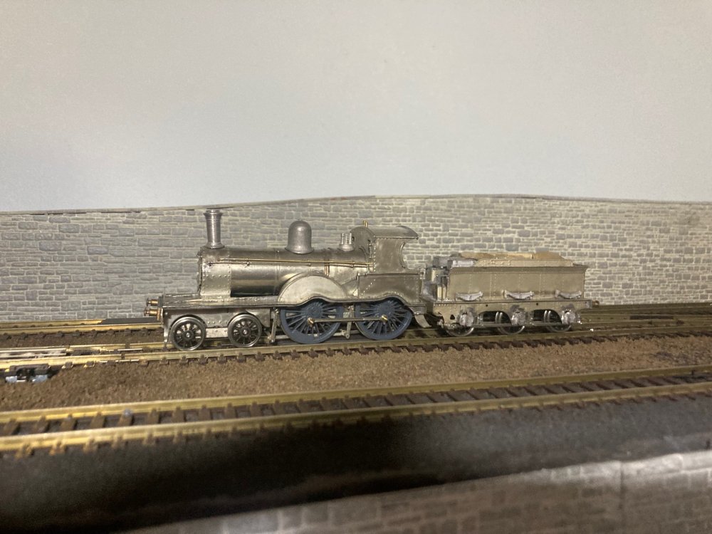

Test running and final detailing including cab interior, fitting smokebox door and vacuum pipe under running board on drivers side.
Earlier photo, did not notice buffers were pointing upwards! Tender springs and tool boxes later removed for painting.
The model is based on a 1939 photo of No59 at Tullow including twin whistles, I have prepared a set of matching numberplates. The 52 Class appear to have been the regular locos on the Kingsbridge-Tullow passenger trains in GSR days possibly up to the end of scheduled passenger (and goods) services in 1947.
The loco is for a customer in the UK hence NEM coupler pockets on the loco. Didn't realise the GSR used knuckle couplers 😉
The challenges of fitting a cab interior to a OO gauge Irish Broad Gauge loco.
Test run  following some "final' adjustments.  Reasonably happy with speed range following light oiling of gear train, axle bearings and crankpins.

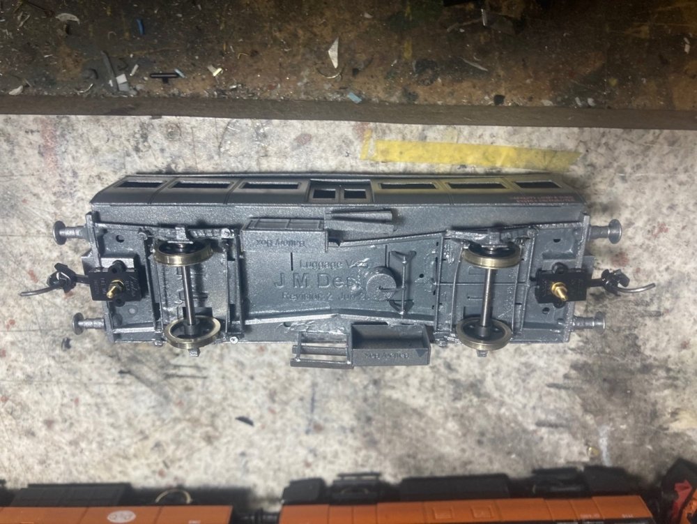

Some activity in the Carriage Shops completing some unfinished projects Tin Vans started between 2012 and 2020.
Fitting Kadee No36 couplers to a Heating and Luggage Van, the best way to achieve close coupling with the JMD 4W vans.
The van is the original test build with 3D printed gangways assembled in 2012.
The vans were designed with a coupling mount for a No 36 coupler, no messing about with NEM pockets!
The coupling mount, Kadee draft gear box and securing nut and washer is completely concealed within the fuel tanks on these vans
The orange peel paint effect is less obvious at normal viewing distance!

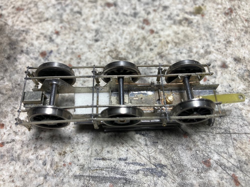

Re-powering a Duetz.
I built a G611 Class Deutz from a Worsley Works set of parts powered by a Black Beetle motor bogie several years ago, and recently decided to replace the motor bogie with a conventional chassis with a coreless motor driving 2 stage gearing to allow for a more realistic top speed for a shunting locomotive.
The Duetz is supplied with a neat 21mm gauge fold up chassis I decided to use the Worsley Works chassis as a template for a scratchbuilt OO gauge chassis using O.4mm  nickel silver strip and turned OO gauge frame spacers supplied with a SSM loco kit.
First task was to cut two strips over length, thin and solder the strips together before drilling out pilot holes for the axles in the Unimat set as a vertical drill.
I then used the Worsley Works chassis as a template for scribing the final frame profile cutting with a razor saw
I also used the pillar drill to drill the pilot holes for the frame spacers before separating the two strips of nickel silver
Assembled main frames motor and High Level Gear box cradles
I am planning to use two High Level Road Runner Compact gearboxes with 60:1 gearing through a layshaft powered by "Tender Riser" with 1:1 step down gearing, I used similar drive systems to power as an Impetus Ruston & Hornsby 88 DS loco during the 1990s.
I carried out a test assembly of the chassis to make sure the drive components fitted before soldering the frame spacers in place.
Luckily the motor fits within the bonnet/engine housing with space to add some weight.
I designed the chassis with one fixed and one rocking axle to improve power pick up. the "rocking axle" is designed to pivot in the gear cradle around the layshaft, it will be interesting to see if it actually works in practice!
Its likely to take some time before I can test the chassis under power. I need to source some 2mm-1.5mm brass tube from the UK to sleeve the motor shaft the nylon gears supplied by high level are 2mm bore, which should give me time to find the cab roof, complete the glazing and locate some large diameter buffer heads.

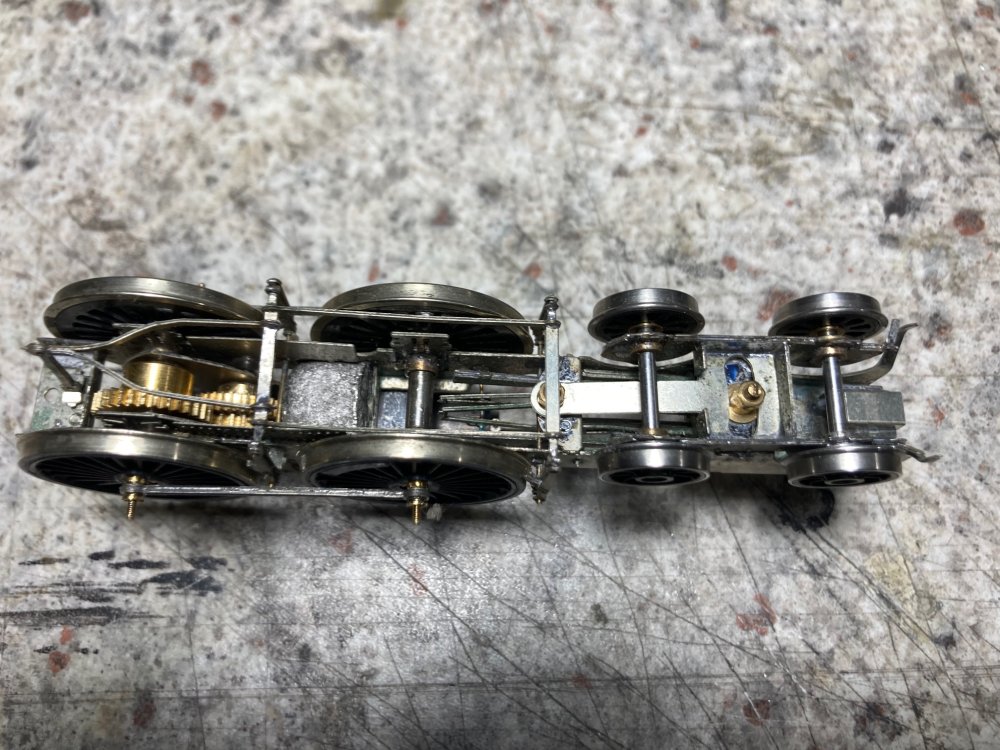

Family gone to the Cinema to see Avatar 2 this afternoon which means I got a chance to play trains in the workshop!
G617 Chassis now ready for final assembly. Some last minute changes included fitting mounting plates with 8BA captive nuts at each end for Kadee couplers
Starting the final assembly
The motor drives a layshaft through a 1:1 "Tender Riser", the final drive to the axles is through two "Road Runner Compact" gearboxes.
A common arrangement in N and 009 locos I used a similar drive system in a RH DS88 shunting loco and a CDR railcar built during the late 80s early 90s
The first challenge was fitting the output gear to the Tender Riser, I used a "narrow" gear which is a push fit on the shaft.
The chassis is compensated with one fixed and one rocking axle gearbox/final drive unit, the "rocking' end of the layshaft is supported by a frame spacer & top-hat brush.
Final drives assembled with worms Loctited to the shaft. The top of the RH gearbox looks rough, I trimmed the top of the gearbox cradle (non structural) to allow the motor to fit.
The biggest challenge to the project was fitting the output gear to the motor.
the TendeRiser is designed around 2mm bore gears, while motors are currently available with 1mm and 1.5mm shafts.
I originally planned to buy 2mm-1.5mm bore brass tube from Eileen's Emphorium as no suitable tune was available locally, but managed to find a small section of 1.5mm bore tube in the scrap box.
I opened up the brass centered gear to a sliding fit on the tube using a tapered broach before Loctiting the gear to the tube and the tube to the motor shaft
Chassis almost ready for testing, fit pickups and allow Loctite 24 hrs. to set!

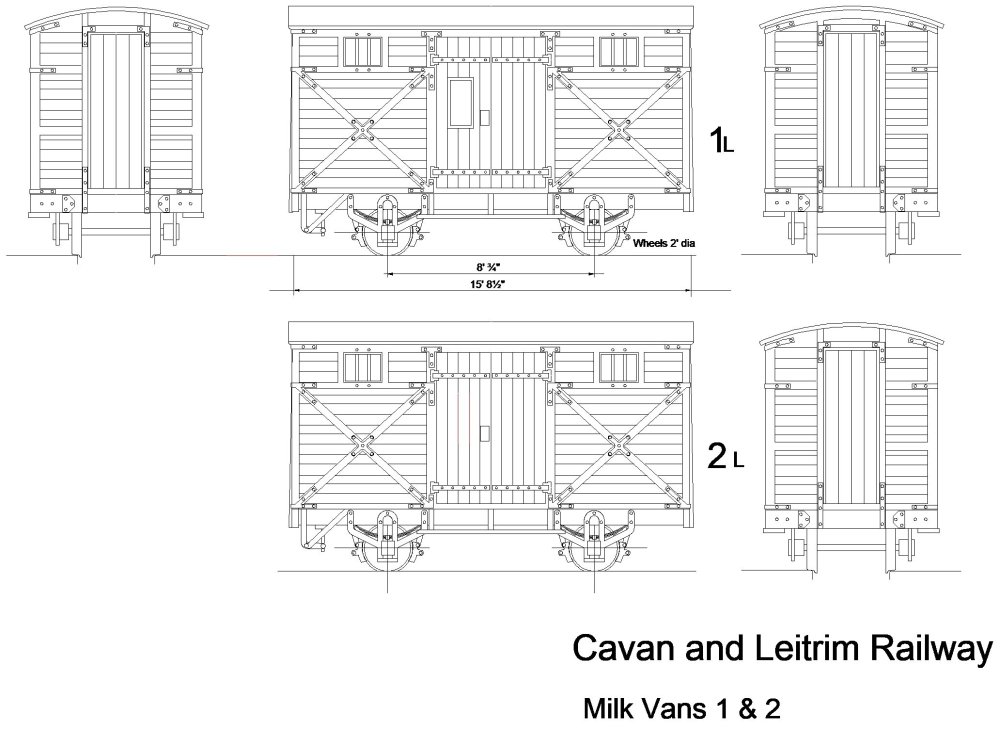

Cavan and Leitrim Railway Milk Vans 1&2.
Used as passenger brake vans on C&L Main Line trains in GSR and CIE days, these Ballinamore built vans were distinctly different in outline and appearance to the original Metropolitan Passenger Brake Vans.
No.12L - 2-4-2T, built 1899 by Neilson Reid & Co., Works No.5563, as Cork, Blackrock & Passage Railway No.6 - 1925 to GSR as No.6p - 1934 to C&LR as No.12L - withdrawn 1959 on line closure - seen here at Ballyconnell.
The starting point was to prepare a 2D tracing from DGCs 1961 drawing and photos from the IRRS Flickr Site.
The research was interesting revealing considerable detail differences between the two vans during CIE ownership IL retaining its original side doors with droplights, while 2L lost its droplights, with different framing at (least)one end. The end posts on both vans had a distinctive inward taper from solebar to roof level a trap for the unwaryCLMilkVan12CIEcondition.thumb.jpg.8e449c34453a4099d59bdfccebfb39f4.jpg
The next step is to prepare a 3D model of the van which could take some time!
