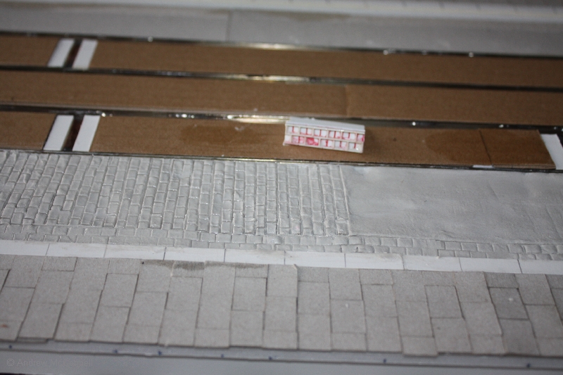

Glenderg Posted February 11, 2014 Posted February 11, 2014 (edited) Des, One method I've seen is where you roll the DAS clay out on crumpled up clingfilm or tin foil, and you use a piece of dental floss or fine fishing line to make the horizontal coursing. You could strap several to two pieces of timber to make an "egg slicer" effect if you wanted to speed things up? The vertical joints can be sorted with a blade of some sort, maybe cut down to match the course height? This the sort of look you're going for? R. (New Road, Kilkenny) (Barrack St., Kilkenny) Edited February 11, 2014 by Glenderg Additional Photo Quote

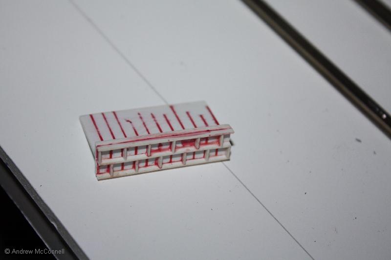

scahalane Posted February 11, 2014 Posted February 11, 2014 Hi Des, this is the template I made out of 0.3mm plastic. The edges were lined up on both sides to create a seamless tile. The stone coursing was based on the bridge on the Lower Glanmire Rd, Cork. The raised stone was done after with lumps of Das, now I have to get around to painting it proper. Quote
