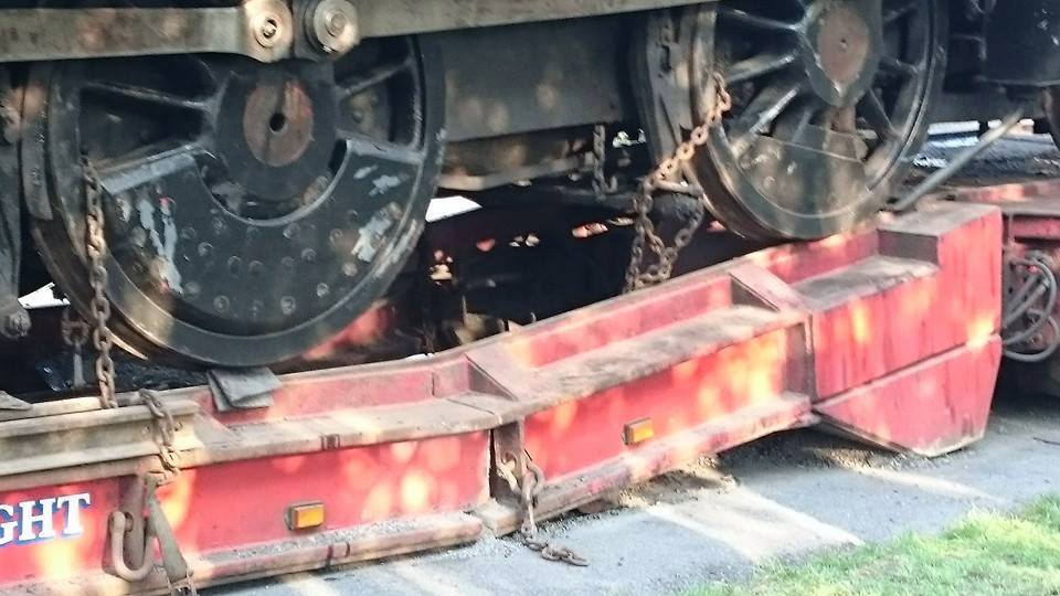

snapper Posted March 18, 2015 Posted March 18, 2015 Well its different from the usual trucker mistake threads we usually have here. A trailer carrying a steam train has collapsed in Coldharbour, Wareham. It is thought it will be moved overnight. https://twitter.com/BBCDorset/status/578265168934760448/photo/1

Noel Posted March 20, 2015 Posted March 20, 2015 So, a lesson in axle-loading to be learned here? Looks more of a problem with the trailer beam loads rather than the axle loads. Metal fatigue or insufficient strength, or something else?
Mike 84C Posted March 20, 2015 Posted March 20, 2015 Its a very clean straight break, I wonder if the trailer has been streched at some point in its life and that has created a stress area. Be interesting to see if it is in both chassis rails.
Broithe Posted March 20, 2015 Posted March 20, 2015 There is what could be a weld fillet in the top, immediately above the break in the bottom. I wonder if there has been an extension welded in at some point, and the tensile part has failed, propagating to the weld up the back of the web with the shackle through it? Looking through the gaps in the wheels, it does appear that both sides have failed in similar ways.
