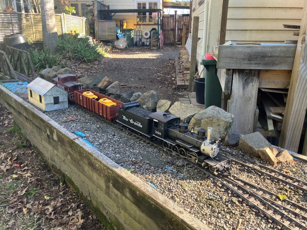

#348 with stock train in spot of afternoon sunshine. #348 had been recently through the shops for attention to her leading truck and this was a bit of a test run.
#348 picks up a laden gondola from the lithium mines at the end of the extension.

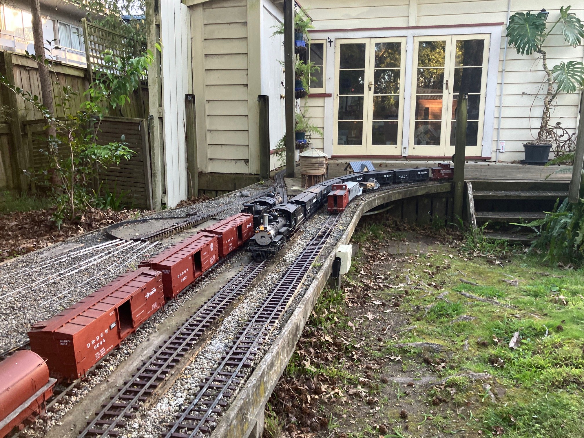

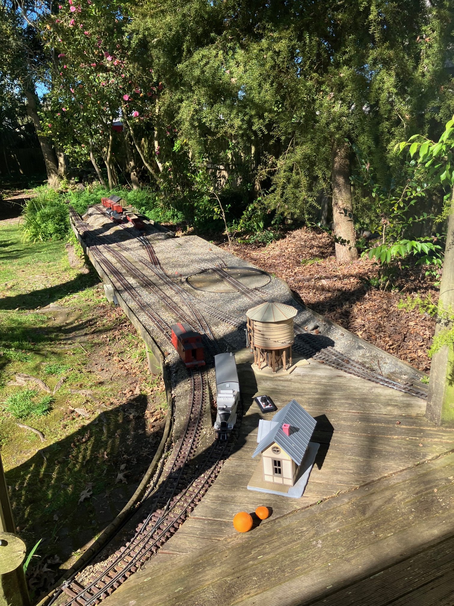

General view Jackson City RGS Motor #4 with the daily Passenger-Mail-LCL (sundries) service. Orange and Mandarin had fallen from trees in our garden (still on trees since Autumn!) Just about finished clearing (autumn/winter) plant debris (mainly leaves) from lawns and paved areas/decks, next job to bring in a load of mulch or stone to cover beds (weed control).

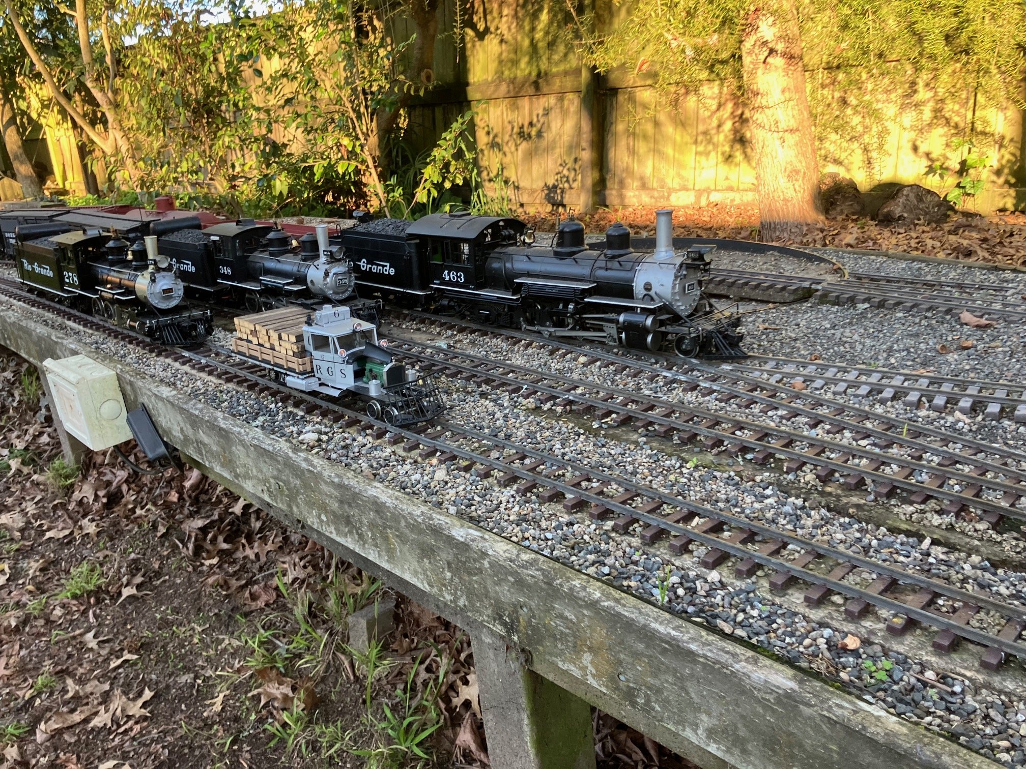

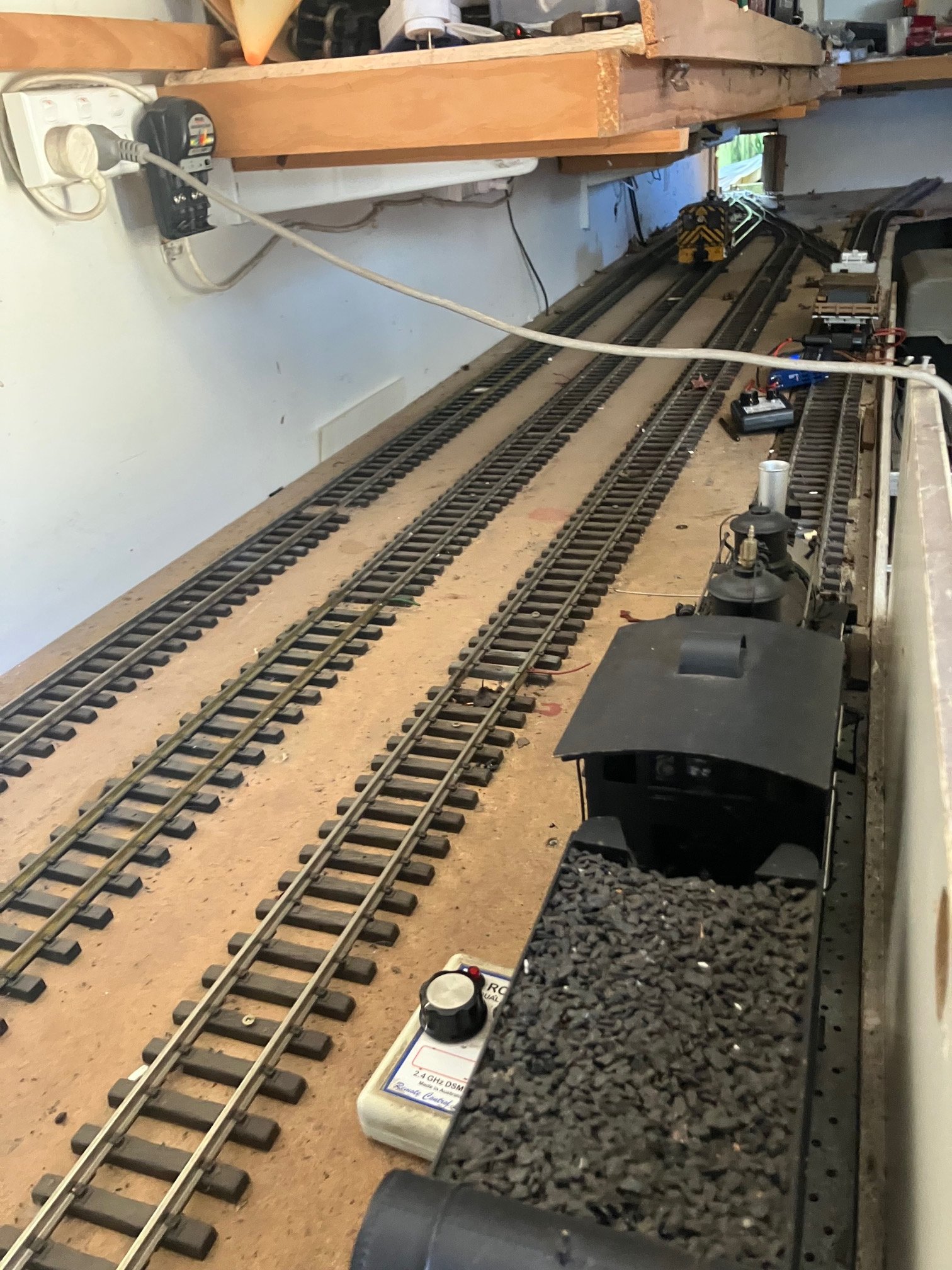

Garage Staging around noon! Almost everyting out on the line. Staging Pilot DRGW#50 (LGB) parked No2 road RGS Motor #6 on charge. DRGW C19 #348 2-8-0 waits its next duty.

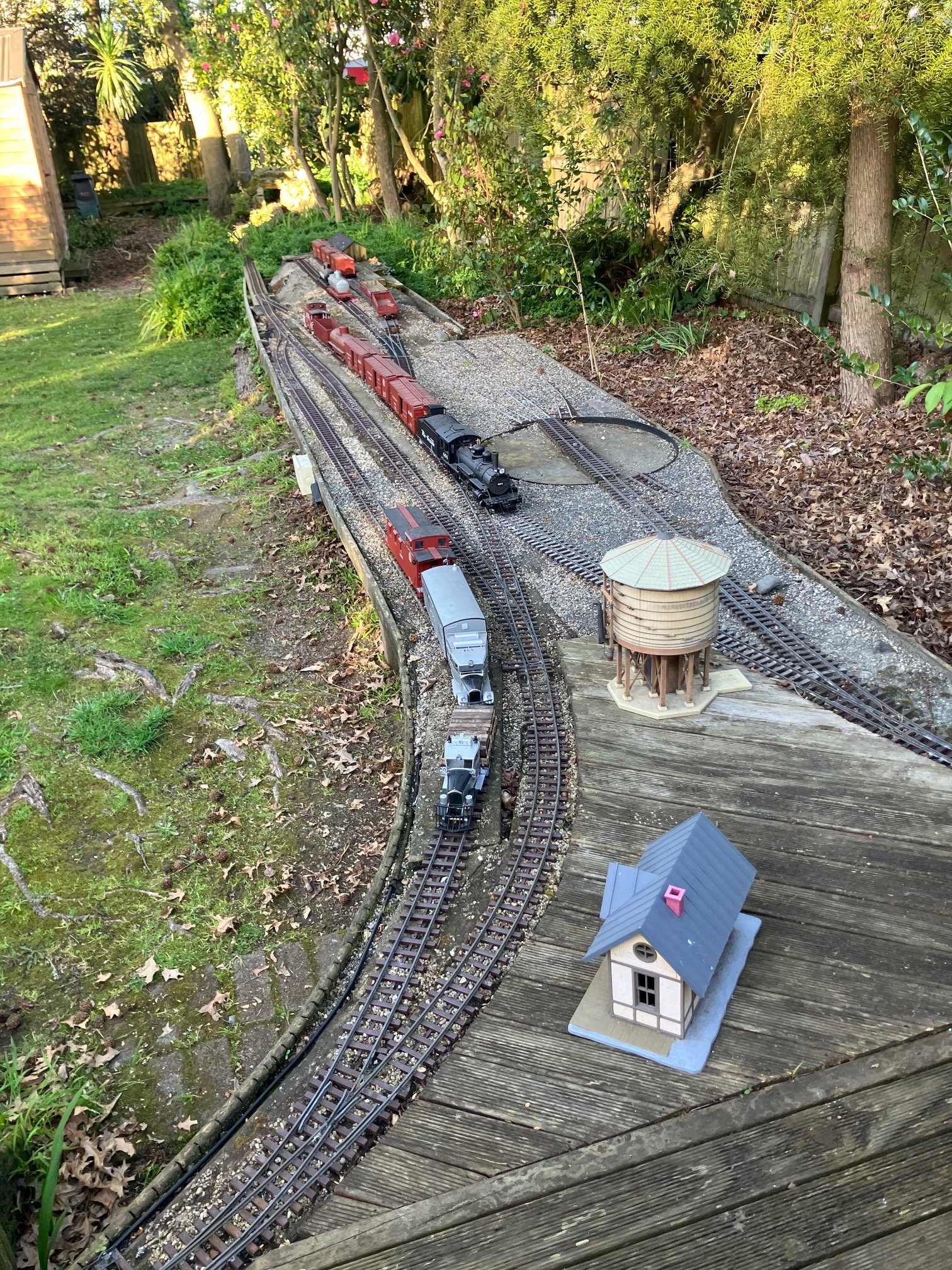

Jackson City RGS Motors #6 & #4 & Caboose in Siding, DRGW#464 recently arrive on freight waiting to switch yard. Main-line clear for Stock Special.

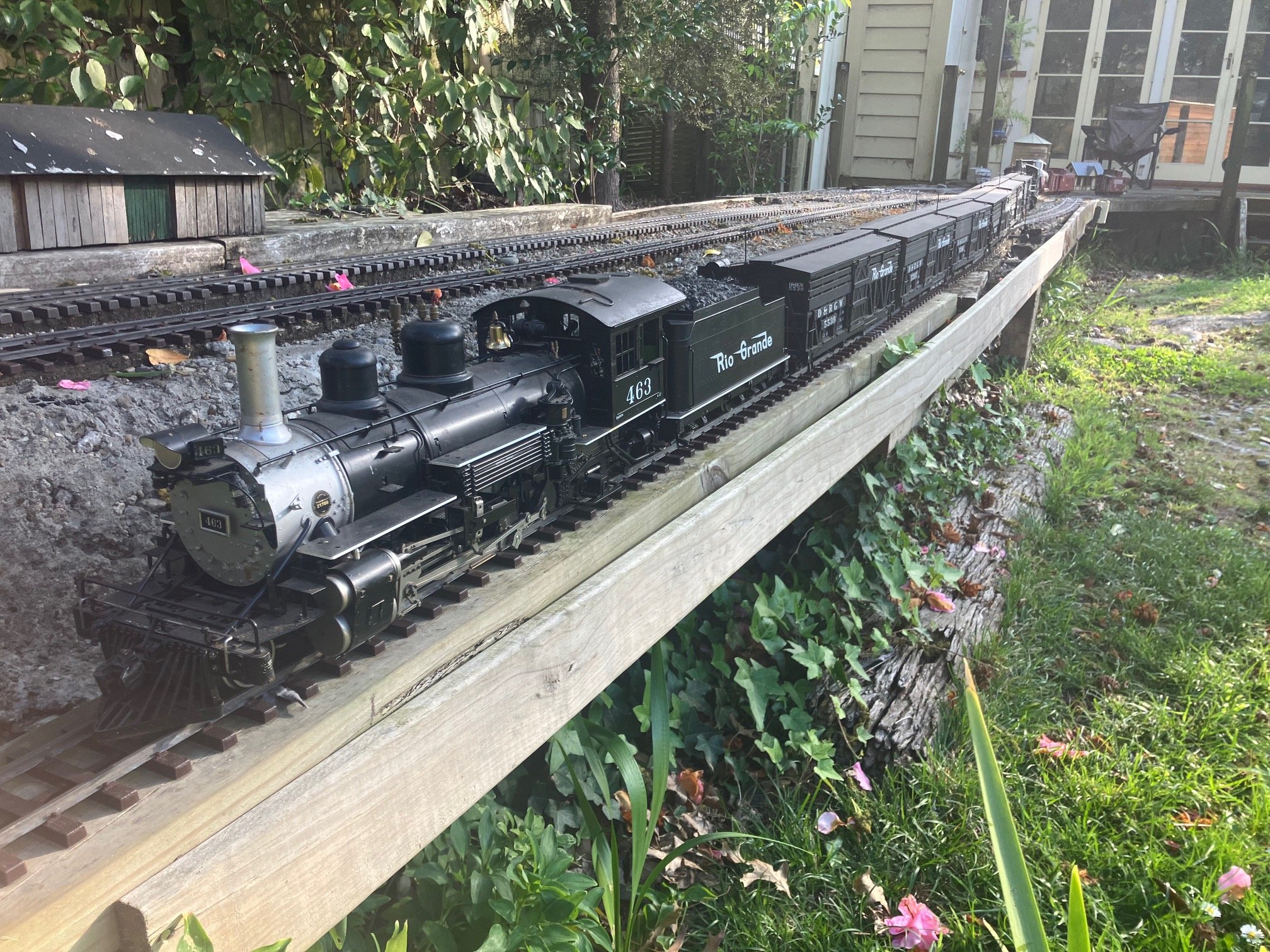

DRGW #463 arriving with Stock Special from Arboles. Spring and Autumn were the peak livestock (mainly sheep) shipping seasons on the RGS. Spring-moving stock (by trainload) to high summer pasture for graazing, Autumn to meatworks. This Special is likely to be an empty working returning cars for cleaning/disinfection, before working another special or storage until Autumn!
Age/weather is beginning to take its toll on the trackbase and ground cover in this area long overdue for an upgrade after after 16-17 years use, track in this area was upgraded about 10 years ago (sleepers replaced, points on running lines upgraded from 1:4 to 1:6 about 8-10 years ago)

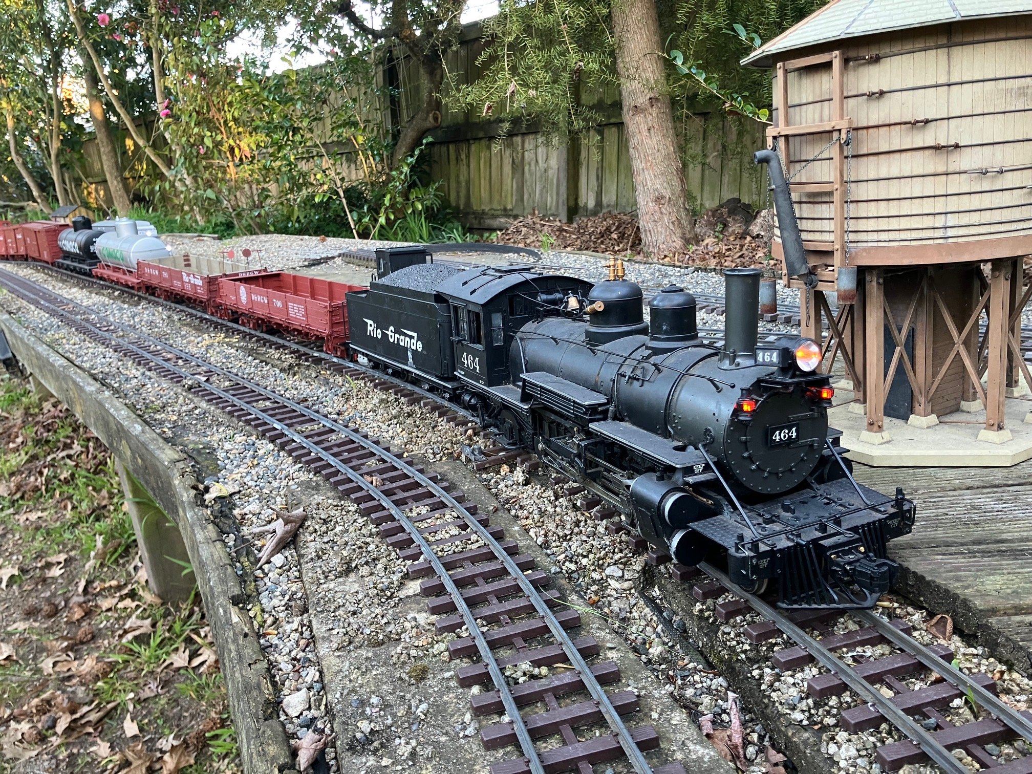

#464 is now handles the heaviest trains following re-wiring and replacing her batteries. Ready to depart after adding all the freight cars (8) in the yard to her train (13 inc 2 Caboose)

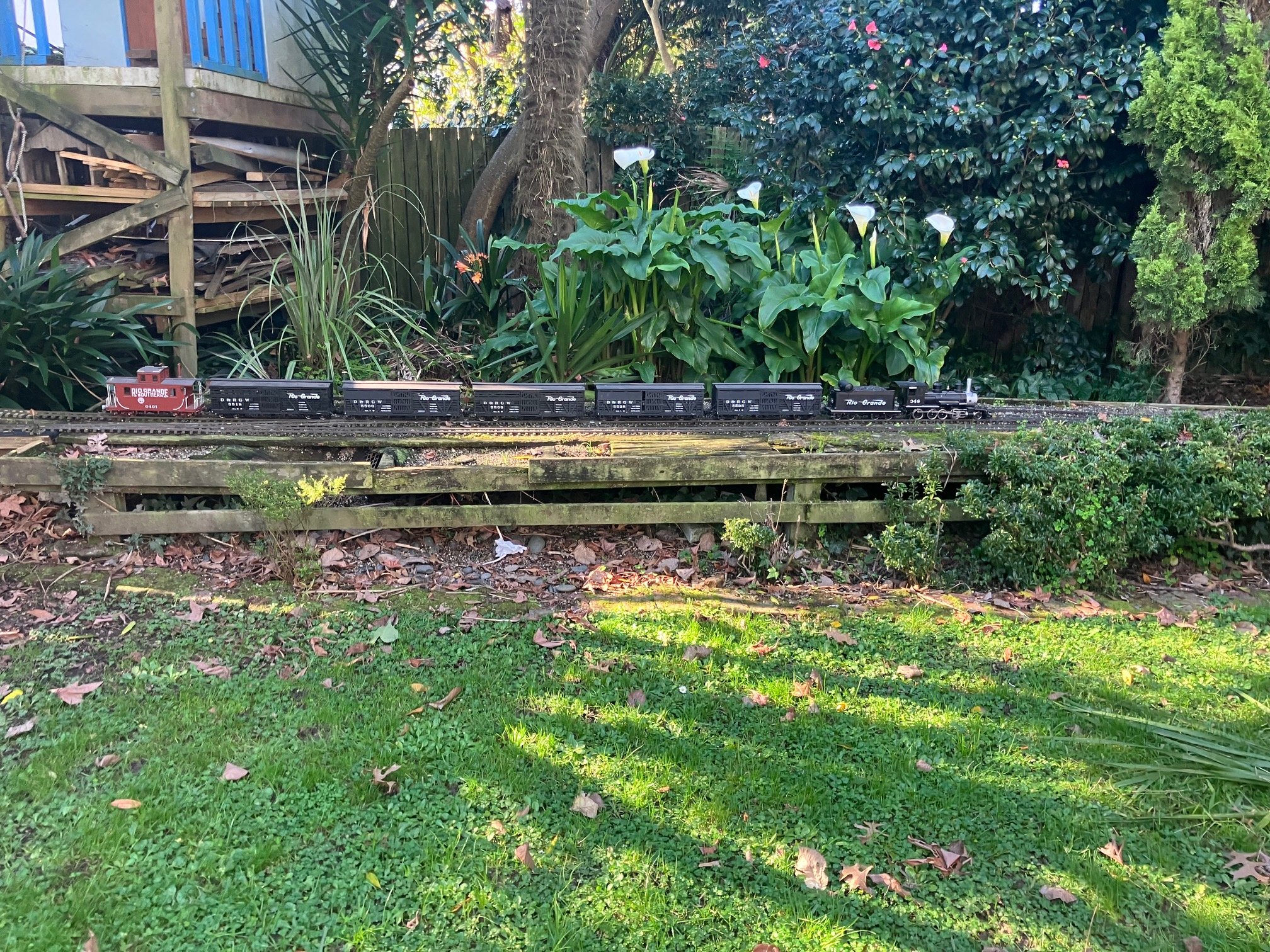

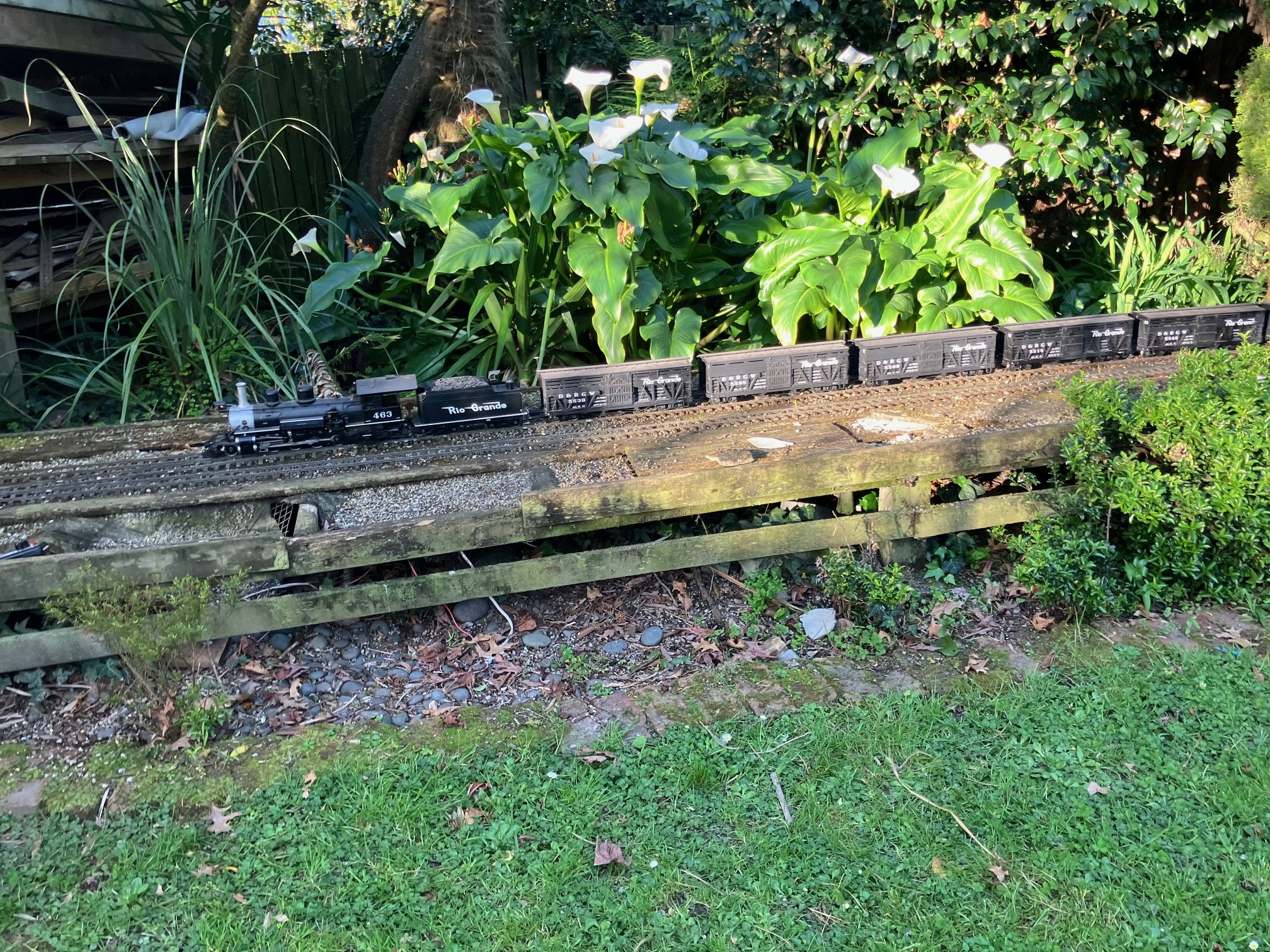

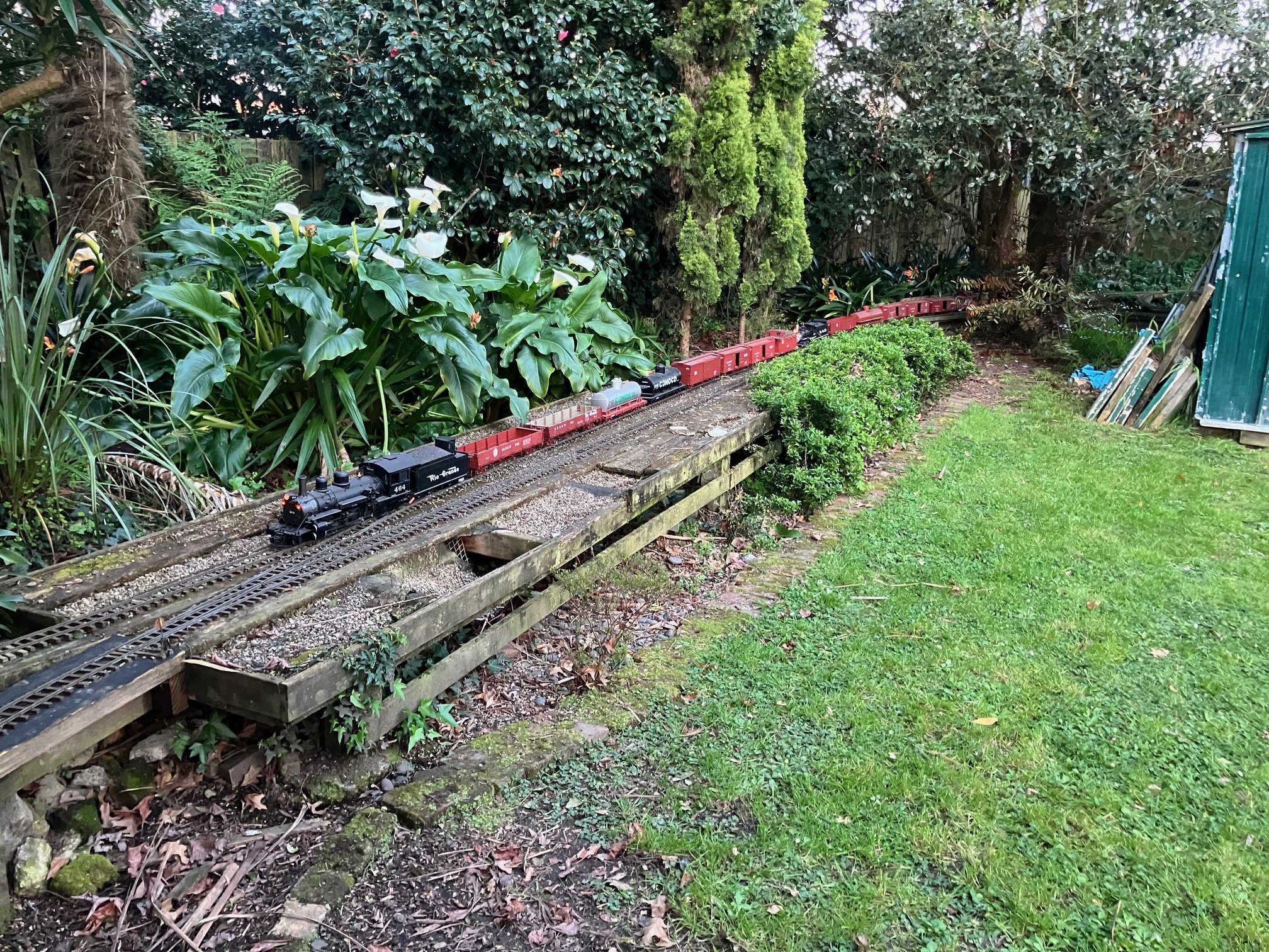

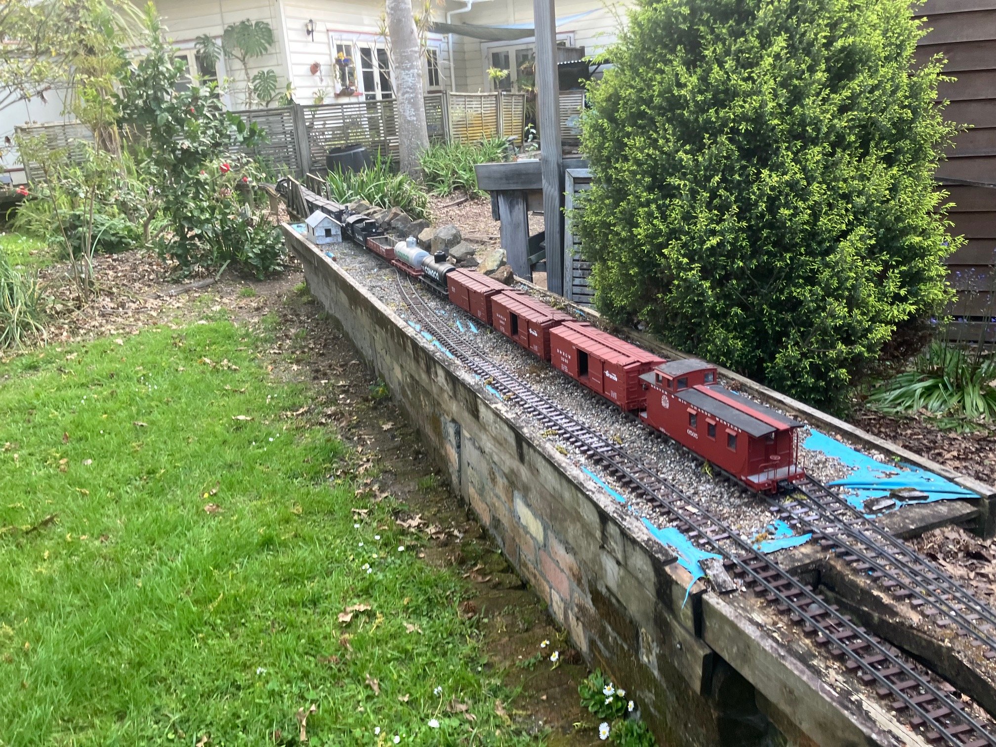

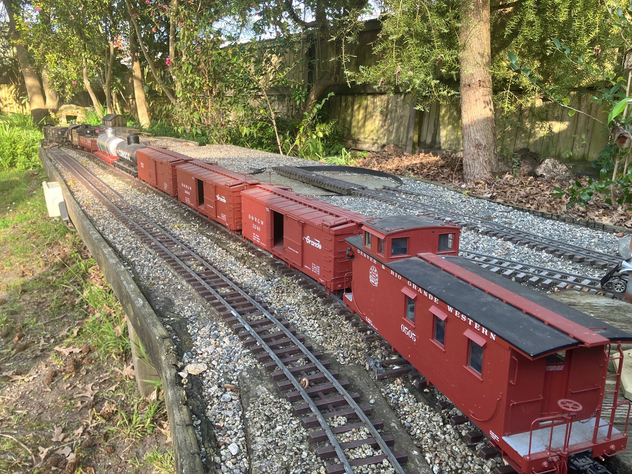

A distinct improvement in the weather and almost catching up on stock maintenence/repairs, lead me to setting up an almost 'scale length' RGS freight typical of the roads final years.
Freights of that era tended to be worked by pairs of K27 2-8-2 (usually leased DRGW) with second loco 'cut in' as mid train helper. Blocks of stock cars usually cut in behind the lead loco and box cars/mixed freight behind the helper.
Main problem in running the mid-train helper was keeping the 'helper" coupled to the front section of the train due to very restricted front pilot coupler side play on curves. Same problem arises with loco pushing stock through No4 switches!

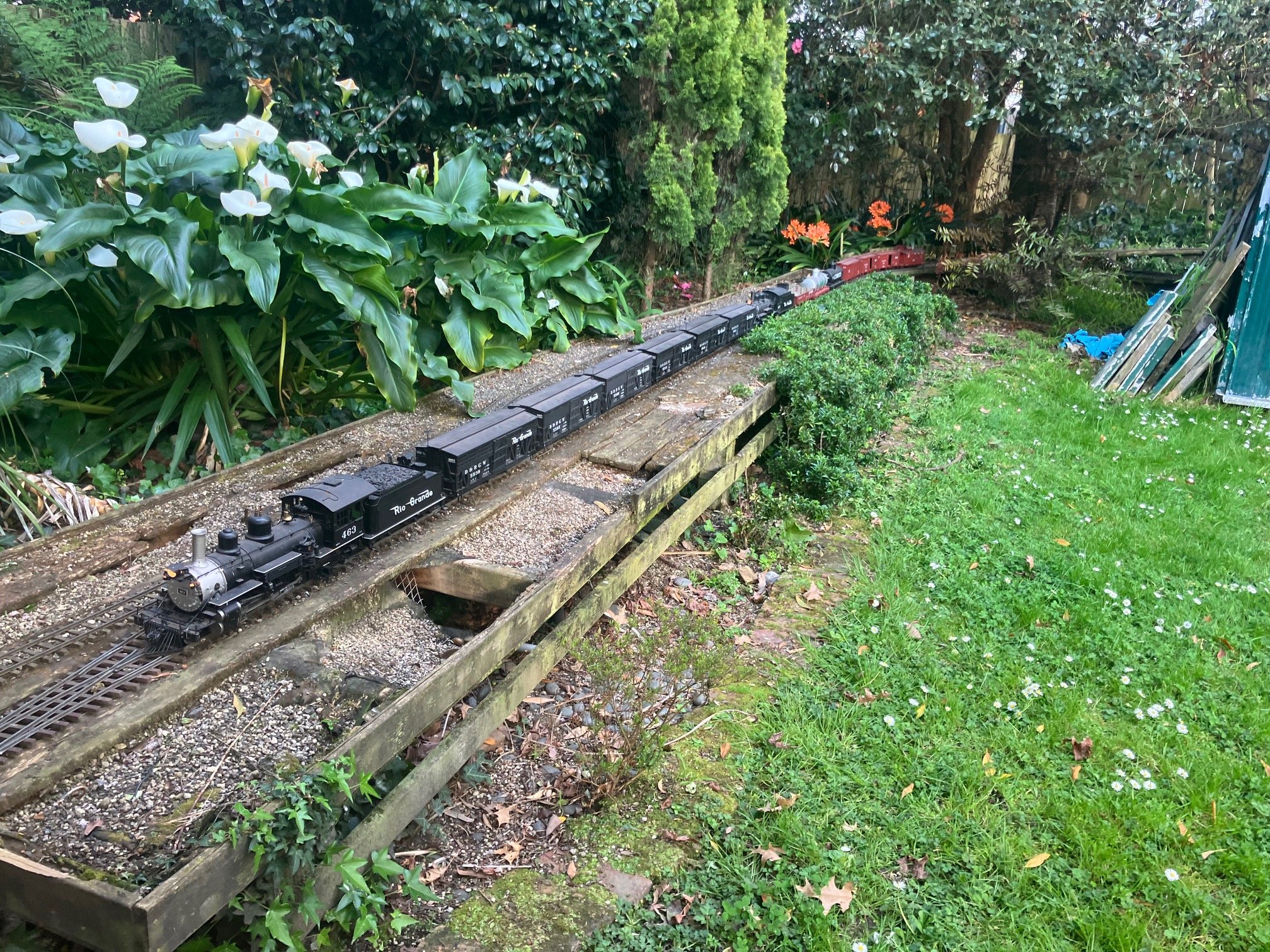

2 locos+12 Cars +Caboose too long for the passing sidings on the Jackson County & much too long to fit in a broadside photo!
Repairs/tidy up planned to the track base in this area and extend the box hedge planting along the baseboard edge.
Baseboard/trackbase in this area is treated (18mm) ply on 4X2 treated framing, track is laid on pond liner membrane (which at the time was on special offer) One of this springs jobs is to top up the ballast mixture of 8mm pebble and 'gap 8' crushed stone fines, glued down with concrete bonding agent (dilute pva).

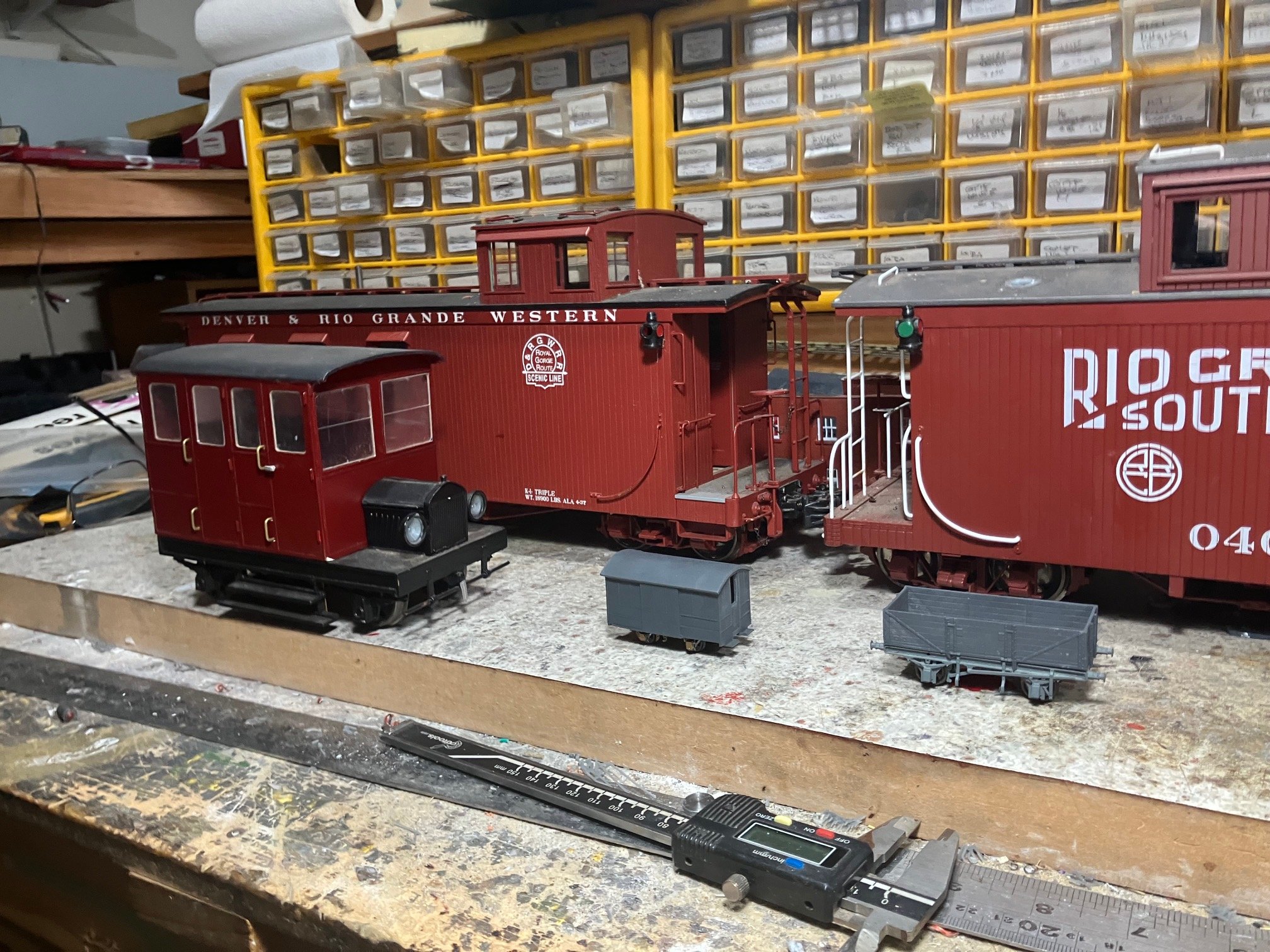

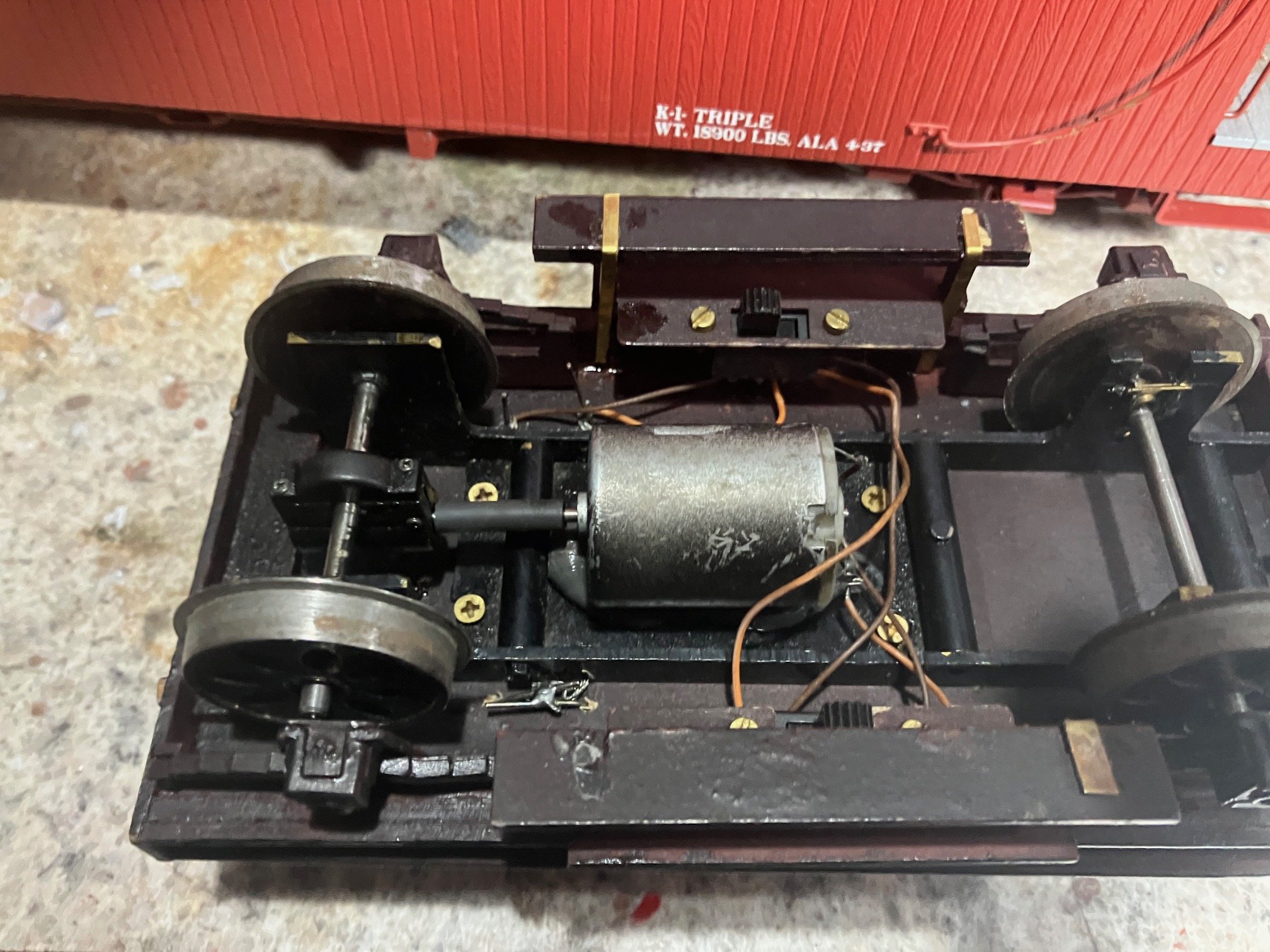

Some Large Scale stock on the workbench for repairs  along with 'small scale' stock🙂

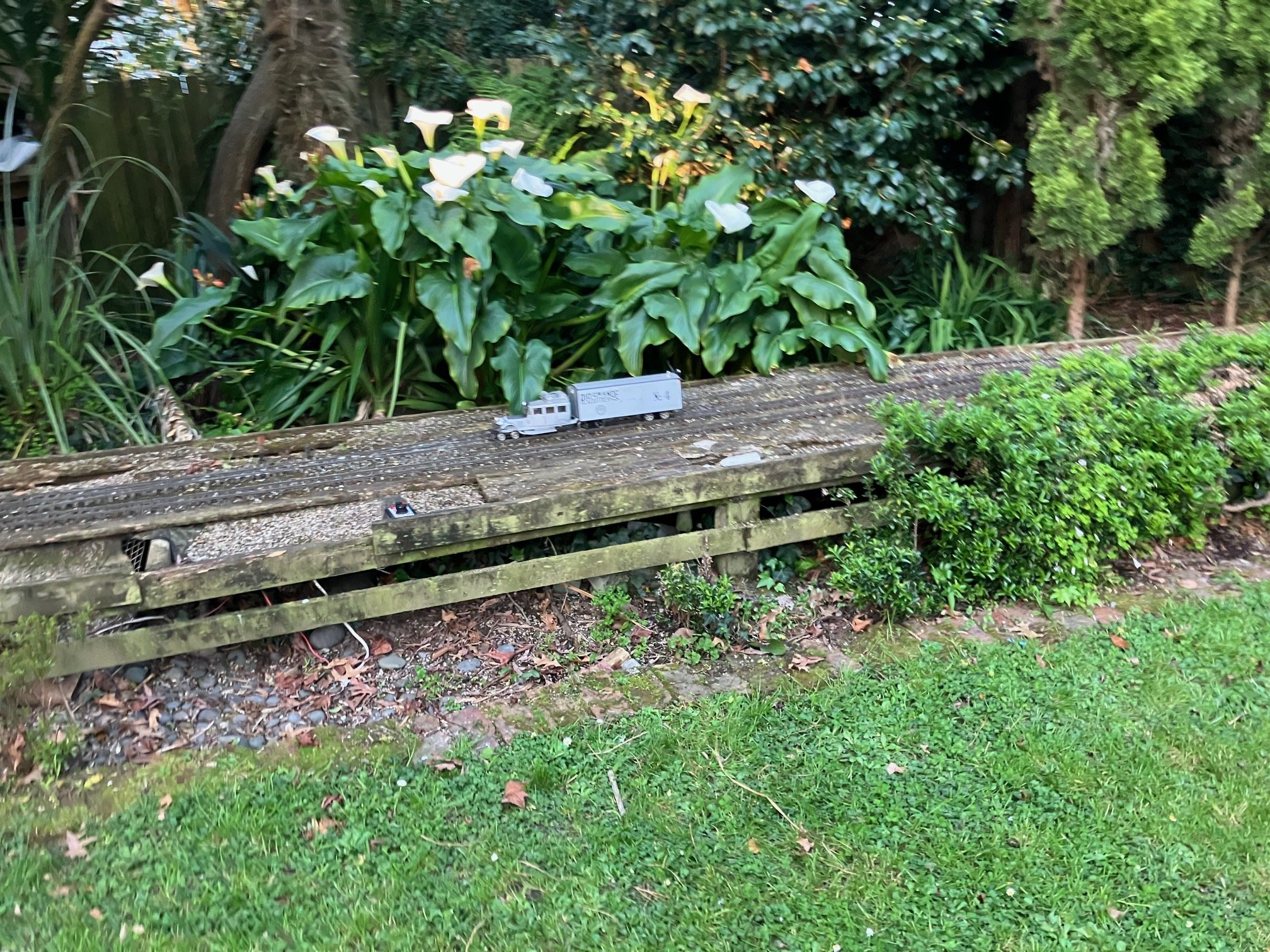

The caboose are in for replacement smoke stack after the original replacements fouled the loading gauge and the "long caboose" became wedged in the tunnel. The T&D Inspection Car in for attention to the transmission following a recent run!

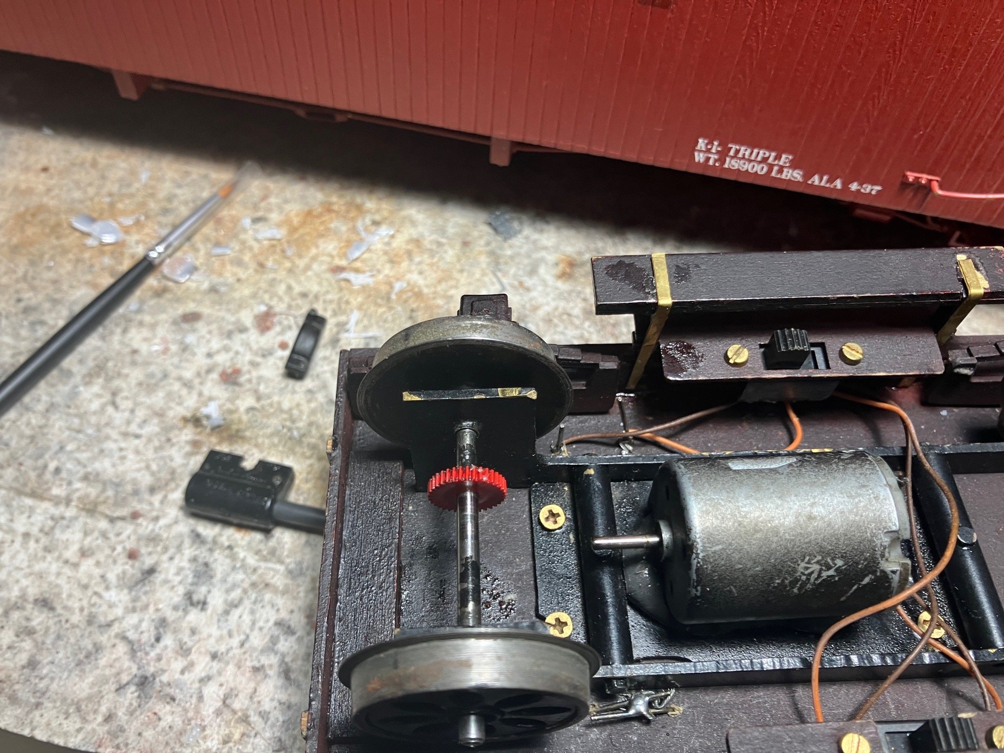

The drive is a 'home brew' using the original motor and wheelsets and a Northyard (NZ) gearbox.
The Loctite bond between nylon gear and axle had broken down, possibly as a result overheating/friction as a result of wheelslipping against an obstruction on the track (twig/stick). Shifted gear from centre and degreased axle/gear with IPA before rebonding with Loctite. Oh I managed to drop an artist brush into the bottle of IPA before degreasing the axle!  Probabably leave to cure for at least 24hrs before re-assembly.
The Car is powered by a pair of AAA batteries mounted in the cabin, control a pair of DTSP switches. One on-off, one forward-reverse

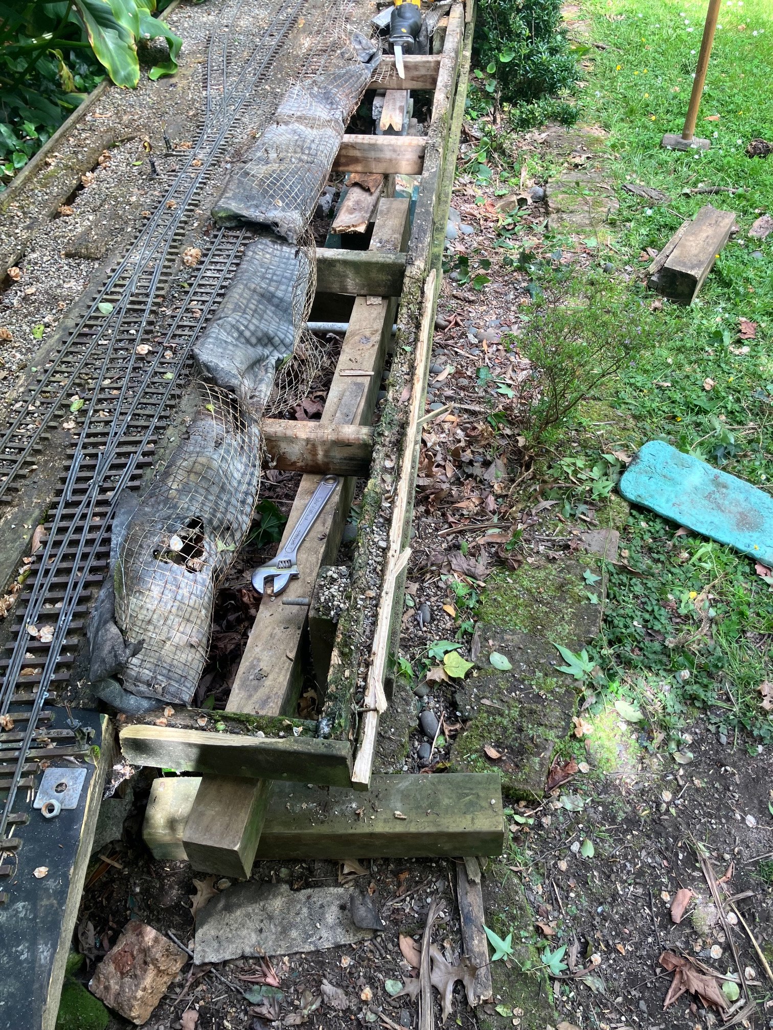

Being a national holiday "Labour Weekend" normal train service cancelled allowing Civil Engineers to carry out major works at Utah Junction.

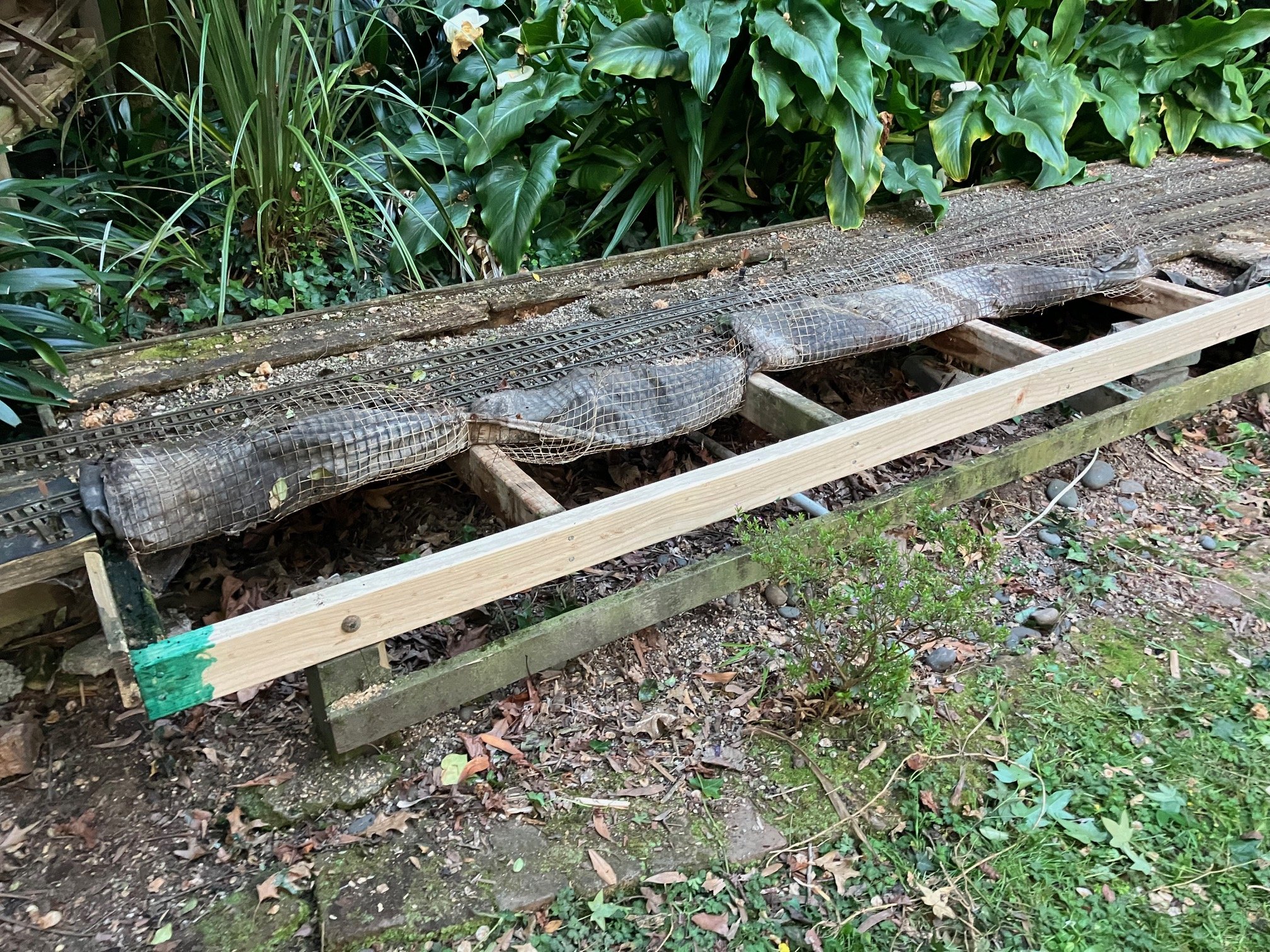

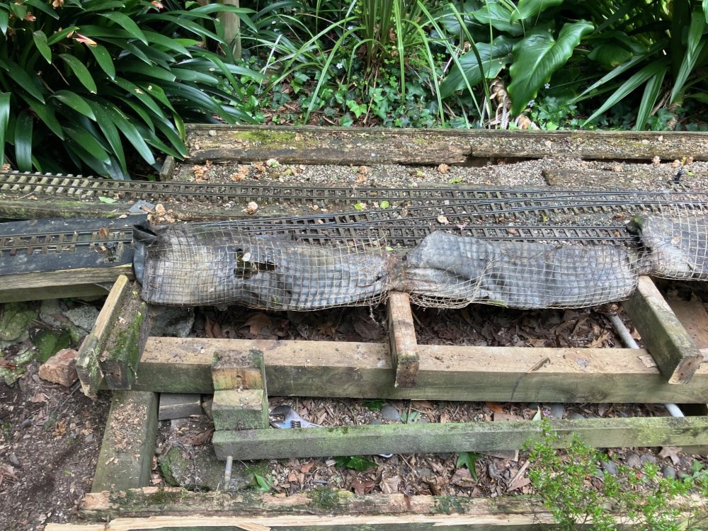

Major decay had set in one of the main basebord/framing members and although probably good for another 3-4 years best to replace while I am still reasonably fit and able (arthritic knees!) First job to put in some tempory supports to the cross members before cutting out/removing the decayed member. Framing in this area originally installed approx 17 years ago (amazing how time flys!)
Fortunately almost no sign of decay in the piles or cross members. So probabably good for without major work for another 10+ years. All timber was CCA pressure treated.

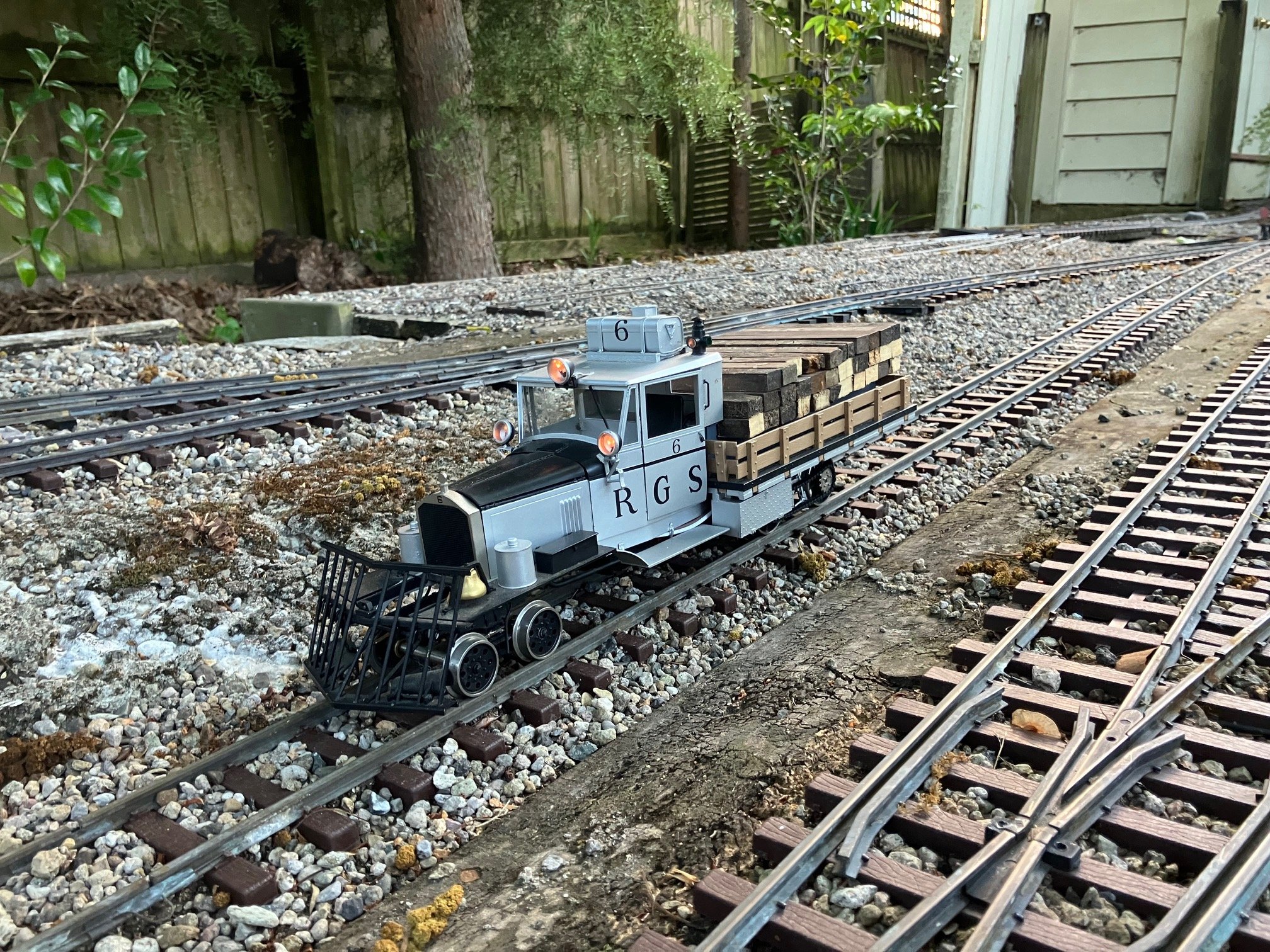

Motor #6 preparing to return to base. Load is cedar ties (supposedly decay/rot resistant) I had machined about 15 years ago, but rotted away after several years outside use as sleepers/ties.. Load helps hide batteries and electronics 🙂

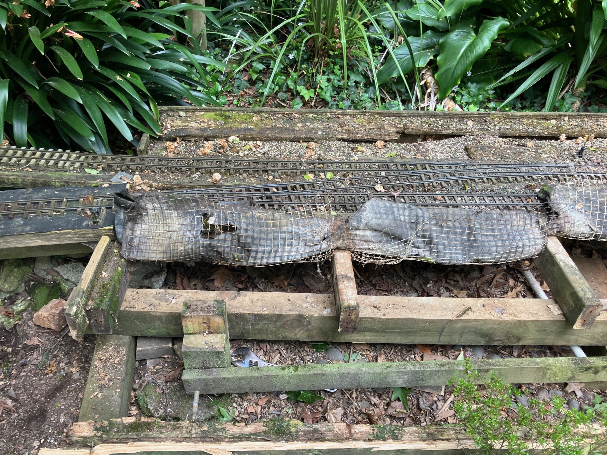

Structural repair completed before tea time, cut ends of new framing treated. I may fit a metal flashing over the framing in this area as the decay occurred along the drip line of a large tree.
I'll replace the welded meash that supports the weedmat that supports the stone/ground cover in this area and fit a treated decking fascia to the new framing to tidy up the area for this season. Long term plan is to extend the box planting along the border to hide the framing, but we are already showing signs of unseasonably hot dry weather this spring, so probabably best to concentrate on trackbase repairs and delay planting until the winter months.
