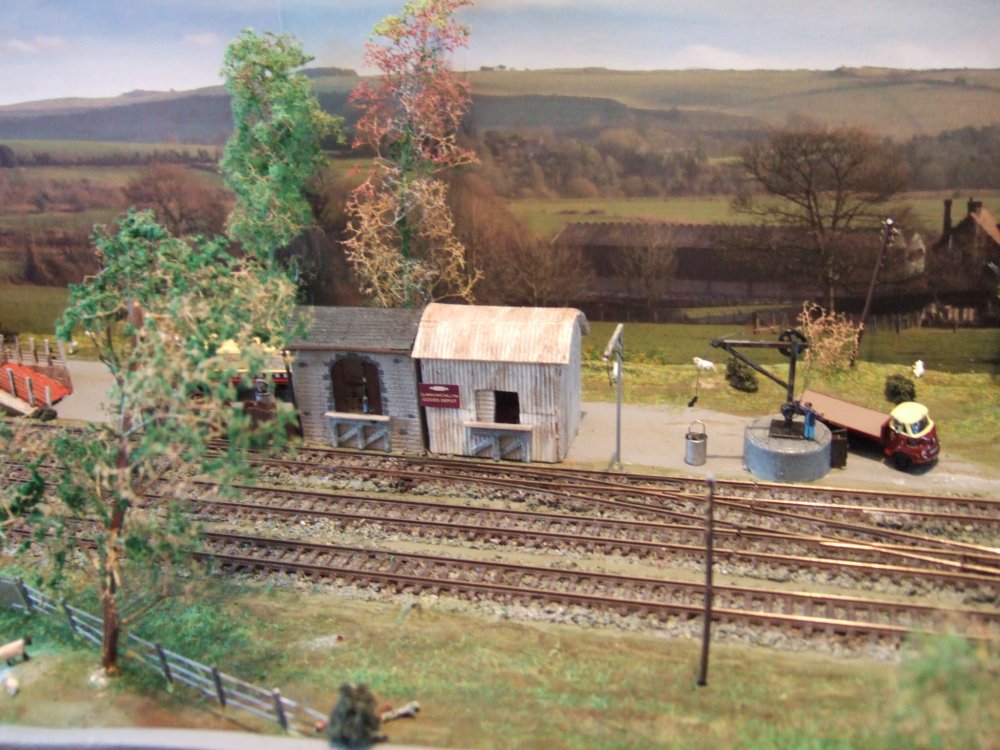

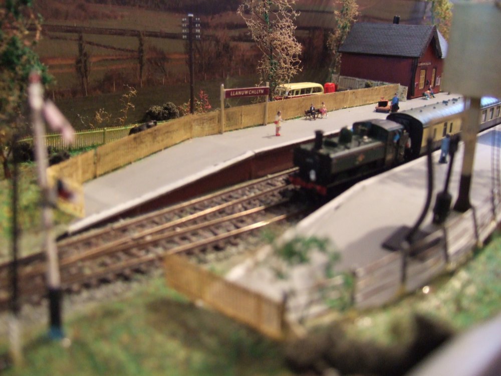

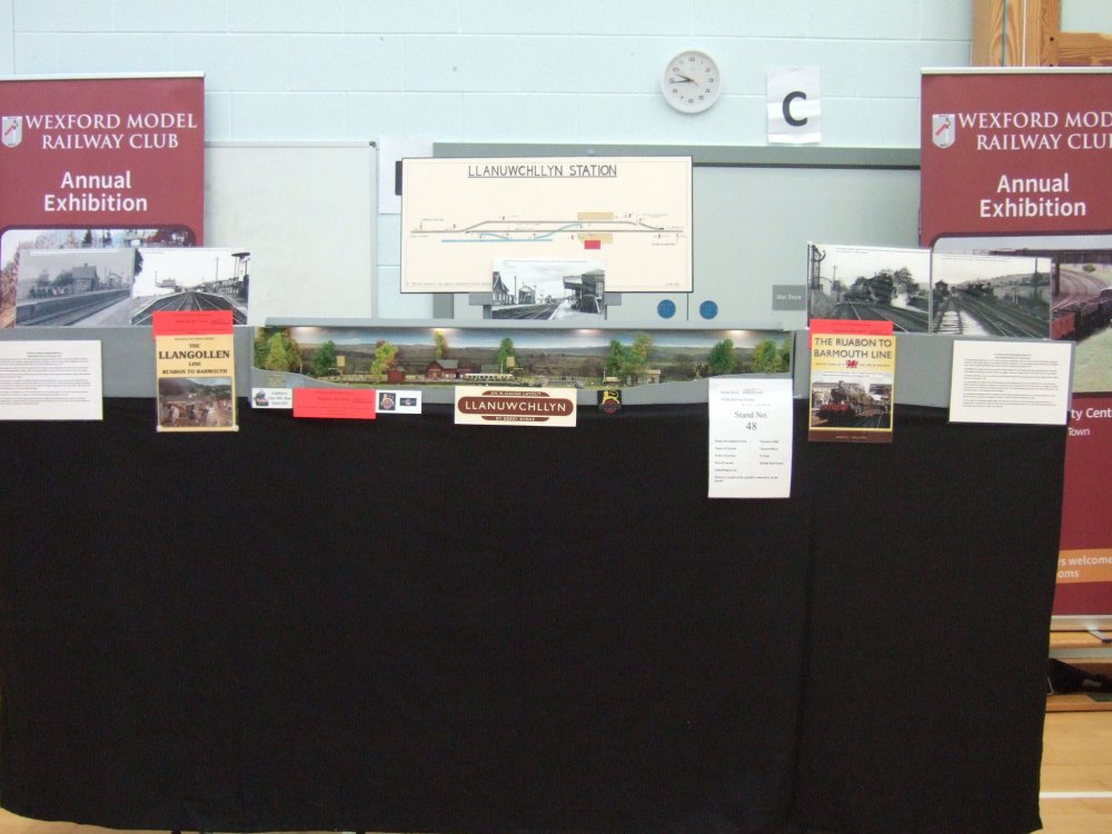

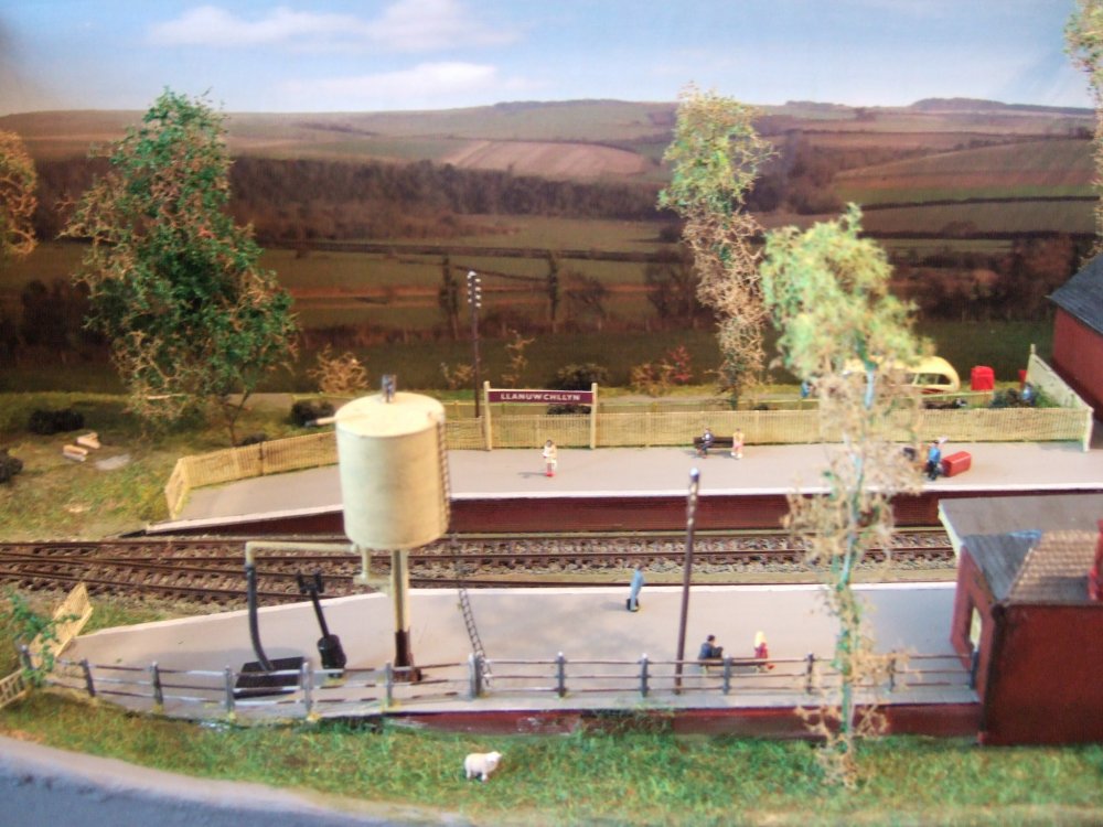

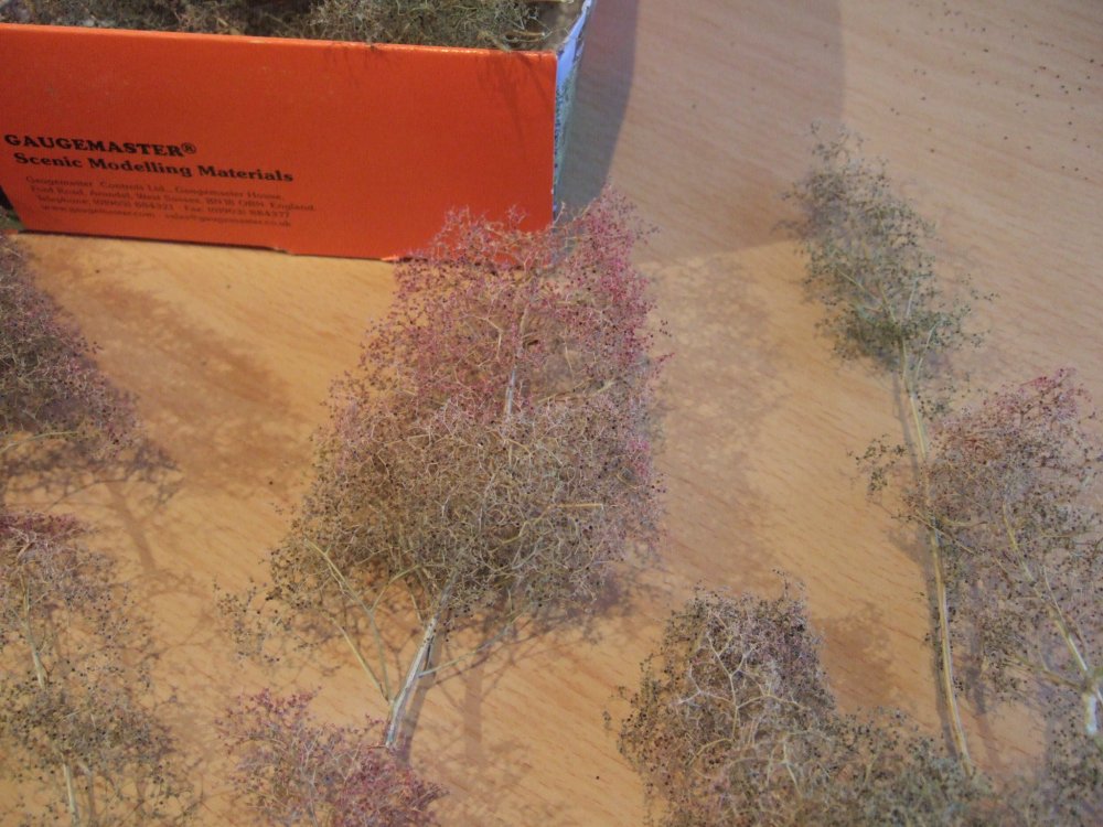

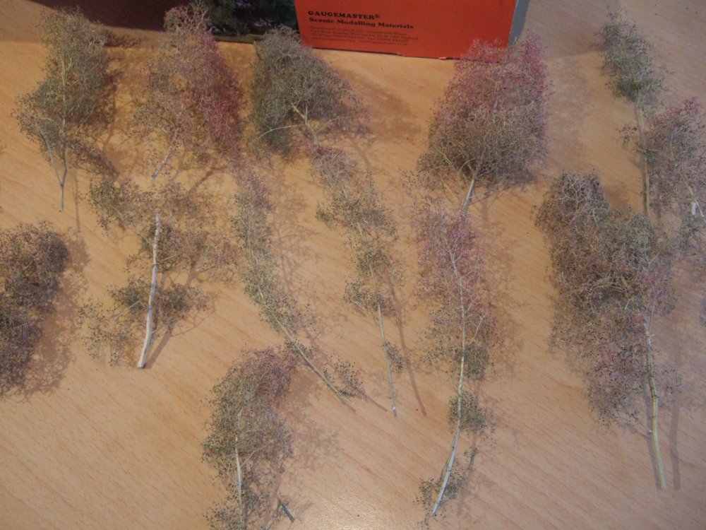

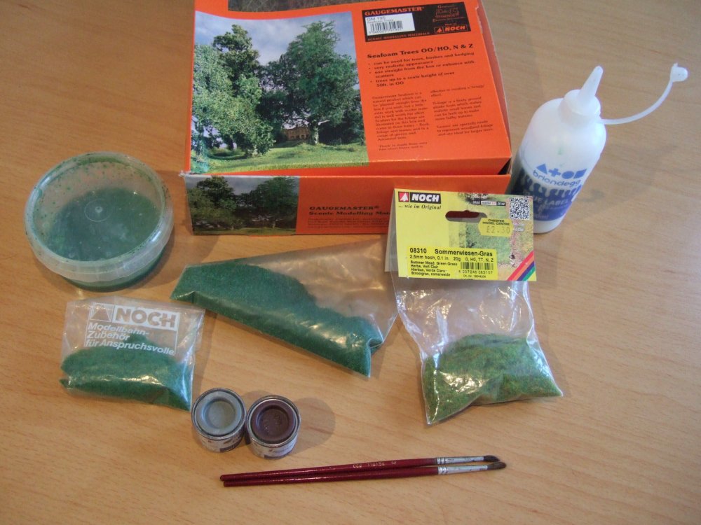

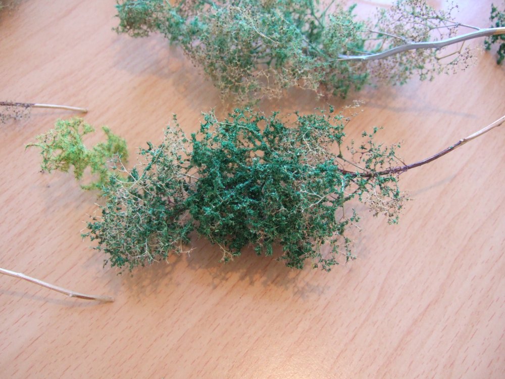

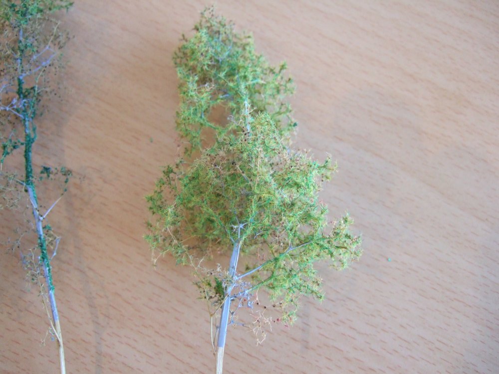

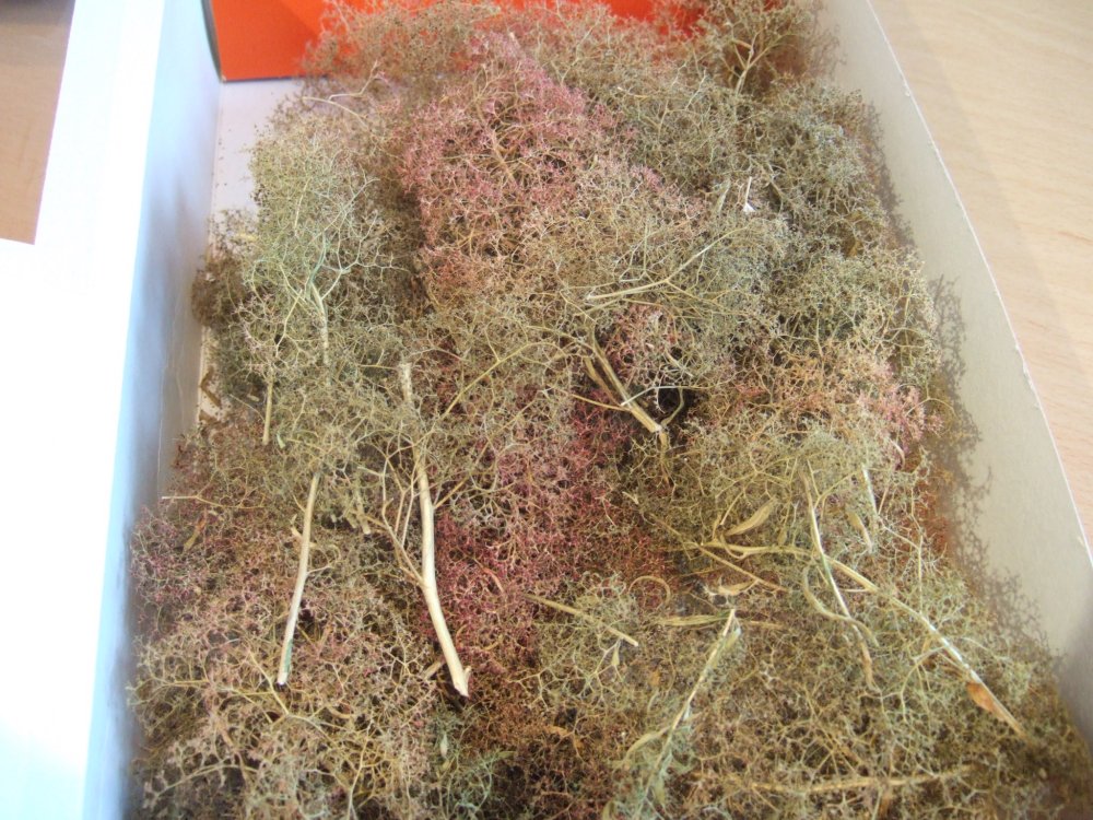

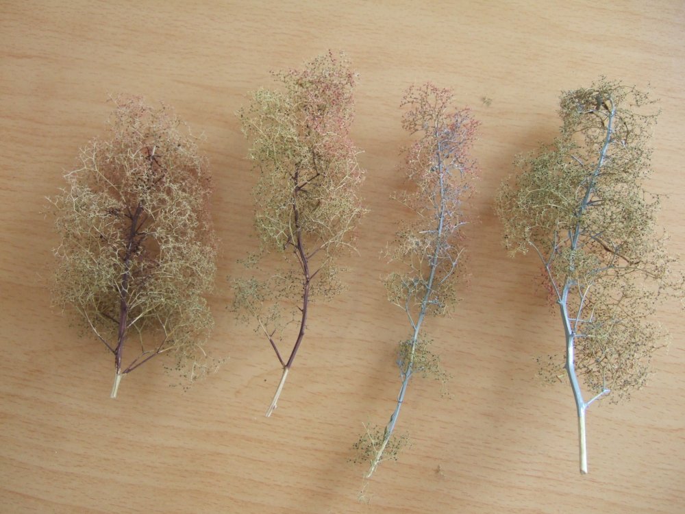

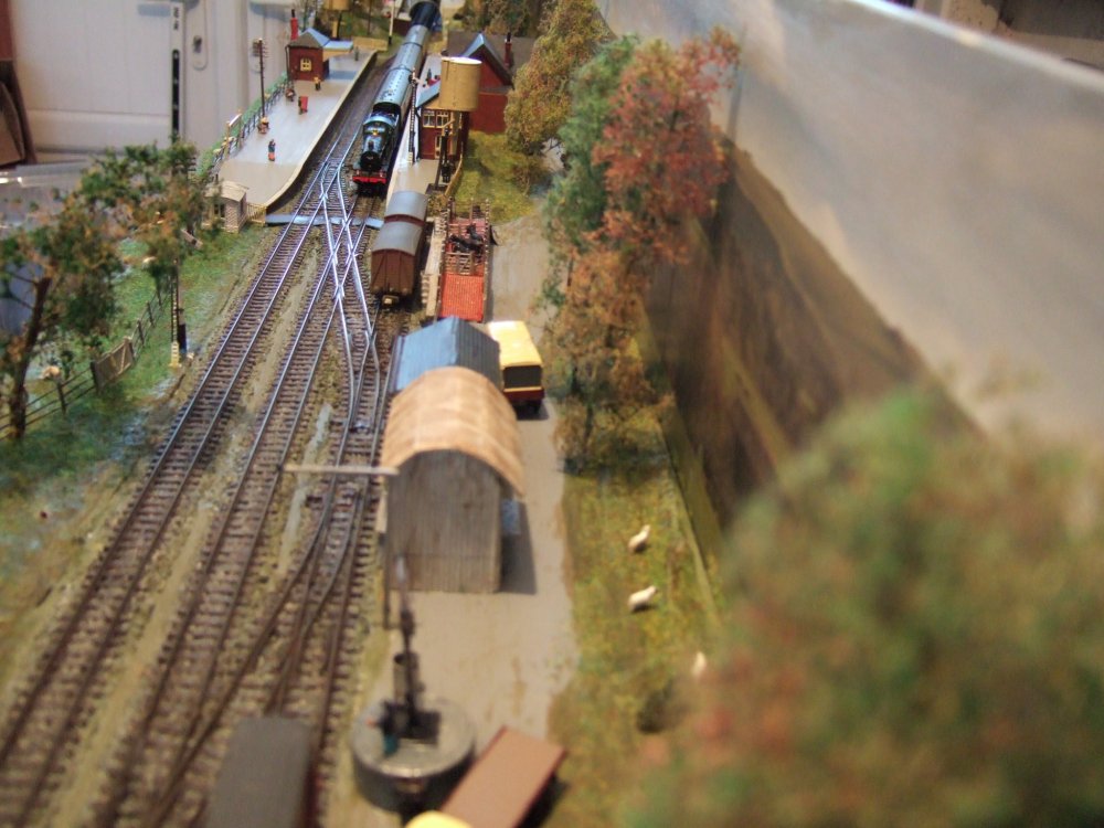

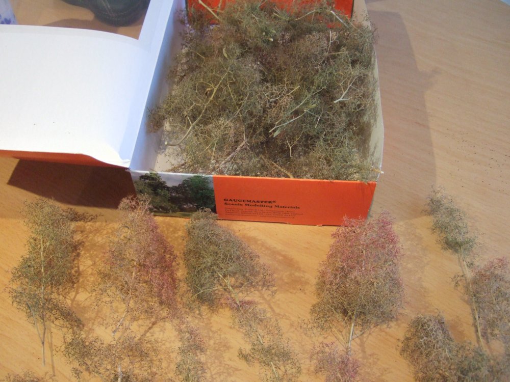

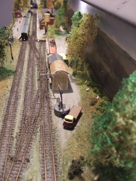

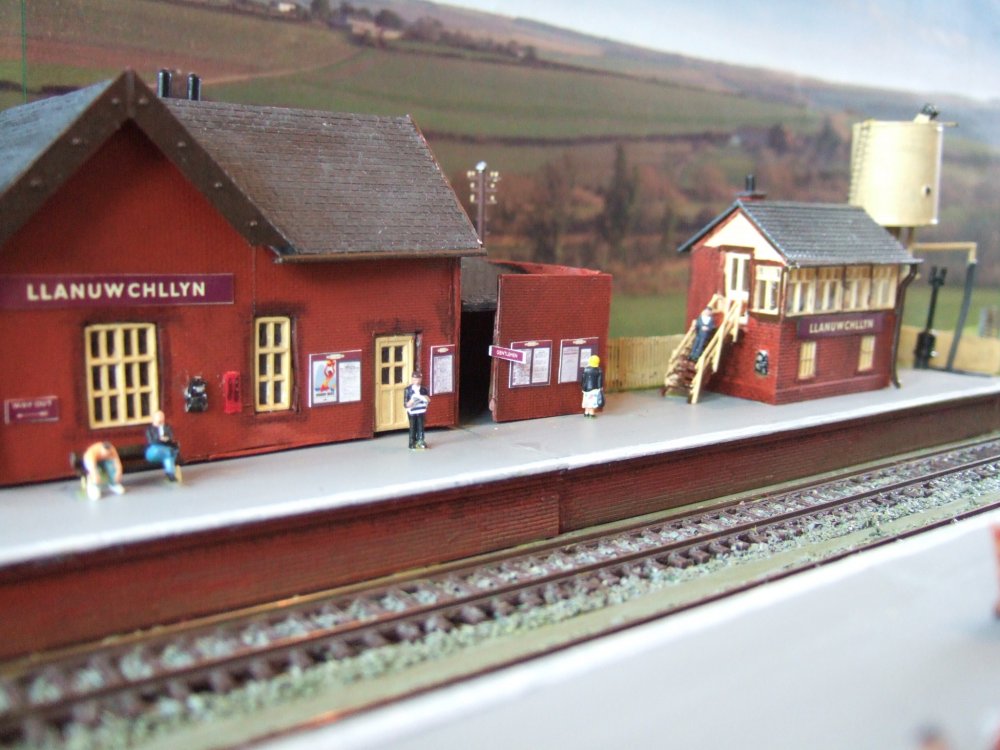

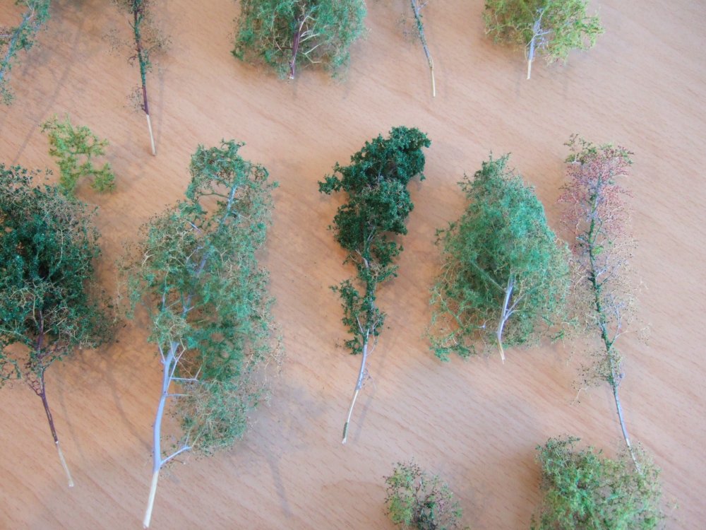

Irishrailwayman Posted February 5, 2018 Author Posted February 5, 2018 Trees for Llanuwchllyn have been developed using the Gaugemaster Sea Foam kit - the same technique used for my Llangollen and Cynwyd layouts. The dried sea foam natural plant product comes packed in a box and pieces are selected and teased out into "tree-like" shapes. Any natural leaves present may be removed. The stems and main branches are painted in brown or grey to simulate different "tree" species. Dilute PVA glue is daubed on the stem (e.g. to simulate ivy) or on the "branches" and a variety of scatter materials can be used sprinkling them on (material that does not stick can be caught on a folded piece of paper and re-used). Noch produce "leaf-like" scatters in a variety of colours but any fine scatter material can be used. In fact, the more variety, the more a natural variation is created - just like in nature. Similarly, the sea foam being a natural product means that no two trees are alike. The fineness of the model "trees" make them particularly suited to N gauge but they should also be at home in OO. A couple of pictures to illustrate the above: 2 Quote

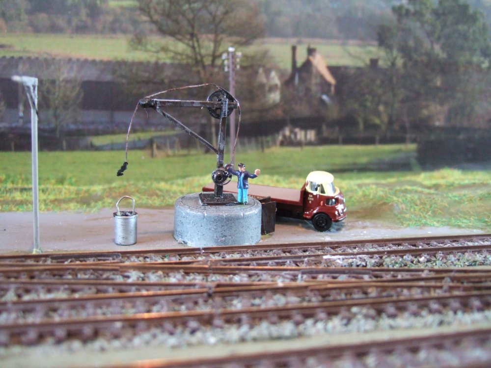

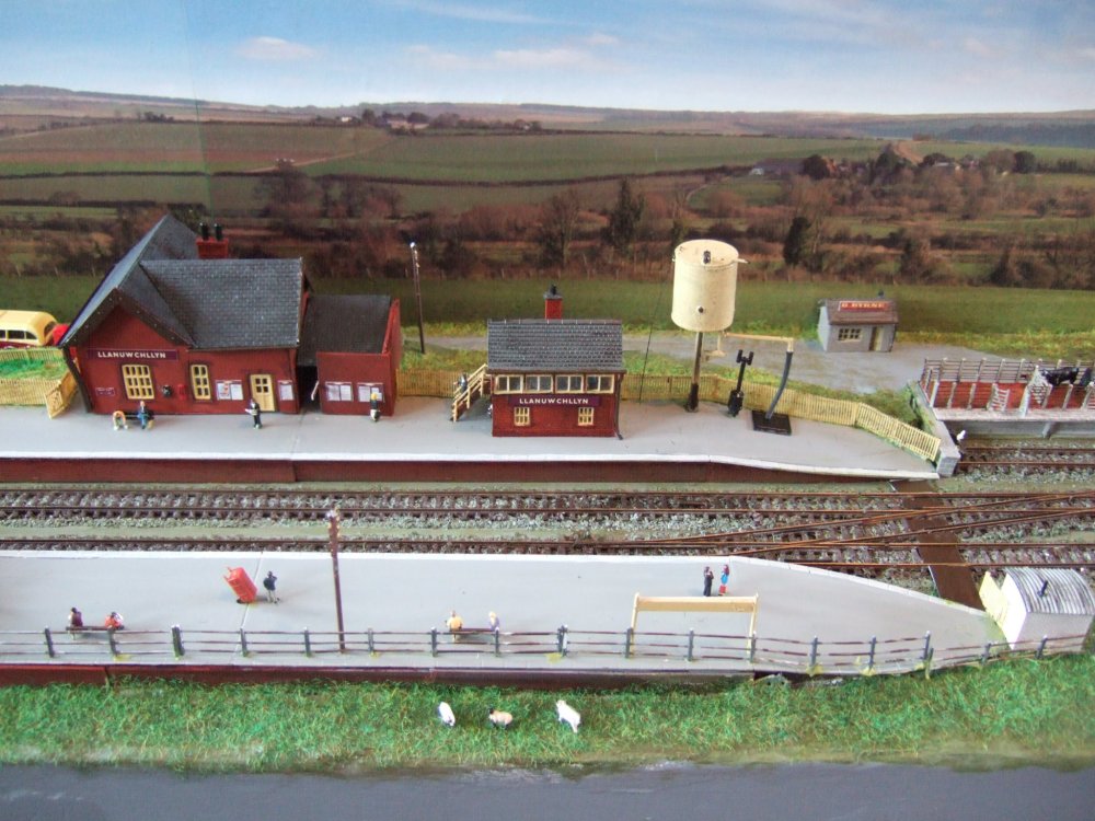

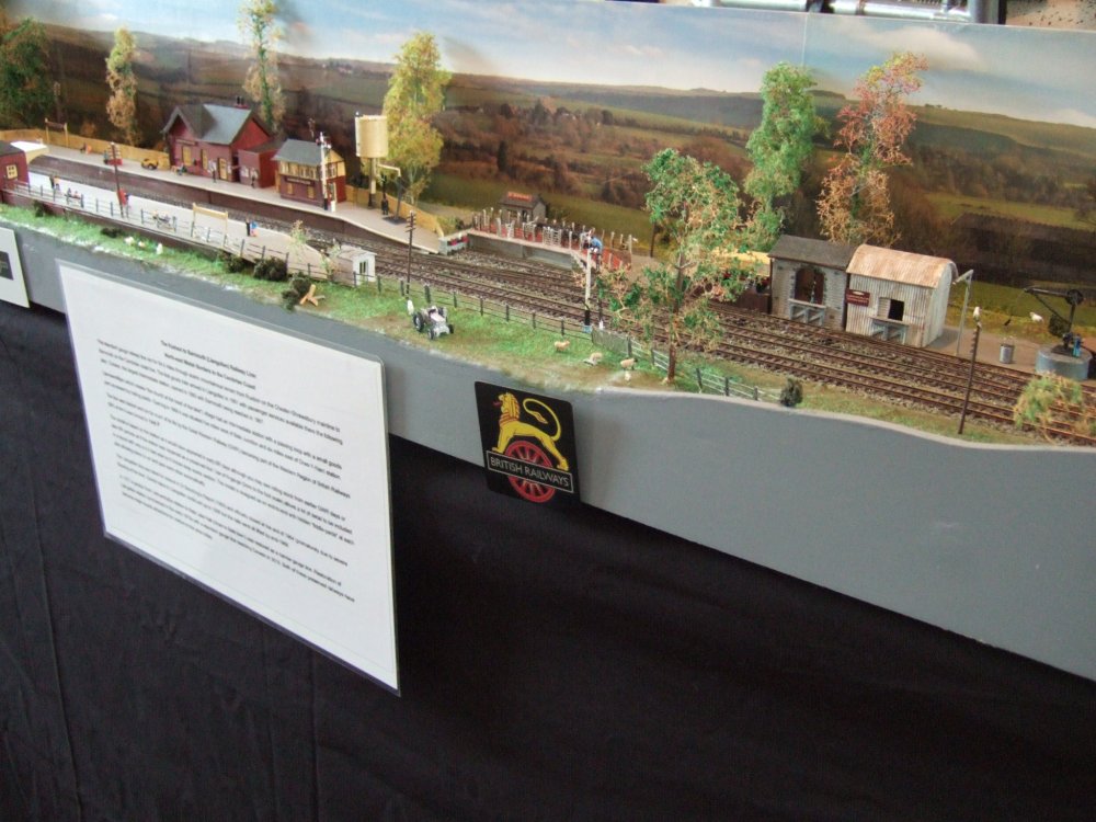

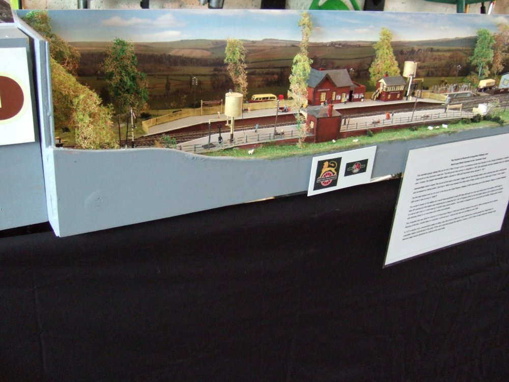

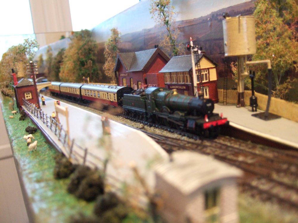

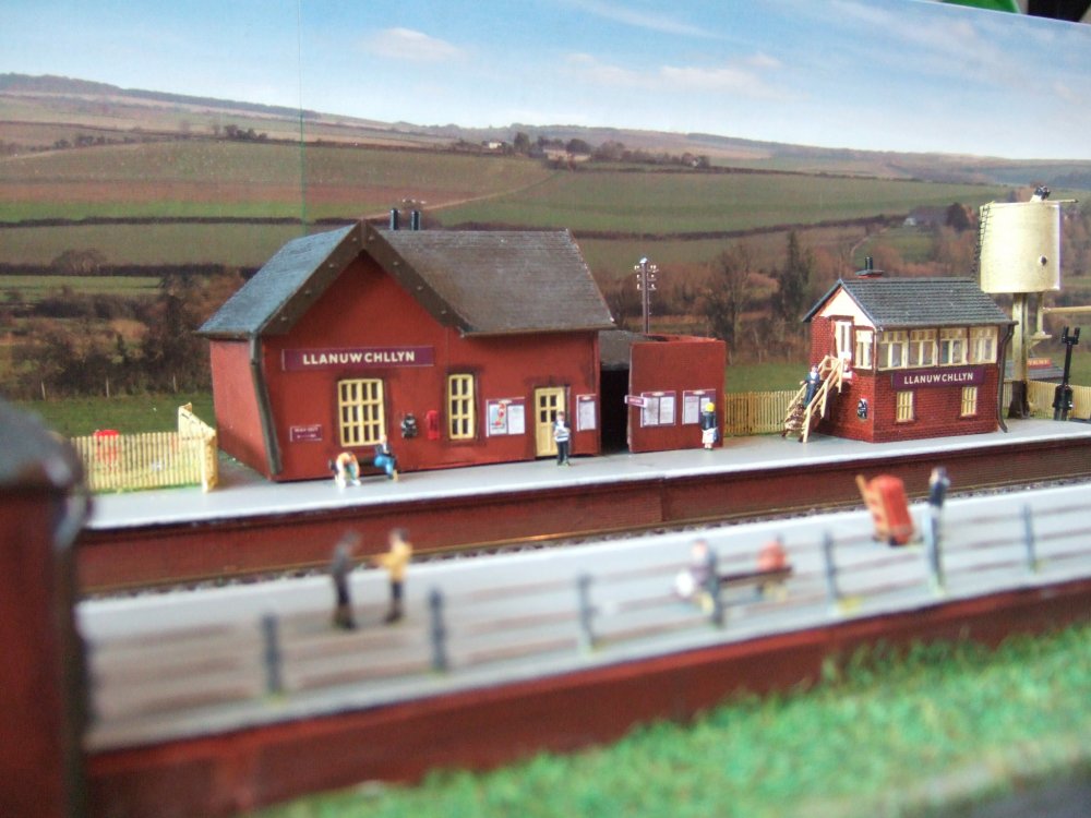

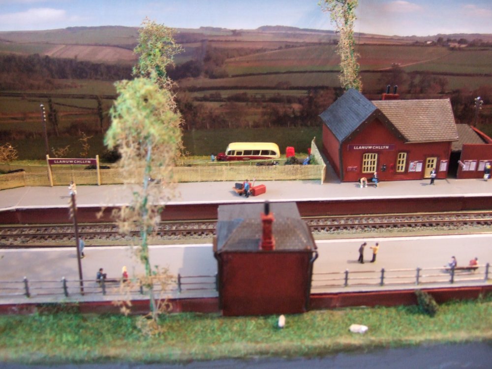

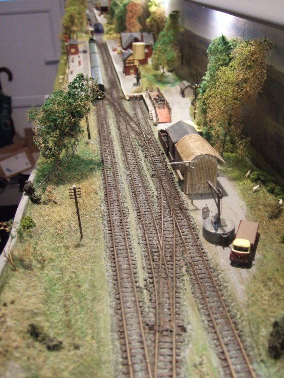

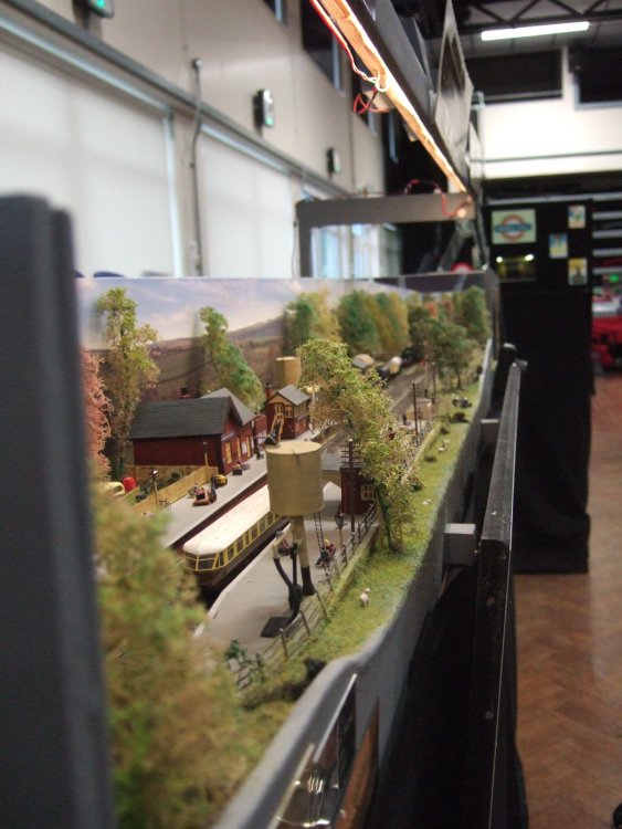

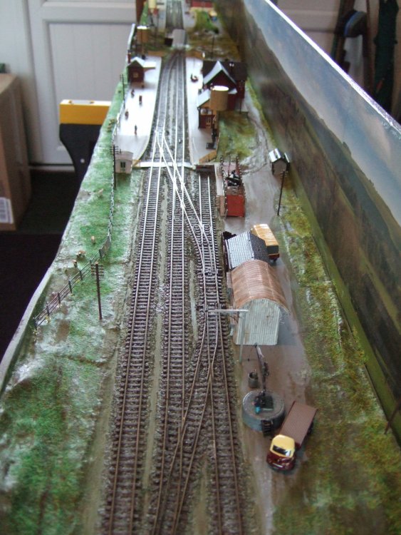

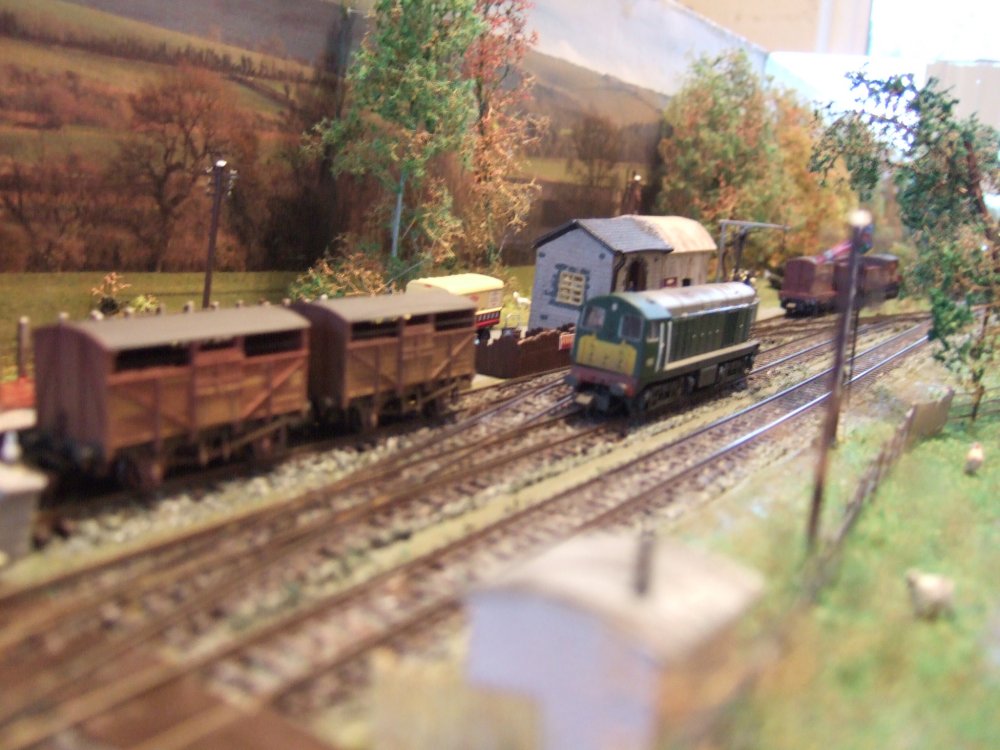

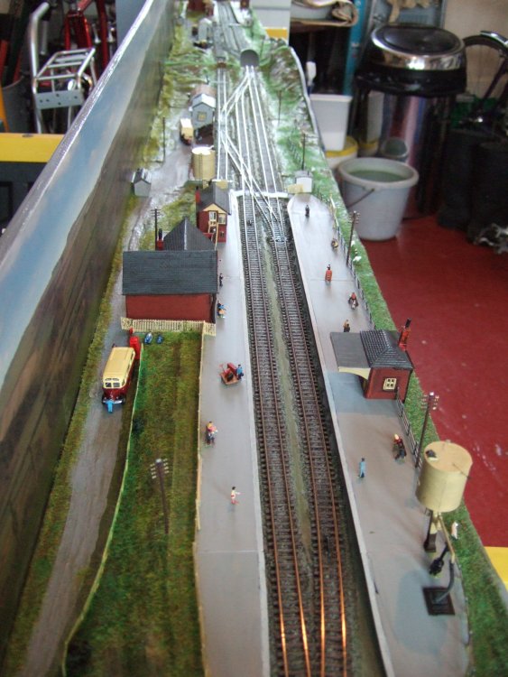

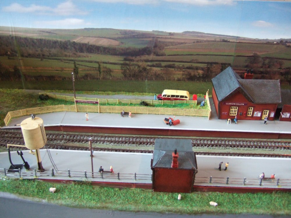

Irishrailwayman Posted February 7, 2018 Author Posted February 7, 2018 While my trees are drying, here are a few photos of Llanuwchllyn with some detail added. I also am working on the signals at present. 2 Quote

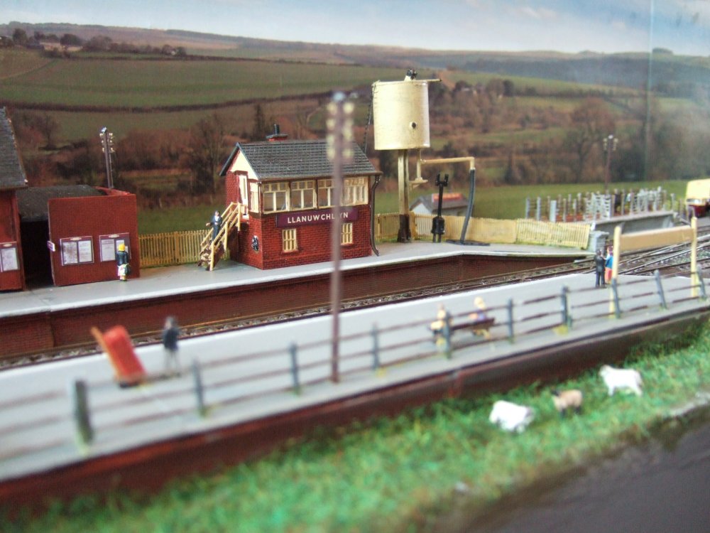

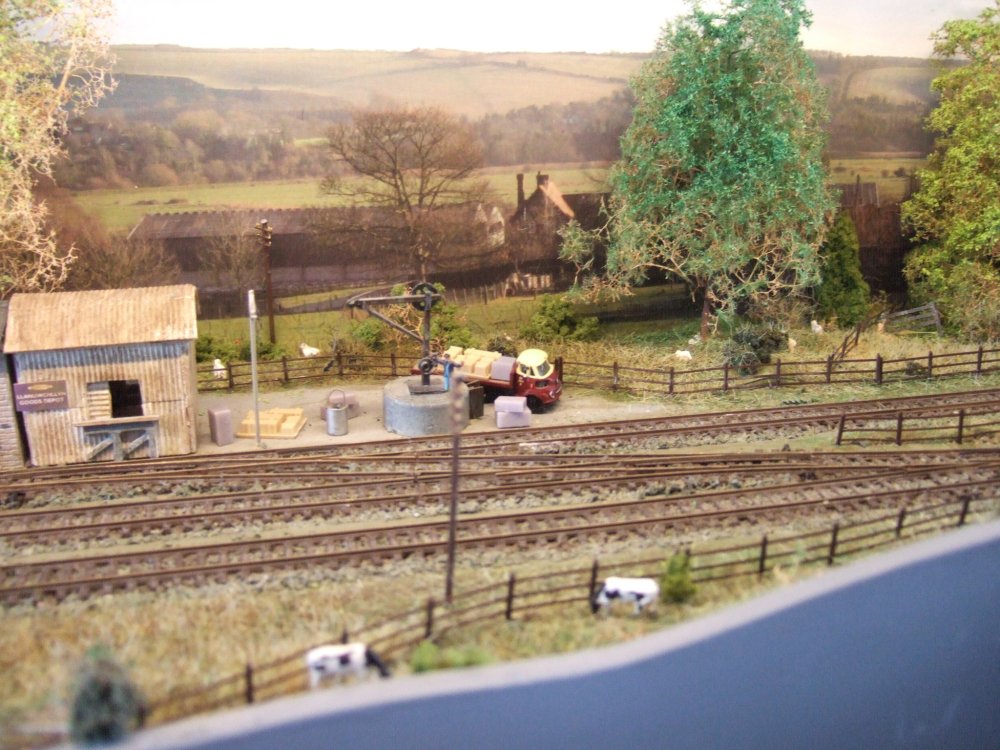

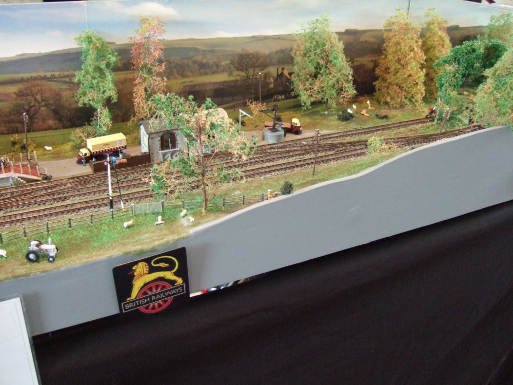

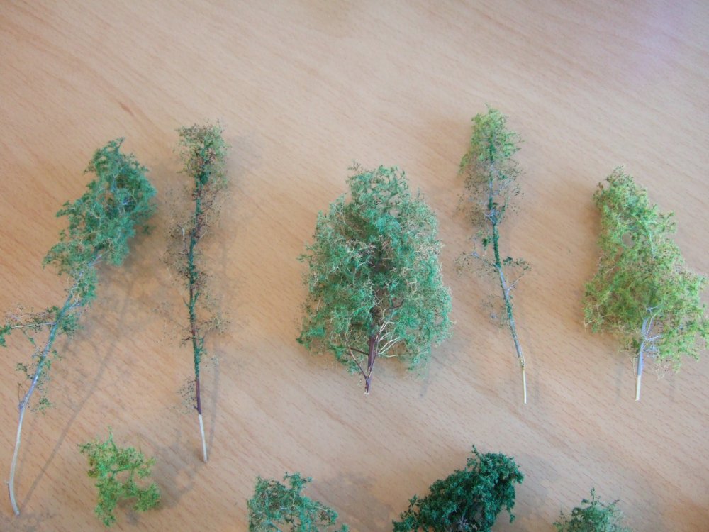

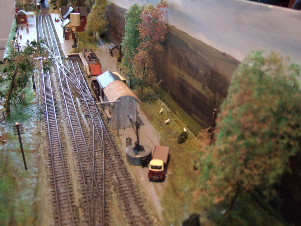

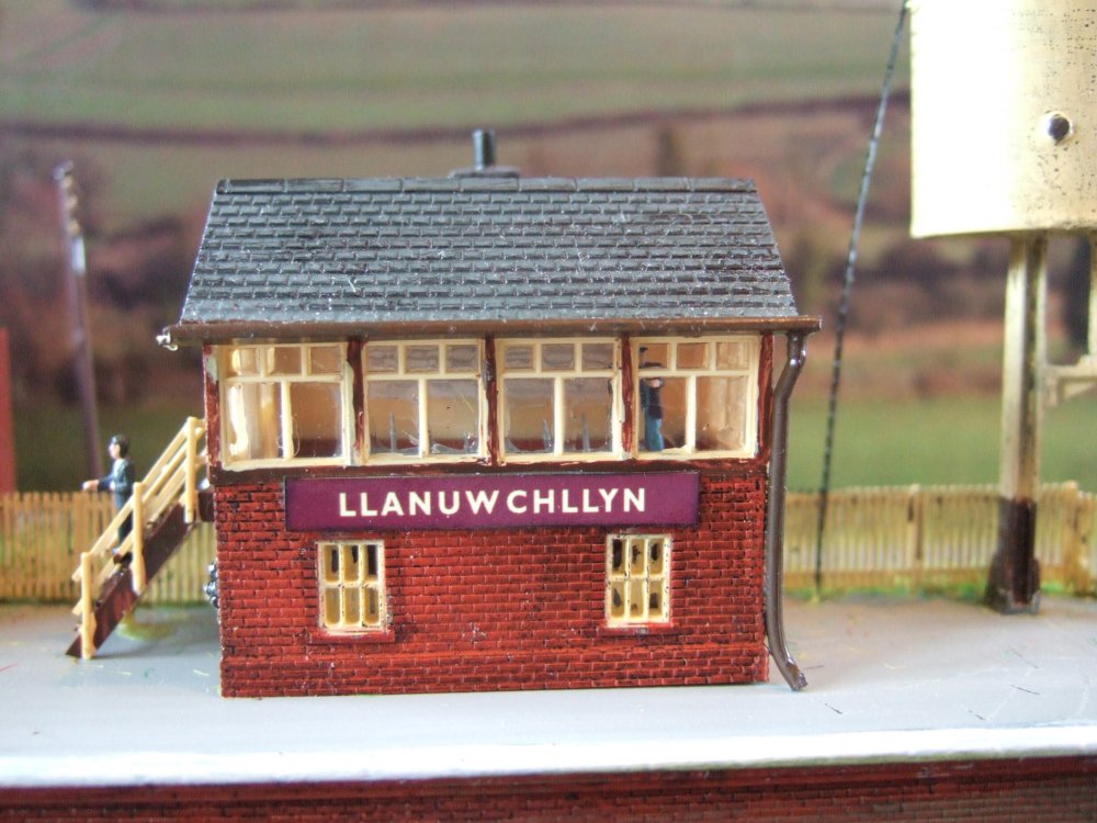

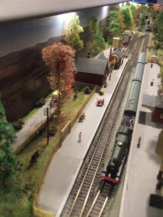

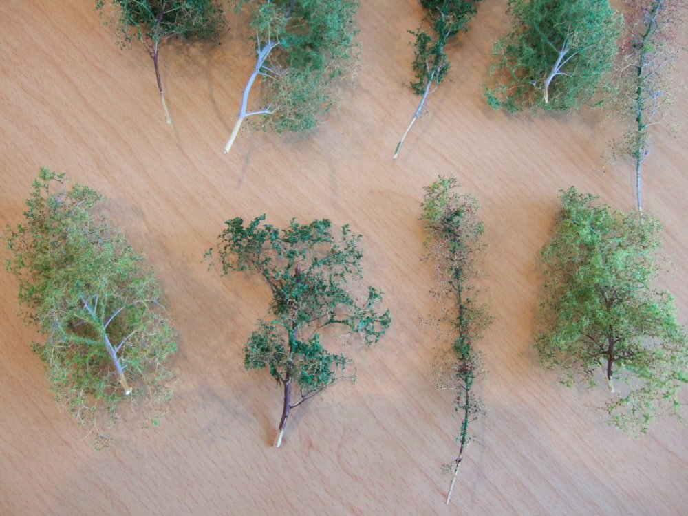

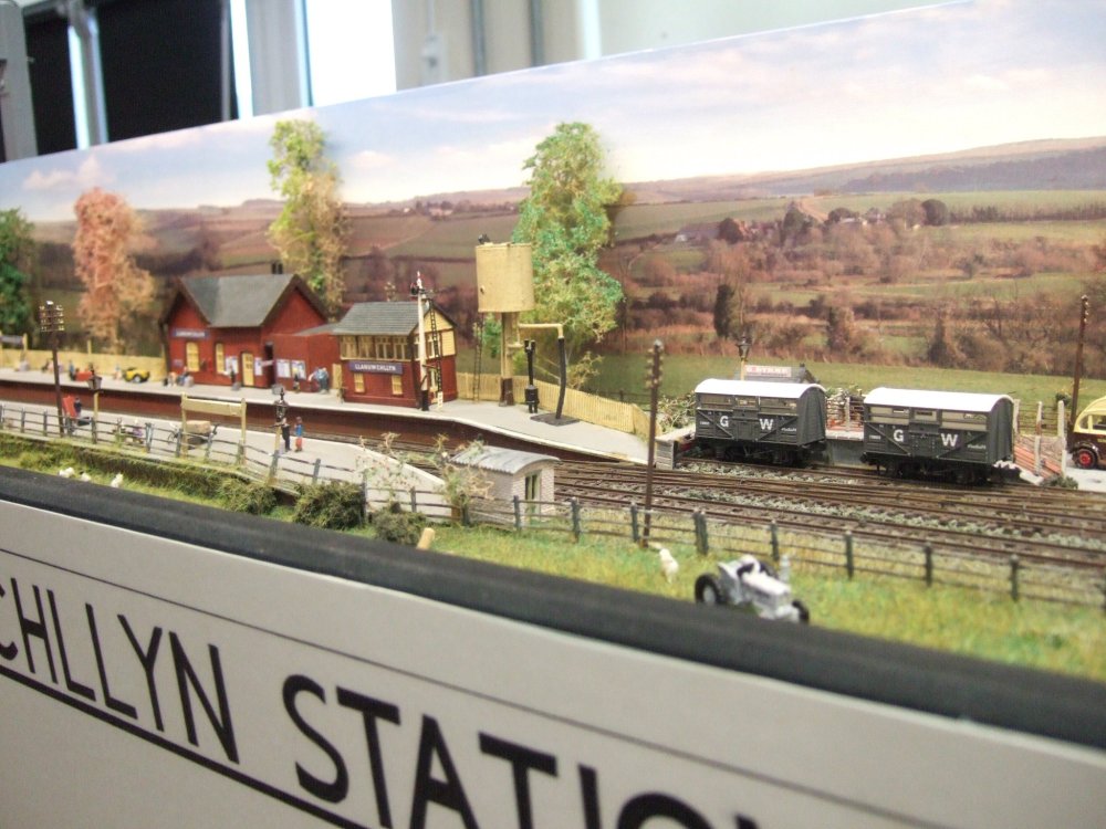

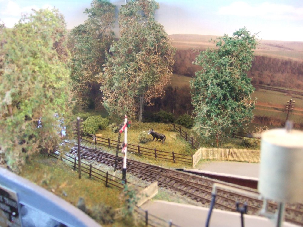

Irishrailwayman Posted February 11, 2018 Author Posted February 11, 2018 A couple of finished seafoam trees ready for planting on Llanuwchllyn. Note the lack of uniformity and variety of colours and shapes - just as with the prototype. In nature, trees are quite tall relative to the train so quite tall ones may be used on a layout even in N gauge. 1 Quote

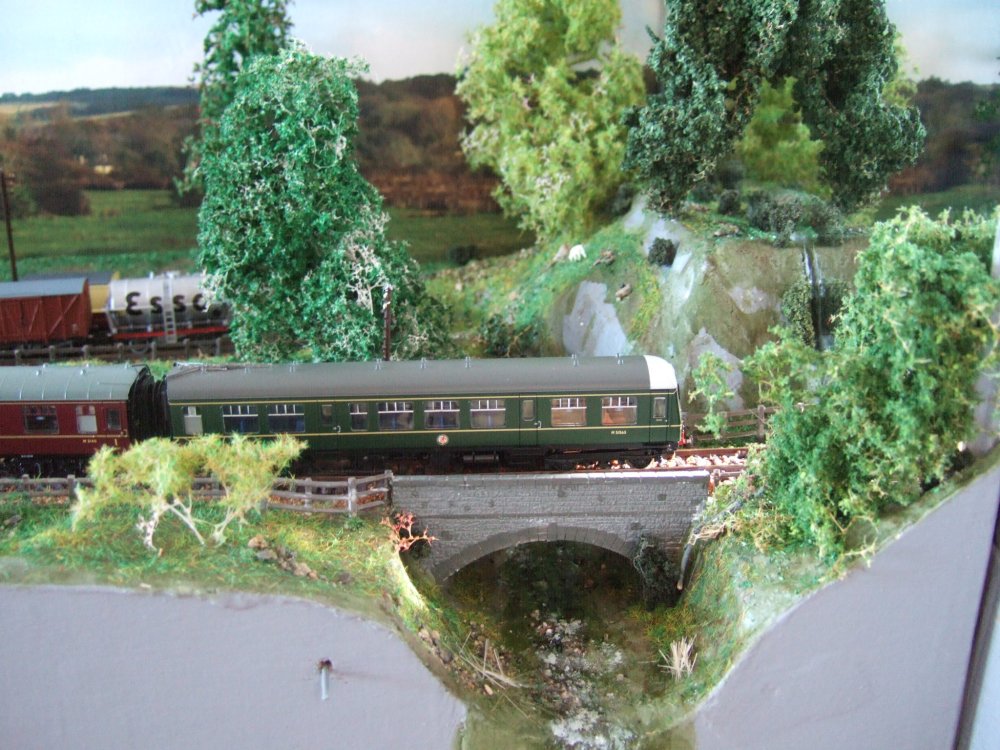

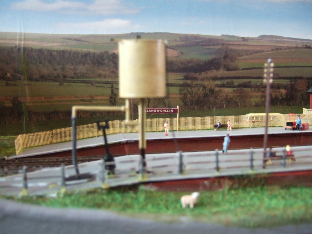

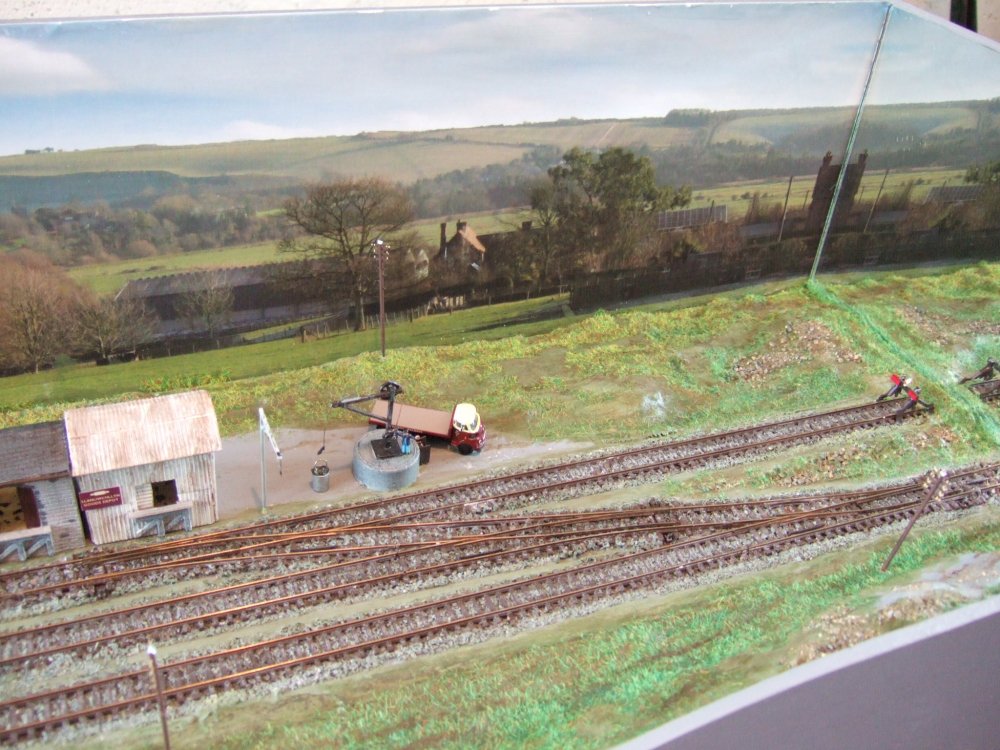

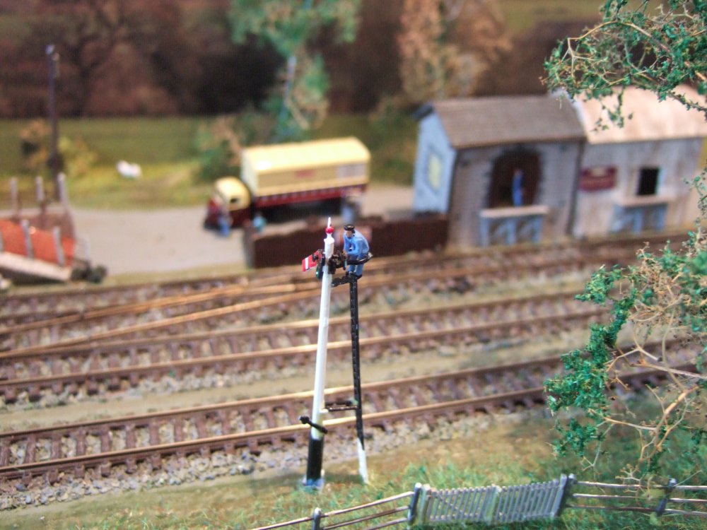

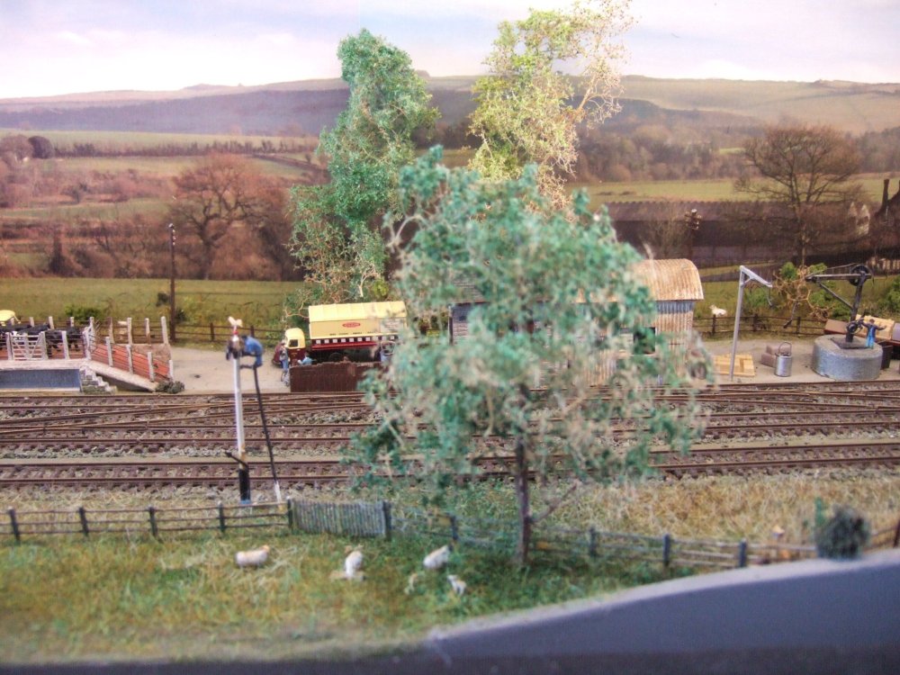

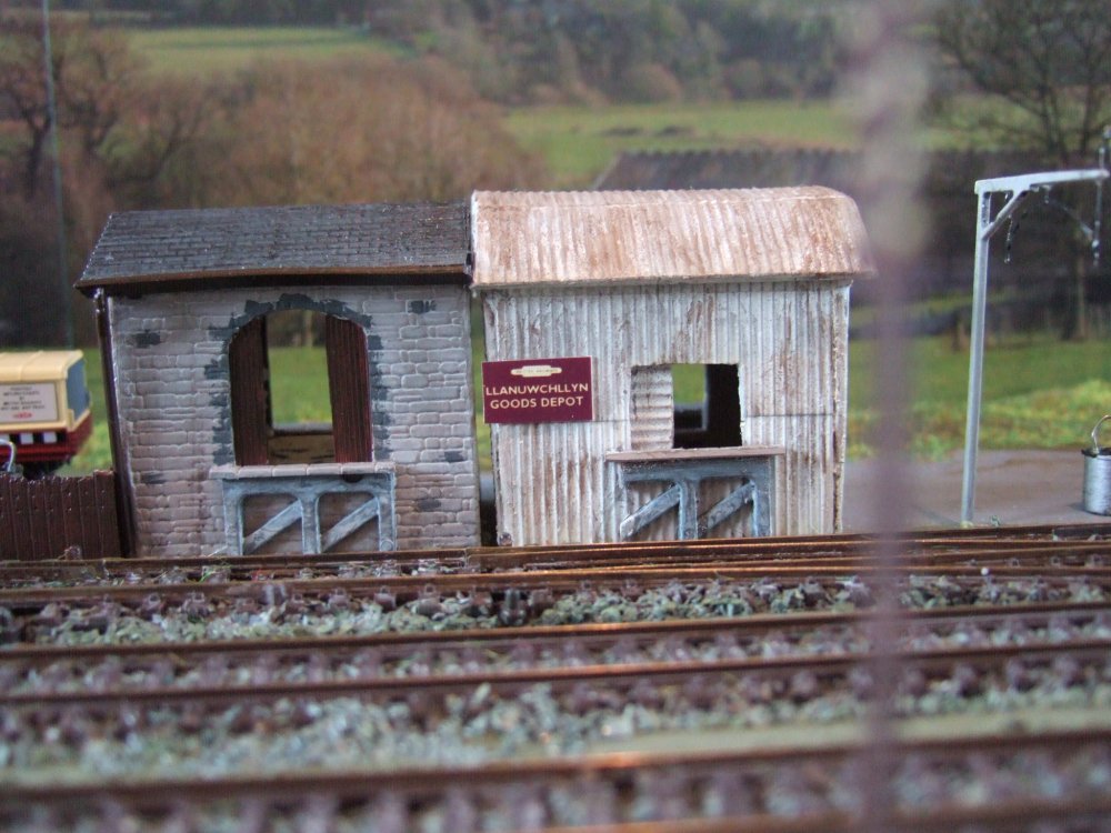

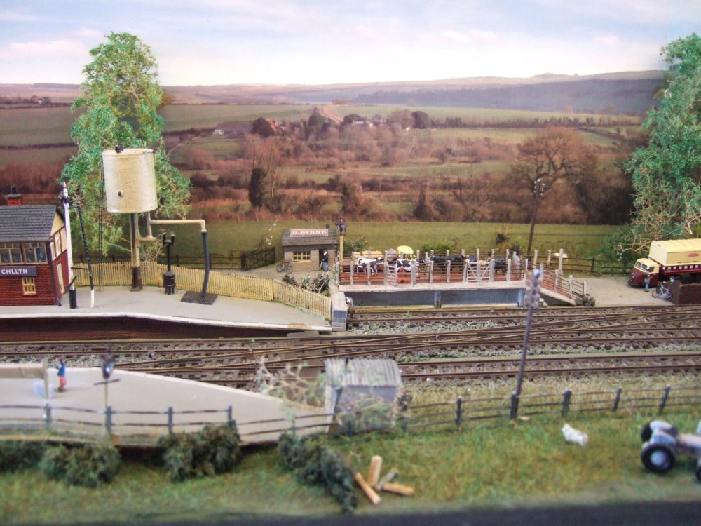

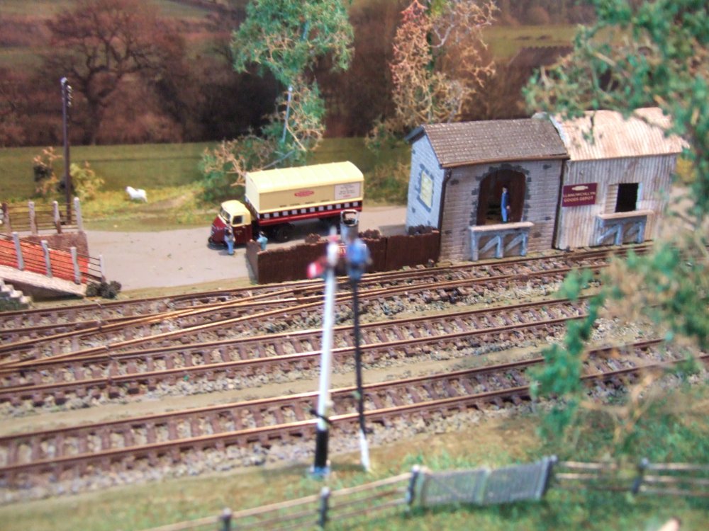

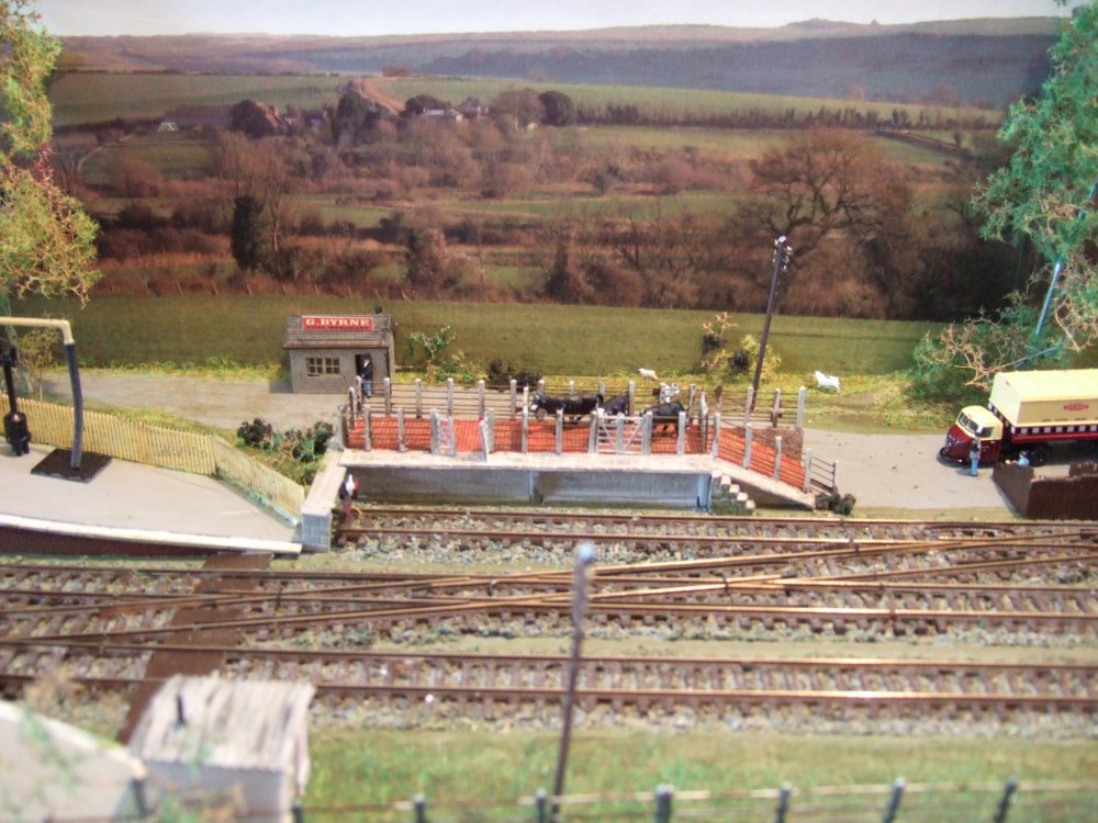

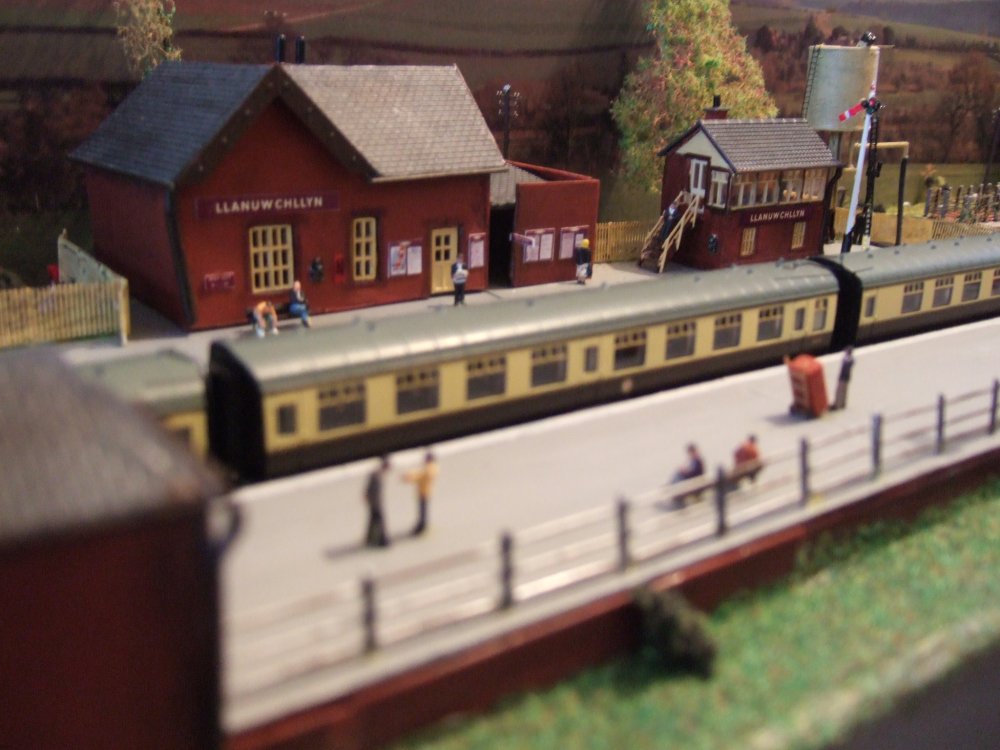

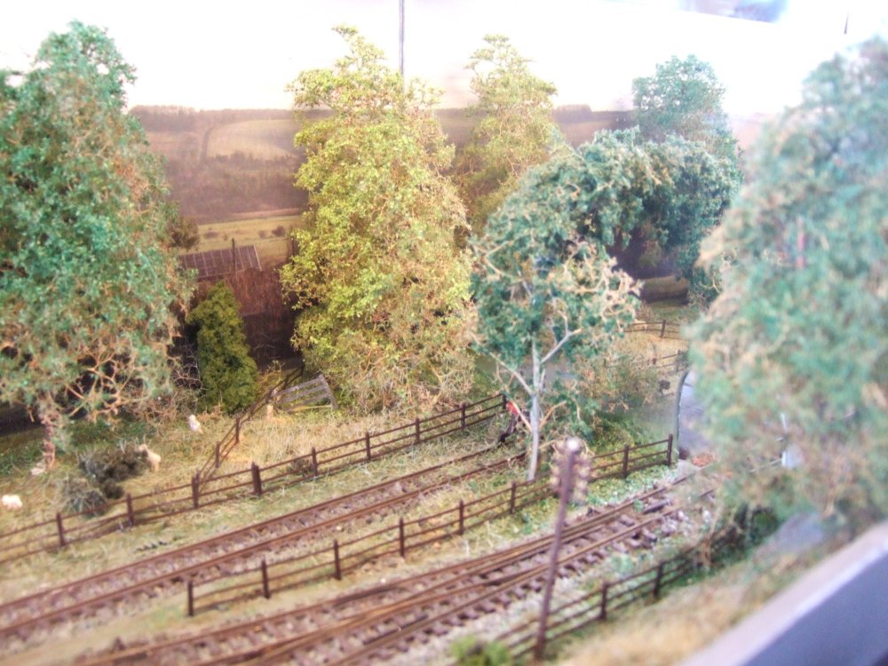

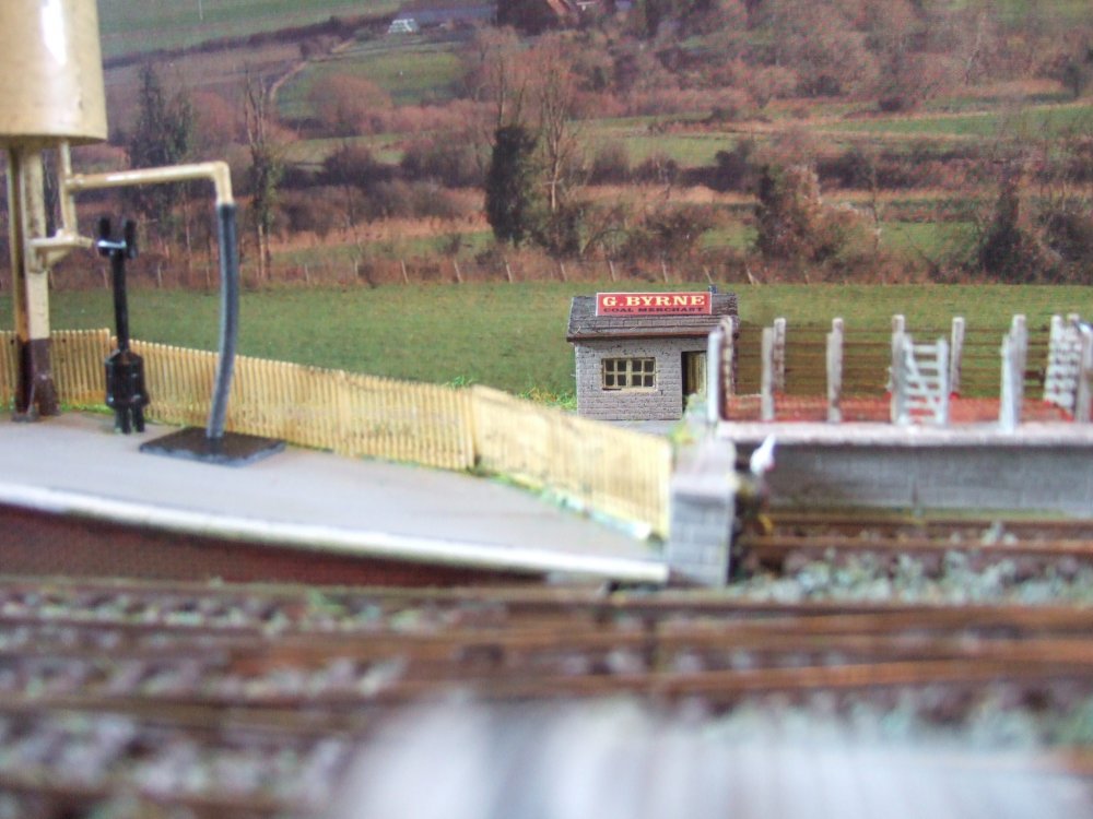

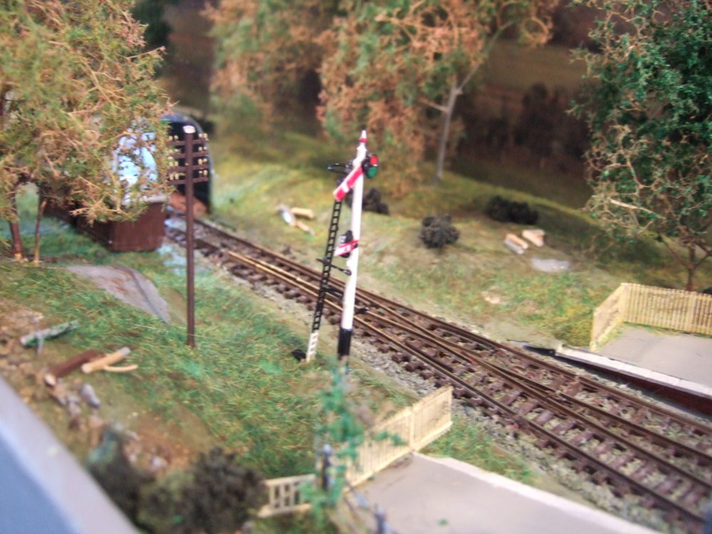

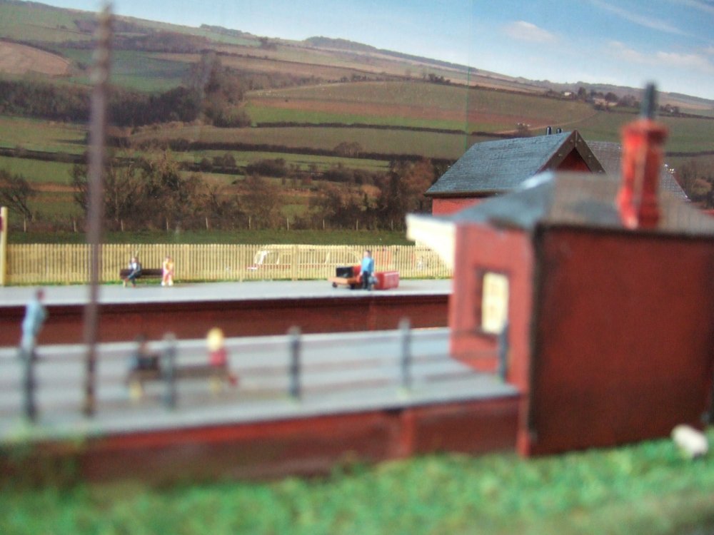

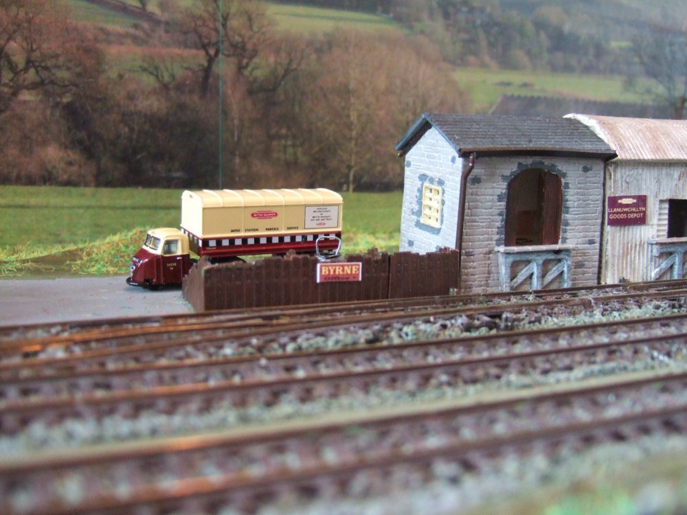

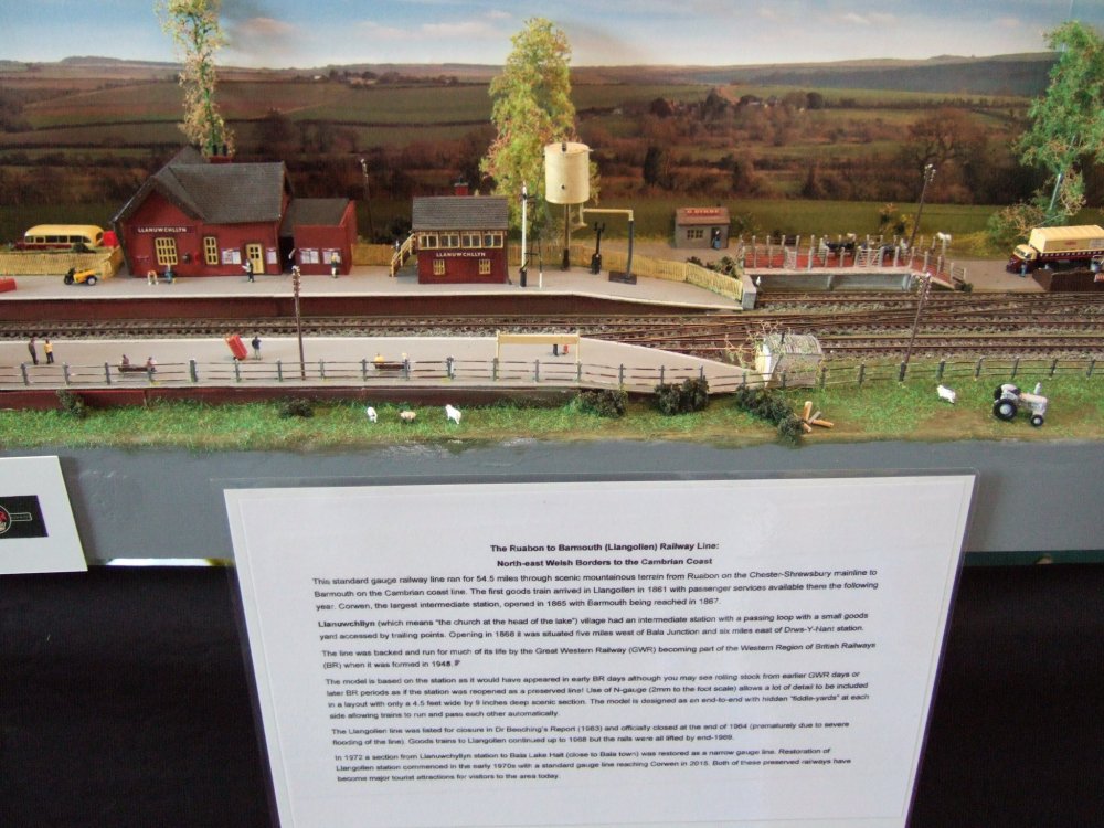

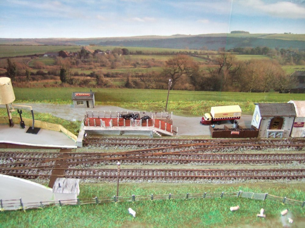

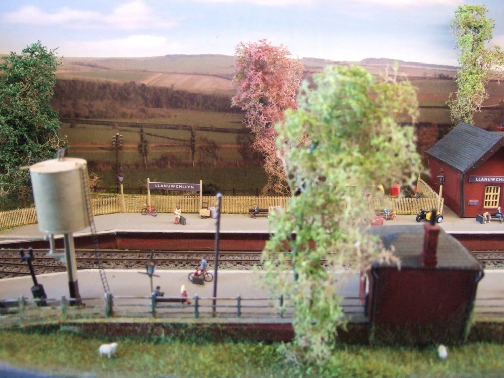

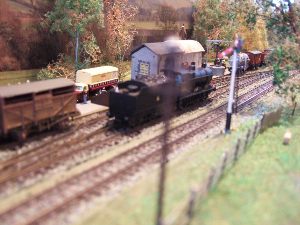

Irishrailwayman Posted March 1, 2018 Author Posted March 1, 2018 Llanuwchllyn has had its trees planted and numerous other details added. Functional testing has begun to iron out any technical glitches. Note the unusual GWR Calling-on signal lower arm on the Down Starter: Two guys have a chat by the Goods Shed while their colleague services the lamp on the Advance Starter signal on the Up line: 3 Quote

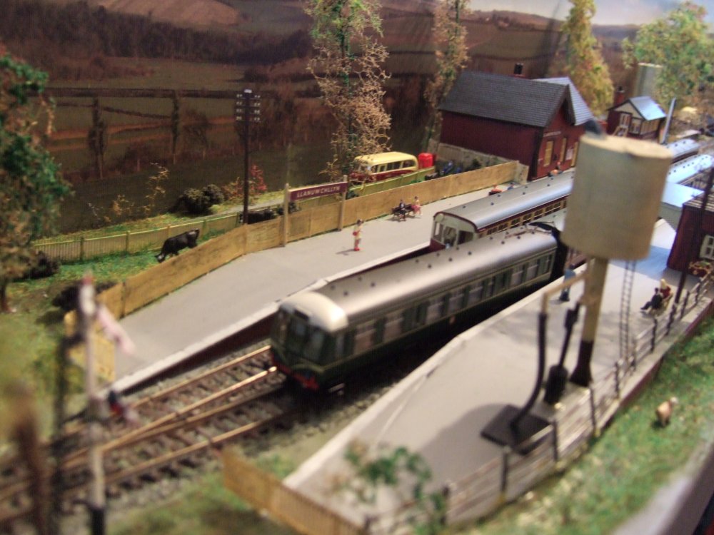

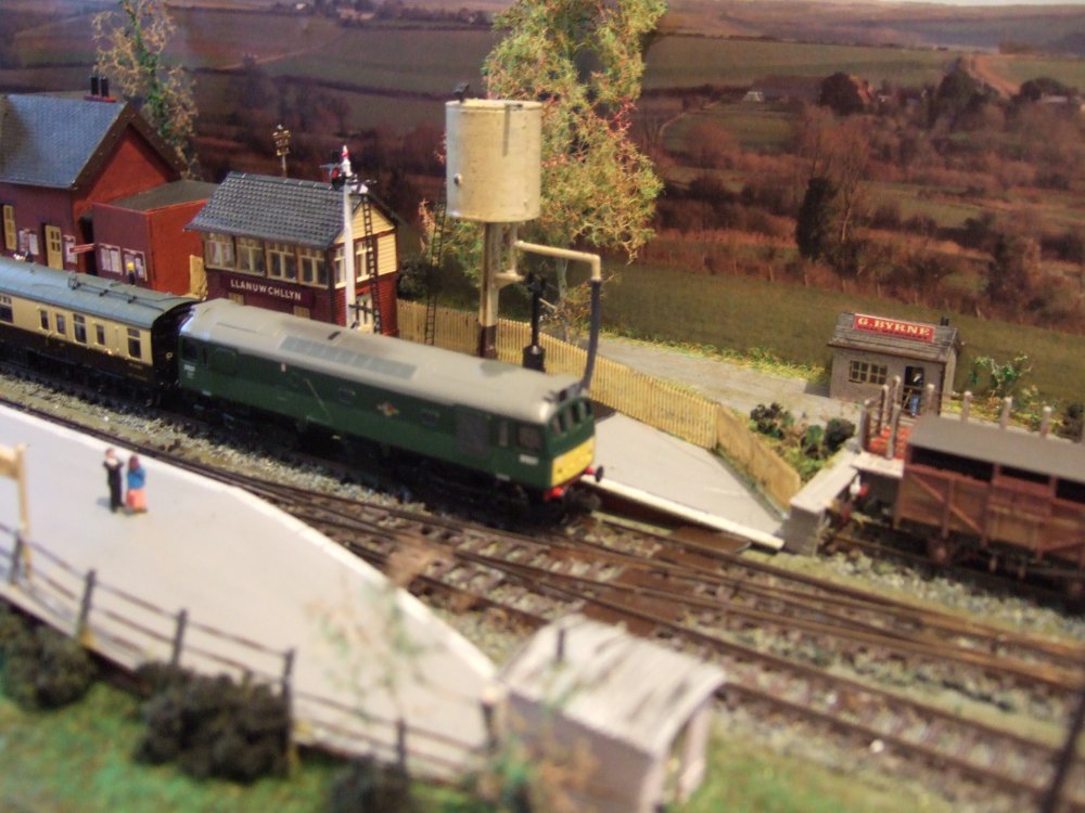

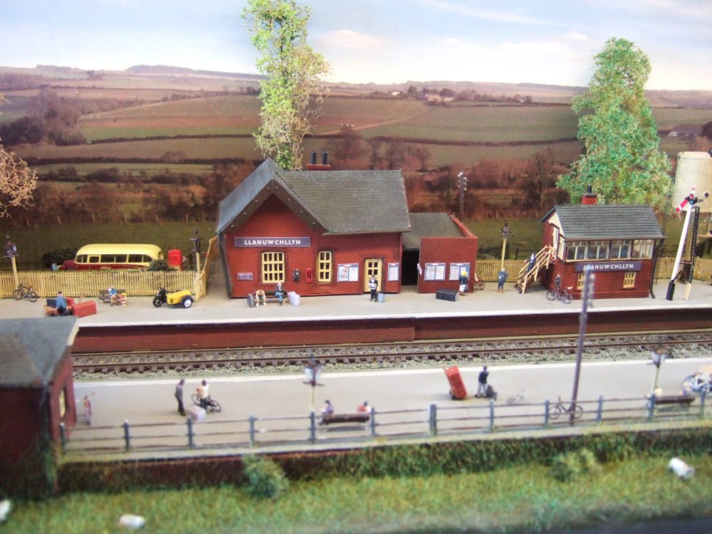

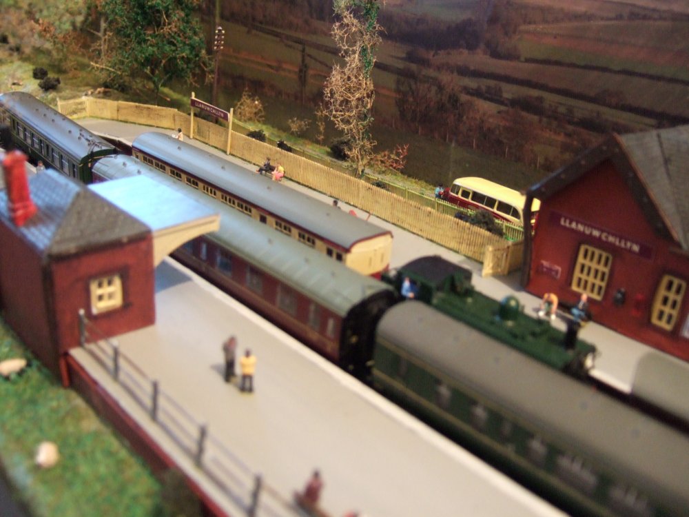

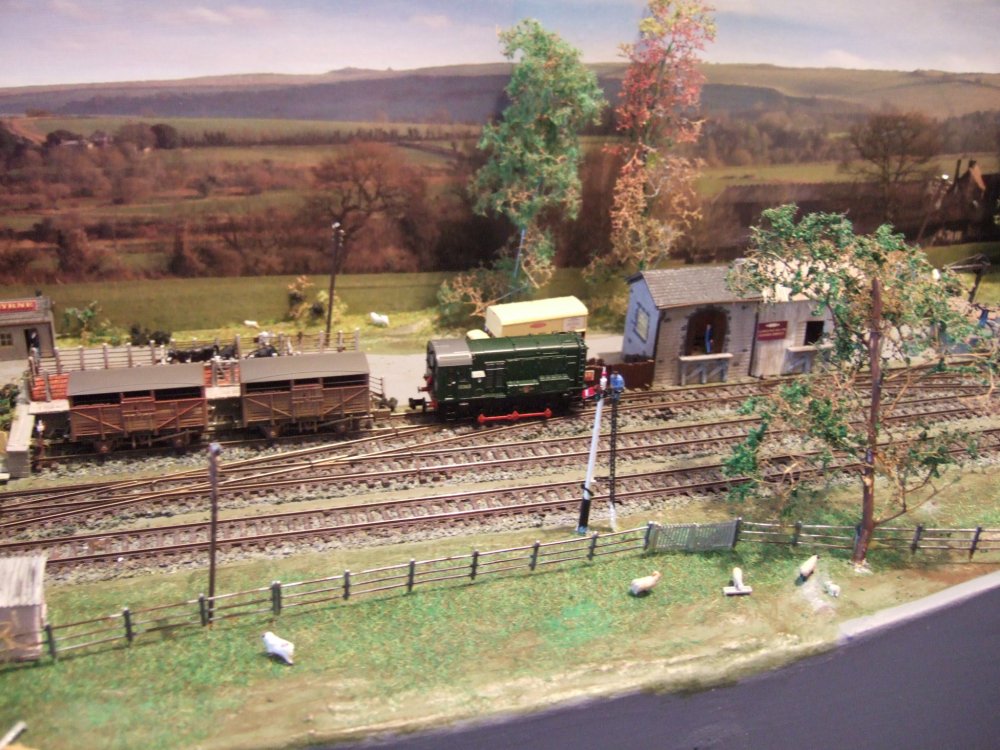

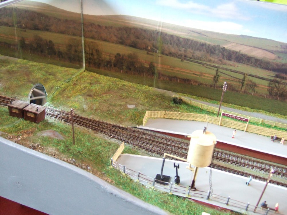

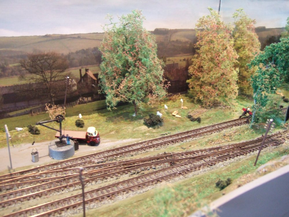

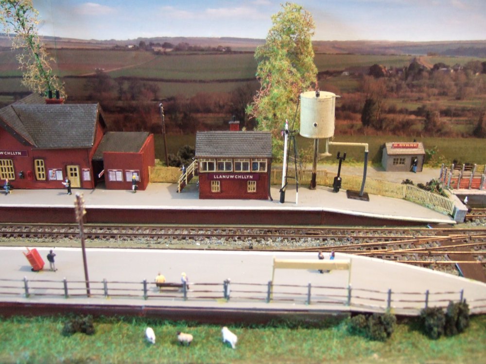

Irishrailwayman Posted March 4, 2018 Author Posted March 4, 2018 A couple of shots of Llanuwchllyn with BR 1960's rolling stock although GWR stock might be equally at home here: 2 Quote

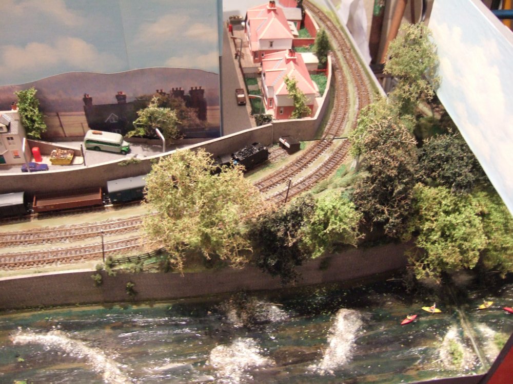

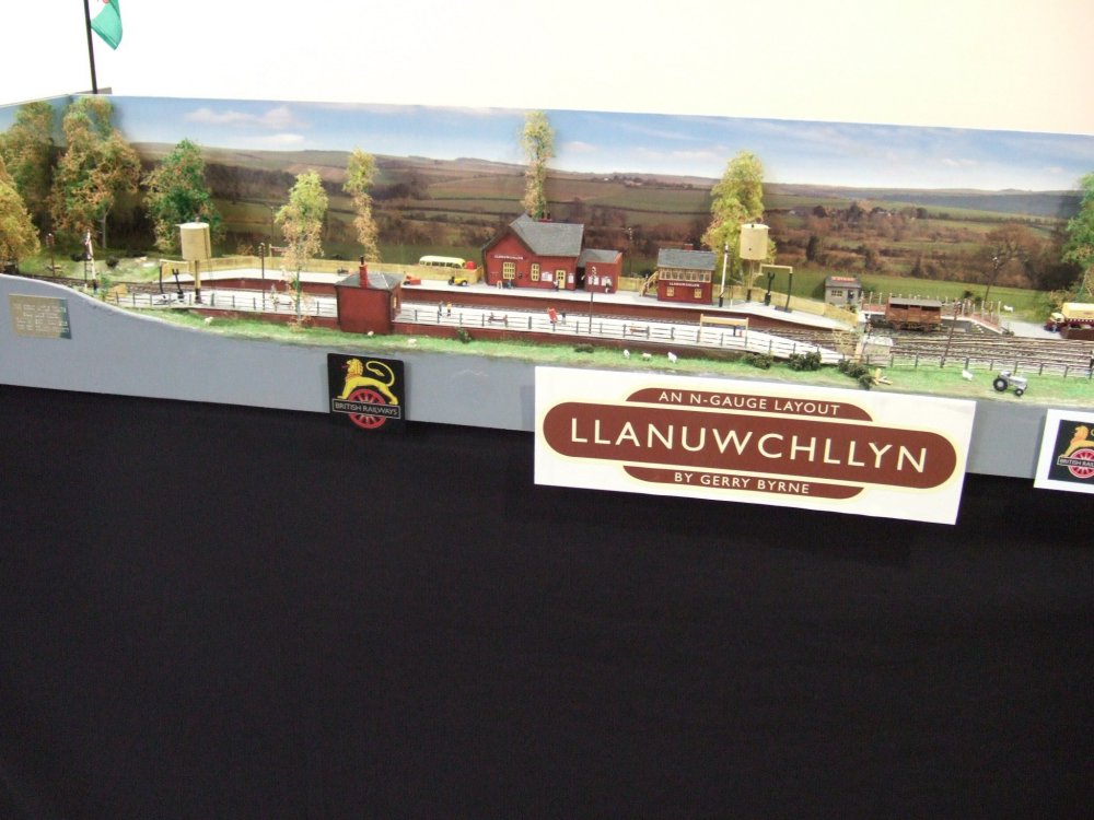

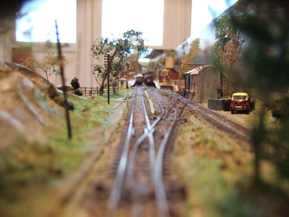

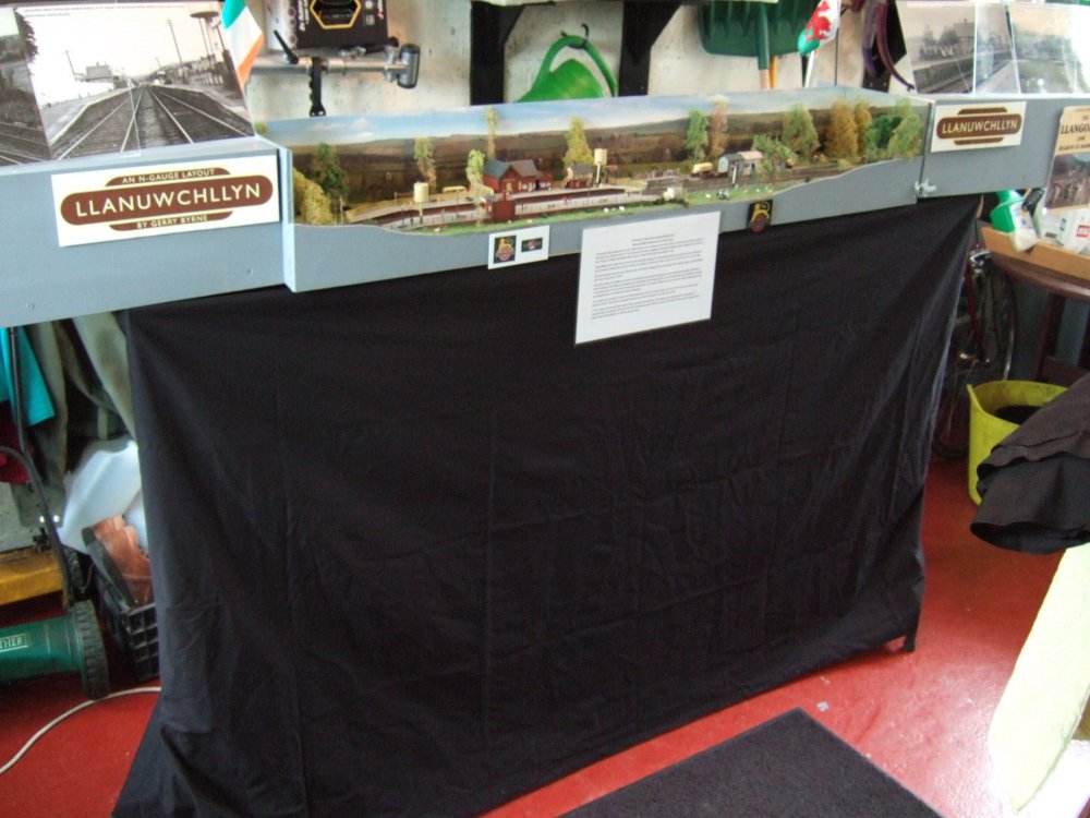

Irishrailwayman Posted May 9, 2018 Author Posted May 9, 2018 Currently getting Llanuwchllyn in N ready for its Exhibition Debut at Bala Model Railway Exhibition in North Wales at end of May: 1 Quote

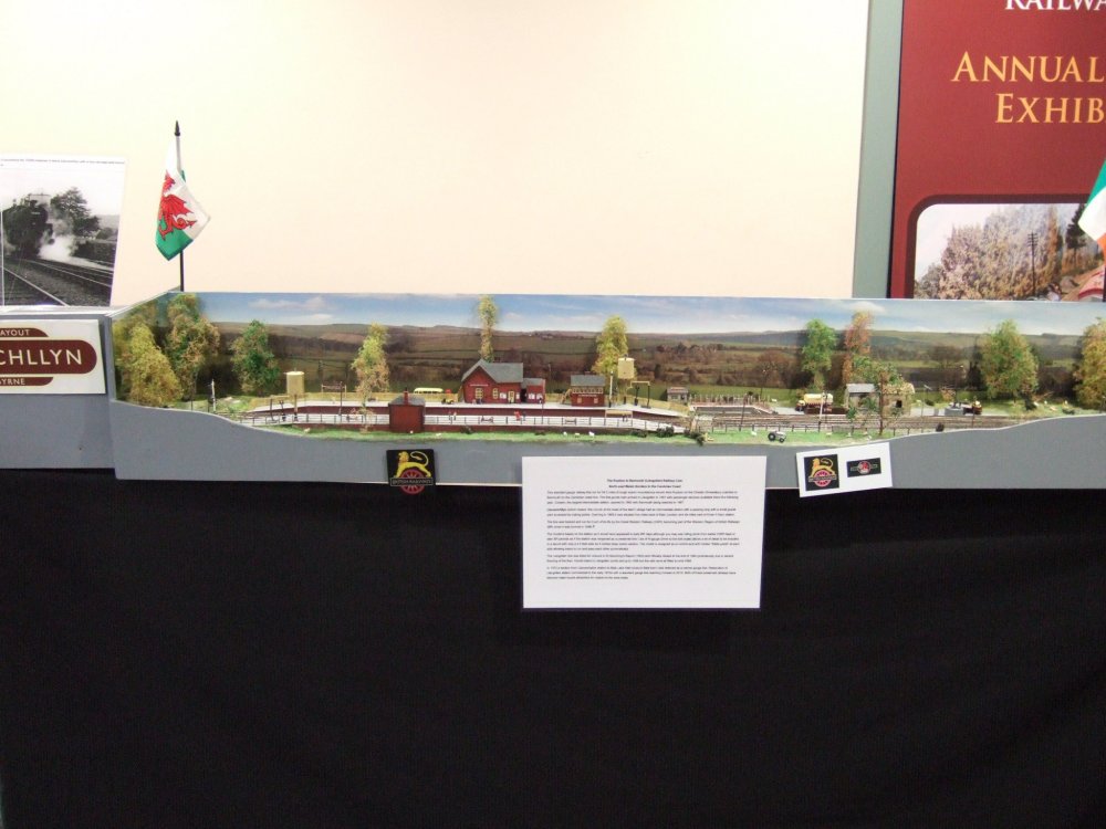

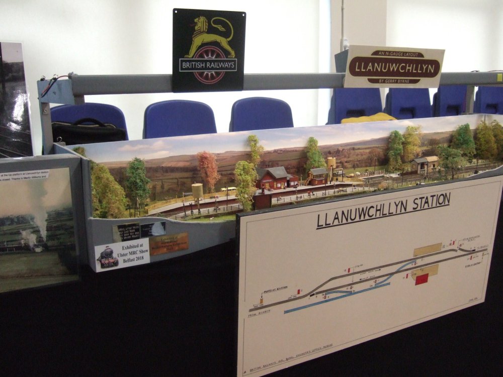

Irishrailwayman Posted May 31, 2018 Author Posted May 31, 2018 Llanuwchllyn makes its Exhibition debut at Bala Model Railway Show, North Wales. 1 Quote
