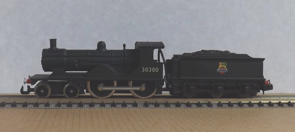

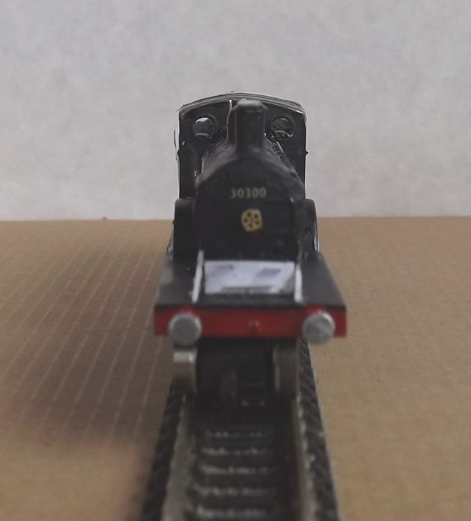

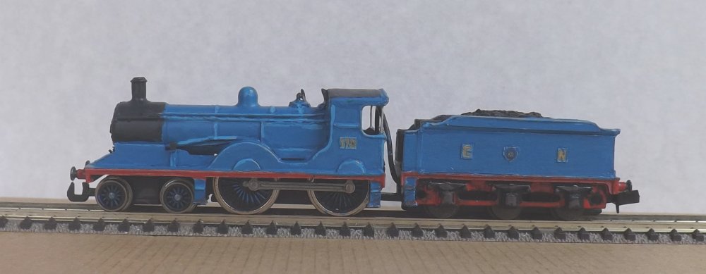

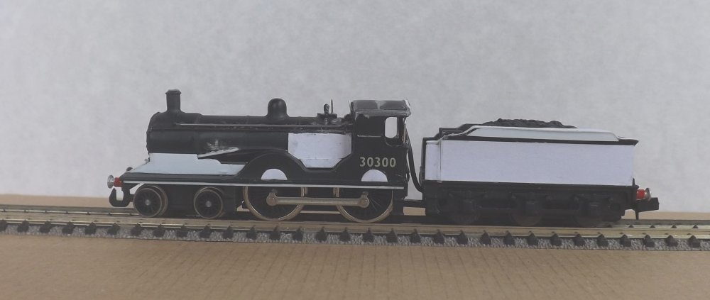

0 MikeO Posted November 17, 2017 Posted November 17, 2017 In my experience over the last 5/6 years it is difficult to get the types of MK1 coaches jhb mentions. The types that are available are not really suitable as they have different configurations of doors/windows etc. While steam locomotives are more readily available these will need some work to make them passable.. Below are some photos an S class I converted from a Union Mills T9 . The photos show the T9 in its original form, the alterations I made to the sides and front and finally the finished article Union Mills T9 Alterations to one side Alterations to front Completed version 3 1

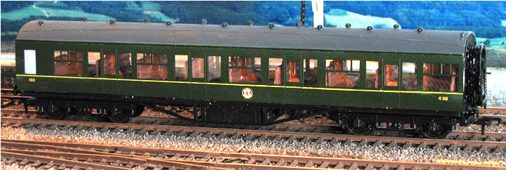

0 Mayner Posted November 18, 2017 Posted November 18, 2017 Worsley Works sides on a rtr Graham Farish or Dapol body would appear to be the best option for producing UTA/GNR coaches Colin Flanagan has produced convincing results with rtr conversions of NCC & GNR coaches using these methods in OO The Worsley Works N scale list does not include GNR stock at this stage http://www.worsleyworks.co.uk/2mm/2mm_Irish_Standard_Gauge.htm but Alan Doherty is likely to produce the sides if you ask him. Finding a donor body may be a bit tricky Graham Farish appear to have dropped their older corridor and non-corridor coaches which may still be available second jhand on e-bay or exhibitions https://www.ebay.co.uk/itm/GRAHAM-FARISH-N-GAUGE-MAINLINE-COMPOSITE-COACH-GWR-BROWN-CREAM-/292327768203 j
