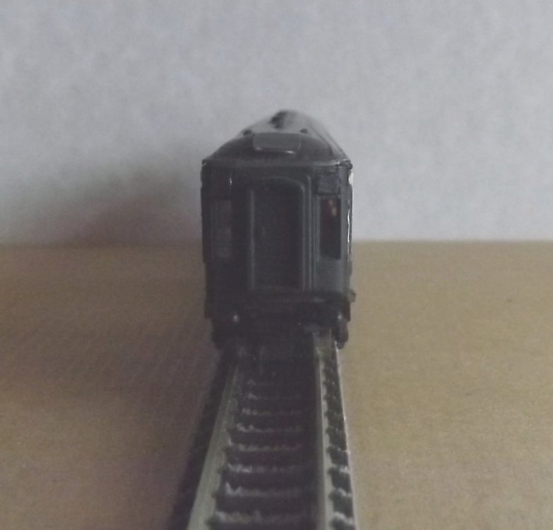

The end windows are different to those shown in Desmond Coakham's book but I will leave them as they are for the moment because I am not sure I could get the right look in N gauge. I will include pics of the ends.Again i do not know about the gang ways.

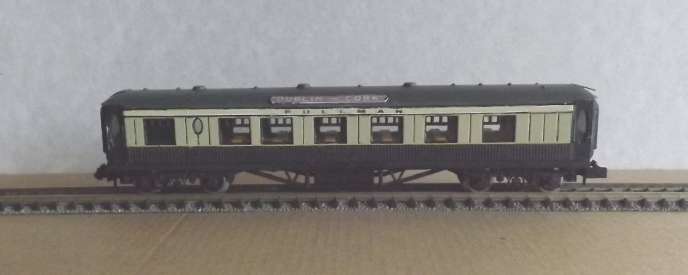

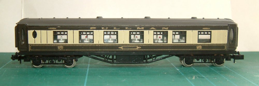

Some pics. I do have a pic of the original coach so the first two are the side and the end. i had to lighten the end to make it clearer.
The next two are the work I have completed todate. Both these photos have been lightened for clarity but in doing so the roof colour has become  grey which it is not in reality.
Sometime ago I did make an attempt to change the end, to block out the small upper window, but this was not a success given the size of the end in N gauge. So i will just leave any other changes for now.
I have painted the chassis brown again this was done sometime ago
