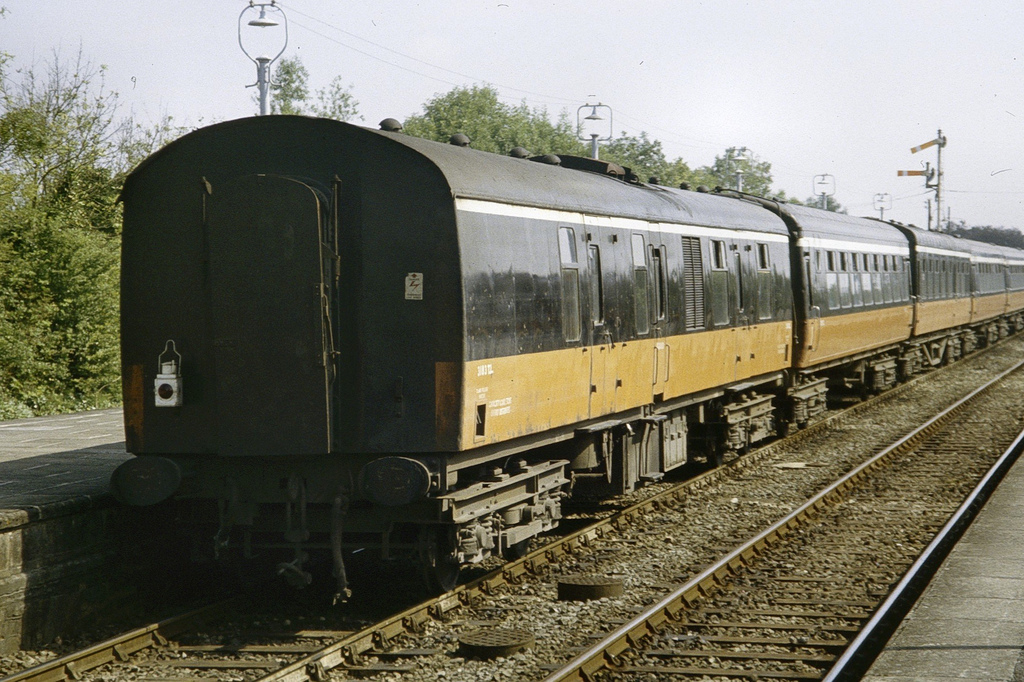

CIE Generating Steam Van 3183 (ex-BR) Ballybrophy
copy right acknowledged - link only
Shows BSGV 3183  in 1983  before the tippex livery , Most photos at this time show this kind of Yellow/mustard livery , rather then the more orange later tippex livery,
Is this correct or a trick of the light , i.e. should I be repainting my Cravens to a far more mustard like colour

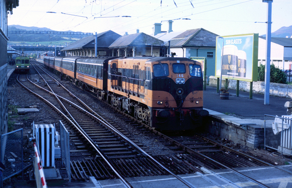

The confusion is hers a picture from 1985
1987-09-07 Irish Rail 146, Bray
which is the correct tone ?
thanks

Its a trick of the light as at that angle you are also seeing a clear reflection of other colours (e.g. sky, trees and foliage opposite, etc).  "Mustard" isn't a colour that jumps to mind from the B&T era.  Tan, Golden Brown, Deep orange (i.e. more red than yellow).  "Some" later IR/IE era had more yellow in the orange mix, whereas early mk3s had a slight red bias.  Consistency was not consistent! :) Also factor in UV and weathering over time.

The one at Bray looks best. The "mustard" and also the unnaturally dark shade apparently shown in the pic at Ardrahan are not at all accurate. They are the result of in one case under-, and the other case over-exposure of the camera film.
All three carriages are exactly the same colour. No weathering or wear comes into it; it's the photo in each case.
