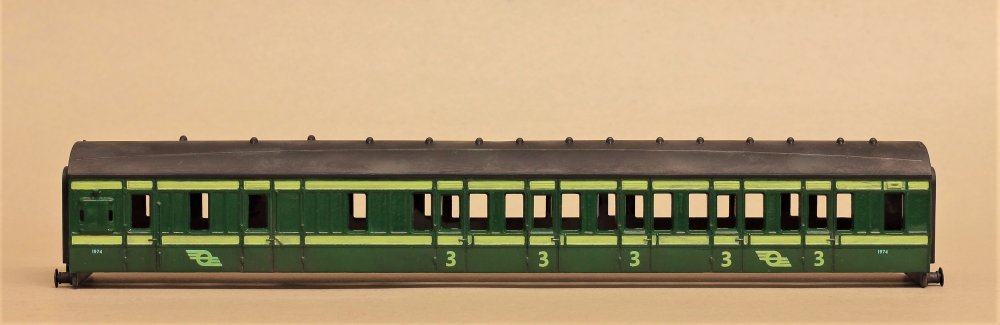

0 murrayec Posted February 28, 2019 Posted February 28, 2019 Here is a test of the Railtec Transfers on a piece of flat cut out styrene for a 6 wheeler lav coach, the green paint is Humbrol 3 and after transfers were on finished with semi-matte Alclad II;- I reckon the colour for the lining looks quite good. The pinstripe is only on the narrow line but looks clear. I bought the 4mm-5635 n674 sheet as it had the smallest logo for this type of coach, but as popeye mentions above the numbers are a problem! - you get enough of the small logos to do ten of these coaches but only enough 1, 2, & 3 numbers to do four & a half of these coaches- it would be great to see the numbers 4 to 0 changed to 1, 2, & 3 on the sheet! If there is to be an edit on this sheet regarding the numbers I would suggest making a separate sheet for the 6 wheelers and I would suggest scaling the logo and numbers down by a .8 factor..... Otherwise I will be using these. Eoin
0 popeye Posted March 1, 2019 Author Posted March 1, 2019 The colour looks good. Did the lining go on ok over the bumps and handles?
0 murrayec Posted March 1, 2019 Posted March 1, 2019 8 hours ago, popeye said: The colour looks good. Did the lining go on ok over the bumps and handles? Hi popeye The test styrene side is scored with the Cameo Silhouette knife for the bumps so not like a model side's deep and wide relief, I used a few drops of PVA in the water as recommended by Railtec's instructions, they say this is preferred to MicrolSol, also to avoid MicroSet. I could not encourage the decal to sit down into the score lines but that might have been expecting to much! But the decal is pretty strong as I had to manipulate the lining with a stick and bud to get it in position with no tares, reckon it will work OK on the actual model sides. I have another styrene side which I'm going to put the high relief vents on and test again. Door handles and guard went on after the decals. Eoin
