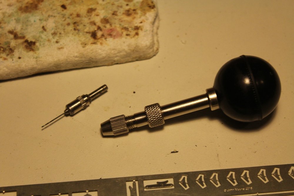

Mayner Posted September 15, 2018 Posted September 15, 2018 (edited) I found that Expo Tools & Equipment ttps://www.expotools.com & Eileen's Emporium https://eileensemporium.com/ are a good source of modelling tools and material in the UK. Both have been in business for many years have on line shops and attend most of the major UK exhibitions. Drills & Chucks: These days I use Titanium coated HSS twist drills for work between 0.5-1.5mm, small titanium coated drills are less inclined to flex and break than plain HSS. Both Expo & Eileens stock reasonably priced drill sets. https://www.expotools.com/cgi-bin/sh000001.pl?WD=titanium coated&PN=16pc-HSS-Titanium-Coated-Twist-Drill-Set-11532.html#SID=109. I have a number of pin vices for holding these drills bought from suppliers in the UK & the States. The most useful tool for holding drills of less than 0.7mm is a miniature drill holder that I got as a freebie with my 1st order from Micro-Mark in the States, this fitsinto the collet of a larger drill. Nuts & Bolts: Traditionally British and Irish modellers have used small BA nuts and bolts, though fine metric threads are creeping in. Bolts are normally supplied slotted countersunk or cheese head. 8, 10, 12 & 14 BA are probably the most common sizes used in 4mm/OO gauge models with 10BA the most common for general assembly work. These threads will self tap in plasticard and possibly resin. Nuts, bolts, washers, taps and dies are available in these sizes from Expo & Eileens. Expo supply a useful BA and metric tap and drill sets complete with drills in the necessary tapping and clearance sizes. Edited September 15, 2018 by Mayner Quote
