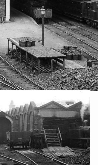

Ballynahinch and Downpatrick definitely had open wooden coal stages

Excellent! Particularly like the overall concept - big pile of coal on the ground, presumably shoved straight out of the wagon door, then with the neat rows of baskets making it easier to load up the tender/bunker.

Hand coaling  may also explain why in photographs, Irish tenders are not rammed full of coal unlike their British counterparts. Which often was like rubbish when you needed to burn it.

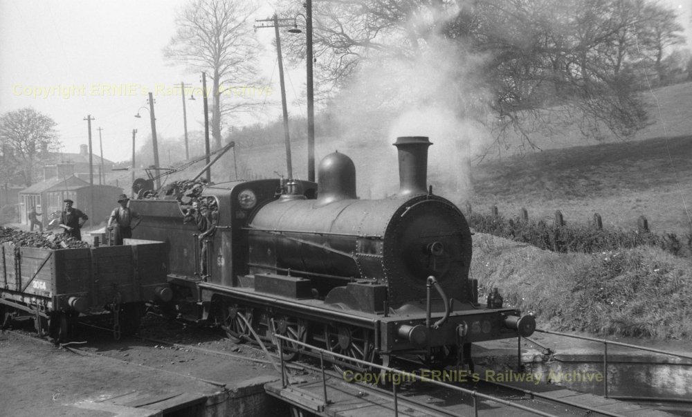

At Enniskillen even though there appears to be a coal bank complete with a crane to load the coal it seems that the coal loaders preferred to transfer it straight from wagon to tender! Some hefty lumps of coal on view.
22April1953 AL class 59 HC Casserley photographer.
Given where Belmullet is I imagine that if it had existed the M&GWR would have probably provided a concrete coal bank and not much else.
