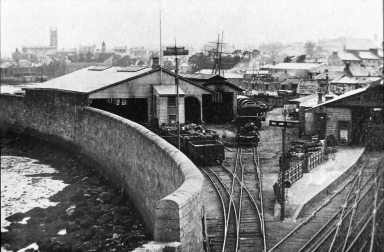

Since my previous topic in the layouts area ended up being hijacked as a general track discussion (fine by me) I decided to start afresh. As a reminder of what I envisaged, here's the original photo that inspired me...
PZ-railway-station-768x505.jpg&key=552ef
...something that fits nicely into a corner of a room and has loads of atmosphere. OK, Penzance isn't exactly Ireland, but most Irish termini are well spread out, even on branch lines to nowhere. This could be made into a convincing Irish layout with a little imagination. The idea could have quite a small footprint in 4mm scale, assuming a lot is left 'off-stage'...
The narrow gauge track on my layout would be far more limited than in the photo and the map. It is really a stage for some interesting modelling. I kind of envisage a very minor independent line along the lines of the Waterford & Tramore or similar, with some very dodgy stock and operating practices. There would also be a bit of through running from a 'proper' railway - and  a tiny bit of narrow gauge.
I use the Waterford and Tramore inspiration very loosely, as I really need a line with a little more operational interest - and I think the W&T is just that little bit too unique and awkward to copy closely. In the course of my research I have found a few other lines that could also provide inspiration. Short, predominantly passenger lines, completely isolated from their neighbours, seem to be a bit of an Irish speciality. The little-known Newry, Warrenpoint & Rostrevor line was another one, if only for a short while. It looks very interesting, but it was absorbed by the Great Northern fairly early on. There seems to be little information that I can easily find, beyond a bit of basic information about the locomotives. Nearly all photos etc. are from after the line was taken over and substantially rebuilt by the GNR. The Cork, Blackrock & Passage is another of the genre - but regauged to 3ft gauge in 1900. There is more information about this one available online (including a Facebook Group) and in books, but almost no useful information about the broad gauge rolling stock. I do like the relatively intensive nature of the service provided though. A freelance line combining aspects of all three could be modelled, filling in gaps with examples from anywhere I can find them.
The CB&P seems to have been a really interesting line in broad gauge days, with stock and features almost in the same league as the Waterford & Tramore, but maybe not quite! Aspects of it could definitely be incorporated in the layout. Here is the Cork Terminus, for example, in broad gauge days. (each square is approximately 300mm in 4mm scale)
There are several features that I like, such as the turntable at the buffer stop end of the platform. The Station at Passage West had a similar turntable, but was otherwise very basic.

The problem I am having envisioning things is the Penzance picture with its 7' 1/4" std gauge and 4' 8 1/2" narrow gauge 🤣

Unfortunately, typical track layouts take up a lot of space, even in remote places. Penzance is not too different in overall concept to a few genuinely Irish 'tight' locations, even if the exact location of each component may be different in relation to each other. Killybegs, Warrenpoint, Schull spring to mind. The main difference from the norm would be the mix of gauges, which is a personal choice and would be different in organisation to Penzance.
