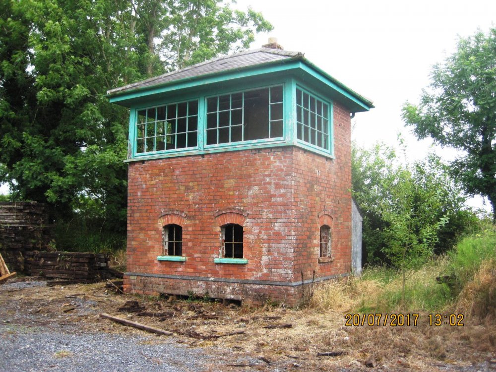

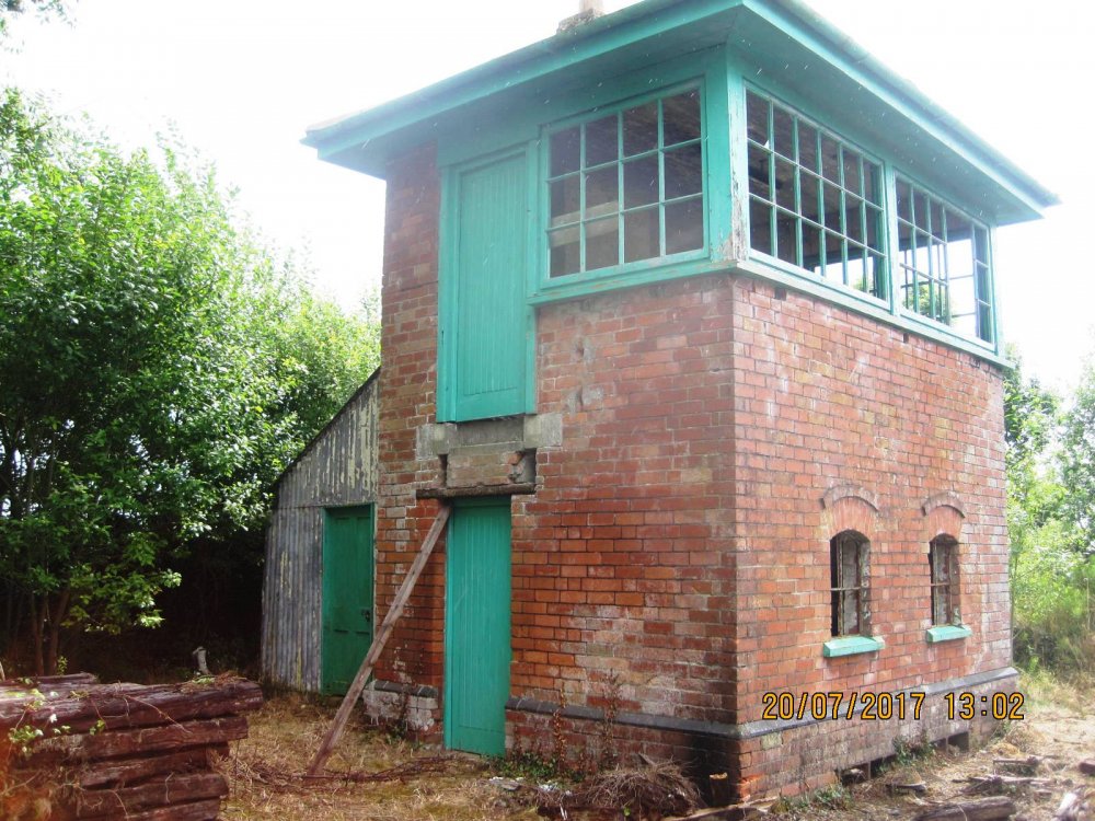

The cabin is a standard GSWR design, the model is based on a survey of Kiltimagh carried out at various dates between 1982 & 2018!
1852571551_mypicturesbackupfile2004302.thumb.jpg.4087a1a16f640ca5ff874226a8338e42.jpg
The lean to oil/lamp hut at Ballyglunin seems to have been a standard feature, there was a similar lean-to on the gable end of Kiltimagh cabin before the Burma Road closed in 1975.
