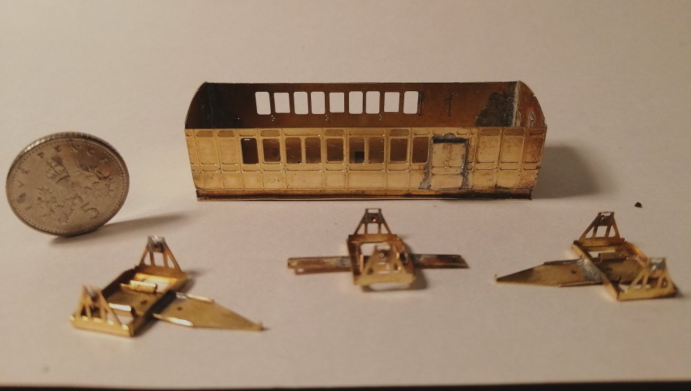

Angus Posted November 8, 2023 Author Posted November 8, 2023 A week away with some modelling tools reinvigorated my modelling. As we were staying near Oban on the West Coast of Scotland I built up some Caledonian Railway stock. An Irish item did fall into the bag in the form of a Worsley Works etch for a GSWR brake third 6 wheeler. I only had a soldering iron and some basic tools so all the detailing is still to add. 8 1
Broithe Posted November 8, 2023 Posted November 8, 2023 Beautiful. I could foresee a market for these as earrings, possibly with an LED and a button cell, for added allure. Christmas is coming. Many years ago, I did actually repurpose some fingernail-sized 'pewter' Morris Minors as earrings, I probably shifted about 15 or 20 pairs. 1 1
David Holman Posted November 8, 2023 Posted November 8, 2023 Exquisite. Shouldn't be allowed, really... 1 1

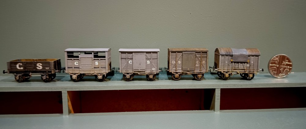

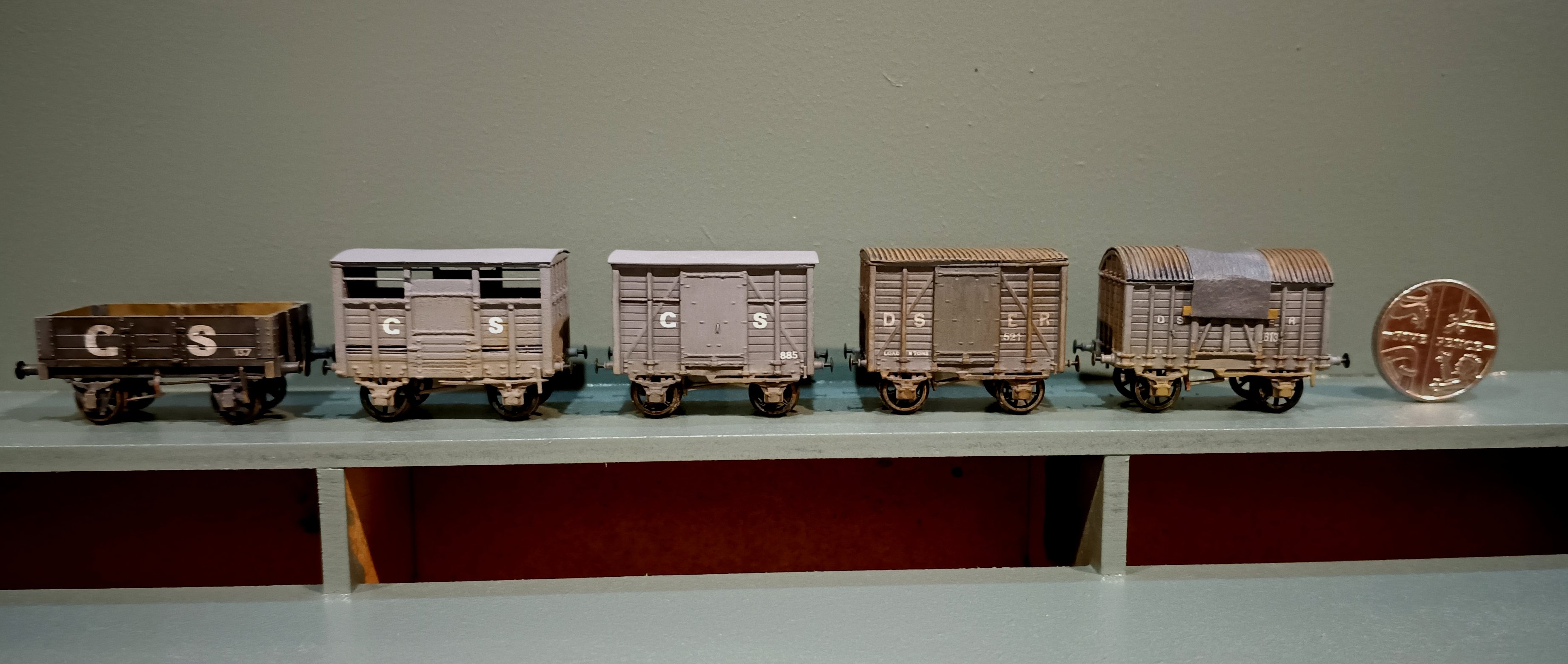

Angus Posted September 4 Author Posted September 4 (edited) I've not done much Irish modelling as demonstrated by the lack of posts here, however, I am assisting with the 2mm Scale Association's stand at the Edinburgh Model Railway Show this weekend. As we normally have a range of models on display, I thought I'd finish some of the Irish models I had knocking around almost completed. I've not weathered the two Great Southern Vans yet but the others are nearly done. I need to do a bit more research on numbering and other markings (load, tare etc). I struggled to find a decent photo of Great Southern vans that showed these (or clearly showed an absence). The vans are all 3D prints from the much missed KMCE and are of DSER origin. The open was a gift from a fellow modeller received complete but unpainted and is I believe a CB&SCR Wagon. As is appropriate a 5p piece included for scale. Edited September 4 by Angus 6 5
Mol_PMB Posted September 4 Posted September 4 Lovely work, and those prints are very finely detailed for 2mm scale. Hope you have a good weekend at the show. 1
leslie10646 Posted September 4 Posted September 4 Absolutely terrific, Angus. Great work. You've no excuse not to run lengthy "Fairs Specials" in N gauge! 2
jhb171achill Posted September 4 Posted September 4 3 hours ago, Angus said: I've not done much Irish modelling as demonstrated by the lack of posts here, however, I am assisting with the 2mm Scale Association's stand at the Edinburgh Model Railway Show this weekend. As we normally have a range of models on display, I thought I'd finish some of the Irish models I had knocking around almost completed. I've not weathered the two Great Southern Vans yet but the others are nearly done. I need to do a bit more research on numbering and other markings (load, tare etc). I struggled to find a decent photo of Great Southern vans that showed these (or clearly showed an absence). The vans are all 3D prints from the much missed KMCE and are of DSER origin. The open was a gift from a fellow modeller received complete but unpainted and is I believe a CB&SCR Wagon. As is appropriate a 5p piece included for scale. Those are absolutely amazing! I thought I recognised the designs as I have some of Ken's equivalemnts in 00 scale. I had several more on order when he sadlt passed away, but it was not to be. Howver, the above begs the question - does someone have these moulds or whatever design tech is needed to produce more? If so, or if possible, I would like to get two more of the vans you have in the middle (in 00, of course). 1
Angus Posted September 5 Author Posted September 5 11 hours ago, jhb171achill said: Those are absolutely amazing! I thought I recognised the designs as I have some of Ken's equivalemnts in 00 scale. I had several more on order when he sadlt passed away, but it was not to be. Howver, the above begs the question - does someone have these moulds or whatever design tech is needed to produce more? If so, or if possible, I would like to get two more of the vans you have in the middle (in 00, of course). That would be the STL files, probably stored on his computer. Sadly, even if his family could accesses them after his death they probably won't realise what they were. A print file for the Ashbury's vans are available as a file download from Rue d'etropal. The model doesn't look as refined as Ken's though. 1
jhb171achill Posted September 5 Posted September 5 22 minutes ago, Angus said: That would be the STL files, probably stored on his computer. Sadly, even if his family could accesses them after his death they probably won't realise what they were. A print file for the Ashbury's vans are available as a file download from Rue d'etropal. The model doesn't look as refined as Ken's though. Ken’s stuff was state of the art, even by today’s standards, let alone when he made them. 1
