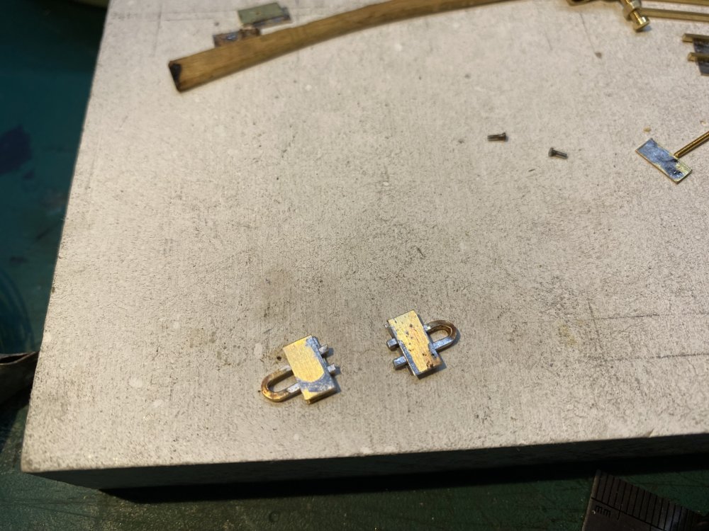

More BCDR coachwork. The Oldbury Brake 3rd has two full-length steps on each side. After some head-scratching, a period of confusion about which step was which and then a fair bit of faffing around, I managed to get them assembled. I’m recording the process as much for my own benefit (I’ve got another one to do) as for anyone else who might be tackling one of these for the first time. Each assembly has 6 struts to hold top and bottom steps parallel to one another. Each strut has 2 half etched lines for folding and there are half-etched pads on the undersides of the steps into which the struts are soldered. I think it’s easiest to make up the step assemblies as separate units before attaching them to the chassis and also to solder them while still flat, before bending the struts, so… Solder struts to the underside of the bottom step, half-etched line downwards… Turn the whole thing over and solder the other ends to the underside of the top step, half-etched line upwards… Fold the bottom step up through 90 degrees… Then fold the top step down through 90 degrees… et voila! The whole caboodle attaches to the chassis by soldering the top step to 4 little tabs folded out from the sole bar. There are four half-etched pads on the underside of the step to help locate it correctly. However, on my set of etches, assuming I’ve understood the build process correctly, these half-etched pads are on the bottom step rather than the top, which would put the steps in the wrong place. This was what confused me in the first instance. It doesn’t really matter - they’re not essential and no kit builder was harmed in the process but this bit of the build really challenged my capacity to visualise in three dimensions. I haven't soldered the steps to the chassis yet because I still need to source appropriate axle boxes from somewhere. Stepping out, but cautiously Alan PS Does anyone know what this is?

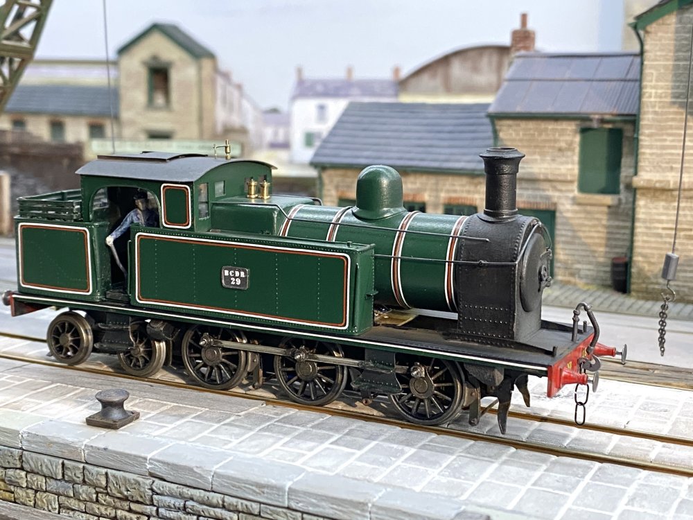

Peckett has emerged from the paint shop at long last. There were a few hiccups with the job (of course there were) not to mention a colour change along the way but I think it's about finished. It's had a little weathering to take the shine off it. It also has a cheap chip from Hatton's and some lead in the tanks so it shuffles along in a satisfying narrow-gaugey sort of way. It will make an appearance at the O:16.5 narrow gauge stone yard in due course. Meet Pete, the Peckett pilot.

Beautiful paint finish on the loco Ken. Looks really well and a great lineup of loco plus coaches
