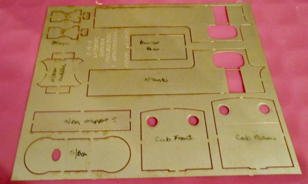

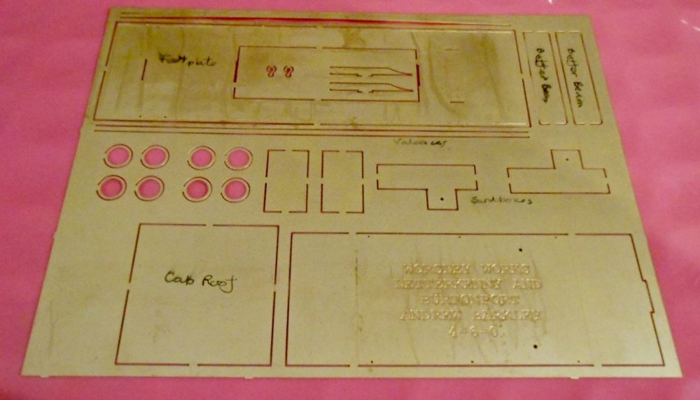

Have been adding various bits and pieces this week - a case of studying as many photos as you can, because a lot of stuff doesn't make it into a line drawing, let alone a Worsley etch! In no particular order I have: tidied up the smokebox saddle, filling in gaps with thin brass sheet and solder added the four cab handrails, cursing myself for cutting off the thin strip of brass in the space. Had I just cut it in the centre, it would have been perfect for a simple fold back around the top of each handrail instead fiddling around with tiny bits of brass strip handrails along the tank tops fitted bunker extension pieces: on three of the class, it was the usual coal rails, but No4 had them plated over, so this is what I've done added vacuum pipes, from the spares box tank filler caps, made by adding a thin oval of nickel silver to a thick oval of brass smokebox lamp iron, simply made from a piece of bent brass strip cab beading, from phosphor bronze strip cab spectacle plates - thankfully in the etches, because they would be a swine to make otherwise a white metal brake cylinder, from the spares box various pipe runs along the boiler from cab to smokebox various operating rods, mostly I'm guessing for the sanding gear The cab interior still needs to be done, but have put in an order to Laurie Griffin Miniatures for a suitable set of castings, plus a sset of loco jacks for the footplate and something to represent the curious spherical valve [taps? sticking out of the front of the sand boxes. I'm also pondering on couplings, having come across the Zamzoodles, which are working chopper couplings and would really look the part. However, the curse of the turntable makes them problematic for shunting mixed and goods trains because, like Dinghams and others having two hooks together is not recommended, so I may yet be sticking with Kaydees. So, while waiting for my orders to arrive, have started on the Great Clean Up, prior to the first 'witness coat' of primer & then however many further sessions of filing, scraping and sanding in order to get a decent paint finish. The various implements of torture are shown below: The set of 'whiffers' [variously shaped needle files] are always useful, as is the dreaded glass fibre brush meaning I can look forward to the usual nasty little splinters in my fingers for the next few days. As already mentioned, the loco is going to be No4 and a correct set of Barclay builders plates have been ordered from the Light Railway Stores for well under a tenner [including postage], which is great value. I'd been looking forward to creating that rather splendid Swilly [very] dark green, but Patterson's book says the Barclays were black with yellow lining for No4, though if anyone knows different, please let me know. The remaining pictures show the loco ready for that first witness coat, so it will soon be goodbye to all that shiny brass and nickel silver.
