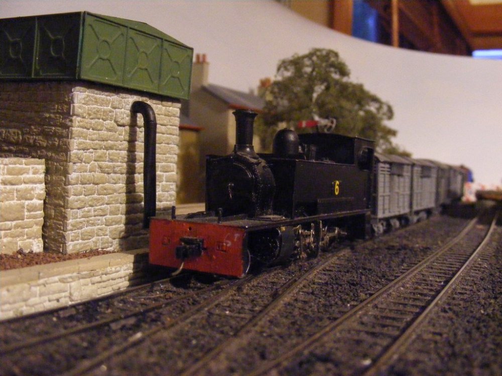

Very impressive shed Tony, certainly a center piece for a diorama in its own right. I have used the Wills stone sheets for smaller buildings and generally brush paint the building in a dilute light grey to pick out the mortar joints and then paint the stone work with a dry brush technique. Paint is Testors solvent based Floquil which is unfortunately no longer available

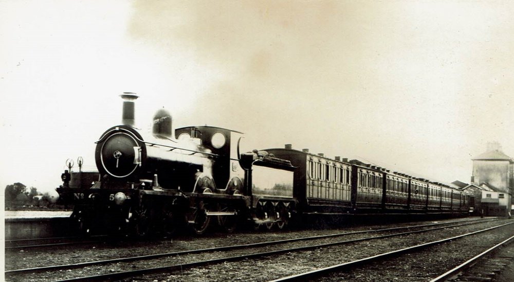

Nice photo most likely in GSWR days almost looks like a fine scale model, possibly a "colourised" black and white photo. Station looks like a weatherboard version of Rosslare Strand and other stations on the Rosslare Route. I don't buy the Cuban analogy, the GSR & CIE continued to invest it physical plant and freight rolling stock up to date between the 1920s & early 1980s. Most of IEs current freight rolling stock is at least 30-40 years old, while the standard open wagons in the Castlecomer photo are of a new design at the time 4-5 years old.
