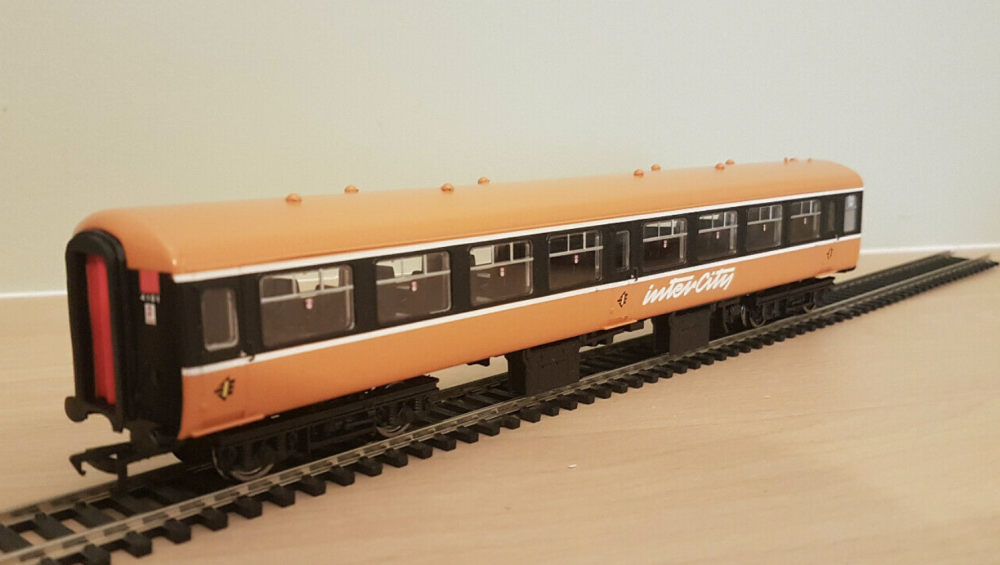

FYI, There is about 4 of these Bachmann Irish rail intercity mk2a's due to sell on eBay in the next few hours. It's not me selling, I already have a rake, but remember some folks were lamenting their lack of availability. Expensive but at the moment bids aren't completely insane. https://www.ebay.co.uk/itm/Murphy-Models-IE-Intercity-Mark-2A-TSO-Open-Second-Coach/193760517684
