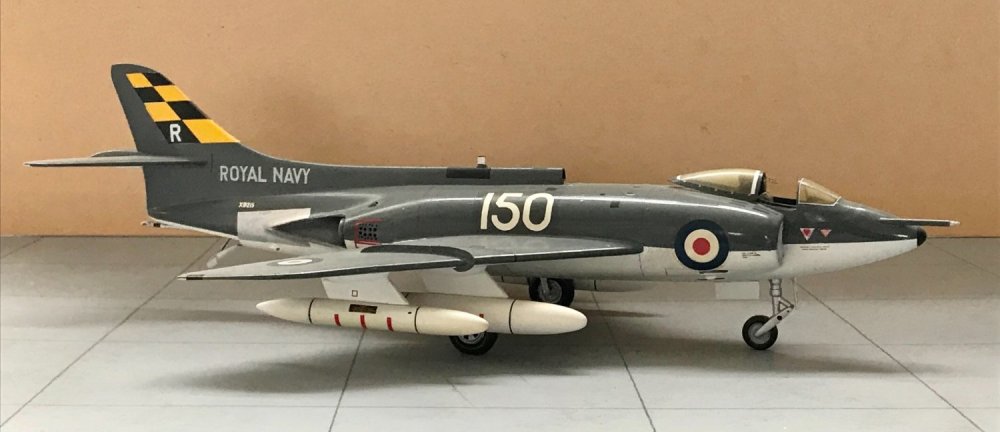

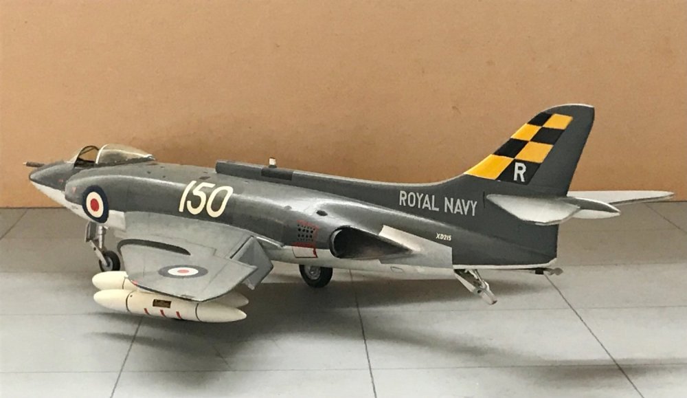

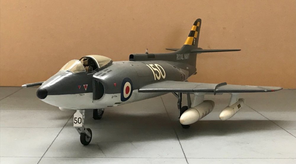

Supermarine Scimitar built from the 1:48 scale Contrail vacform kit.

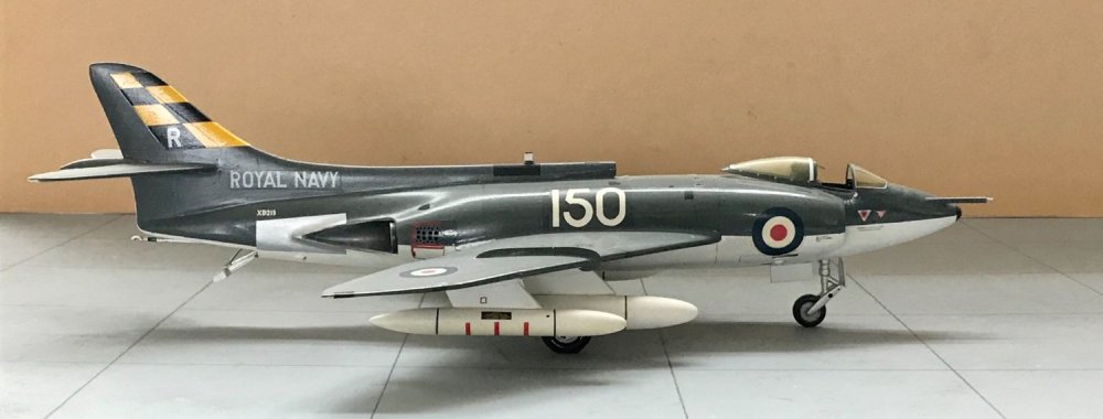

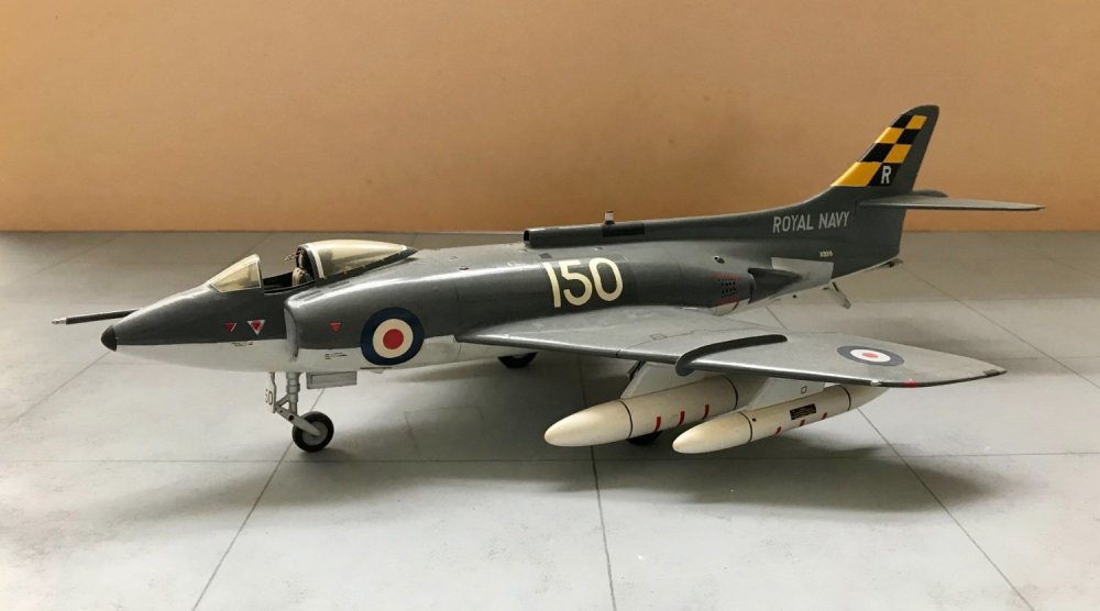

Hawker Seahawk FGA-4 built from the 1:48:scale Falcon vacform kit.

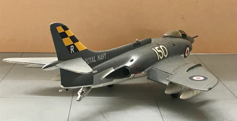

Another vacform kit - a Fairey Gannet AS Mk1 built from the 1:48 scale Dynavector kit with a scratch built wing fold.  In the short time they were in production, Dynavector produced some superb kits.

They did come up with some crazy designs.
You could try taking a picture outside in daylight, it would look more natural, I know it's cold out
there but it would be nice to see the difference.

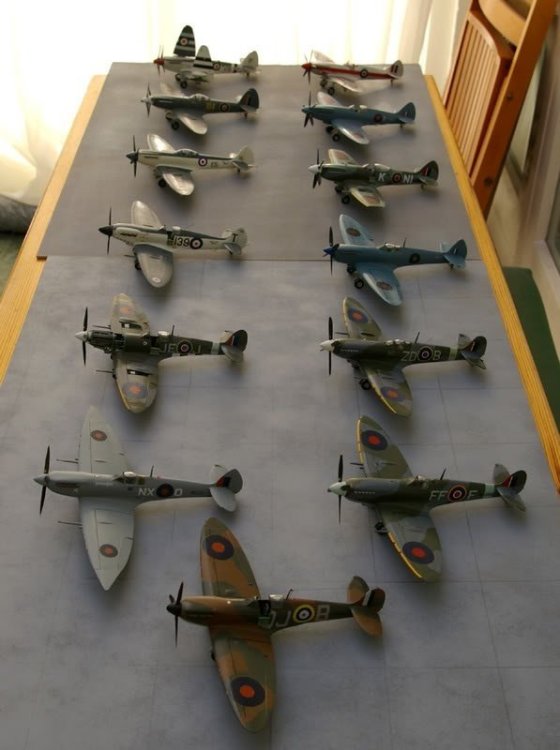

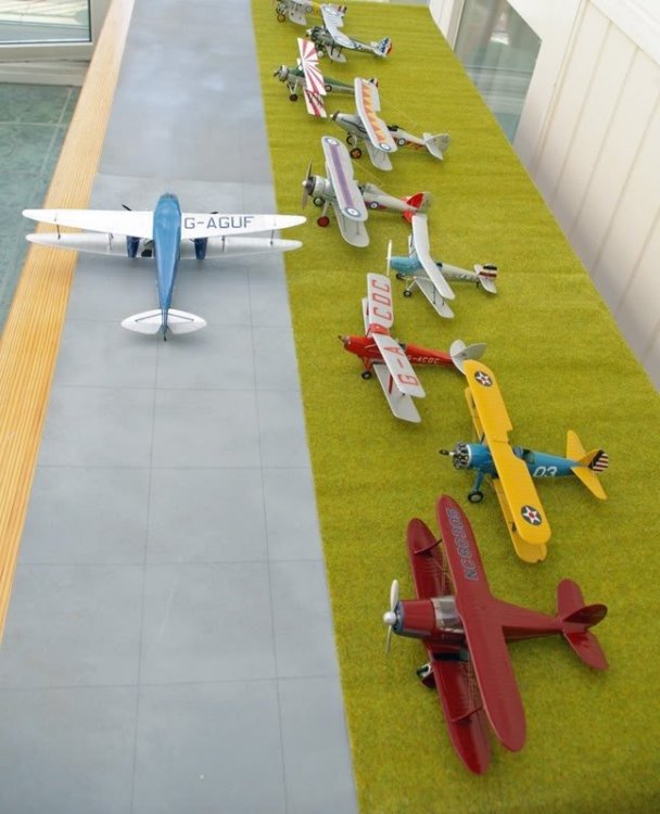

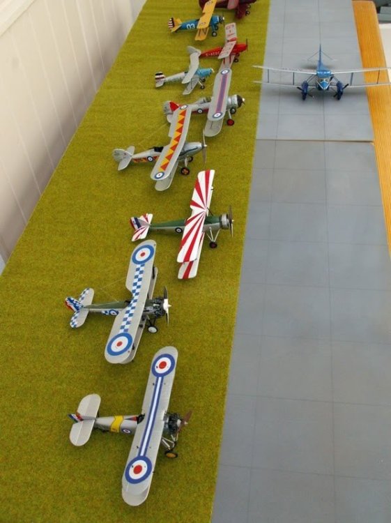

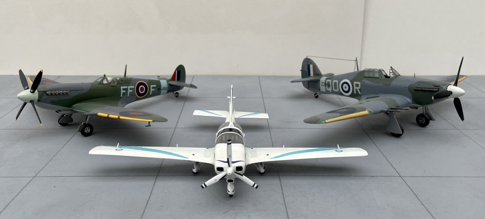

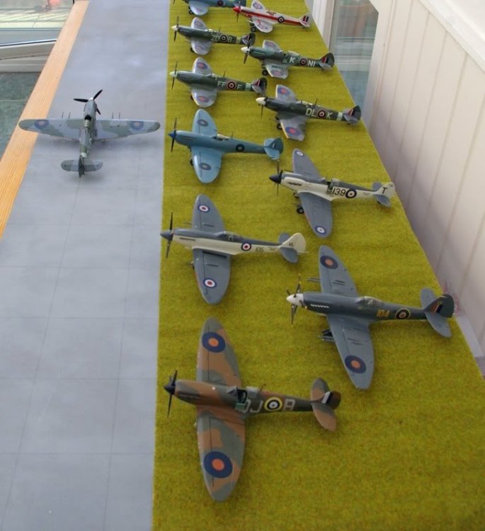

I “repacked” the cabinet in the dining room having had the doors replaced and these were left over - there’s always some bits left over that you can’t get back in…

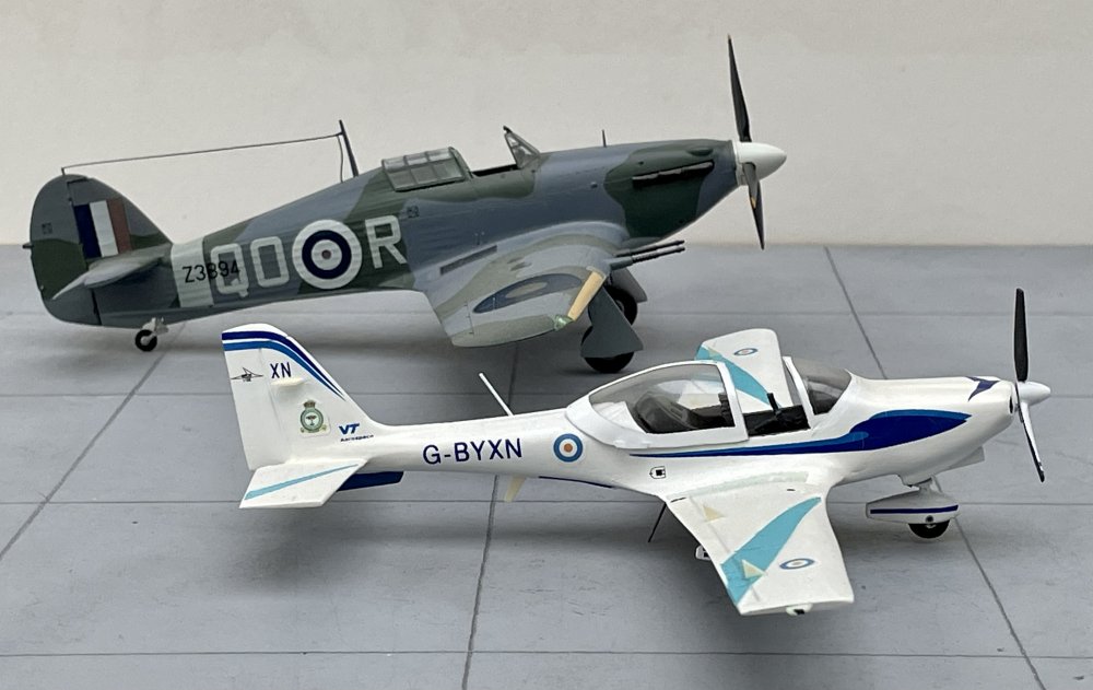

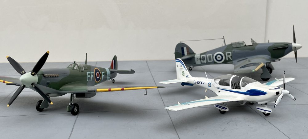

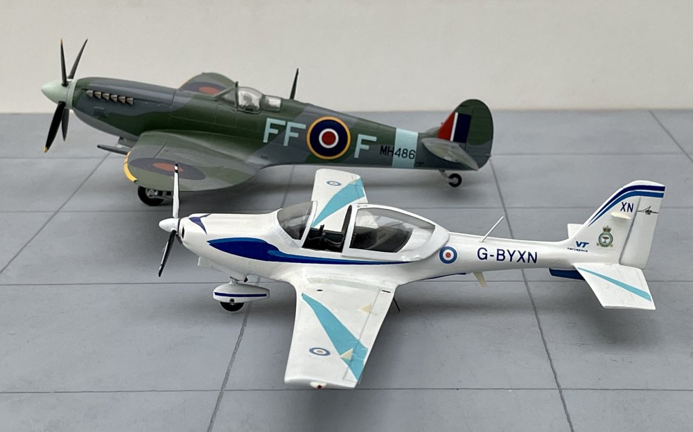

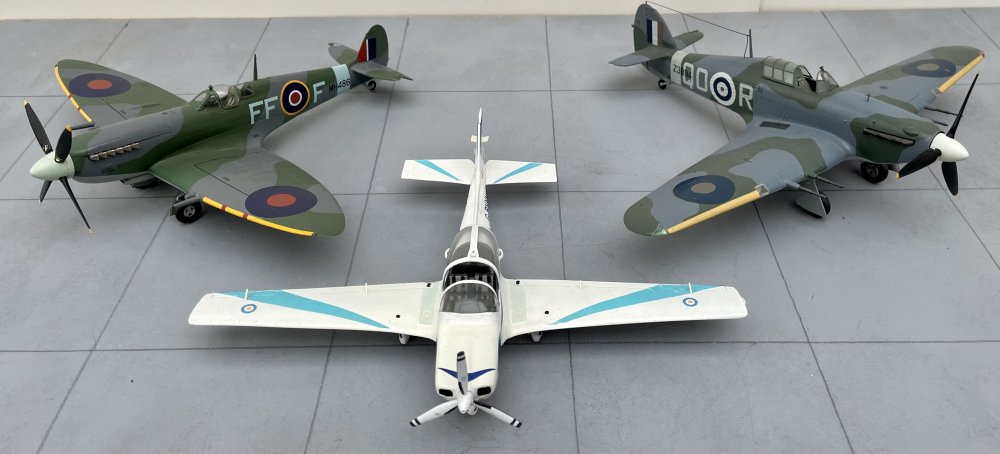

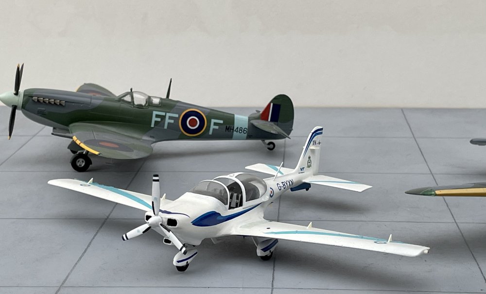

The Grob Tutor is a 1:48 scale resin kit produced some years ago by Heritage Aviation Models.  They still have a website but it looks like it hasn’t been updated in a while…
