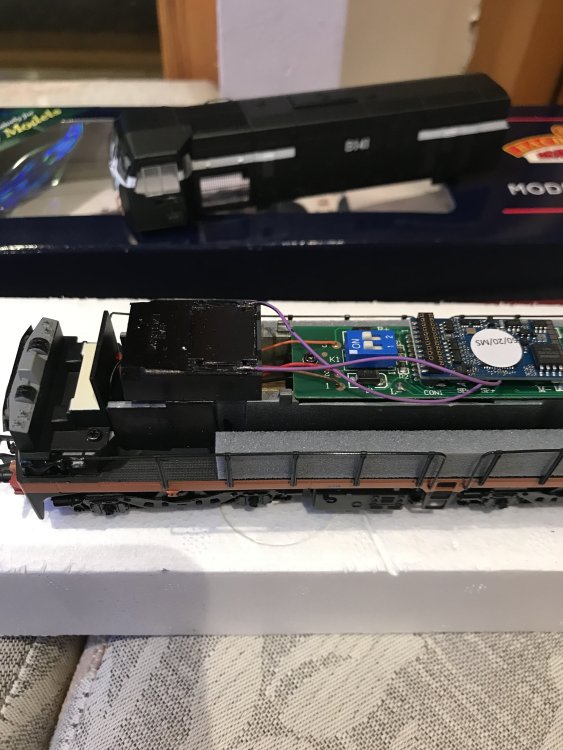

@mmie353 I literally just finished sound testing a load of different speakers on my 141/181s - I get them from Roads and Rails as well. You might find this useful...
1. The playlist of different speakers tested is here and you can judge for yourself (I found a combination of a sugarcube and megabass worked best for bass and higher freq sounds):
2. There's a direct comparison video of double iPhone vs sugarcube & megabass in that playlist as well - second last vid
3. Here's a few pics of how to file off the lugs (4 metal on the chassis, 1 plastic inside the roof of the loco) and fit the speakers (get some black tack from Roads & Rails if you are ordering, it's class):
You can get a set of files from Woodies for a few quid
Make sure and mask up to stop the filed metal falling into the motor
Metal lugs filed off
Cut / file off the plastic lug on the right in this picture
Black tack is very handy for sticking down the speakers - I covered over chassis with black tape as a speaker base - left a gap in the tape for air to circulate around the motor (not sure if needed but was being cautious :) )
4. And the finished result is here :)
Hope that helps your decisions!

Also if you are using a single speaker it’s needs to be a 4 or 8 ohm. If you are using two speakers they need to be 8 ohm. Using double 8 ohm speakers wires in parallel will give an impedance of 4 ohms which the chip can handle. If you use two 4 ohm speakers in parallel you get an impedance of 2 ohms which will let too much current through the chip and blow it!
The speakers on Roads and Rails all display their ohm rating so it’s easy to buy what you need :)
