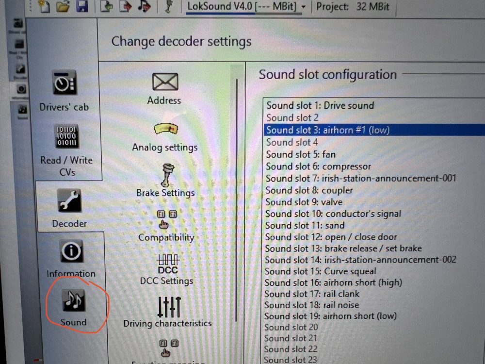

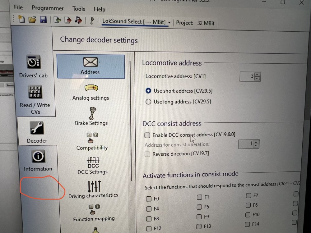

0 MauriceJ Posted October 20, 2022 Author Posted October 20, 2022 Hey guys, I have a lokprogrammer question.. I want to transfer sounds between these 2 files but one of them does not have a “sound” menu. Is there any way around this? Cheers
0 MauriceJ Posted October 20, 2022 Author Posted October 20, 2022 15 minutes ago, MauriceJ said: Hey guys, I have a lokprogrammer question.. I want to transfer sounds between these 2 files but one of them does not have a “sound” menu. Is there any way around this? Cheers Nevermind, just found a HIFI version of that file.
