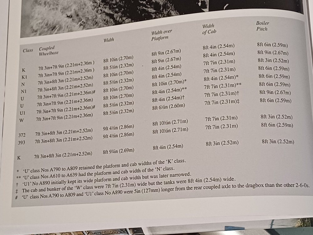

Maitland Posted February 20, 2023 Posted February 20, 2023 Has anyone done a Woolwich conversion to 21mm gauge? I'd be grateful for any hints etc. Peter Swift's book on the SECR Ns says the platforms and buffer beams were widened, but doesn't say by how much, anyone know? Thanks in advance. 1 Quote
2 Galteemore Posted February 20, 2023 Posted February 20, 2023 (edited) The late Tony Miles or one of his crew built one, to be seen at SDMRC, I think. @Horsetanmay know more. Footplate was widened by 6.5” and distance between cylinder centres by similar amount. Edited February 20, 2023 by Galteemore 1 Quote

0 Horsetan Posted February 20, 2023 Posted February 20, 2023 8 hours ago, Galteemore said: The late Tony Miles or one of his crew built one, to be seen at SDMRC, I think. @Horsetanmay know more. Footplate was widened by 6.5” and distance between cylinder centres by similar amount. That's more or less correct. If I recall correctly, the tender footplate was also widened. But note that the cab width stayed exactly the same, as did the tender body. 1 1 Quote

0 Angus Posted May 2, 2023 Posted May 2, 2023 (edited) I'm currently contemplating buying a Farish N Class for conversion to 10.5mm gauge 2mm finescale (coz I've not enough started and half finished projects.....). The 2mm scale association have just released a set of etched valve gear for the conversion and the Farish model utilises bearings which can swapped for a replacements that accepts 2mm finescale stub axles (another association product) to allow drop in re-wheeling. Apart from the book mentioned in Maitland's post above (which I've just bought) does anyone know of a comprehensive list of difference between the English and Irish variants? Some differences can be easily picked out from photos (cut outs on the tender sides, front footsteps, age dependent smokebox doors, wheel diameters dependent upon batch, etc), others such the width are more subtle but can be seen (the widening of the tender frames but the tender tank width staying the same leading to a step between the two). Just being lazy really and looking to avoid work that may already have been done! Edited May 2, 2023 by Angus 1 Quote
0 Horsetan Posted May 2, 2023 Posted May 2, 2023 (edited) 1 hour ago, Angus said: ....Apart from the book mentioned in Maitland's post above (which I've just bought) does anyone know of a comprehensive list of difference between the English and Irish variants?... That book is the only place where you'll see a table of all the differences in measurements, grouped together in an easy-to-read format, and much of that is derived from an earlier work by Peter Rowledge (I think) Edited May 2, 2023 by Horsetan 1 1 Quote
