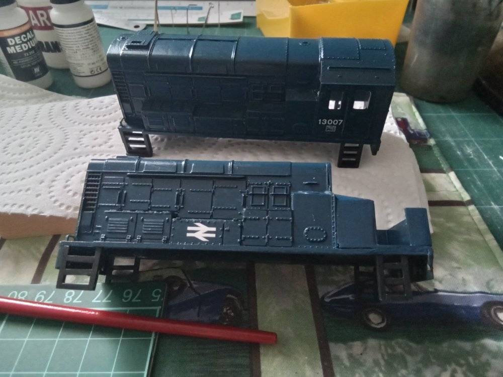

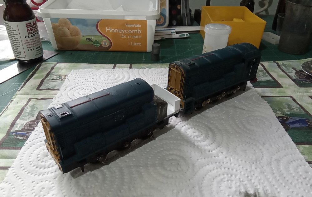

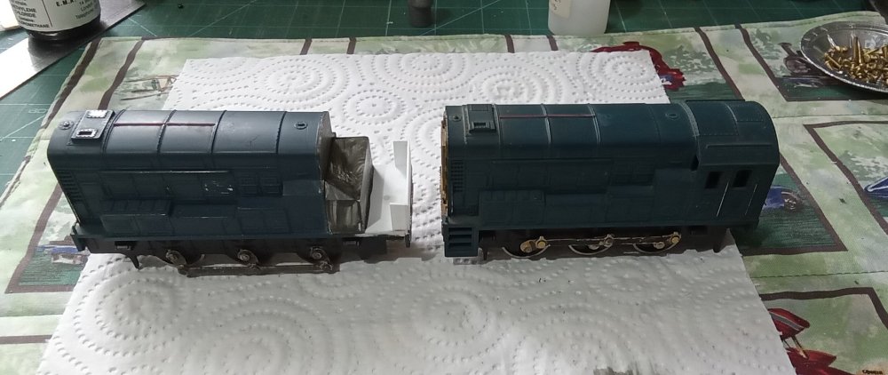

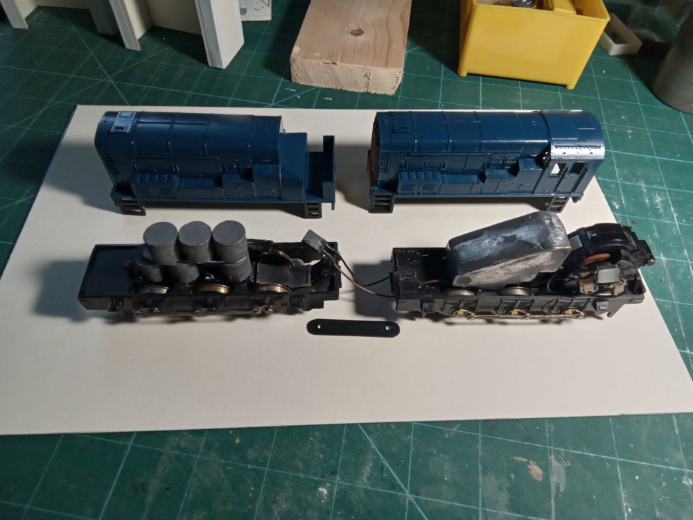

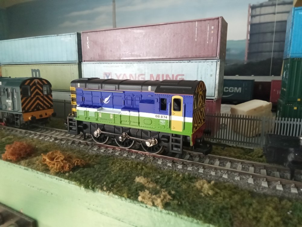

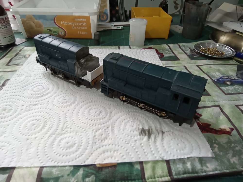

irishmail Posted June 16, 2024 Posted June 16, 2024 (edited) Thought I would show my latest project here. Thanks to @Gabhal Luimnigh, I have two old Lima 08/09 shunters. One working and one non runner. I have always been interested in making one of the class 13 Tinsley hump shunters and this provided me with the opportunity for this project. There are a few detail errors with the Lima model, but I did not want to start cuting up a Bachmann or Hornby version. I also have a Lima 08 in Silverlink livery which got from Hatton's last year as a non runner, (motor mounting bracket was broken), so I took the bracket from the blue 09 non runner and 08874 was back in working order. Next it was a case of carefully cuting the cab off one of the donor bodies, then using bits of plasticard trying to replicate the 'calf' unit. Extra pick ups have been added and both main unit and calf are connected electrially. Additional weight has been added. Its still a work in progress at this stage, needing numbers and buffers. Edited June 16, 2024 by irishmail 9 1

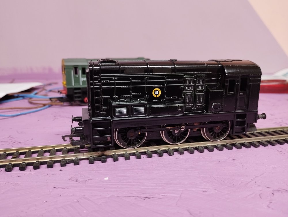

Gabhal Luimnigh Posted June 16, 2024 Posted June 16, 2024 18 minutes ago, jhb171achill said: Wow - 179 still in actual railway service? Or including industrials and preservation? On another front, with a generous 2ft rule, a coat of green or black paint and CIE logos will make a half-acceptable "D" class shunter out of one of those..... Like this? 4
jhb171achill Posted June 16, 2024 Posted June 16, 2024 17 minutes ago, Gabhal Luimnigh said: Like this? Good to see that close up, as I was thinking of doing that myself! Just wondering where the right style of numbers (e.g. D302) might be obtained from - larger for the sides and cab end, and smaller for the front end....? 1
Gabhal Luimnigh Posted June 16, 2024 Posted June 16, 2024 1 hour ago, jhb171achill said: Good to see that close up, as I was thinking of doing that myself! Just wondering where the right style of numbers (e.g. D302) might be obtained from - larger for the sides and cab end, and smaller for the front end....? No idea Jonathan but I'm sure they can be obtained.

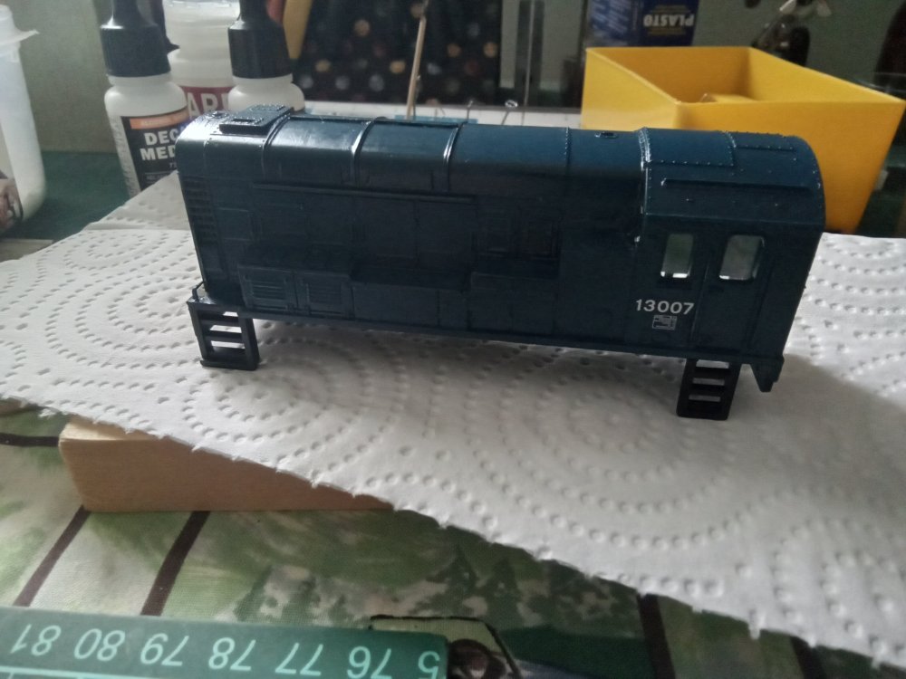

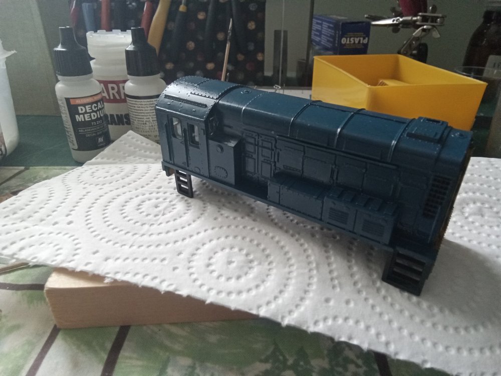

irishmail Posted June 18, 2024 Author Posted June 18, 2024 Bit more progress on the class 13 project. Glazing fitted on cab windows, (absent on the Lima models), and now applying transfers. I am using modellers licence/ rule 1 for the numbering as the Lima donors would not be an exact match for the origional 13001 -13003. So a bit of fictional back story. After the sucess of the three class 13's at Tinsley, BR wanted another 7 to make 10 units in total. As the yards they were destined for were not as steeply graded as Tinsley, some of the origional modifications carried out on the Tinsley three were not required such as the modified buffer beams. I have gone for 13007. 4
