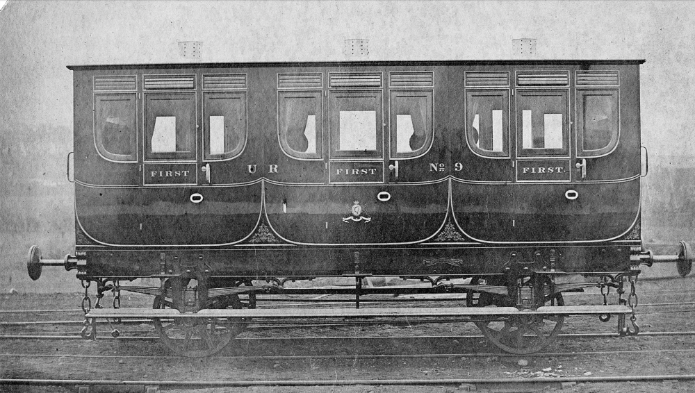

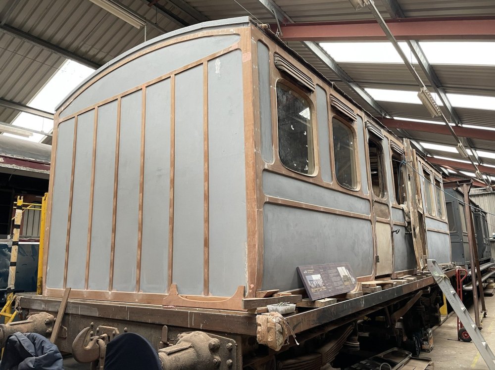

GSWR 90 Posted August 16, 2024 Author Posted August 16, 2024 (edited) 4 hours ago, Northroader said: Just looking at the drawing of the coach (which is very helpful to a modeller) it strikes me that there’s a central toilet/s fitted with a roof tank above. This must be very early on in the development of this facility, or was it a later addition? Got an end elevation? The photo shewing it lifted on slings looks like the end panel mouldings are missing. oh, and thanks for giving a van drawing, that’s magic. Yes, it had two toilets in the middle separated by a diagonal partition. Not sure about the history of railway bathrooms but I think 33 had them from new. The first modern toilets appeared at the end of the 18th century, e.g. Bramah and Cummings toilets, so I suppose that makes sense. The toilet in 33 would have been Jennings 'thunderbox' style, we have the top part of the wooden 'box' but we're looking for Jennings-style a bowl and handle, as well as a folding sink. Unfortunately there isn't an end drawing, the drawing of 33 was made by the same volunteer who is designing the underframe. There are a few things that might be different between that drawing and the real thing, which will make it look more like the UR coach in this photo, e.g. the coat of arms will probably be a maiden harp with wolves as supporters instead of a normal harp with unicorns we're hoping to have the toilet windows frosted with the UR coat of arms I think it might have had very small metal steps below the doors as per the photo instead of a larger upper wooden one I think there was also a bit of debate about steps on the end of the coach We'll try to get the font of the numbers, letters etc as close as possible to that in the photo The photo of it being lifted was taken in 2013 before restoration started, I assume the ends were removed and replaced with something cheap in the 1980s since they were rotten. Here's a more recent picture of it with end moulding. I will see if I can upload some other original UR drawings at some point. Edited August 16, 2024 by GSWR 90 6 Quote
