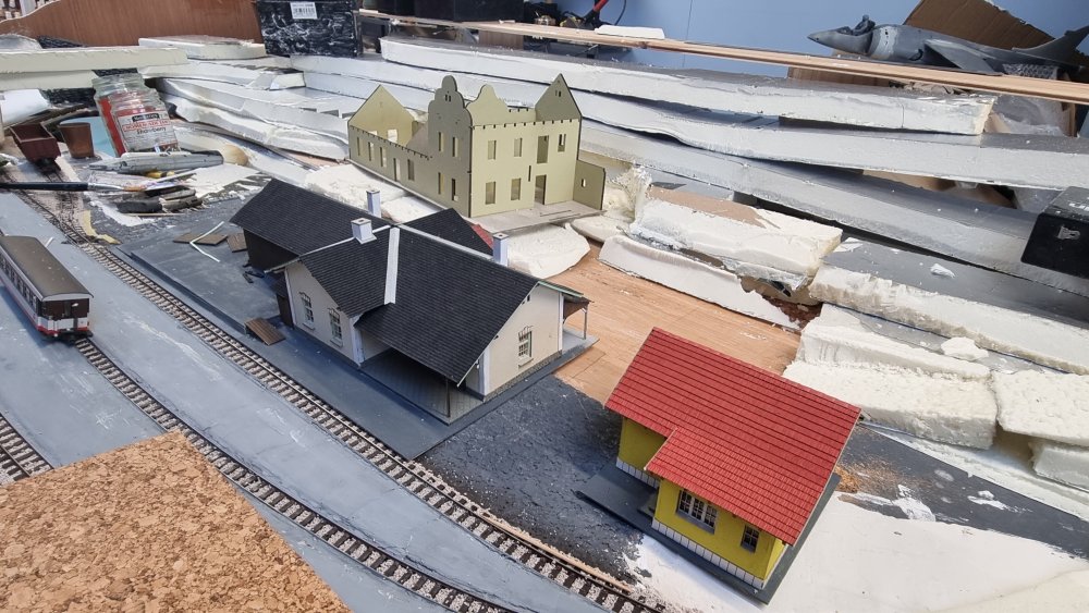

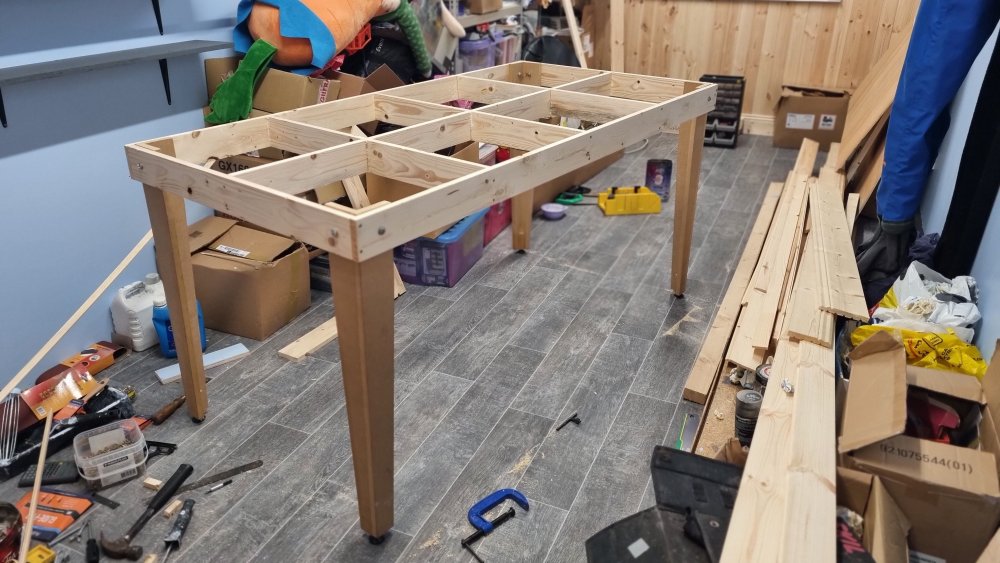

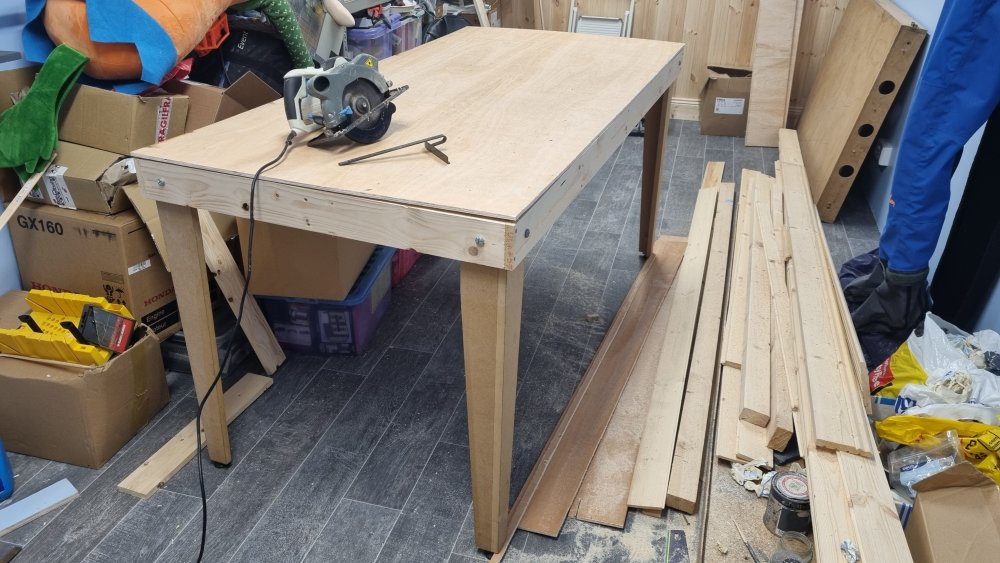

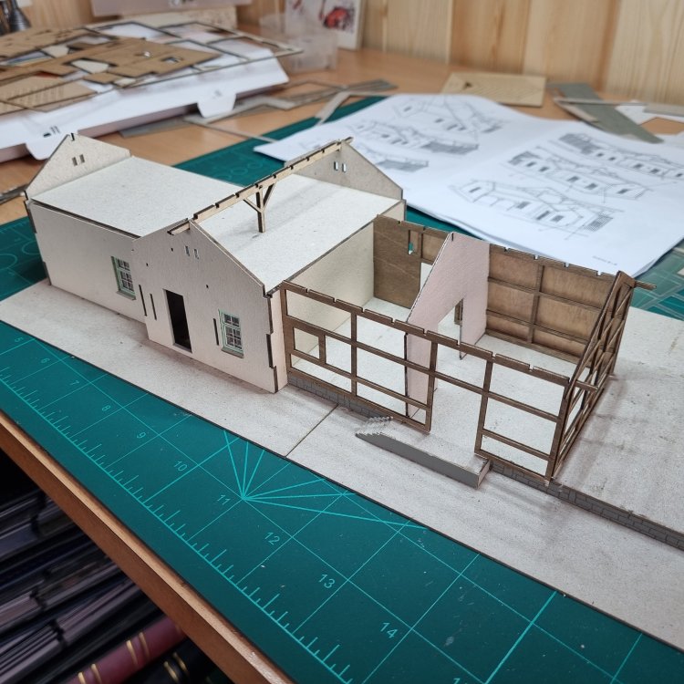

Georgeconna Posted September 15 Posted September 15 (edited) Hi folks Started a HOe Layout, freelance with actual Austrian buildings. Will be a bit of the Mariazellerbahm and Ybbstahlbahn. I know next to nothing about these railways so doing wee bit of research. At the moment gathering stock (ain't ceap) and I have the track plan more or less sorted. Dims are 5x4ft but could do with a few extra inches... Waiting for a few more points and some 6mm ply as the track will be raised up and not flat earth syndrome. The Station building I am working on is from Igra Models and is of the now closed Ybbsitz Railway Station, A laser cut kit. Lots of good vids on you tube: Edited October 28 by Georgeconna 5 2 Quote

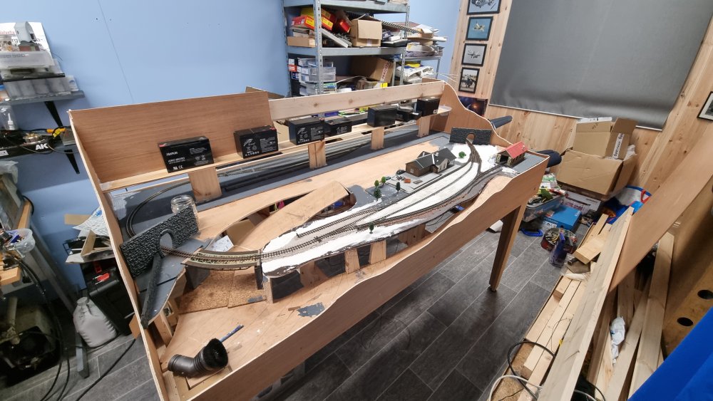

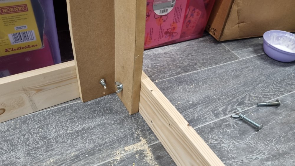

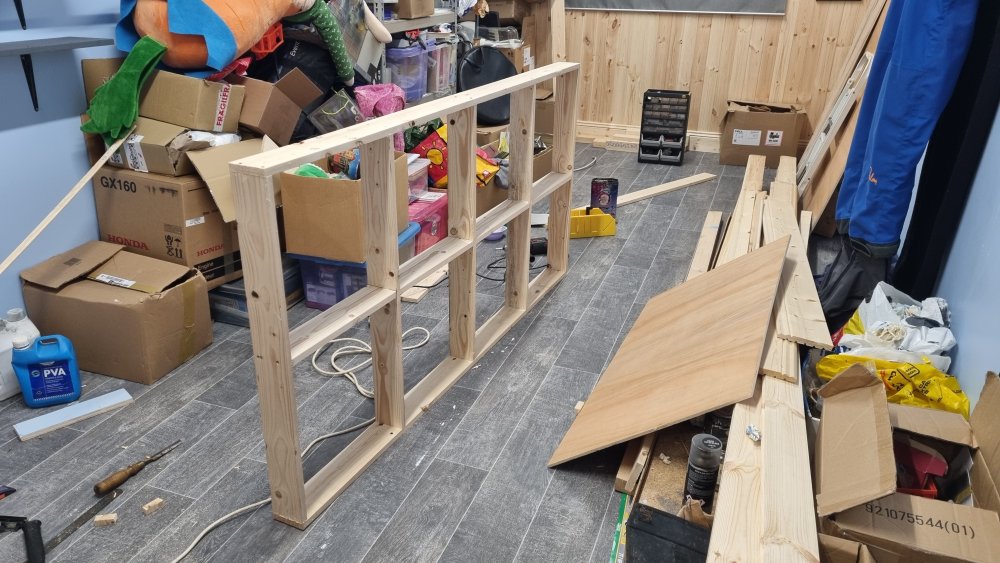

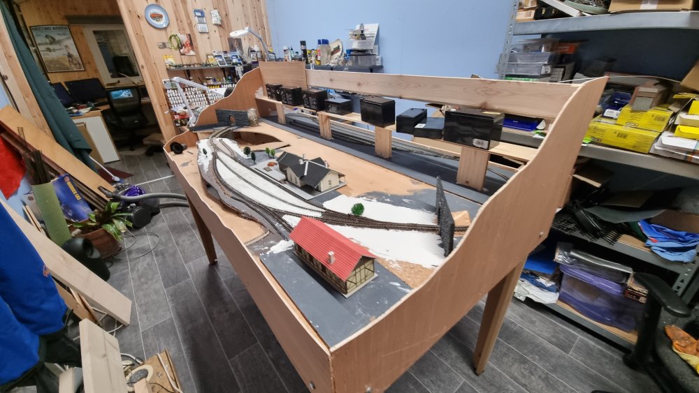

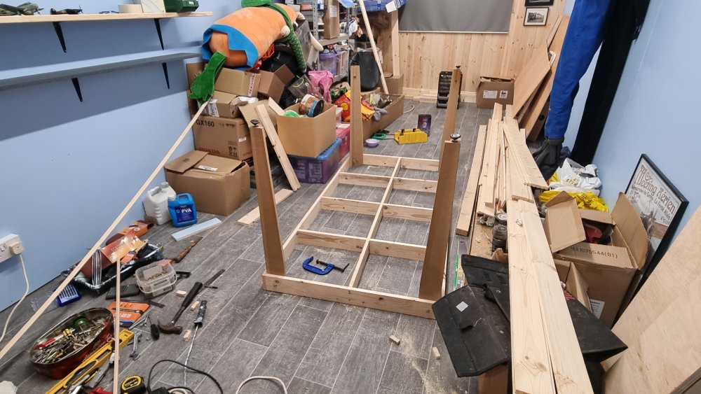

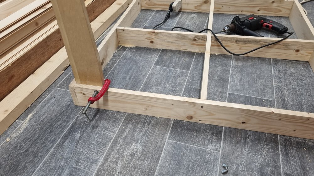

Georgeconna Posted October 4 Author Posted October 4 (edited) I decided not to use the MDF baseboard as it was not long enough and it would be difficult installing point motors under neath so went open plan and the track bed will be raised about 3 inches off the top of the base board frame. I used the legs from the MDF board. Edited October 4 by Georgeconna 5 Quote

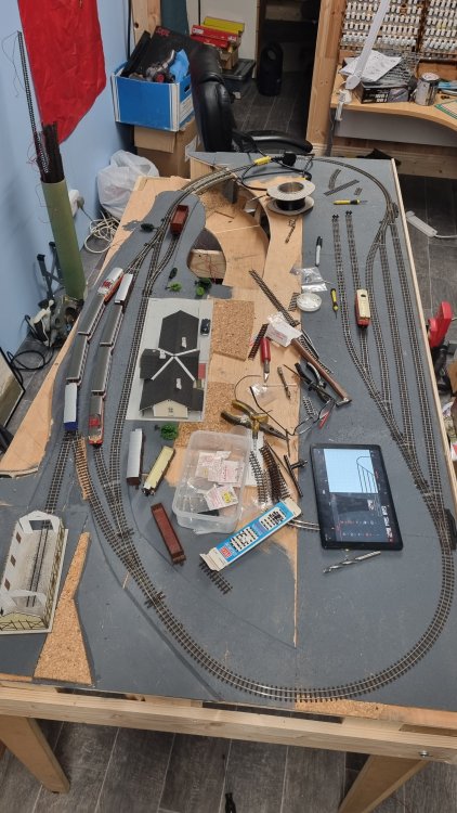

Georgeconna Posted October 4 Author Posted October 4 (edited) Quick cobble of the proposed track plan. These stations tended to have loops rather than sidings. The main line being the middle track and people had to cross the track nearest the station to get on the train! The layout is 6x3ft so the extra foot gives the scene a little bit more breathing space and less clustered. 8 48 minutes ago, jhb171achill said: I'm following this with very great interest. Until Murphy released the 141s, and SSM did an 800 class kit, I had spent twenty years collecting 009 OBB stuff with the intention of having a quite ambitious Austrian narrow gauge layout. The entire collection was sold some years ago now, in order to switch completely to what is now Dugort Harbour, a 1955-70 rural west Kerry layout. I travelled extensively on the OBB narrow gauge line sin the 1970s an early 80s, and they were truly fascinating. Sadly, they've gone to rack and ruin now in many cases; otherwise closed, devoid of steam, or with gold coloured Luas-like things on them instead of "proper train". Had a number of cab runs in those 2095s as well as steam on the Waldviertalbahn - great locos, Only been to Austria once and thT was to see jets. They had some lovely lines for sure some survived until recent times before lifted. The OBB stuff is full of character! Feel free to chip in with ant observations please JHB. Just going off of books and YouTube. Edited October 4 by Georgeconna 2 Quote

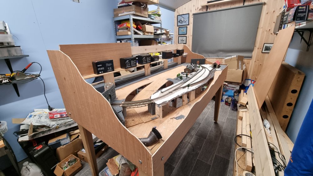

Georgeconna Posted October 14 Author Posted October 14 Been tipping away over the last few days as minding me Dad for the week which gave me a bit of time to think about the layout. The base board was raised 3 inches to enable a bridge to be included and I treated myself to a Blank N Decker battery Jigsaw. 90 quid so not too cheap ir dear and works very well too. 4 Quote

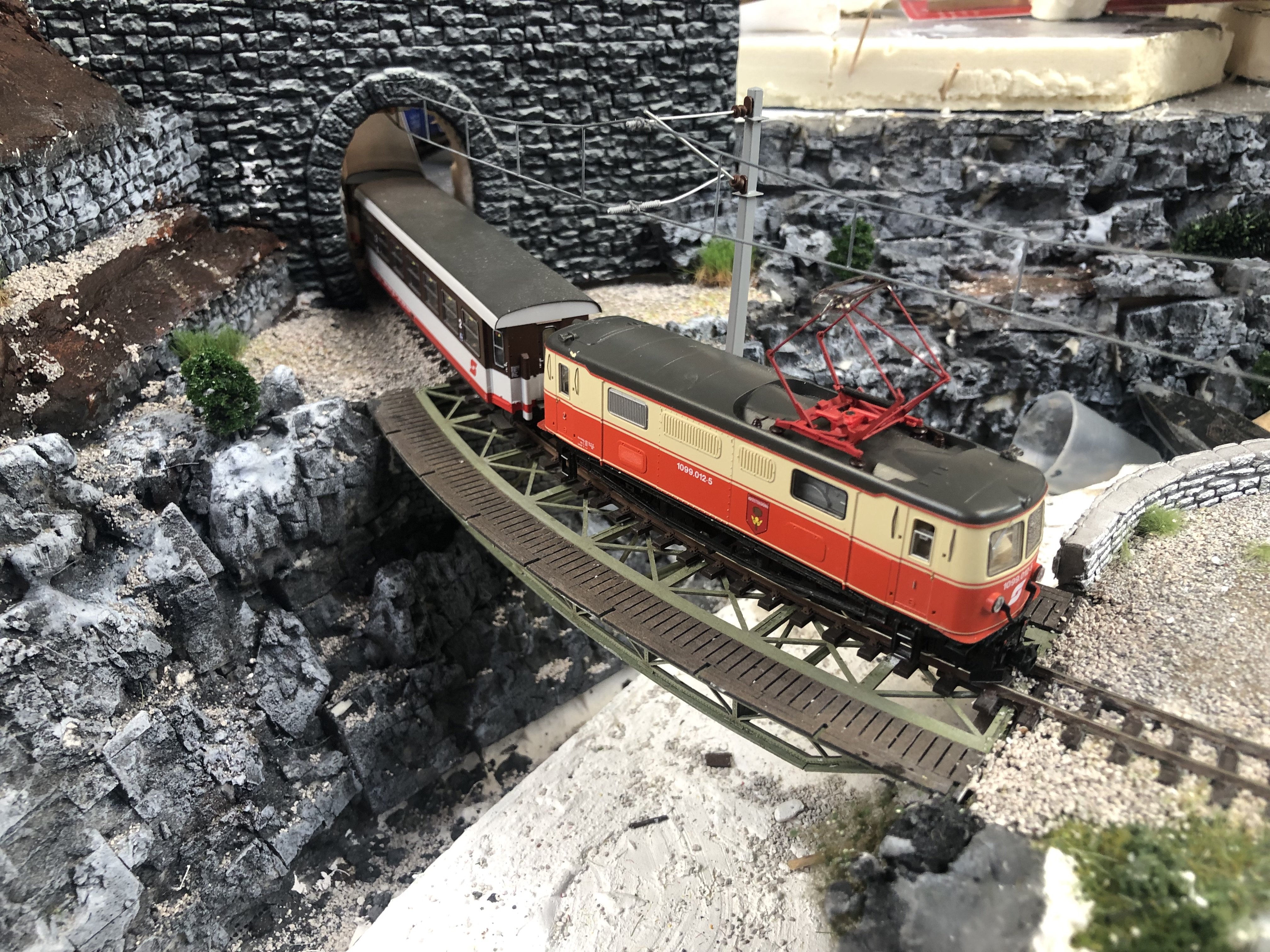

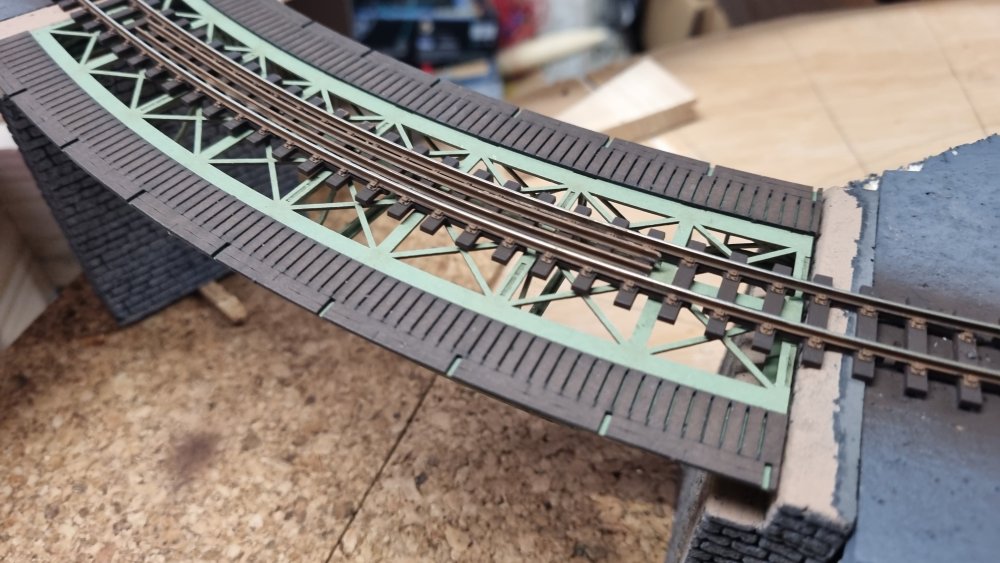

Georgeconna Posted October 15 Author Posted October 15 (edited) Built the bridge kit this evening. Noch job. Laser cut. Joy to make. Just hand rails to do. Edited October 15 by Georgeconna 3 Quote

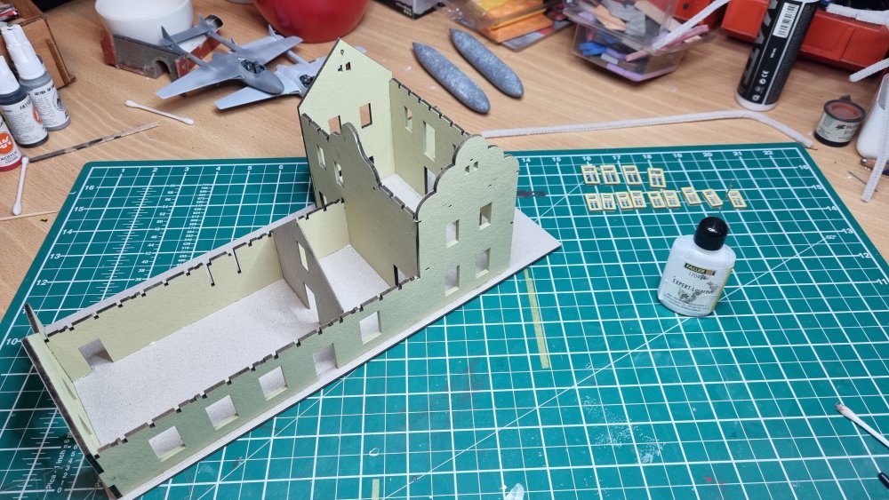

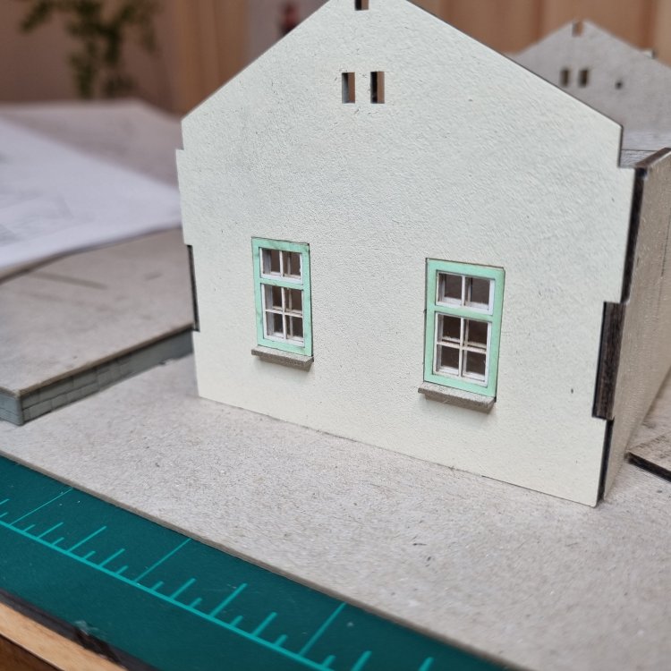

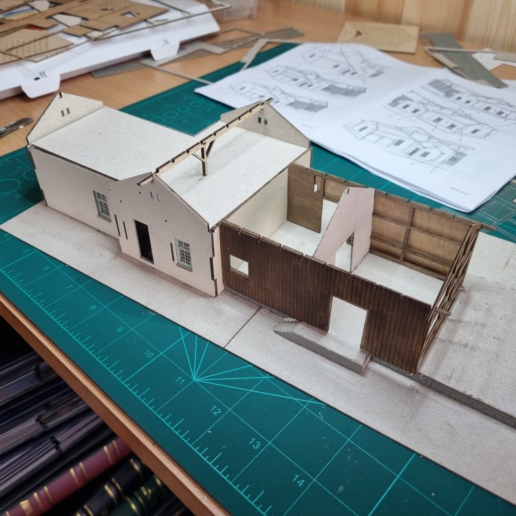

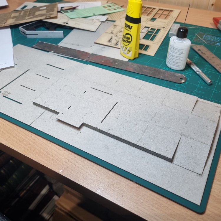

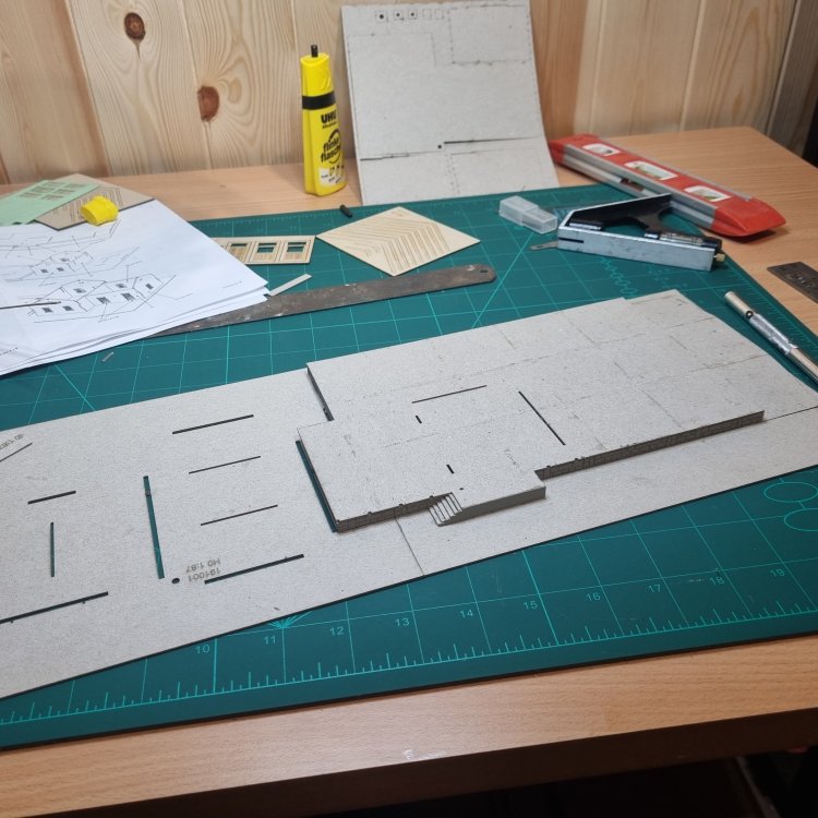

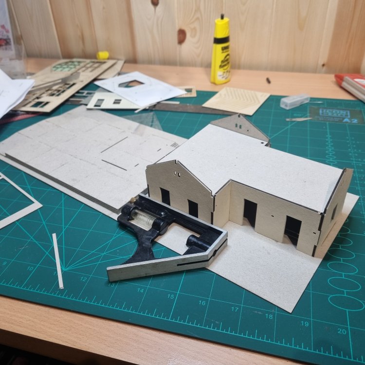

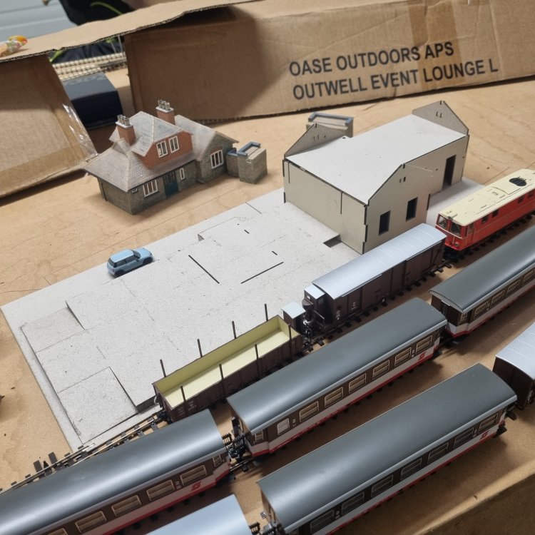

Georgeconna Posted October 15 Author Posted October 15 Cork base down today a day loads of weights on it. Also made a start on the engine shed. Another lovely kit. 4 Quote

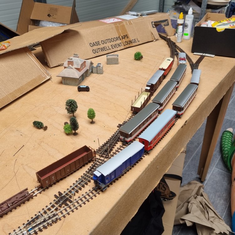

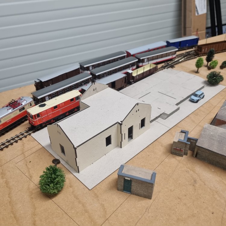

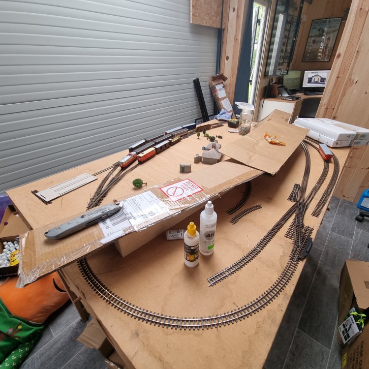

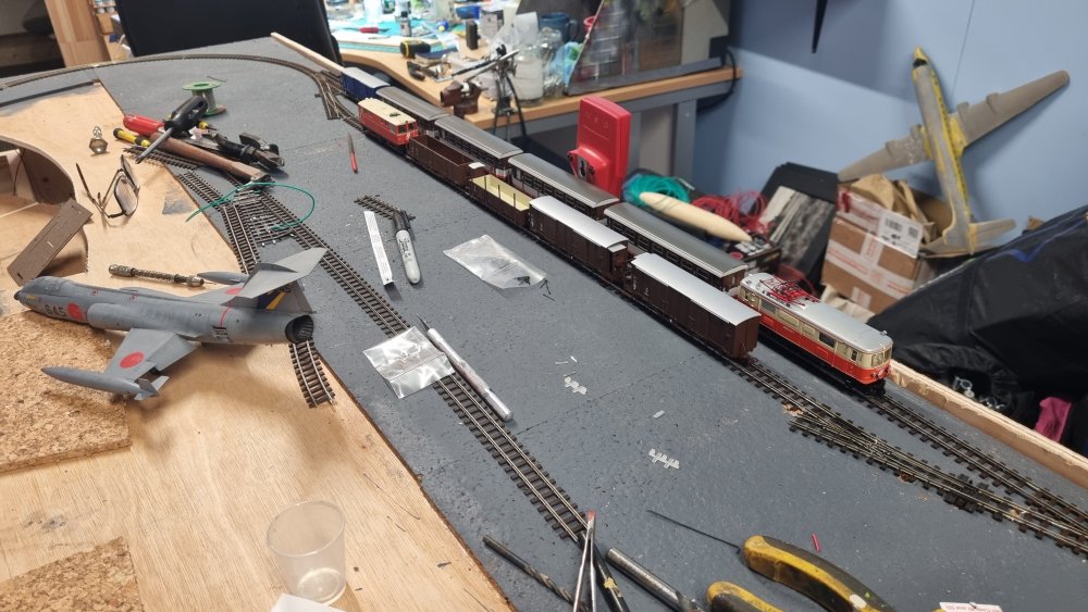

Georgeconna Posted October 16 Author Posted October 16 (edited) A pleasurable few hours in self imposed solitary confinement in the shed, one visit from the missus with a teapot and cup!!. The station track was determined and track cut to suit. Its typical of an Austrian NG Station from what I have seen. It is Pinned I to place at the moment. Fiddle yard to do tomorrow then holes for the point motors and soldering! Just need my modelling desk delivered!!!. Engine shed build continues.. Hope it catches the flavour of these lines.JHB will tell of off otherwise!! One thing hard to find any shots of signals and the OHLE will be a new challenge. Researching that now. Viessmann do OBB Type single arm posts but the 3 lines will mean scratch building the gantrys and by god the network of wires looks difficult. Engine shed is where the Diesel is. Enough loop Space for a 4 coach consist in the middle and outer lanes. Edited October 16 by Georgeconna 4 Quote

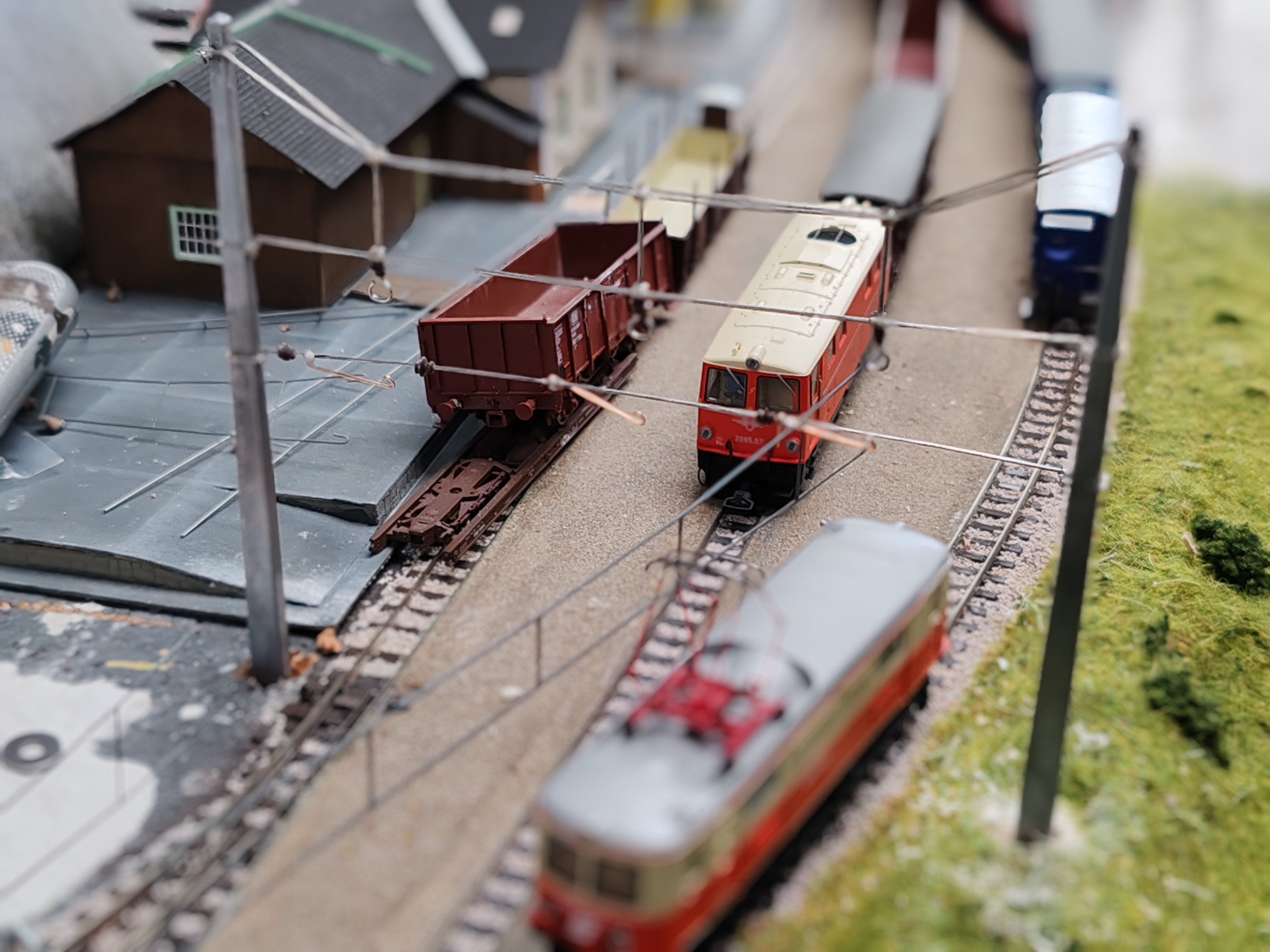

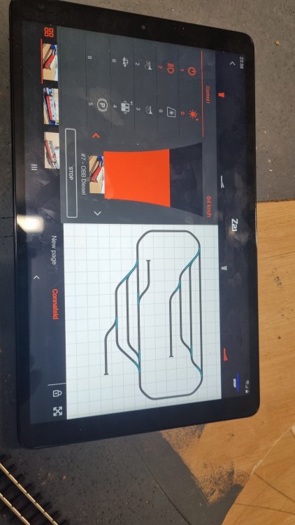

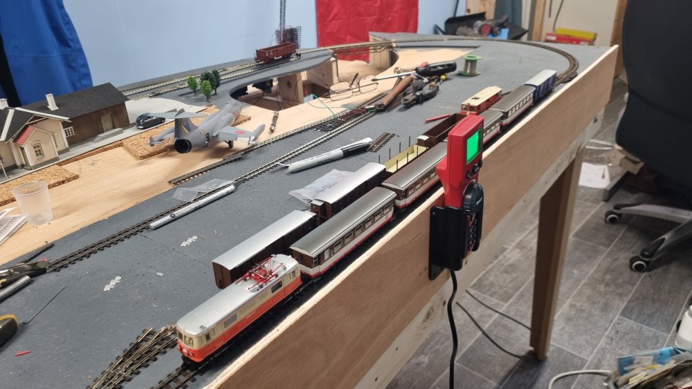

Georgeconna Posted October 28 Author Posted October 28 Spotted JHB Saturday AM for a fleeting minute then you were not seen again!! West side of the Station area is completed. Cobalt Digital running the ops and switching. Using Z21 for DCC control. Ran a test train and the a sample of what hopefully will be running once the layout is done. 20241028_142804.mp4 20241028_141112.mp4 1 Quote

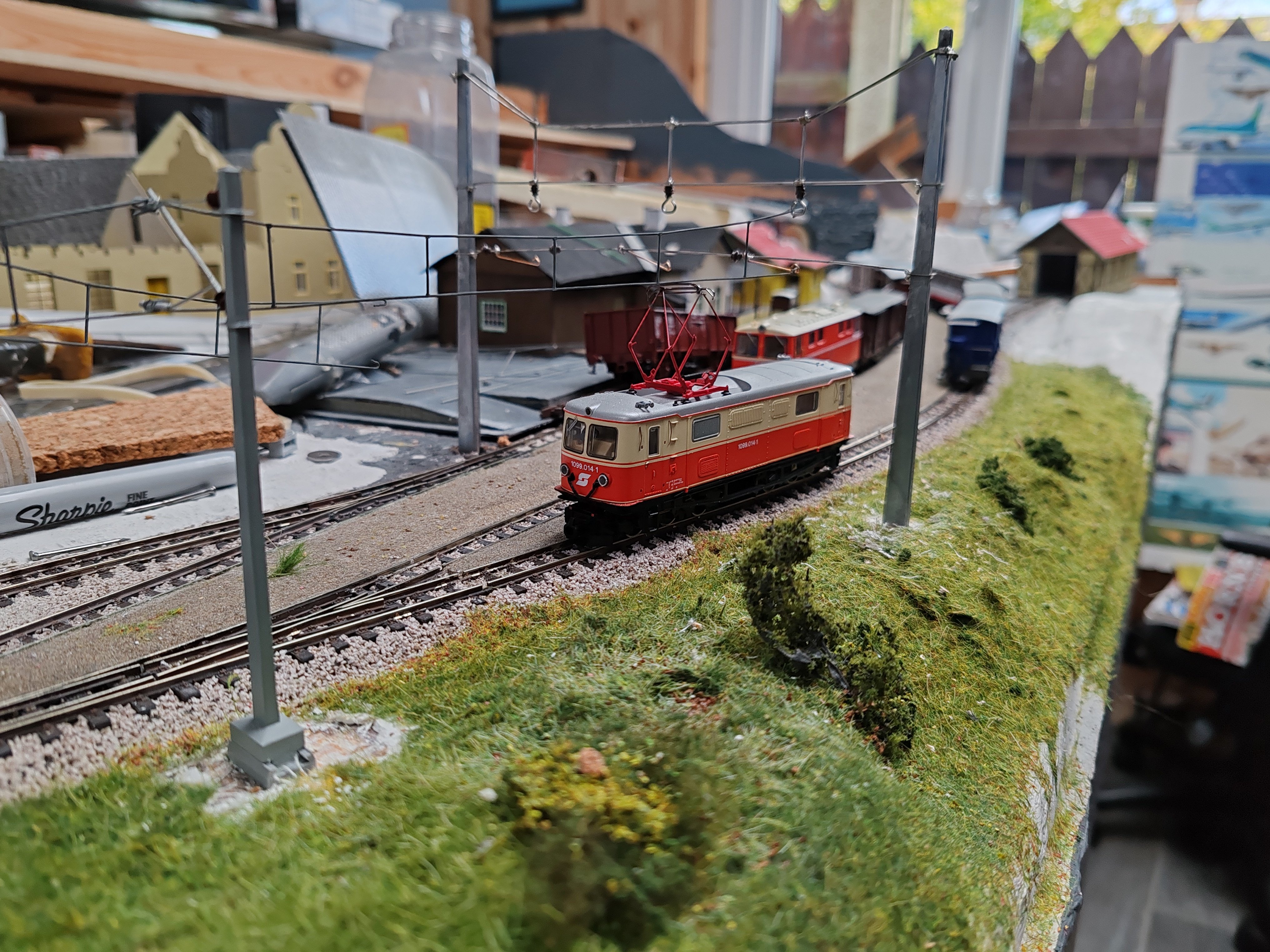

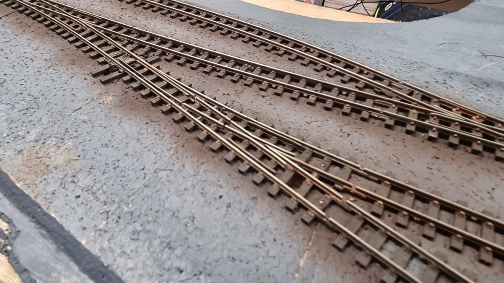

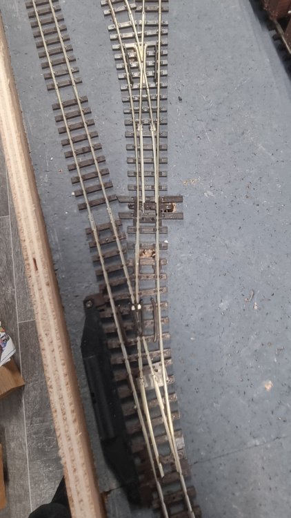

Georgeconna Posted October 29 Author Posted October 29 Cleaned off the board. Need to replace the Y point to the Engine shed site as it is giving jip. The scenic part is almost done. Spray the track next. I ordered an OBB Ohle Mast but me thinks it's more suited to the Ho locos rather than the smaller NG stuff. 20241029_000709.mp4 20241029_000630.mp4 20241029_000553.mp4 20241029_000013.mp4 20241028_235927.mp4 2 Quote

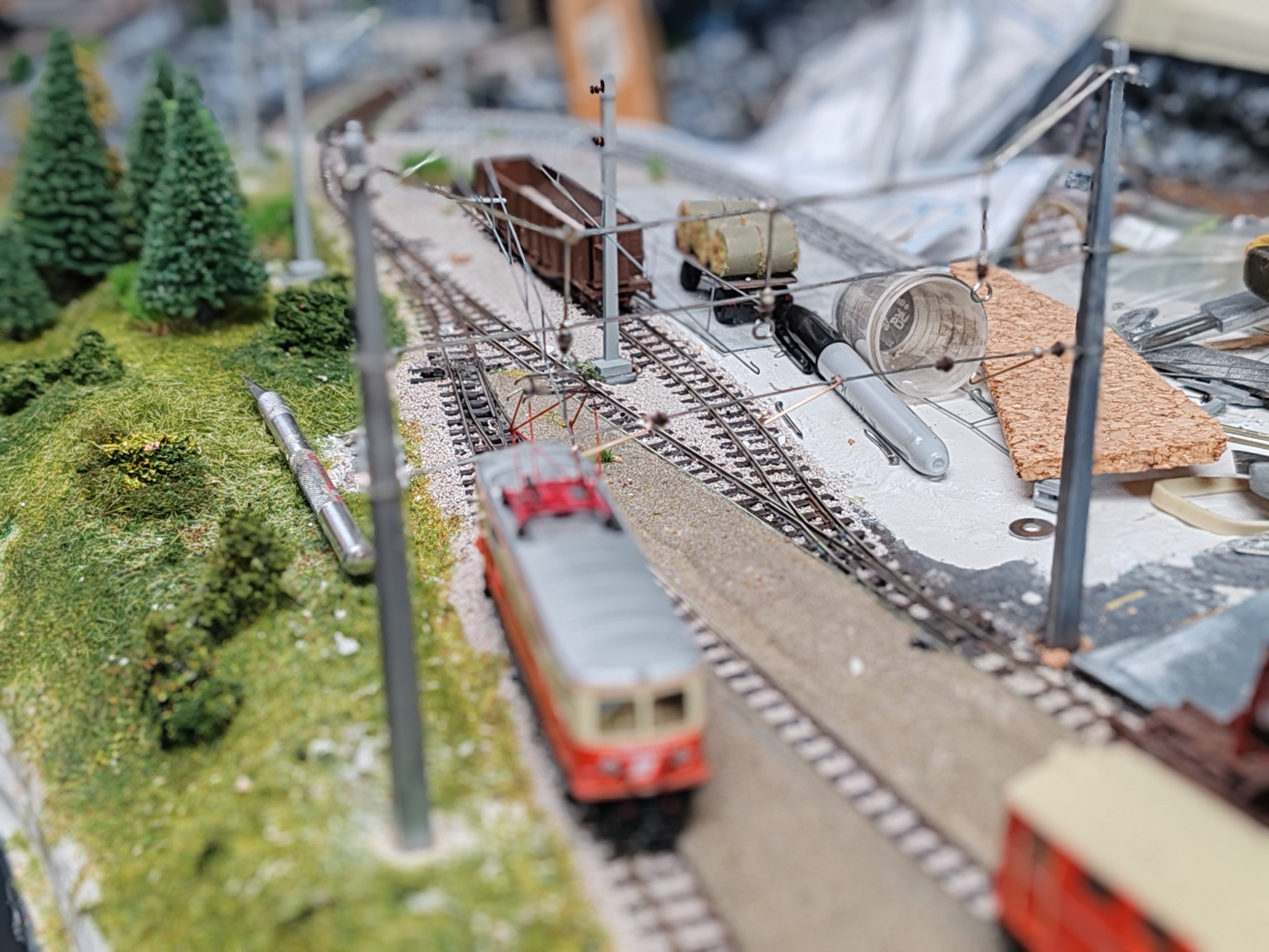

Georgeconna Posted October 30 Author Posted October 30 1st fiddle yard loop done. Entrance points are Roco ones and are lightly sprung and a train can easily push the blades when ran against them so no need for point motors there. Wasted a bit of time when I put the power wires into the wrong holes in the cobalt. Trying to diagnose the issue was puzzling for a while. Dann eyesight! Little vid of double departure. 20241030_001943.mp4 Quote
Georgeconna Posted October 31 Author Posted October 31 Completed the track now snd all point motored up. Next is track weathering. 20241030_201356.mp4 2 Quote

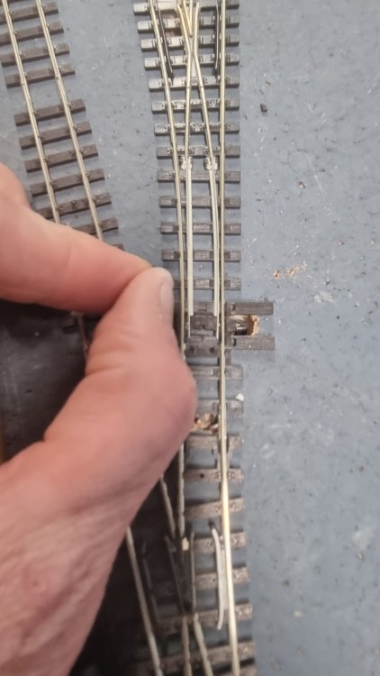

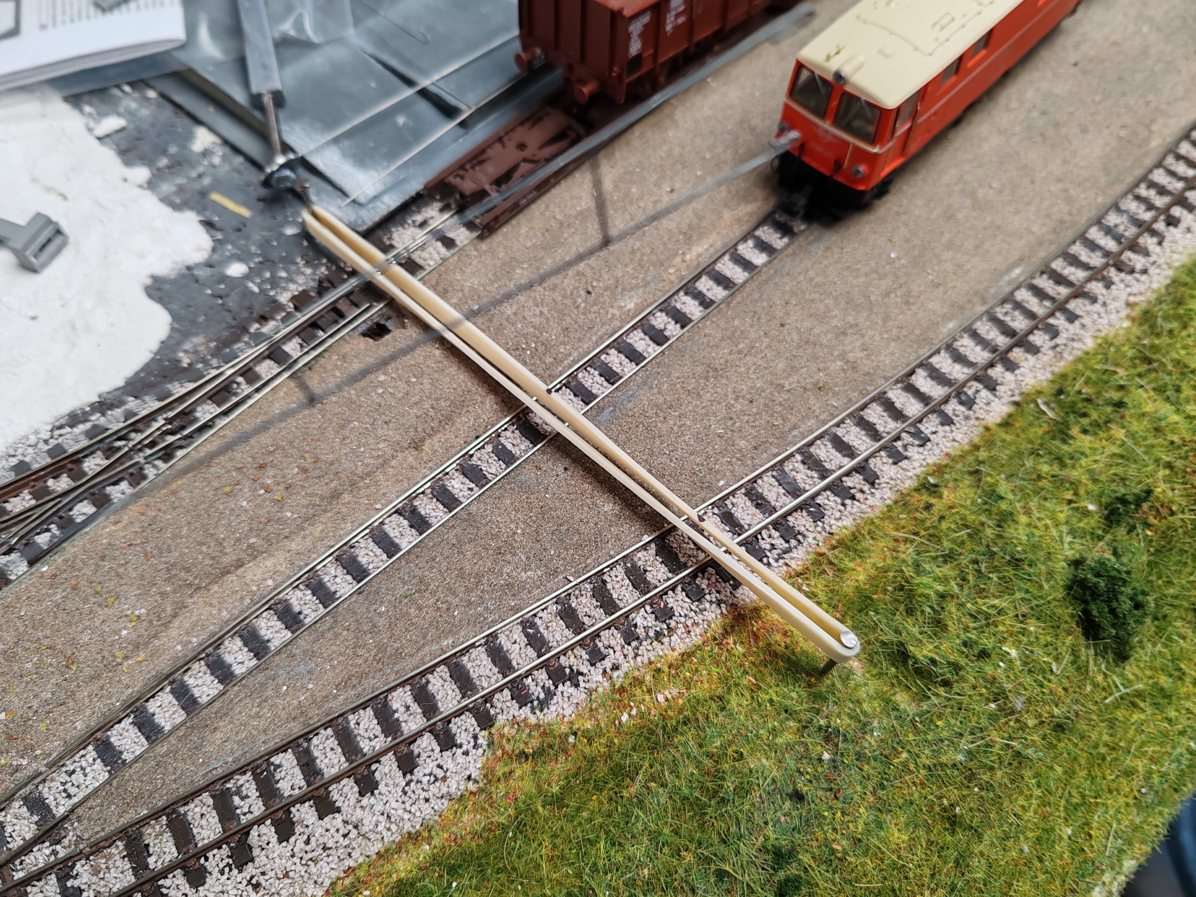

Georgeconna Posted November 1 Author Posted November 1 (edited) Interesting thing came up last night. Bro in law came in a snipped off a bit of the throw arm as it was catching the bogies. Afterwards when I switched the point it shorted. Strange as it was running fine previously. Turned out the point motor was not really set right and the blades were not in the middle of the point when installed. As a result it did not have time to clear the stock rail before the polarity changed causing a short. Certainly a head scratching moment Anyhow re aligned the motor and it now works fine. OO gauge is a lot more forgiving as more space to play with! Just for anyone that might come across the same problem. Edited November 1 by Georgeconna 2 Quote

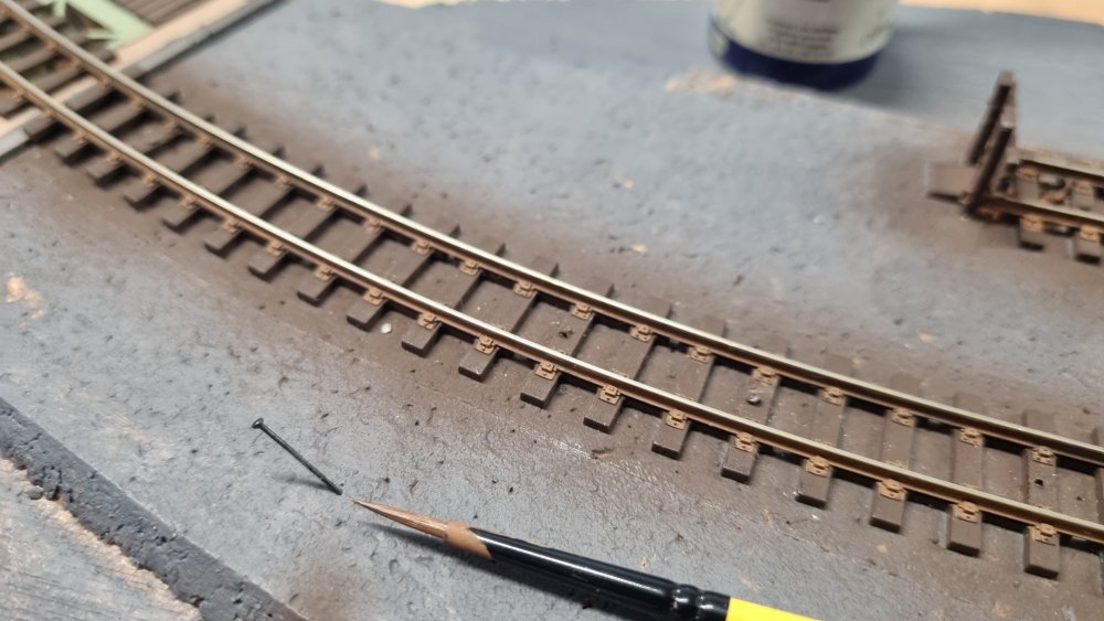

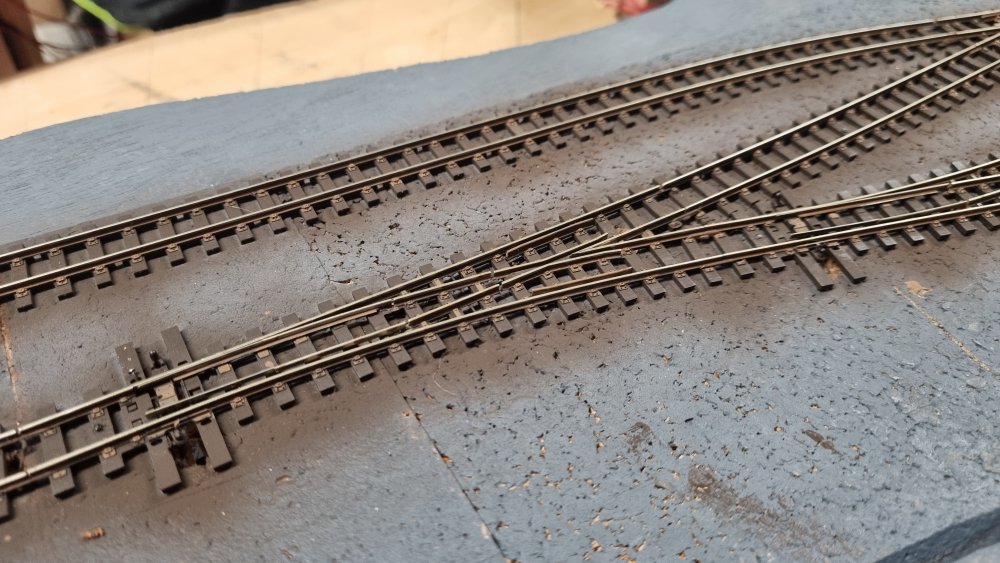

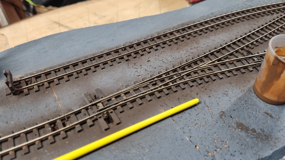

Georgeconna Posted November 4 Author Posted November 4 Bit or track weathering over the weekend.. 5 Quote

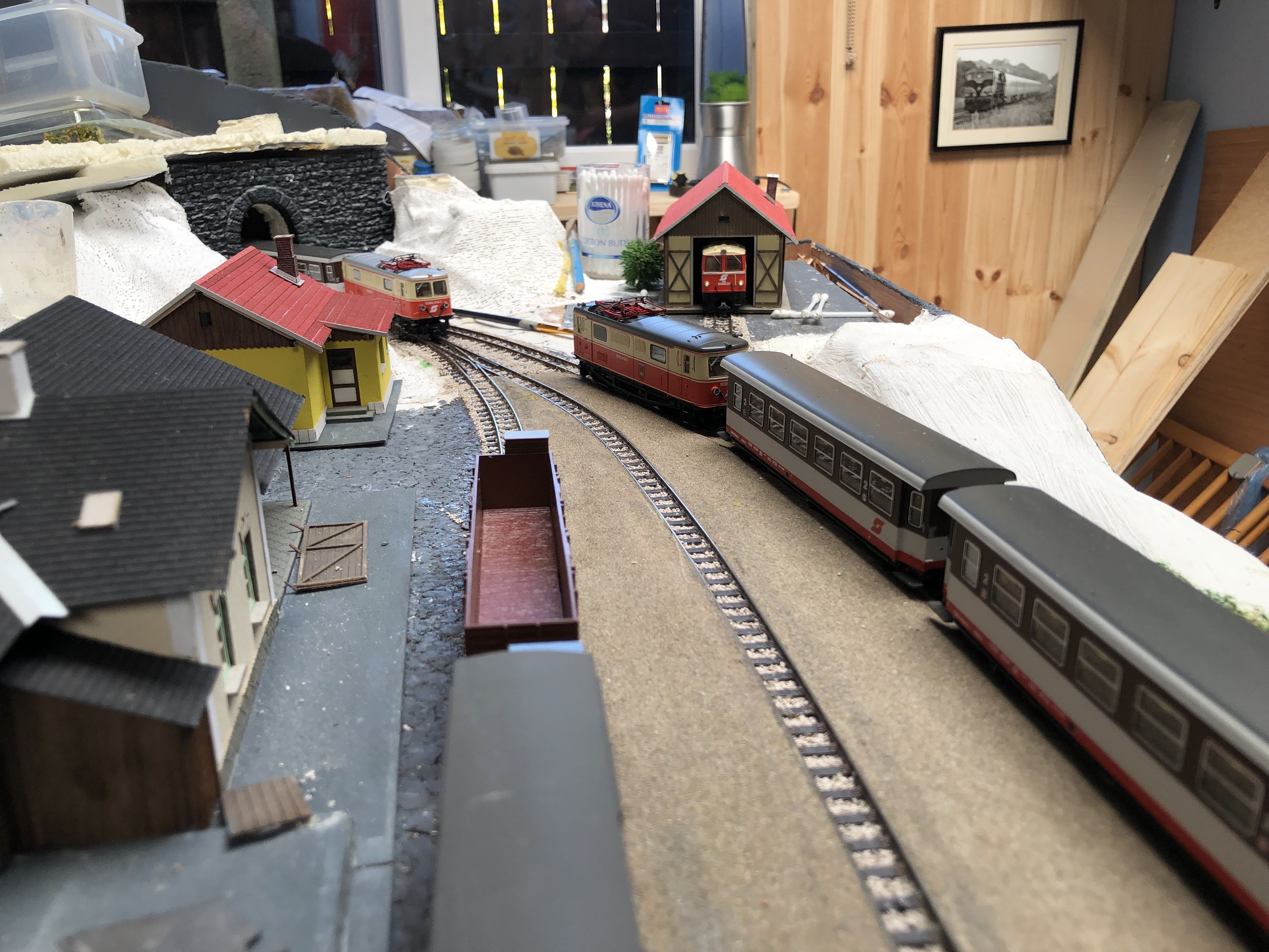

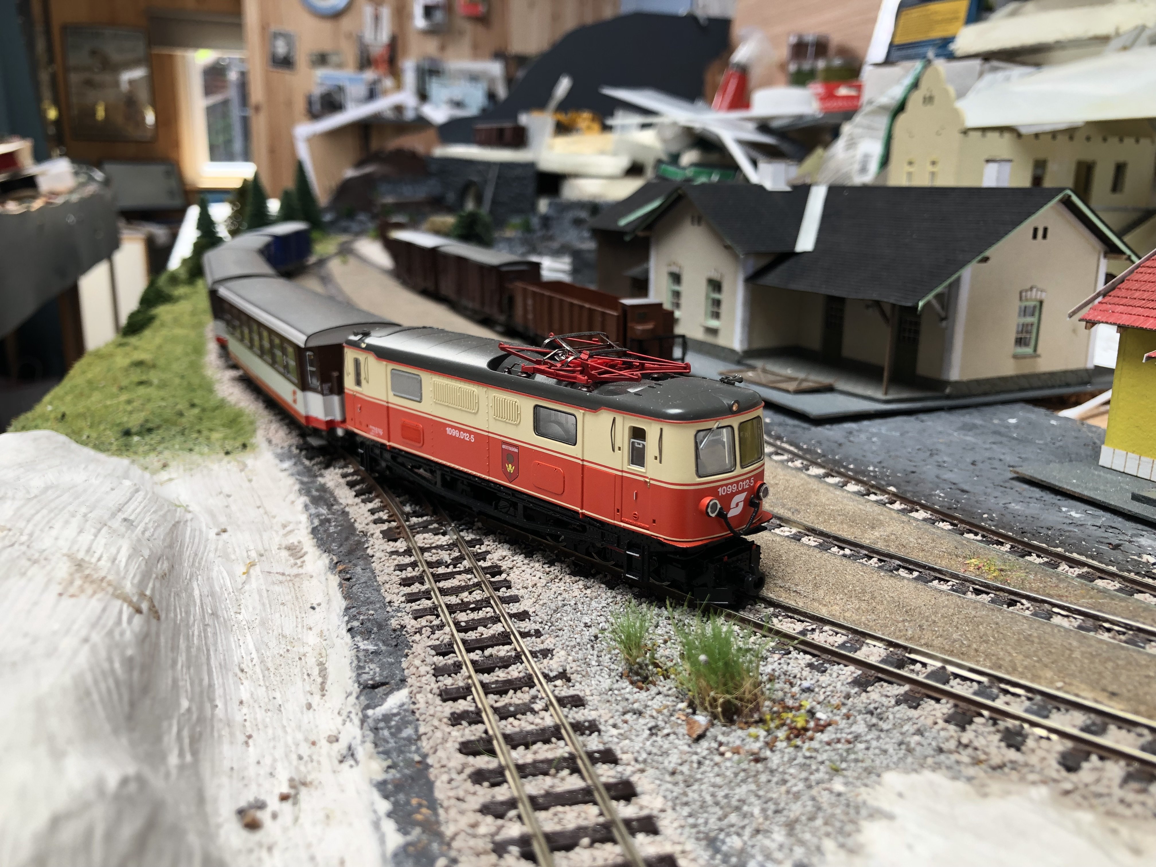

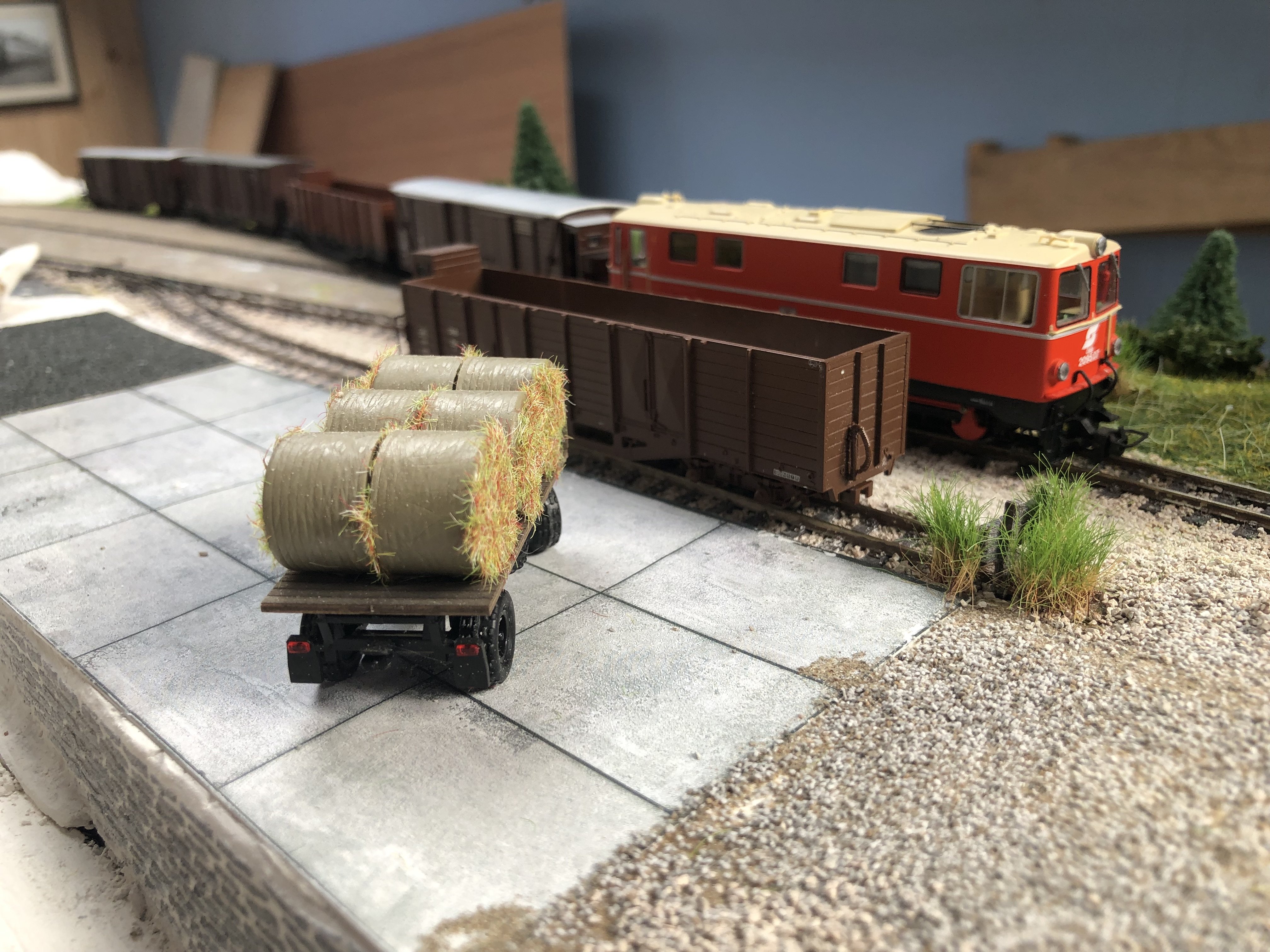

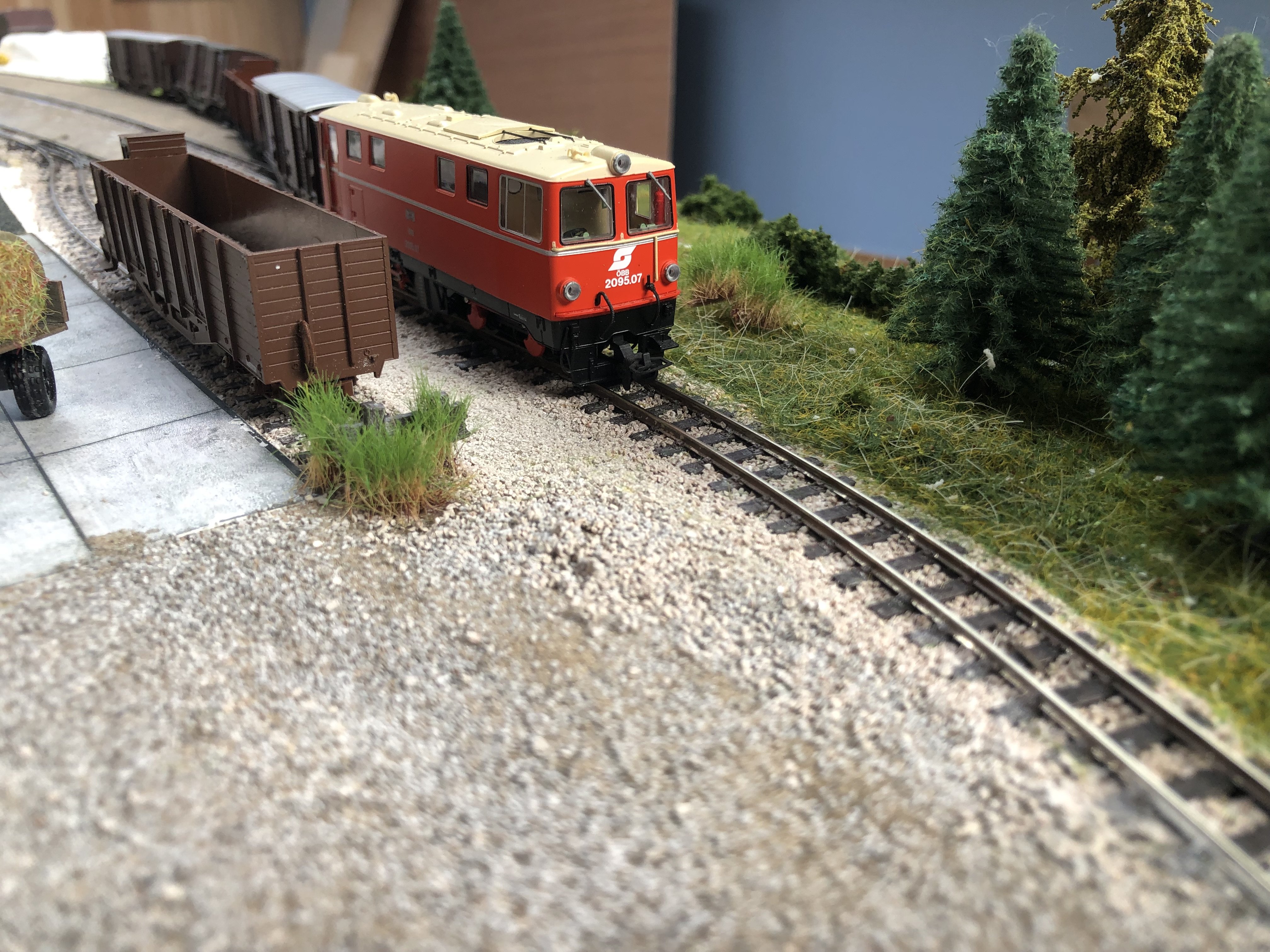

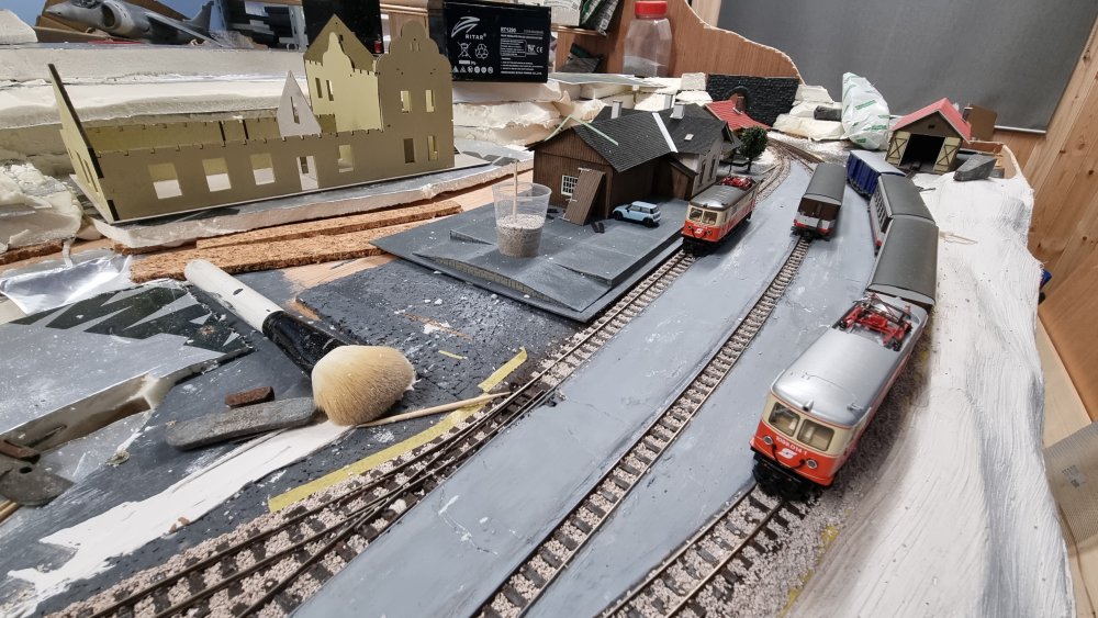

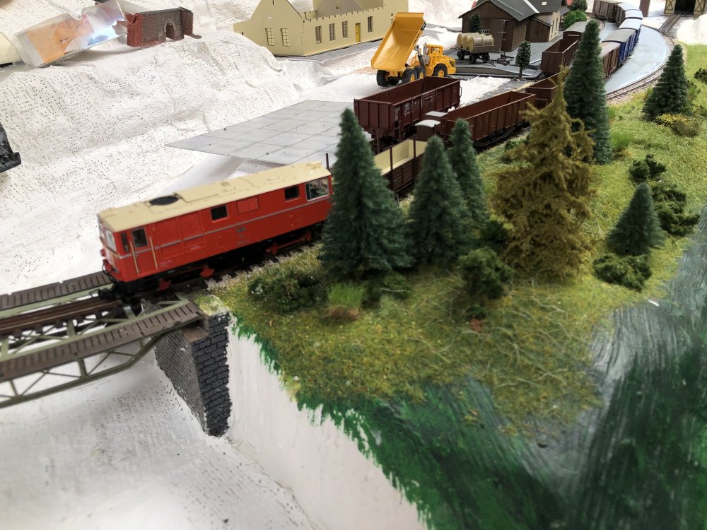

Georgeconna Posted November 18 Author Posted November 18 Had the last week off but got zero done due to a near fatal dose of Man flu but before that took over I laid the platforms down using air dry clay and a bit of pollyfilla. Small bit of ballasting too which I thought looked crap but look fine now when the pollyfilla was laid up next to it. Couple of test runs through those are OK but I will need to reduce the height a tad. 20241118_202453.mp4 20241118_201232.mp4 2 Quote

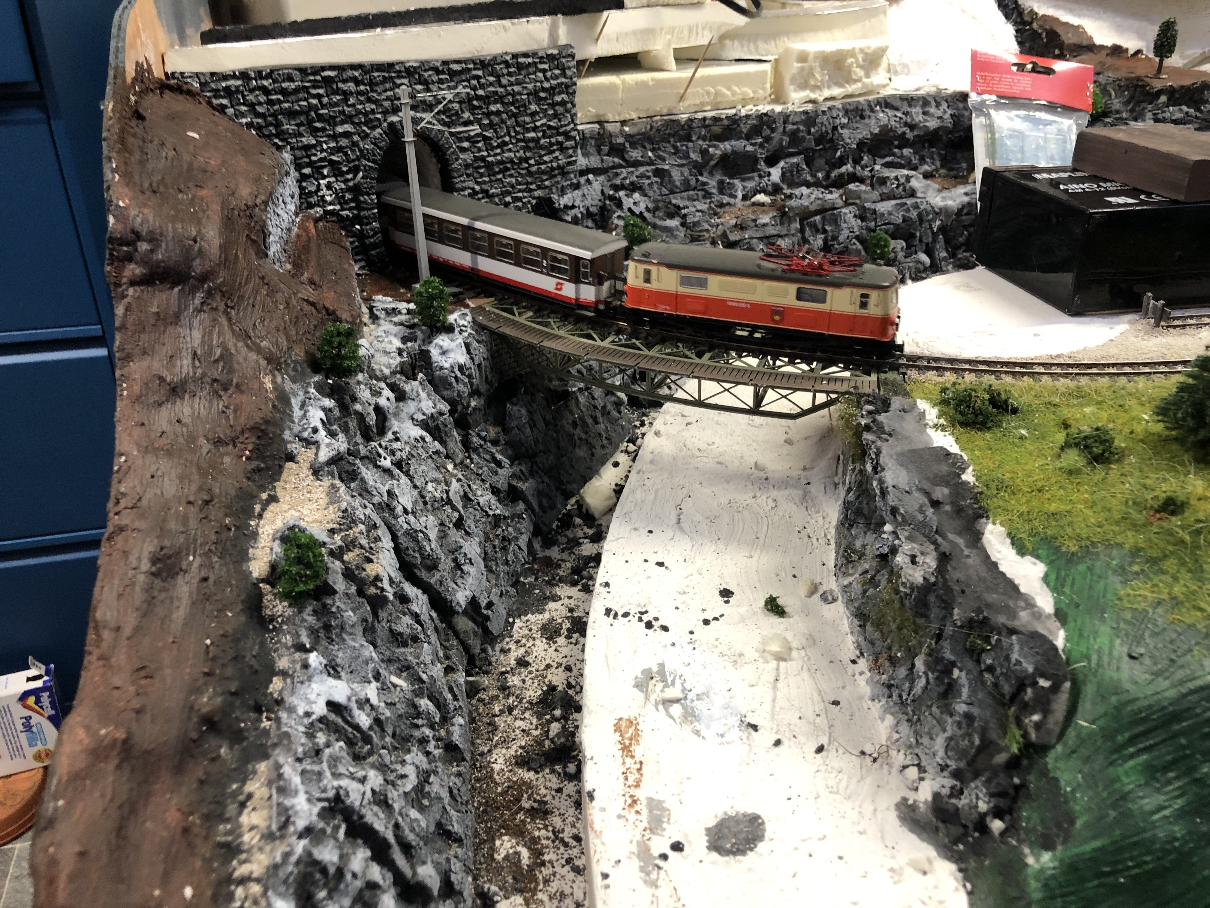

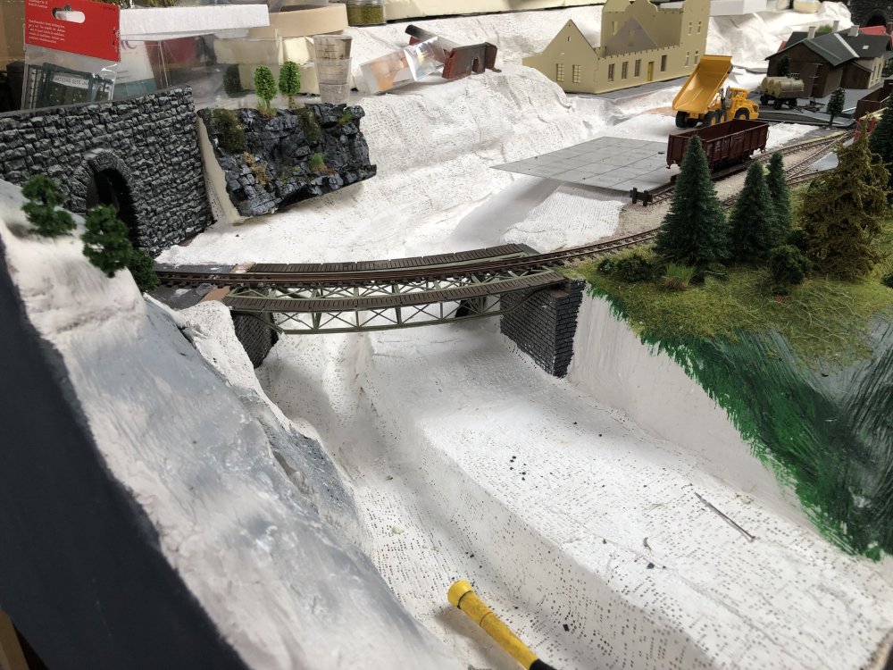

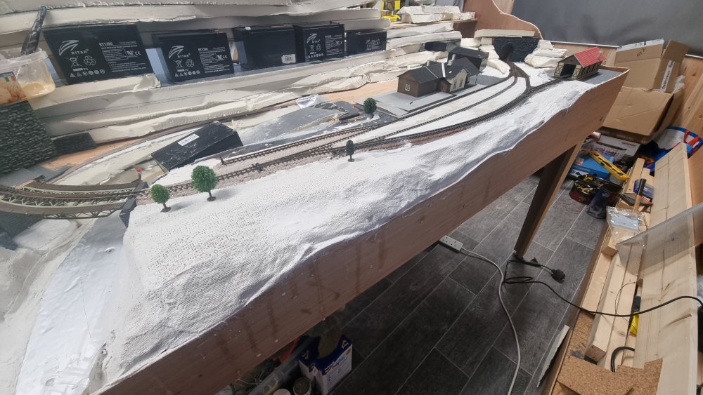

Georgeconna Posted December 2 Author Posted December 2 (edited) Off for the week and a sunny day so wood cutting was the order of the day in between entertaining the mutt. Land scaping next. Edited December 2 by Georgeconna 7 Quote

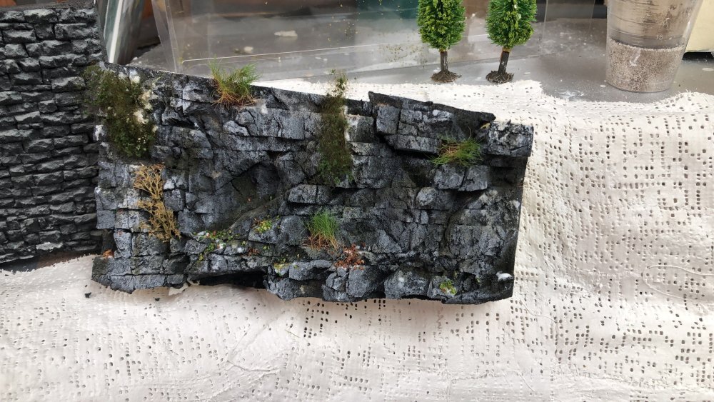

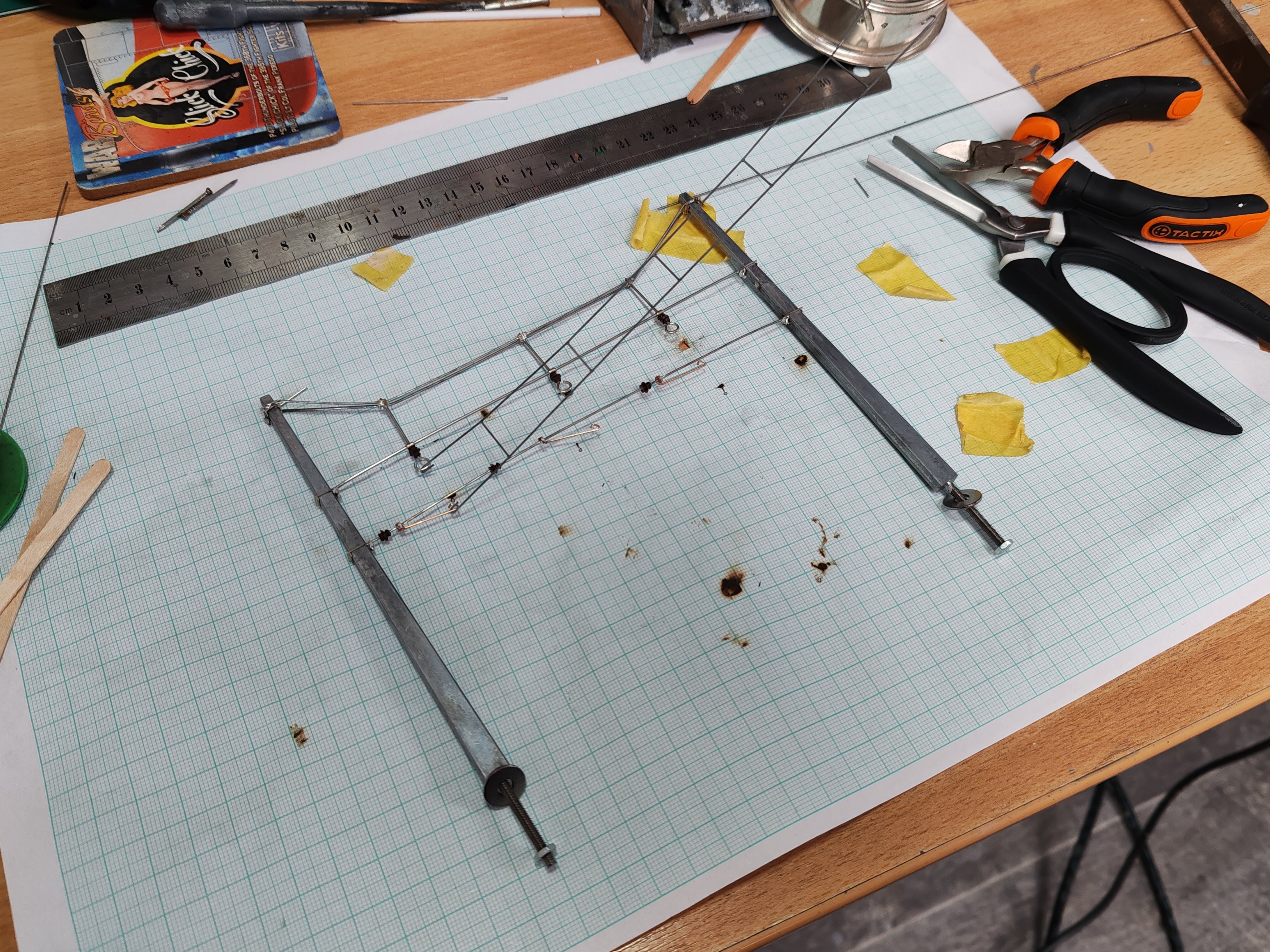

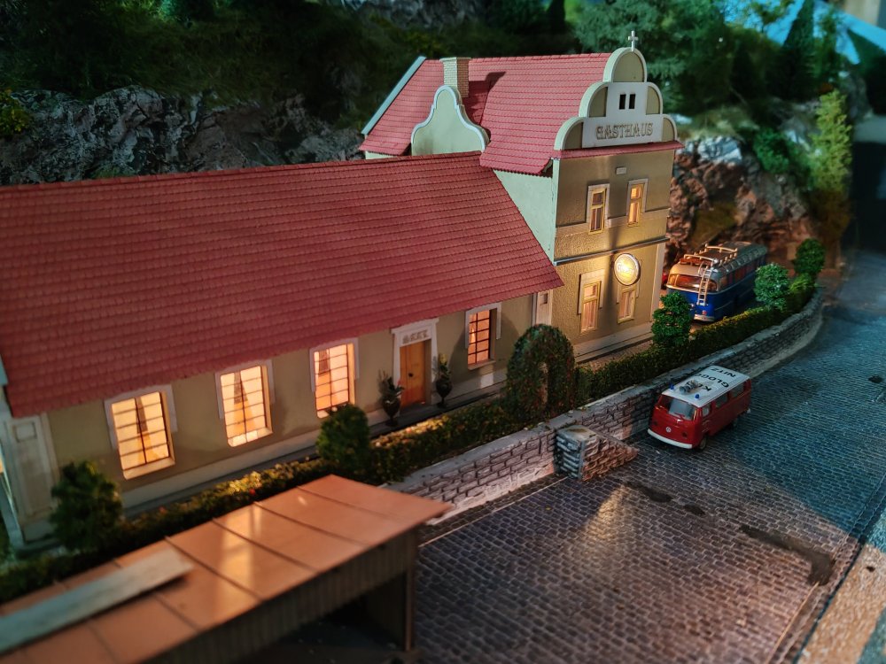

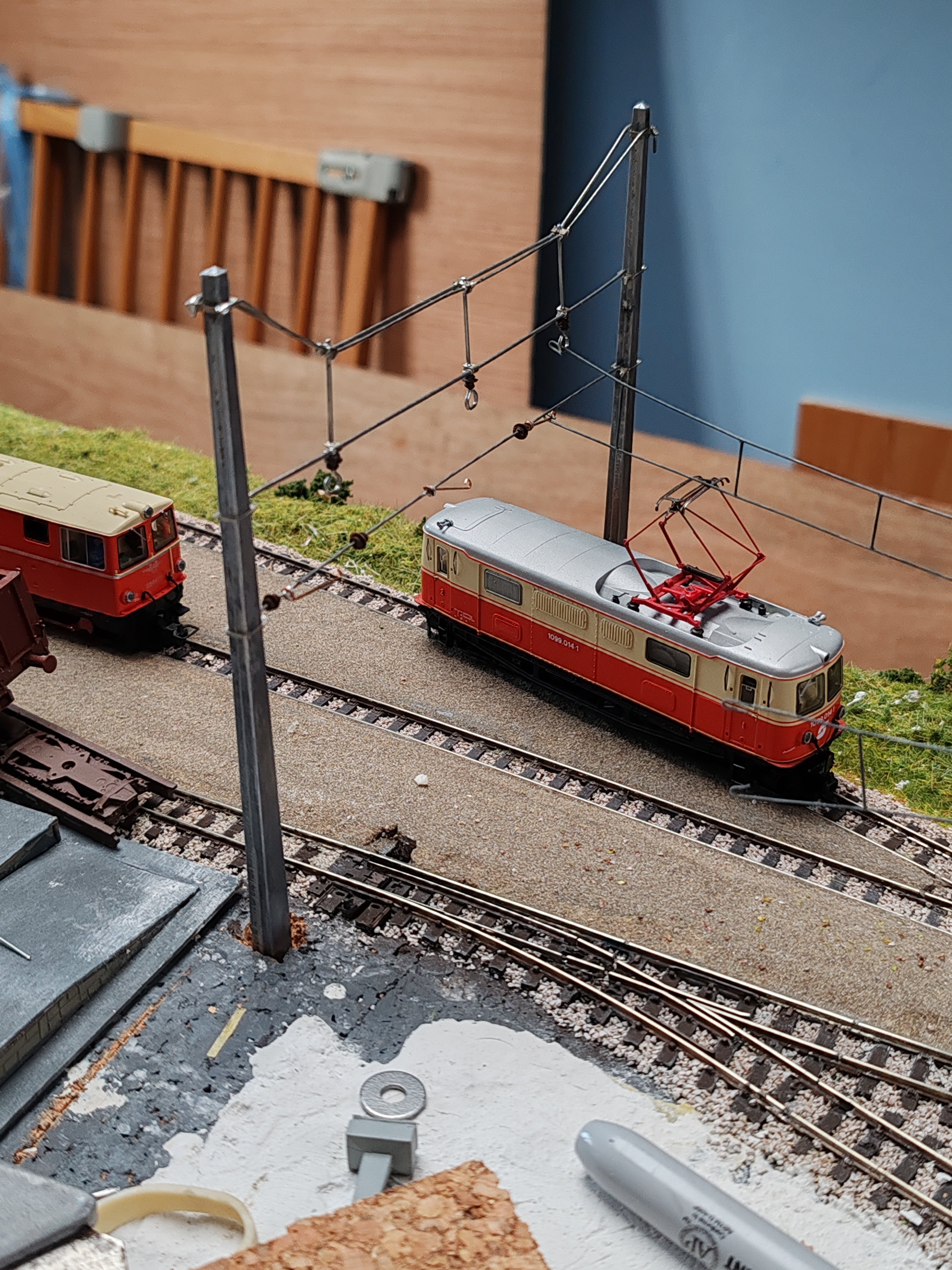

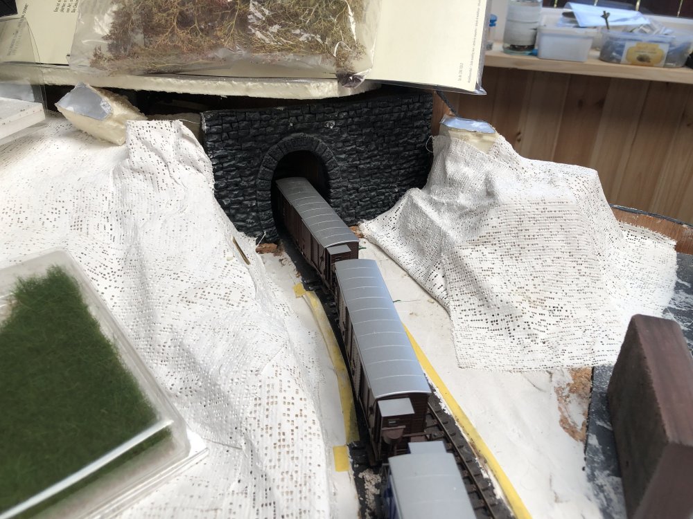

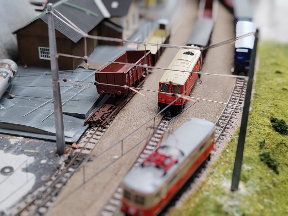

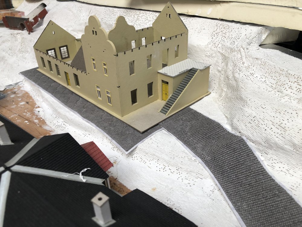

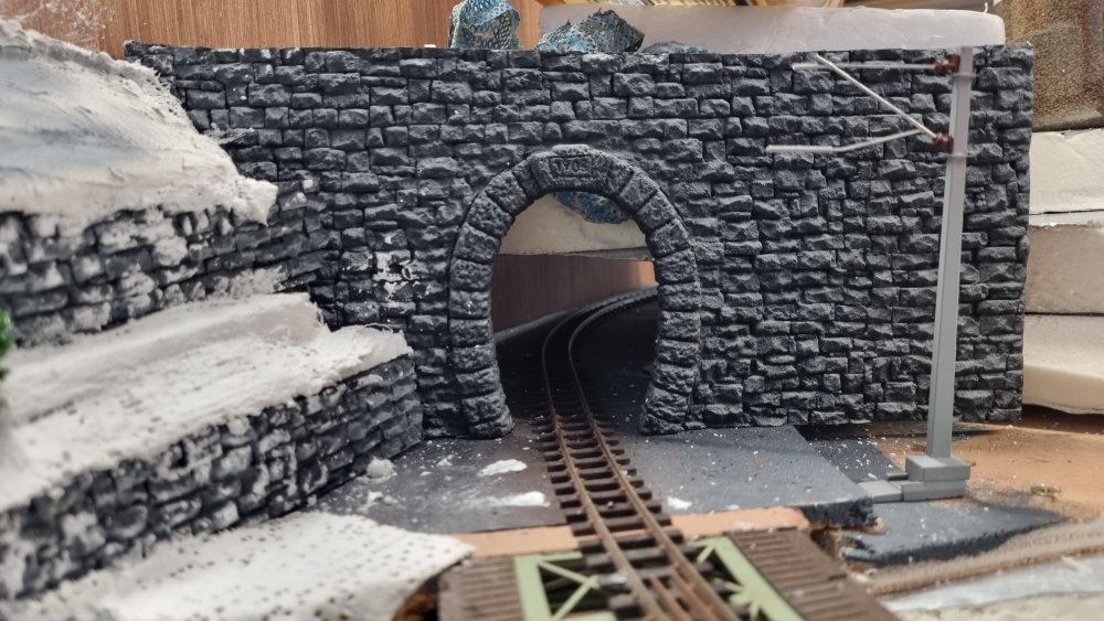

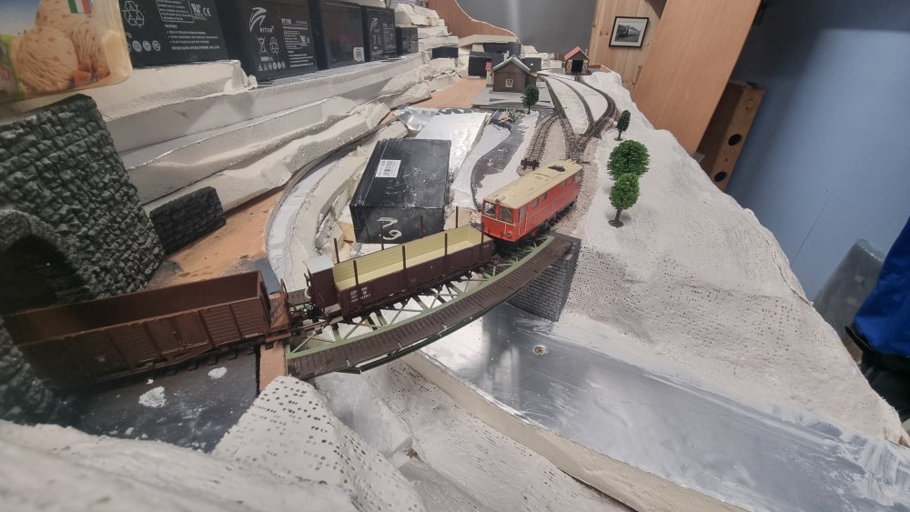

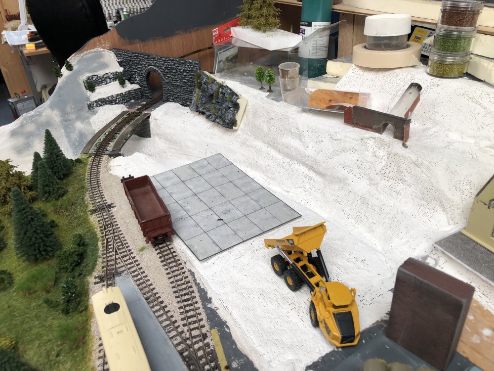

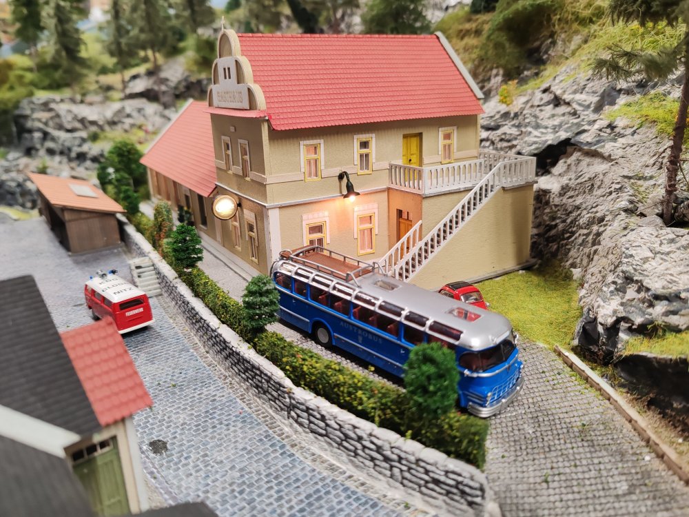

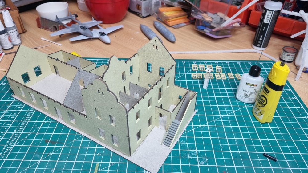

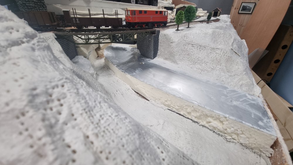

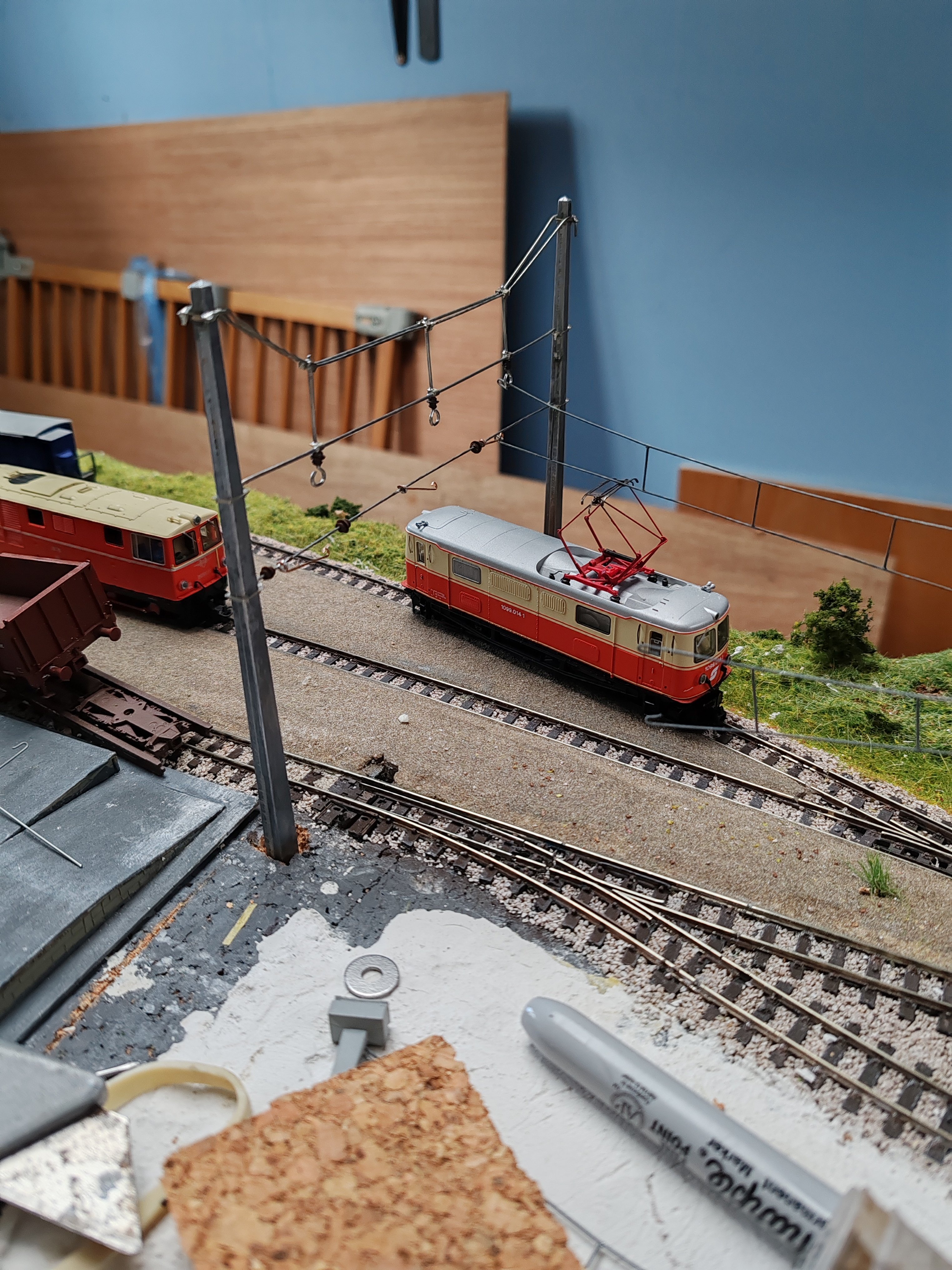

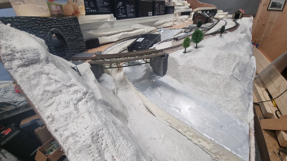

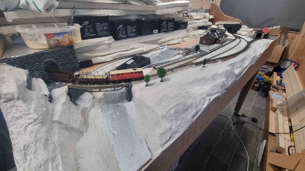

Georgeconna Posted December 13 Author Posted December 13 Tipping away on the scenery. Using some foam Iinsulatipn boards and plaster bandages that I got from Cork Art Supplies Web page. Good price too. Ballasting has Been moving along too but taking ages to dry. Need to think about the OHLE now and the tunnels as I need to work out the madt spacings and sum form of guide to bring the pantos down to the right height when leaving the fiddle yard. I dint fancy having OHLE in the fiddle yard. The final large building, a hostel is in progress also. Keeping it to less is more thinking. 4 3 Quote

Georgeconna Posted December 13 Author Posted December 13 Bit of a play at lunchtime to make sure all is in order after some bsllasting. Also realised the diesel has 29 functions. I had only set up 5!! 20241213_141247.mp4 2 Quote
