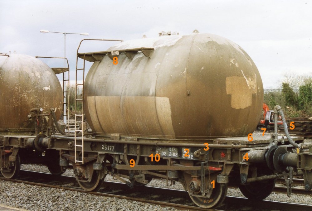

I'm going to be discussing differences in the following areas:
  1. W-irons
  2. Solebar reinforcements
  3. Solebar eyes
  4. Bufferbeam ends
  5. Vacuum pipes
  6. Plain end treadplate
  7. Other details at the plain end
  8. Tank number
  9. Handbrake
  10. Tank support brackets
There may be other differences that I haven't spotted yet.

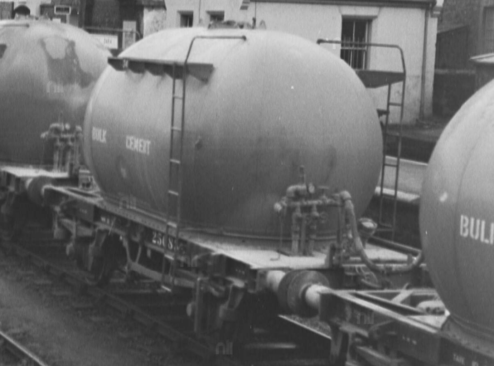

Let's start with the first batch, 25050-25069, built in 1964. Even within the batch there were some variations.
The National Library of Ireland has a nice photo by James O'Dea, at Derry in 1967:
https://catalogue.nli.ie/Record/vtls000307375
  1. W-irons: These are the plain plate type, but the hornguides are festooned with bolts - 16 at each axlebox. This is a key feature of this first batch, which remained unchanged.
  2. Solebar reinforcements: There aren't any - it's just a plain channel section about the W-irons. This was soon modified.
  3. Solebar eyes: There aren't any.
  4. Bufferbeam ends: These are short, the bufferbeams barely protrude beyond the solebars and are no wider than needed to hold the buffers.
  5. Vacuum pipes: These are low, hanging below the bufferbeam.
  6. Braked end treadplate: There isn't one. We can see the top of the vacuum cylinders.
  7. Other details at the plain end: There is a bar across the end above the bufferbeam; this may be a vac brake load changeover valve?
  8. Tank number: 25062 was the 13th cement bubble built (the series started at 25050), and its tank carries the number 13. Not 062!
  9. Handbrake: this is perhaps the biggest difference to what we're used to. It's a handwheel not a lever. Similar handwheels were used on the previous type of wagon built by CIE, the 25201-25435 series flats https://irishrailwaymodeller.com/topic/17496-cie-ballast-wagons-late-1960s-to-1980s-not-hoppers-or-flats/#findComment-250654, and of course on the vac fitted H vans and cattle wagons.
  10. Tank support brackets: without a handbrake vee hanger in the middle of the solebar, these are more obvious. They have chamfered ends.

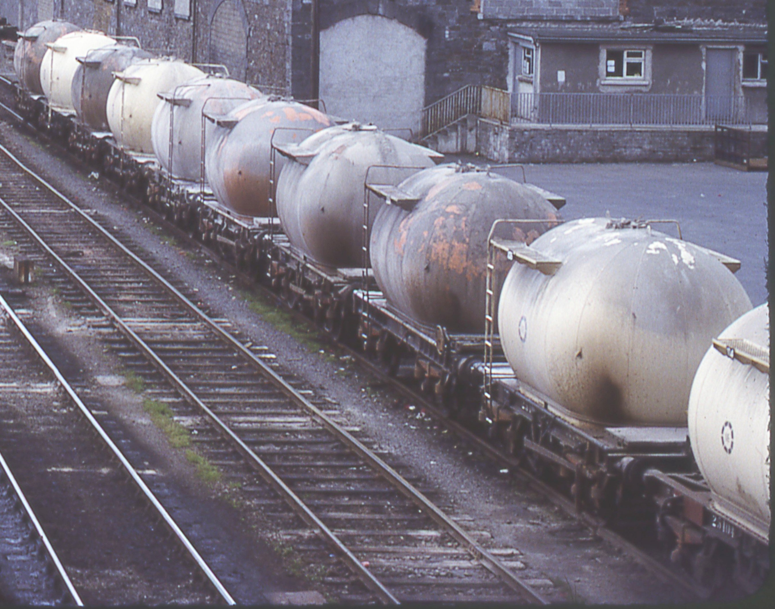

However, 1970s and 1980s photos of these first-batch wagons show some changes, as well as the livery changes to orange and later ivory. This photo by Jonathan Allen on Flickr dated 1978 shows the first wagon with the handwheel above the solebar rather than below. Additionally, the solebars have been reinforced with vertical ribs above the W irons:
168 in Claremorris
Another Jonathan Allen photo from 1970 shows a short train with two early wagons having the handwheel above the solebar (the rest are later batch wagons with the familiar long brake lever):
B185 passing old Portadown station
I'll leave you the fun of looking at 1970s and 1980s photos of cement trains and spotting those with the handwheel brakes - they're quite obvious when you are looking for them...

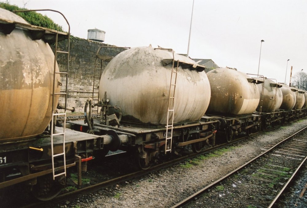

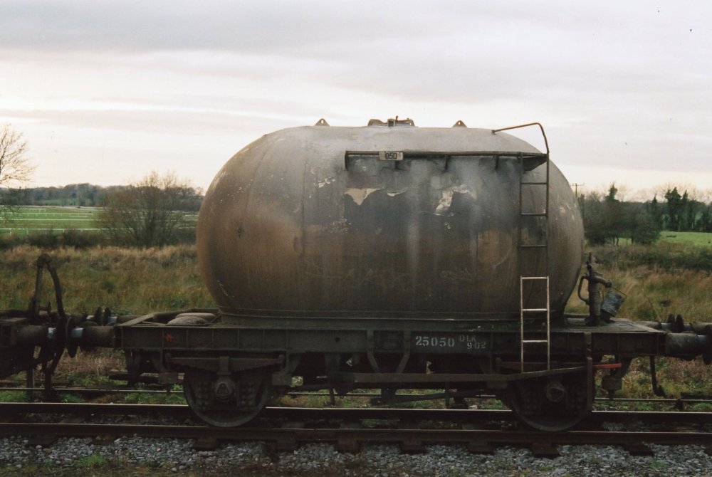

Moving now to the 2000s when I took most of my bubble photos, here's the class leader 25050:
Revisiting the list of characteristics we looked at for the wagon in original condition, with changes marked in bold:
  2. Solebar reinforcements: 7 vertical ribs have been welded above each W-iron. The exact number and spacing of the ribs varied between wagons, as they were a later modification.
  7. Other details at the plain end: Nothing. The parts perhaps associated with the brakes seen in the 1960s photos have been removed.
  8. Tank number: 25050's tank carries the number '050'; it would originally have been '1'.
  9. Handbrake: this has been modified to the long lever type, the same as on the later wagons.

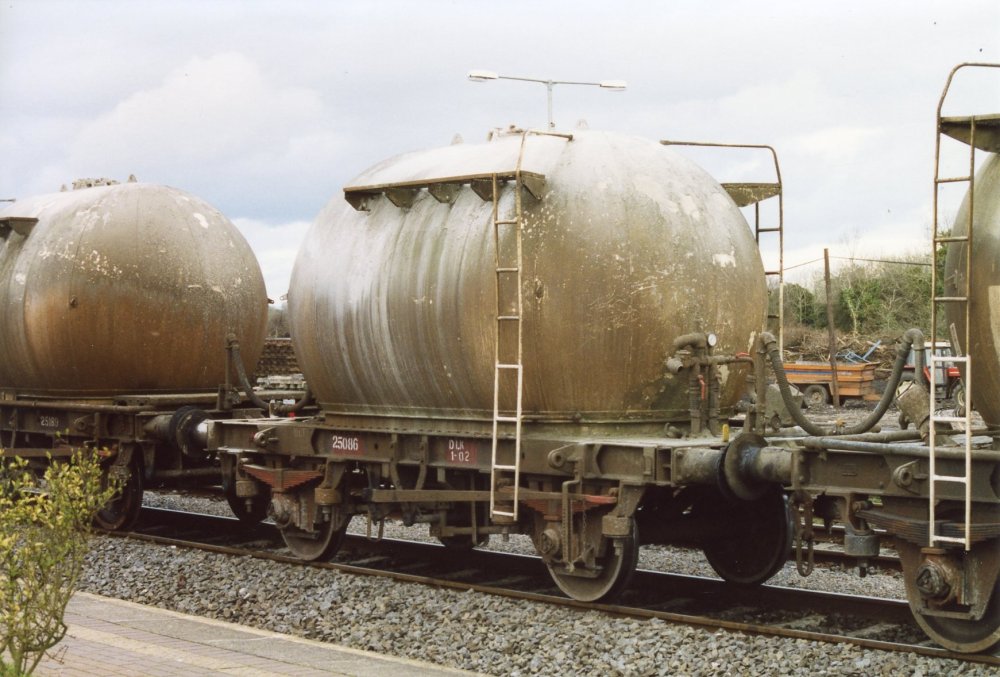

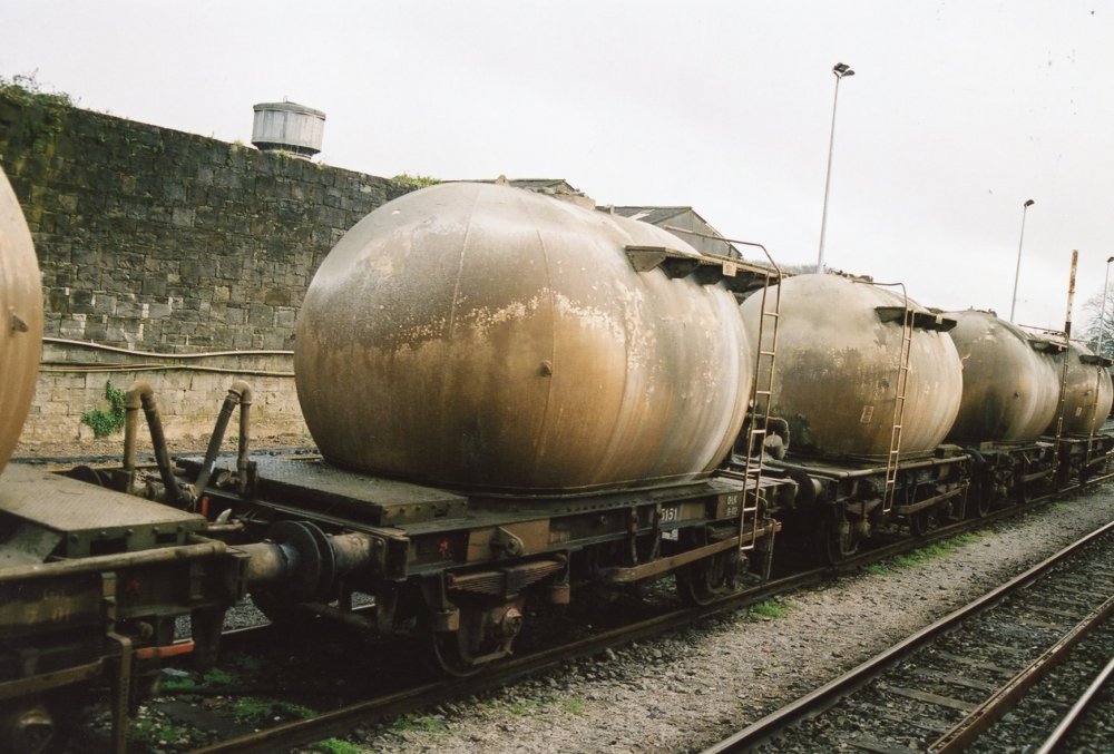

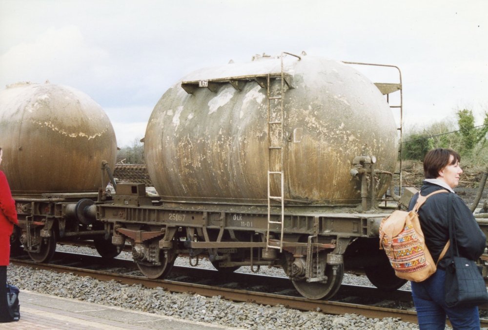

Here is 25067 seen from the other side, basically the same except the arrangement of solebar reinforcing ribs, and the installation of a raised treadplate over the vacuum cylinders.

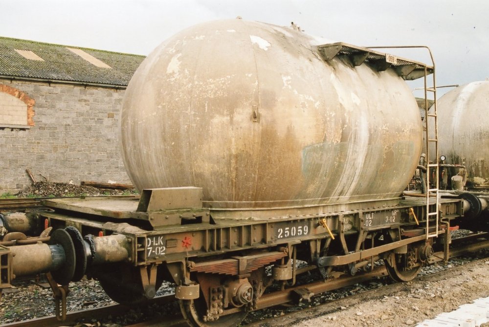

Here's 25059, showing the raised treadplate at the braked end more clearly, as well as some sort of box or housing on top of it. That may have been associated with the brake handwheel arrangement when positioned above the solebar.
Here's another view of 25067 and we can see from this angle that it also has a similar boxy housing at the braked end:
Ernie's photo of 25065 on the left shows the raised treadplate over the brake cylinders, but not the boxy housing. Note the solebar reinforcing ribs are evenly spaced (like 25050 above) rather than the uneven arrangement seen on 25059 and 25067.

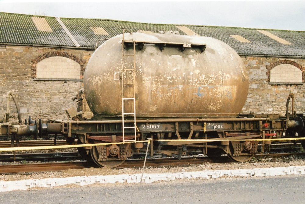

We'll finish the first batch with another of Ernie's photos showing 25067 and 25068 together. This shows the short bufferbeam ends particularly well. Note also that the raised treadplates are secured with 5 bolts each side (we'll see in due course that the later wagons have 6). These two seem to have lost their tank numbers.
Limerick Junc 25067 + 25068 June 2005 DSC02958

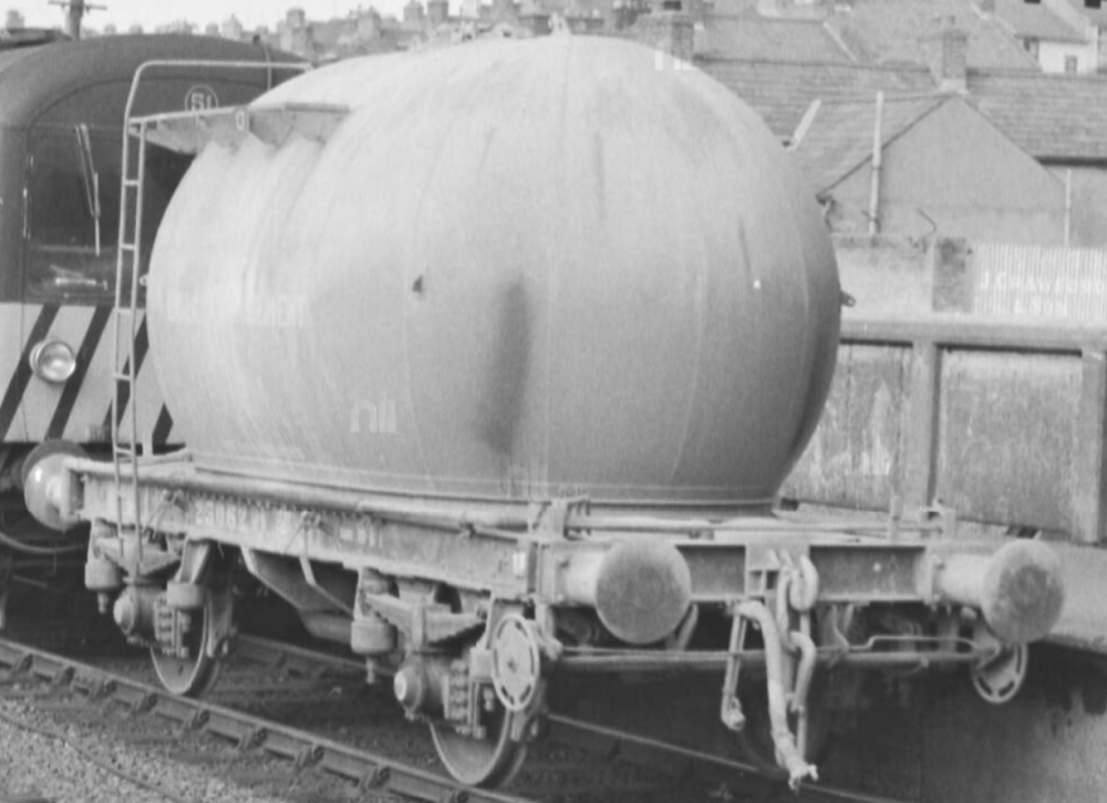

Once again we can thank the National Library of Ireland and James O'Dea for a nice photo of 25083 dating from 1967:
https://catalogue.nli.ie/Record/vtls000306704
We'll look again at the list of 10 items:
  1. W-irons: Just about visible in the photo above, but we'll see more clearly later, these are W-shaped rather than triangular plates.
  2. Solebar reinforcements: rectangular plates welded to the front of the channel section about the W-irons provide extra strength.
  3. Solebar eyes: These are fitted to the front of the solebar reinforcement plates.
  4. Bufferbeam ends: These are longer than the first batch, they protrude beyond the buffers.
  5. Vacuum pipes: These are high, on an upstand above the bufferbeam.
  6. Braked end treadplate: There isn't one. We can see the top of the frame channels.
  7. Other details at the plain end: Difficult to see in this view, but it seems to be just the vacuum pipe.
  8. Tank number: 25083 was the 34th cement bubble built (the series started at 25050), and its tank carries the number 34. Not 083!
  9. Handbrake: this is now a hand lever. However, it's not the later standard type - it has a Morton clutch on the vee hanger, rather than reaching past the vee hanger to a link arrangement.
  10. Tank support brackets: They have vertical ends rather than the chamfered ends of the first batch.

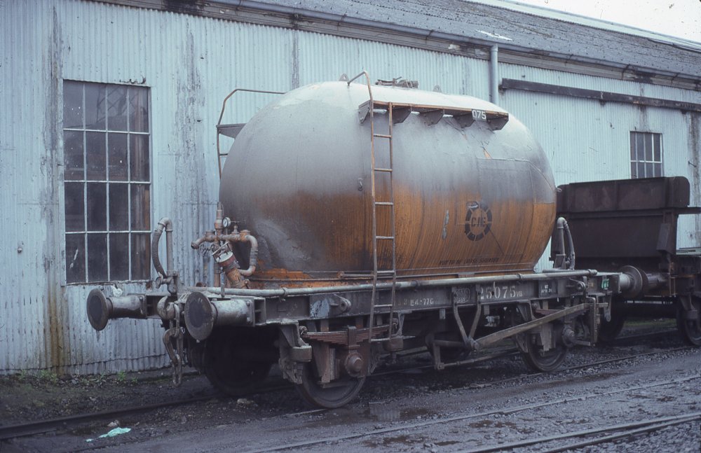

Also in the IRRS archive is this view of 25078, freshly overhauled at Limerick in 1986. Apart from the new ivory livery and the tank number (strangely 078B), its condition is unchanged from the 1960s photos:
https://www.flickr.com/photos/irishrailwayarchive/53508119122/

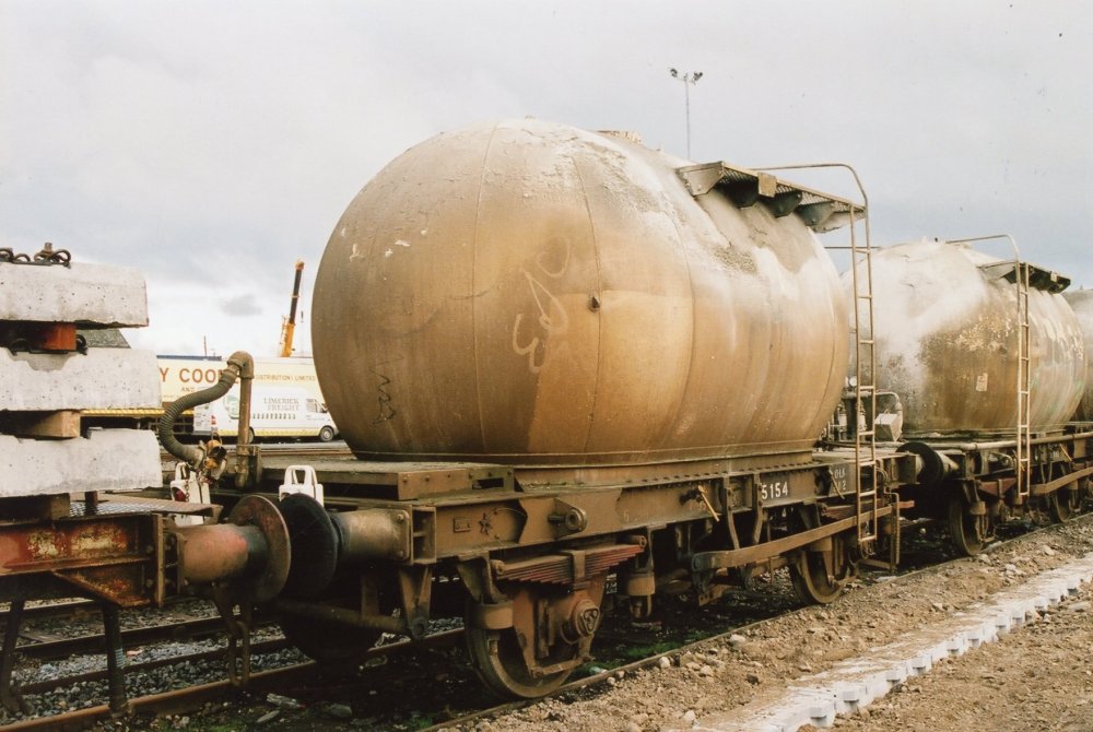

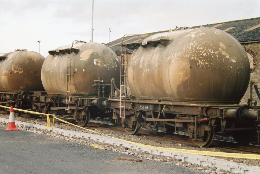

Moving to the early 2000s and my own photos, here's the first of the batch 25070, and in the second photo 25086:
We'll look again at the list of 10 items, again the modifications from original condition are shown in bold:
  • W-irons: These are W-shaped rather than triangular plates.
  • Solebar reinforcements: The rectangular plates have been replaced by plates with fishtail-shaped ends, on both wagons pictured
  • Solebar eyes: These are fitted to the front of the solebar reinforcement plates on 25086, but absent on 25070.
  • Bufferbeam ends: These are longer than the first batch, they protrude beyond the buffers.
  • Vacuum pipes: These are high, on an upstand above the bufferbeam.
  • Braked end treadplate: There isn't one. We can see the top of the frame channels on 25086. It's possible there is a flush plate on 25070 but it's hard to see.
  • Other details at the plain end: Just the vacuum pipe.
  • Tank number: 25070 carries '070', 25086 has no tank number.
  • Handbrake: The hand lever arrangement has been modified to the standard type with a long lever reaching past the vee hanger to a link arrangement.
  • Tank support brackets: They have vertical ends rather than the chamfered ends of the first batch.
So, fewer modifications to this batch but there were still some changes implemented over the years.

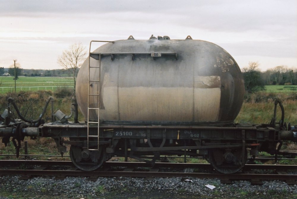

Also in 1965, there were 5 bubbles built numbered 25100-25104. I cannot explain why the numbers 25095-25099 were missed out, and this gap was filled in a couple of years later.
25100-25104 had the same tare weight as the other 1965-built wagons described in the previous post, and were probably similar originally. I have not yet found any older photos of these. However, here's my photo of 25100 in the early 2000s:
We'll look again at the list of 10 items, in this case the differences from the other 1965 wagons in 2000s condition are highlighted in bold:
  • Solebar reinforcements: Vertical ribs above the W-irons.
  • Solebar eyes: These aren't any.
  • Braked end treadplate: There isn't one. We can see the top of the frame channels.
  • Tank number: 25100 carries '100'.
  • Handbrake: The hand lever arrangement is the standard type with a long lever reaching past the vee hanger to a link arrangement.
The only difference from the other 1965 wagons is in the area of the solebar reinforcements and eyes, and in this respect the 25100 batch are more like the original 25050 batch. It is possible that the 1965 production started with 25100-104, and the 25070-25094 batch followed with the improved solebar design.

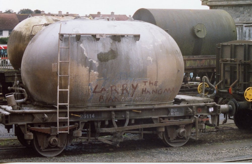

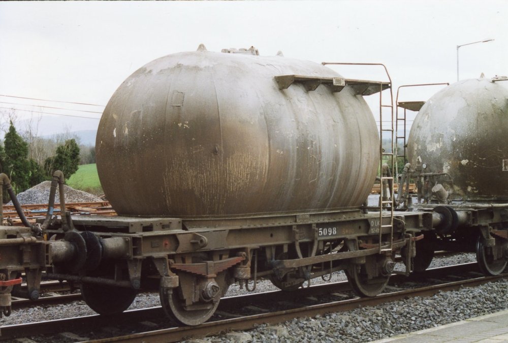

Moving now to the more modern photos which are a bit clearer, here's 25114, 25098 and 25110. I think these remained basically unmodified from the as-built condition.
img758.thumb.jpg.5d5e74c33c007d7f4c3c37cbe7a1db9a.jpgimg764.thumb.jpg.6a76675e88a5c80c2320254fbabdfce8.jpg
  • Solebar reinforcements: rectangular or fish-tail ended plates welded to the front of the channel section about the W-irons provide extra strength.

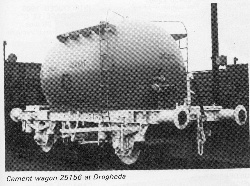

Finally, there was a large batch of 60 wagons built in 1972, 25140-25199. By now the design had matured and these seem to have been identical to the 1970 batch, and they remained largely unmodified through their lives.
The photo in the Doyle&Hirsch stockbook shows one of these when new, here's 25156, and note that the tank number is 156 matching the running number, so the tank numbering policy must have changed by 1972:
For completeness we'll look again at the list of 10 items:
  • W-irons: Plain triangular plates.
  • Solebar reinforcements: rectangular plates welded to the front of the channel section about the W-irons provide extra strength.
  • Solebar eyes: These are fitted to the front of the solebar reinforcement plates.
  • Braked end treadplate: A raised treadplate is provided. It has 6 fixing bolts each side (rather than the 5 bolts on the plates retro-fitted to the first batch).
  • Tank number: matches the last 3 digits of the wagon number

An eBay purchase a few weeks ago on this theme - a nice clear slide of 25075 in orange livery, green-carded at Limerick:
This wagon was in the second batch, and would have been delivered in grey livery in 1965. The photo dates from 1979 by which time it had been repainted with orange tank and grey frame, and then had a chance to get fairly grubby.
Reviewing the list of 10 items as I did up-thread:
  1. W-irons: These are W-shaped rather than triangular plates.
  7. Other details at the braked end: Difficult to see in this view, but it seems to be just the vacuum pipe.
  8. Tank number: 25075 carries tank number 075; it has been renumbered from the original.
  9. Handbrake: this is a hand lever. However, it's not the later standard type - it has a Morton clutch on the vee hanger, rather than reaching past the vee hanger to a link arrangement.
What's particularly useful about this photo is that it clearly shows the as-built brake configuration of the second batch, which was different from the other batches and was later modified to match the last batch.

In the IRRS archive, a photo at Inchicore dated February 1964 with what must one of the first bubbles, still in primer I think:
https://www.flickr.com/photos/irishrailwayarchive/53505734117

I recently bought an old colour slide of Limerick, dated 1983, mainly because it included a nice rake of cement bubbles viewed from above. Here's a closeup of the relevant part of the slide, slightly brightened to enhance the detail:
10 bubbles are visible, of which 4 are in ivory livery and remaining six are in filthy orange.
In later years these wagons tended to be marshalled in pairs with the filler pipe ends (and ladders) adjacent. That is not the case here.
Nearest, and only partially visible, is 25104 built in 1965. It retains its original Morton brake arrangement - the brake lever goes to the vee hanger, rather than reaching beyond it. At the end with the vacuum cylinders, the lack of a raised treadplate is obvious compared to the adjacent wagon which is from one of the later batches (1967 / 1970 / 1972).
The third wagon, in orange, is one of the original batch from 1964. It retains the wheel handbrake arrangement but moved above the solebar (the original position was below). Reinforcing ribs have been added to the solebars above the W irons, quite different from the flat plates with protruding eyes on the later batches.
The fourth wagon is one of the later batches, but seems to have a non-standard access hatch in the top.
The remainder of the wagons all seem to be pretty standard, later batches, and the image isn't clear enough to show the finer details.
The patterns of weathering - cement from above and rail dirt from below - are quite interesting, as is the way that some of the accumulated cement has come off in lumps to expose patches of paint underneath.

It must be said that after a bit of weathering from cement dust and brake dirt, the original colour of the underframe is rather hard to distinguish in most photos, especially monochrome images. Perhaps a good dose of weathering on the models is the answer!
Here are two colour photos of a whole train of grey bubbles in the 1960s, which give no useful information on underframe paint colour!
https://www.flickr.com/photos/irishrailwayarchive/53449790845/
https://www.flickr.com/photos/irishrailwayarchive/54257011099/
Another whole-train photo from the IRRS archive, dated 'm1960s' but I think it's 1969/70 based on A31's livery. Not very useful for wagon livery details though:
https://www.flickr.com/photos/irishrailwayarchive/53447019558/
Another 'm1960s' photo. A 1965-batch bubble is in the background, already looking pretty grubby:
https://www.flickr.com/photos/irishrailwayarchive/53447018728/
So far, I haven't found a colour photo that clearly shows a mixture of original grey and orange liveries. Seems odd, it must have happened in the livery transition period. The liveries can be hard to distinguish in monochrome photos though.
I'd better get back to some modelling rather than just researching the next project. Hopefully someone else has some late 1960s bubble photos that would confirm the liveries of each batch?
You’re 100% right about the 1967 bubbles, and I suspect others too. ALL my recollections were of all over grey ones, and going to school beside the GNR main line I saw them daily. I never saw a single black chassis - in a world where every single solitary goods vehicle was all grey, it would have stuck out like a sore thumb.
But - there’s photo evidence of black too.
My conclusion is that some were black but most grey - and when they painted the “bubble” bit orange eventually, the grey continued on the chassis.
