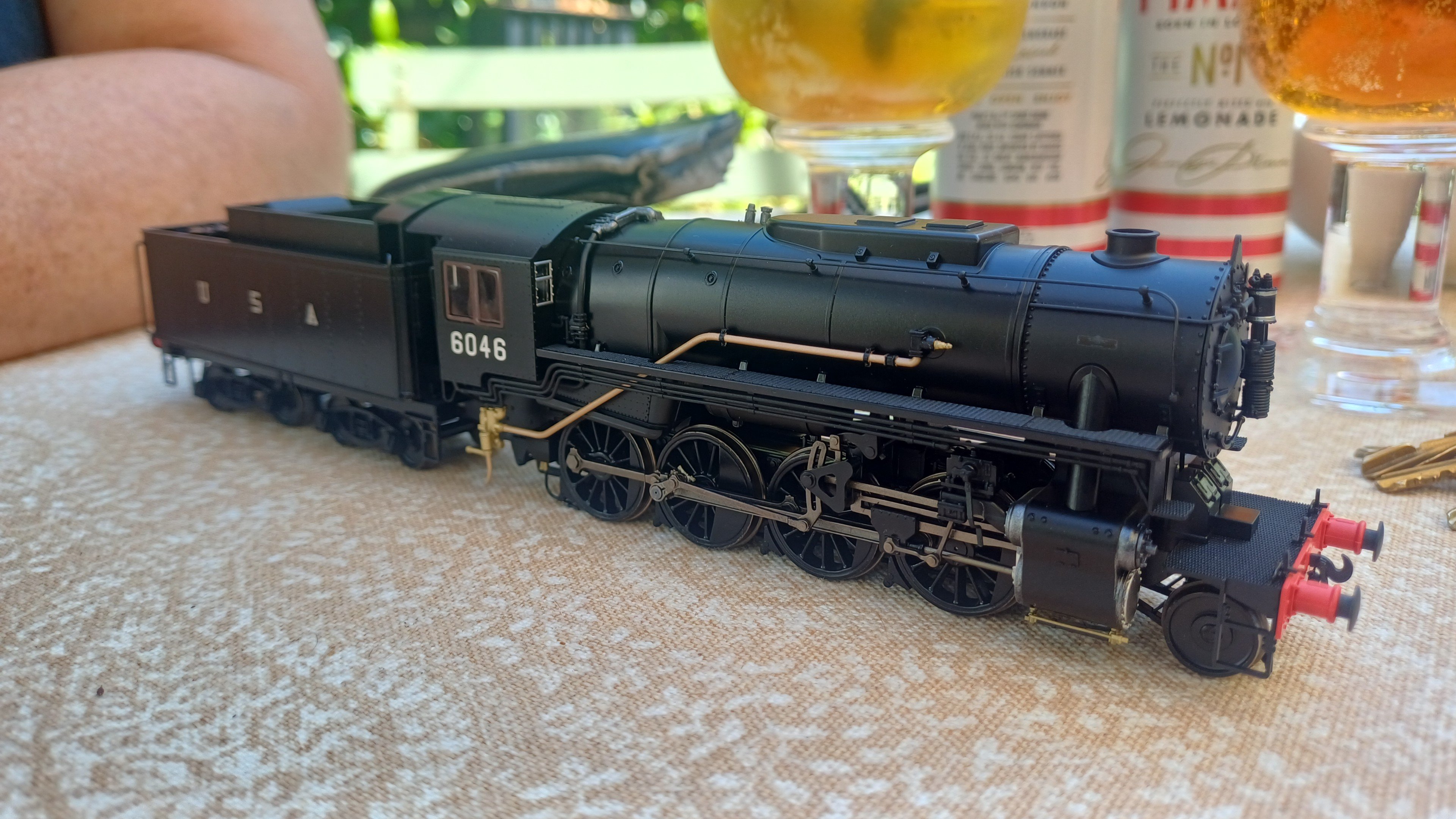

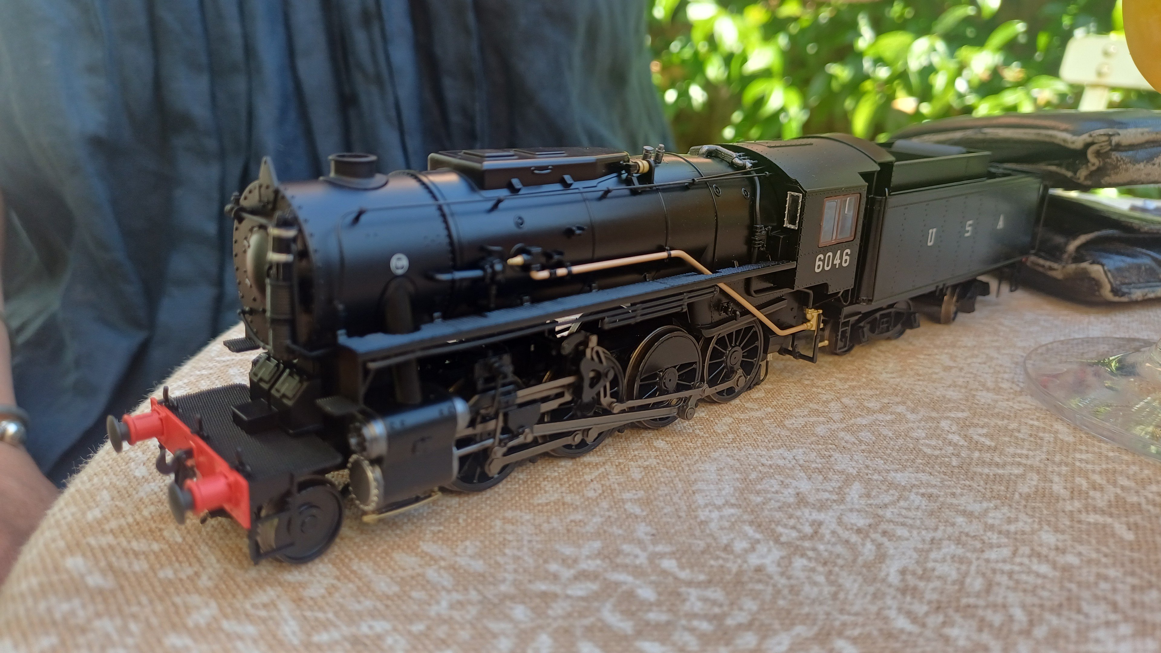

Horsetan Posted July 25 Posted July 25 Two years in the planning, Rapido have just delivered this. The S160 has never been mass-produced in 4mm scale before (although Roco did make a very good one in HO some years ago), and I've only ever seen two scratchbuilt efforts - one in OO, and the other in EM. There's at least eight different livery variants available, and Rails of Sheffield have plenty of stock starting at a not too terrible £230 (more if you want it in DCC with sound). At a glance, it looks as though it might be possible to convert it to P4 - axles appear to be 2mm diameter throughout (so longer replacements will be needed), and wheels look as though they will tolerate a session on a lathe, with most material being taken off the back to thin the flanges and maybe a light skim off the tyre face. 2 1

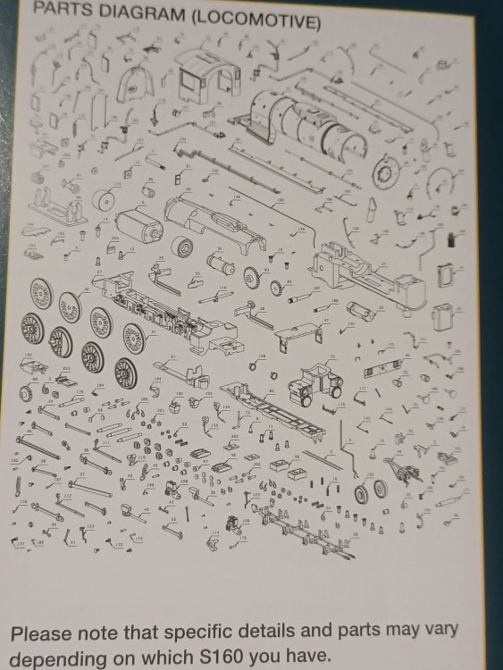

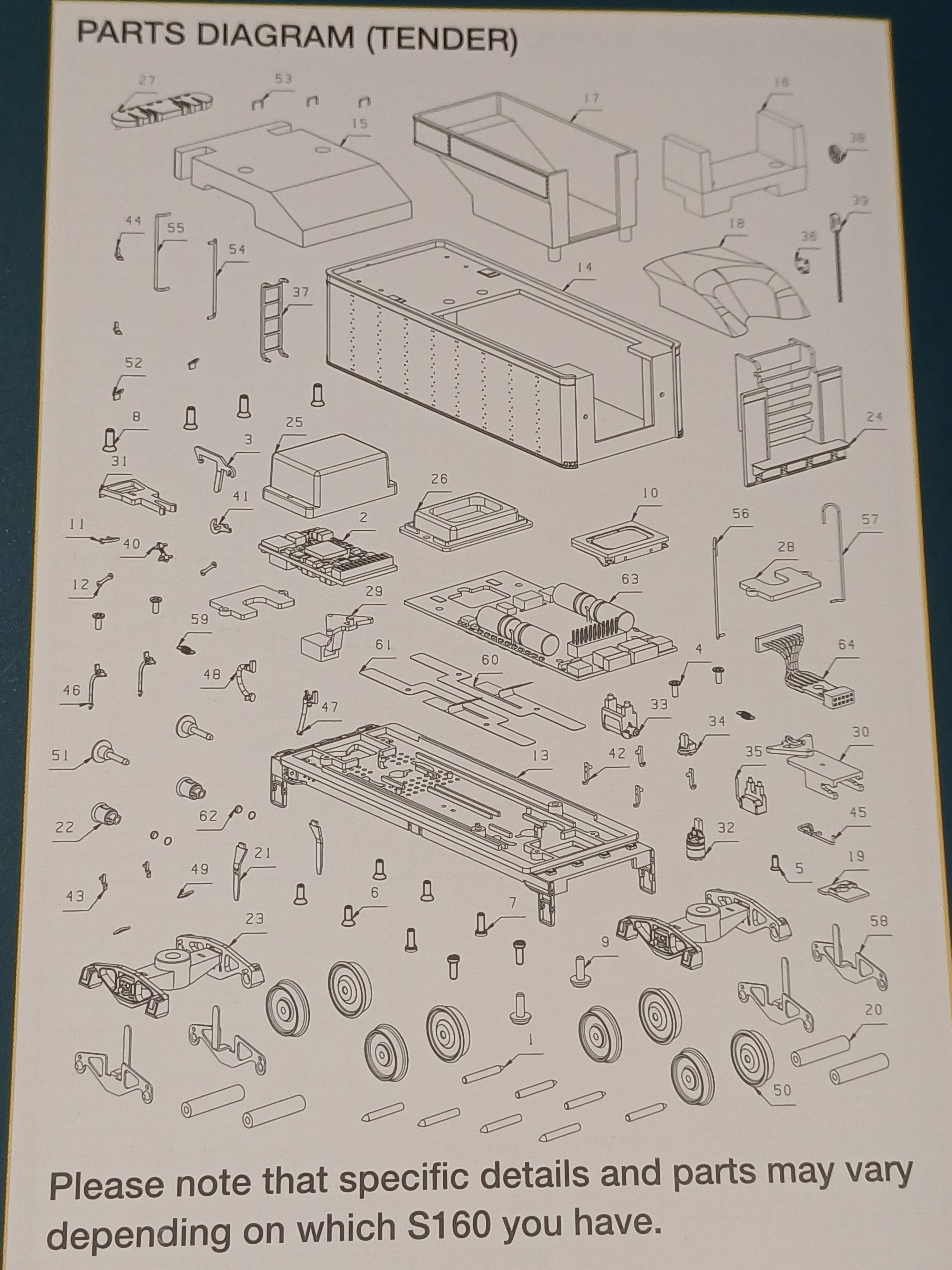

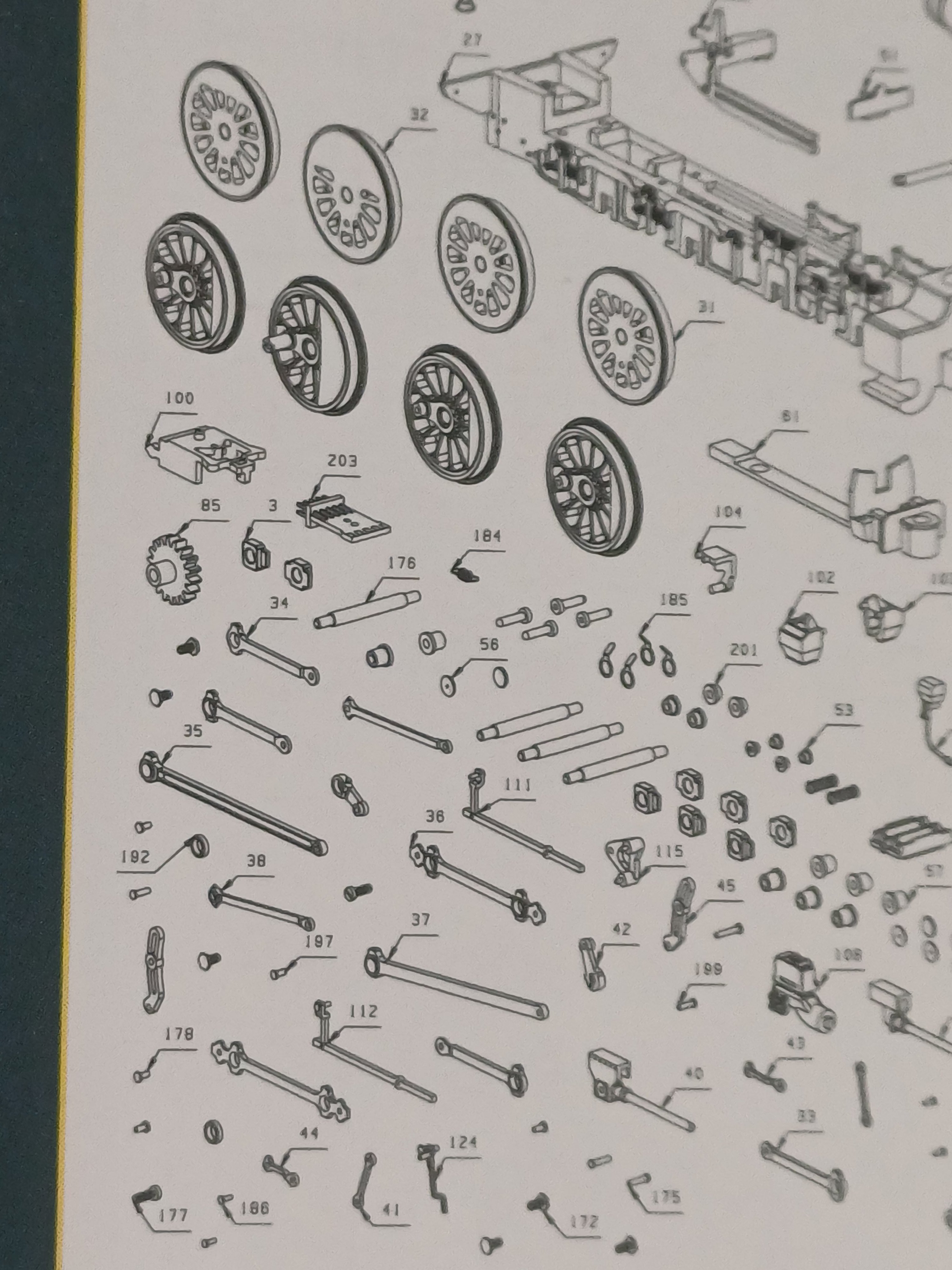

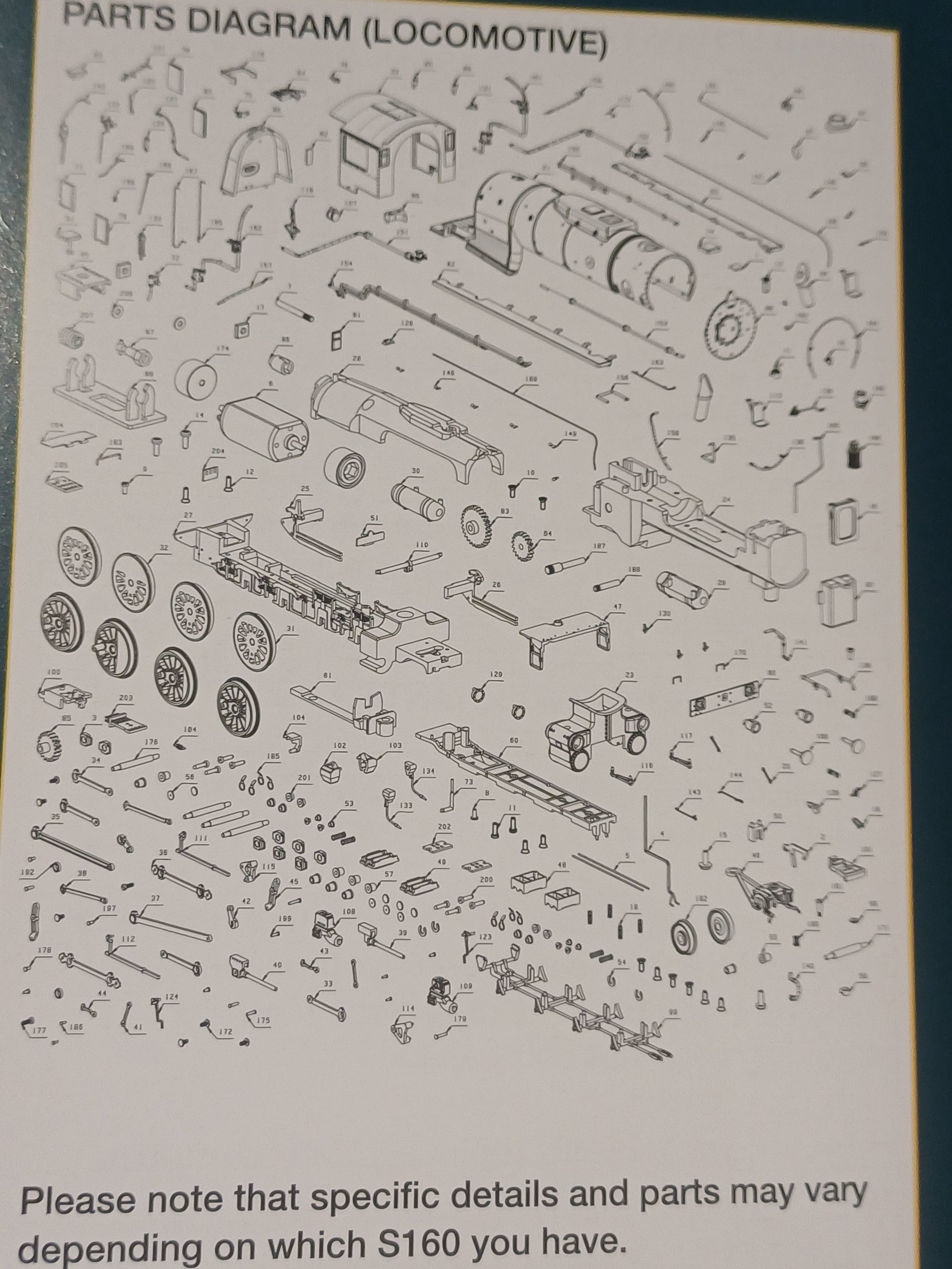

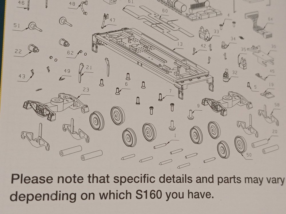

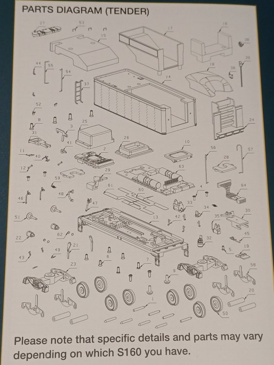

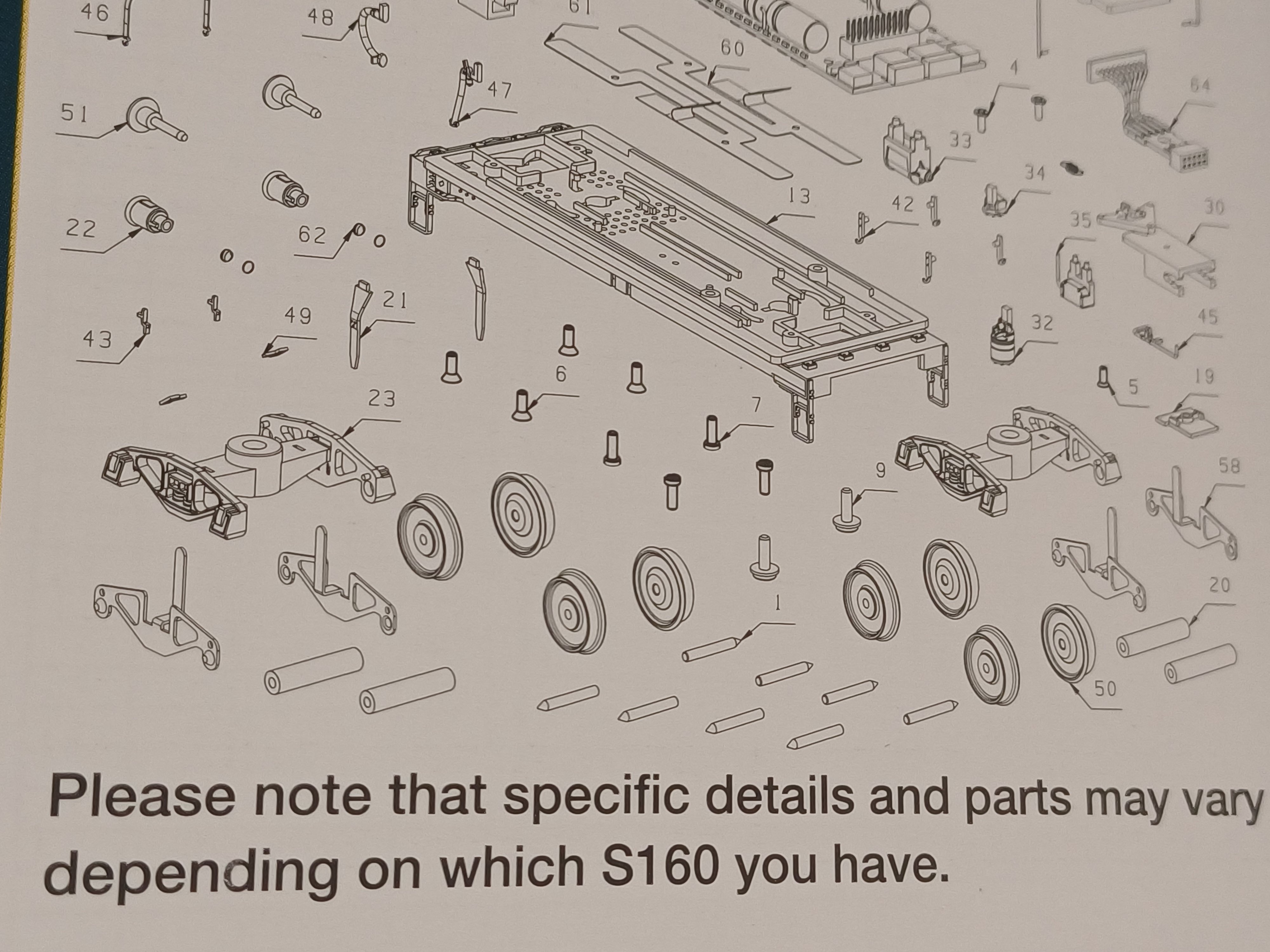

Horsetan Posted July 28 Author Posted July 28 On 25/7/2026 at 6:35 PM, Mol_PMB said: ...I'd be interested to see some photos of how you go about the conversion of something like this. It's turning out to be a bit more complicated, which I would expect from Rapido, after reading the exploded diagrams. The locomotive wheels are all mounted on shouldered axles and are insulated both sides using plastic bushes - similar to the Bachmann spec, and also IRM diesels so far. Shouldered axles have some advantages in that they are good at preserving the back-to-back measurement - once you hit the stop, that's it. This means having P4 shouldered axles specially made. Possibly Ultrascale can do this, as they already make them for their GWR 44xx driving wheels, albeit a ⅛" dia. axle turned down to 2.5mm dia. at the ends. Rapido's are a different diameter on both counts. I also must measure the overall width of the driving wheels in particular and see if it is practical to have metal skimmed off the back to thin the flanges. The tender wheels are very familiar if you have encountered IRM coach bogie wheels - disc wheels mounted on a 1.5mm stub axle, and kept to gauge by a central insulating tube. There are ways of moving the wheels out with press tools. 3
Mike 84C Posted July 28 Posted July 28 Looking at those exploded diagrams, they should be stamped with some sort of warning, " interfere with this model at your peril". 1

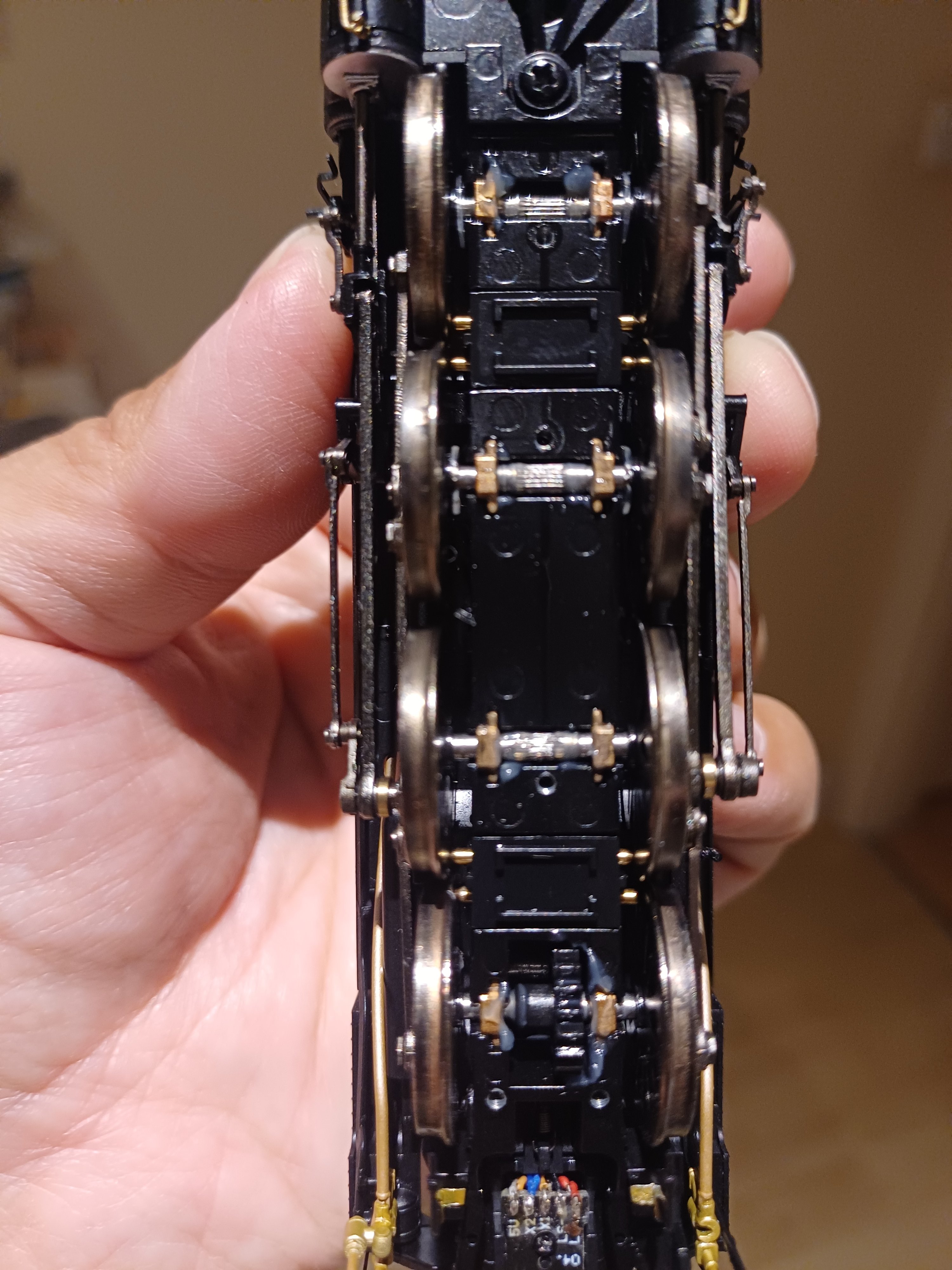

Horsetan Posted August 1 Author Posted August 1 I'm after opening up the chassis to have a look, and can confirm the following: Driving axles: 2mm diameter - all axles have a serrated central section intended for gear wheels, but only the rear driven axle makes use of this. All axles are supported by sintered square bearings, similar to those seen on the Hornby 08 shunter. Overall wheel width: 2.8mm. There is scope to skim off the rear, which would thin the flanges, but I suspect this will only get you to 2.3mm wide at best - good for EM, but no better. I wonder what the spares situation is? Would it be possible to buy direct from Rapido a set of 8 new drivers and insulating bushes, turn off the tyres on a lathe, and then press the bare wheel centres into new P4 tyres?
Galteemore Posted August 1 Posted August 1 Looks like plunger pick ups too ….do those have enough spring in them to cover P4 width?
Horsetan Posted August 1 Author Posted August 1 8 hours ago, Galteemore said: Looks like plunger pick ups too ….do those have enough spring in them to cover P4 width? Yes, they are. I haven't pulled the wheelsets out, but I would hope that the springs behind them can be extended. 1
