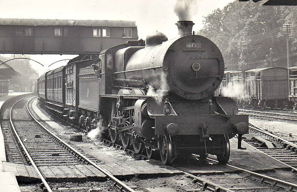

Scots Mac Posted January 4, 2014 Author Posted January 4, 2014 (edited) Hi Jh, that grey looks lighter because of the close up photo-flash.In normal light it does look not too bad and quite dark As for the 400s in the Mclements book they are definately recorded as having been given the green treatment in the 50s. On the smugmug CIE gallery there are monochrome photos in which a few of the 400s look very clean and could quite possibly be in lined green but its hard to know if its rivit lines or lining on the tenders. This photo pf 407 certainly looks like shes imacculate and quite possibly in the,lined green....http://transportsofdelight.smugmug.com/RAILWAYS/IRISH-RAILWAYS/CORAS-IOMPAIR-EIREANN-STEAM/18279129_TbnP49#!i=2844309905&k=m57B4cv&lb=1&s=X2 Edited January 4, 2014 by Scots Mac
jhb171achill Posted January 4, 2014 Posted January 4, 2014 The pic of 402 at Mallow certainly seems green as I see some trace of lining, though interestingly there seems no trace of the number on the buffer beam. For a free, grey or black loco that would be highly unusual. All locos were generally numbered there under all ownerships. Â The one of 407 I'm not sure about. No lining seems visible, and the numeral and "snail" seem clean enough - it could be grey.
Scots Mac Posted January 4, 2014 Author Posted January 4, 2014 Hi JH, you could be right about the lining. I did read somwhere thouigh that numbers on drawbars were dispensed with on locos that got smokebox door numbers. This seems to be the case on 402, theres also a photo of Macha or Tailte? without drawbar numbers , On that photo you have of 401 in green JH is there any sign of lining ? Cheers Davy
