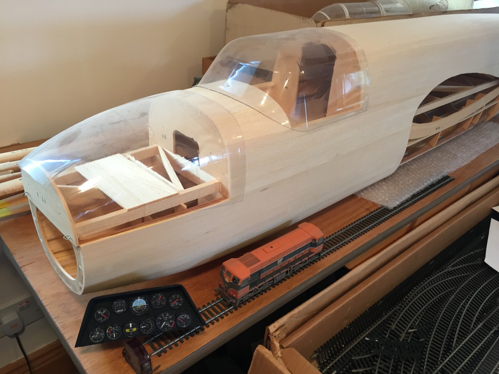

Noel Posted January 21, 2015 Posted January 21, 2015 (edited) Another side of my modelling hobby is RC model aircraft B25 Mitchell of 'Dolittle Raiders' fame. The MM 141 loco on bottom of pic gives a sense of scale. Construction is spruce spars, lite ply formers and carved balsa planked sheeting. Its a Nick Ziroli plan, about 101 inch wingspan. Part of the tail plane. When finished she will be covered with a very thin layer of fibreglass cloth (i.e. instead of dope and tissue as used on smaller models) and then painted. She will have a pair of Zenoah 38cc petrol engines and controlled by Multiplex radio kit. Have an 80% completed AT6 Texan/Harvard ready for spraying which will have a Zenoah 60cc petrol motor. But the RC scale hobby is being parked now for a long break while I get working on the layout. Edited July 21, 2017 by Noel
Georgeconna Posted January 21, 2015 Posted January 21, 2015 Another side of my modelling hobby is RC model aircraft B25 Mitchell of 'Dolittle Raiders' fame. The MM 141 loco on bottom of pic gives a sense of scale. Construction is spruce spars, lite ply formers and carved balsa planked sheeting. Its a Nick Ziroli plan, about 101 inch wingspan. Part of the tail plane. When finished she will be covered with a very thin layer of fibreglass cloth (i.e. instead of dope and tissue as used on smaller models) and then painted. She will have a pair of Zenoah 38cc petrol engines and controlled by Multiplex radio kit. Have an 80% completed AT6 Texan/Harvard ready for spraying which will have a Zenoah 60cc petrol motor. But the RC scale hobby is being parked now for a long break while I get working on the layout. Are you in the Shannon Club Noel, Seen a B-25 on the Flightlines Mag last edition, Might be the same scale, Looks the Job, Are you putting in a Working Bomb bay? Is that a Chipmunk Canopy in the Background?
Noel Posted January 21, 2015 Author Posted January 21, 2015 Hi George No I used to be a member of SRFC in Wicklow. Most of my old flying pals now operate out of a club up in Roundwood. It's been a while since I was on that scene. Well spotted, the canopy in the box behind belongs to an AT-6 Texan/Harvard which is also about 102" scratch built from plans. And yes the bomb bay will have operating doors and working bomb releases (micro parachute types for recovery and flower bombs for target competitions). The cockpit panel beside the MM loco actually belongs to the AT-6. Also used to fly choppers and pattern aerobatics many moons ago, but once I got used to petrol motors I never wanted to hear the screech of a high revving glo motors ever again! That end of the hobby has pretty much gone electric now anyway, and quad copters have ruined flying. Noel
