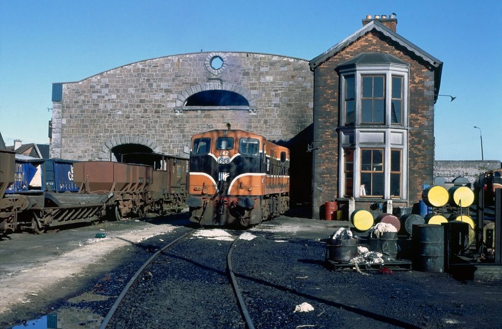

Mayner Posted July 6, 2017 Posted July 6, 2017 The late 1960s was an interesting period with conventional (usually unfitted) wagons and vans running in mixed consists with recently introduced flats carrying ISO containers, palletised fertiliser and Guinness traffic, or bulk cement wagons. Brian Flannigans Flickr site has a good collection of photos of typical goods stock mainly in the Tralee area. Dublin-Tralee goods services were the last to go over to Liner (unit train) operation when loose coupled services ended in 1978 when a coupling broke on the last scheduled loose coupled goods out of Heuston Goods as the train climbed the Gullet to Inchacore and the wagons ran back into the station
Noel Posted July 6, 2017 Posted July 6, 2017 Great pics on that link. Thanks for posting. Pretty much what I remember before boring liners and fitted bogie freight arrived. . . . a coupling broke on the last scheduled loose coupled goods out of Heuston Goods as the train climbed the Gullet to Inchacore and the wagons ran back into the station. Would the guard in the brake van not have applied the brake stopping the uncontrolled run back of the rear half of the train?
Noel Posted July 6, 2017 Posted July 6, 2017 PS: That yard in Dromad depicted in the flickr link is eccentric but a treasure trove.
