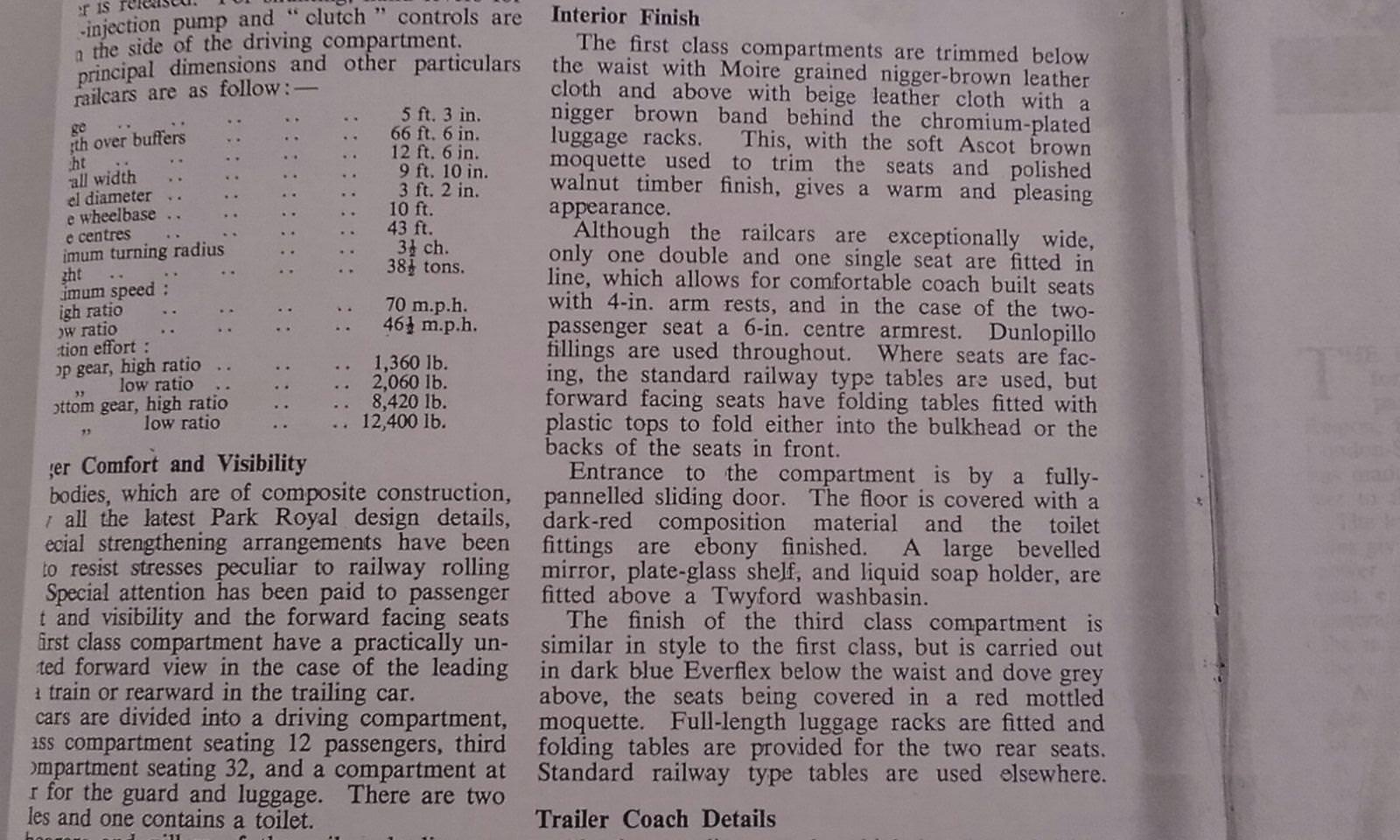

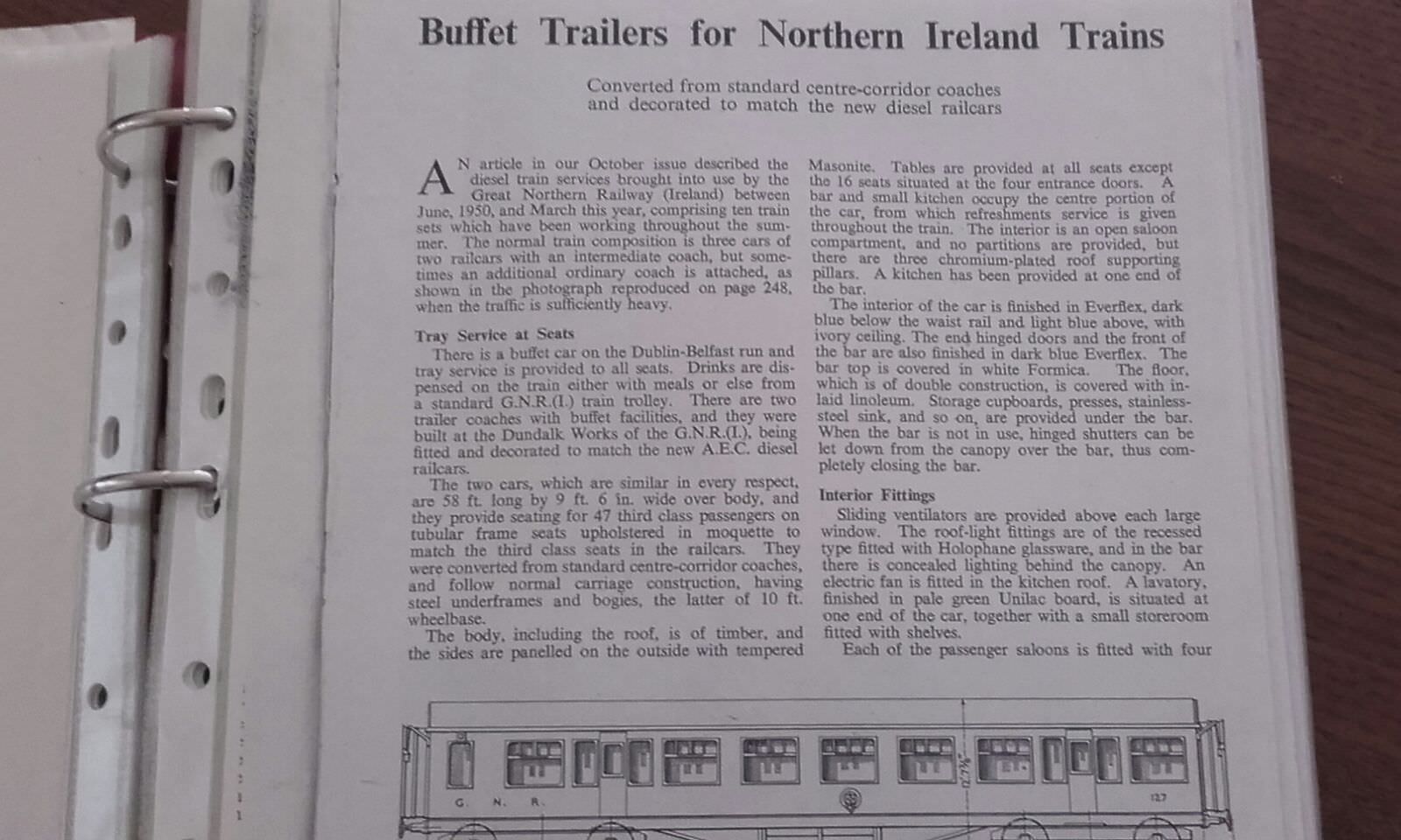

WRENNEIRE Posted August 3, 2017 Share Posted August 3, 2017 May be of some interest Quote Link to comment Share on other sites More sharing options...
Mayner Posted August 3, 2017 Share Posted August 3, 2017 (edited) May be of some interest The trailer coach looks like a K15 3rd Class. SSM do a complete kit for these coaches, Worsley Works have the option of a set of scratch builders parts or sides only to fit a rtr body. Interesting the note about the coach being panneled in Tempered Masonite (compressed cardboard) on timber framing which contributed to the short life of post WW11 GNR coaches compared to similar NCC/UTA & CIE stock Edited August 3, 2017 by Mayner Quote Link to comment Share on other sites More sharing options...
